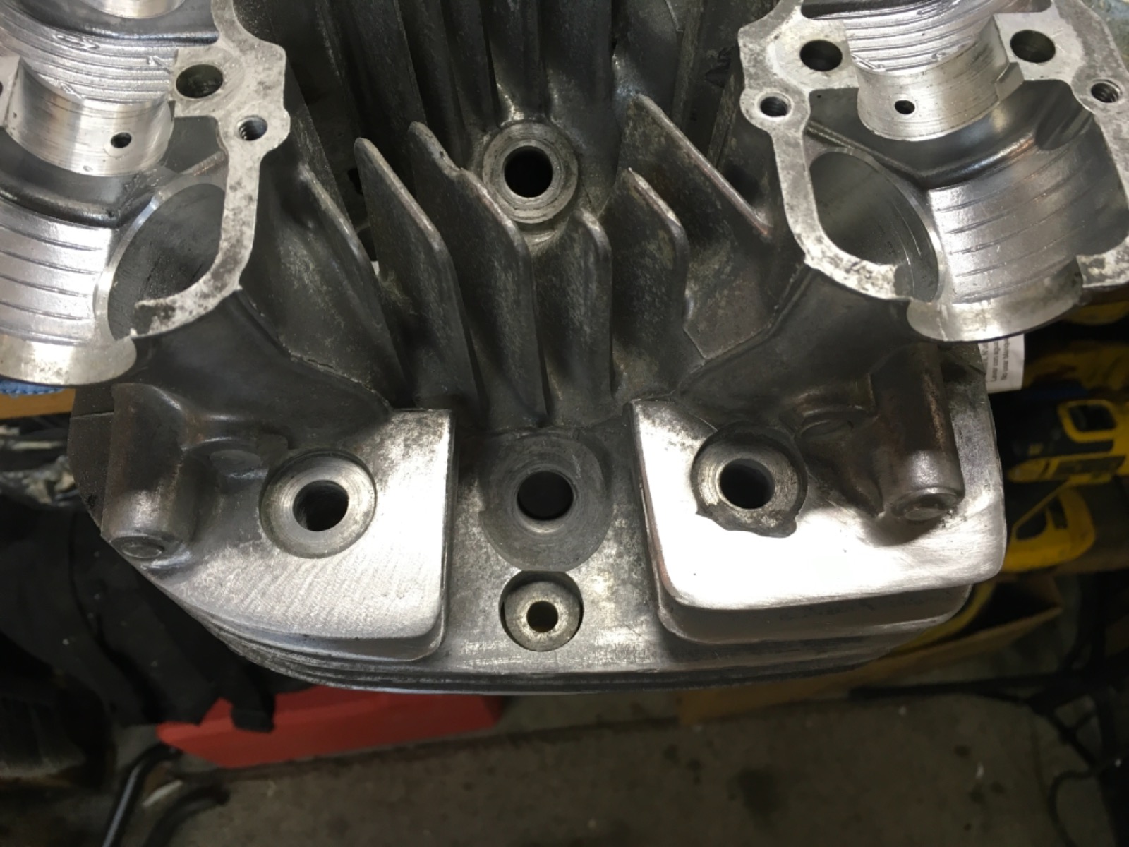

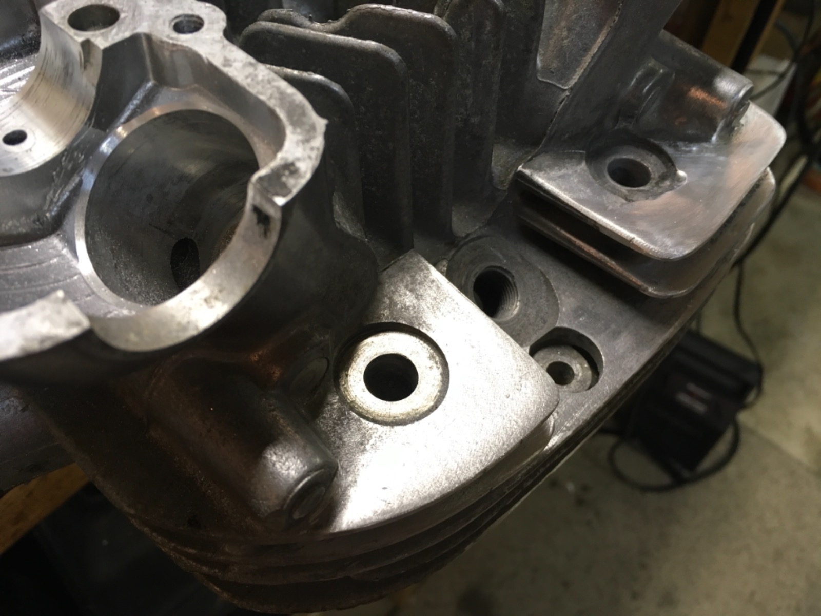

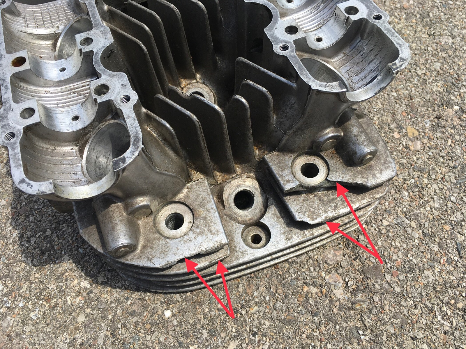

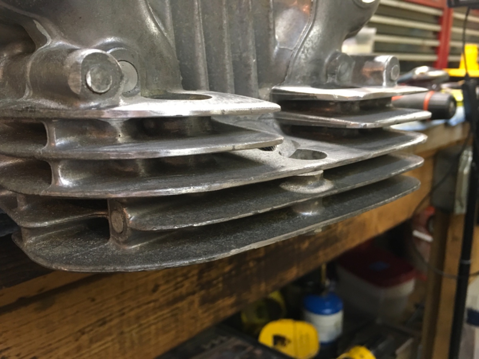

I’ve been working on the head. I found a local engine shop that had no problem welding up the broken fins. I cleaned the up today, I need to take the head back at least one more time to do a little more weld build up. They it off the be glass bead, I’m hoping that will blend in the repairs. Then to my Vapor Hone guy, and finally back to a different shop that’s been building metric engines for 30+ years.

That fin repair looks very good!
Vapor blasting with glass bead tends to leave behind some bead clinging to the workpiece. Don't know it it's due to surface tension or electrostatic attraction. To check for bead remnants, be in a dark or dimly lit place where you can be at least a few feet away from the workpiece. You'll also need a bright, point source light. A bright handheld LED flashlight with a spot beam works very well. Hold the light just below eye level & shine it at the workpiece. Any glass bead will reflect, making it easy to see what needs additional cleaning. A strong detergent solution, brushing and directed stream of water will remove the remaining bead.

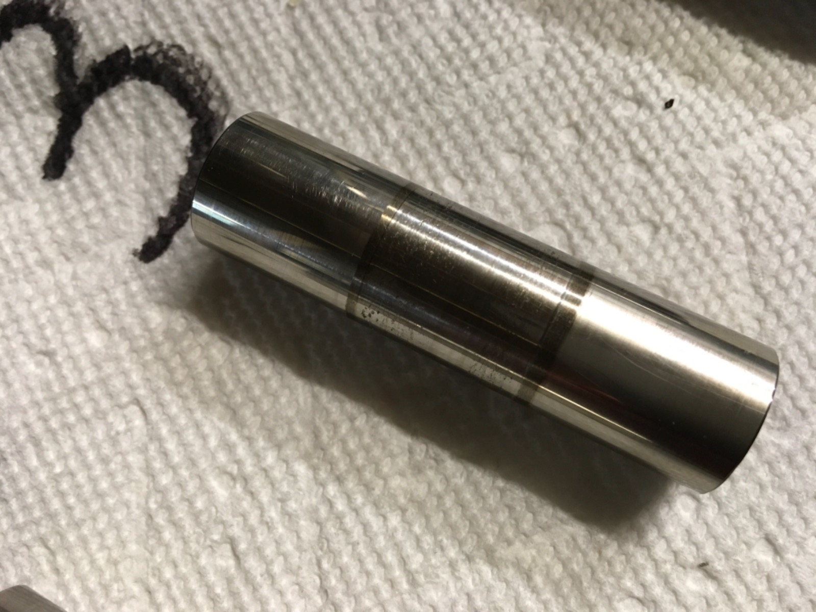

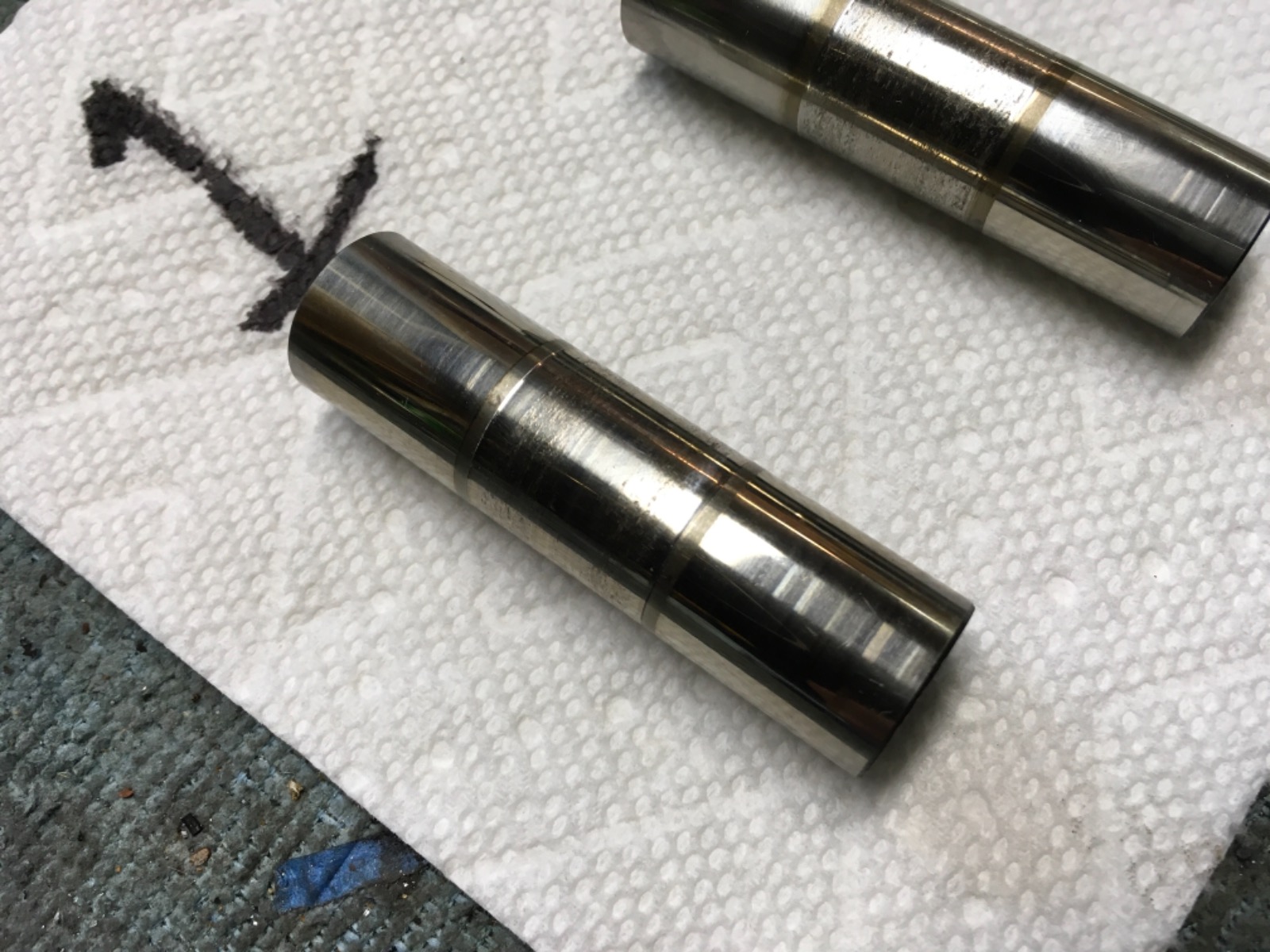

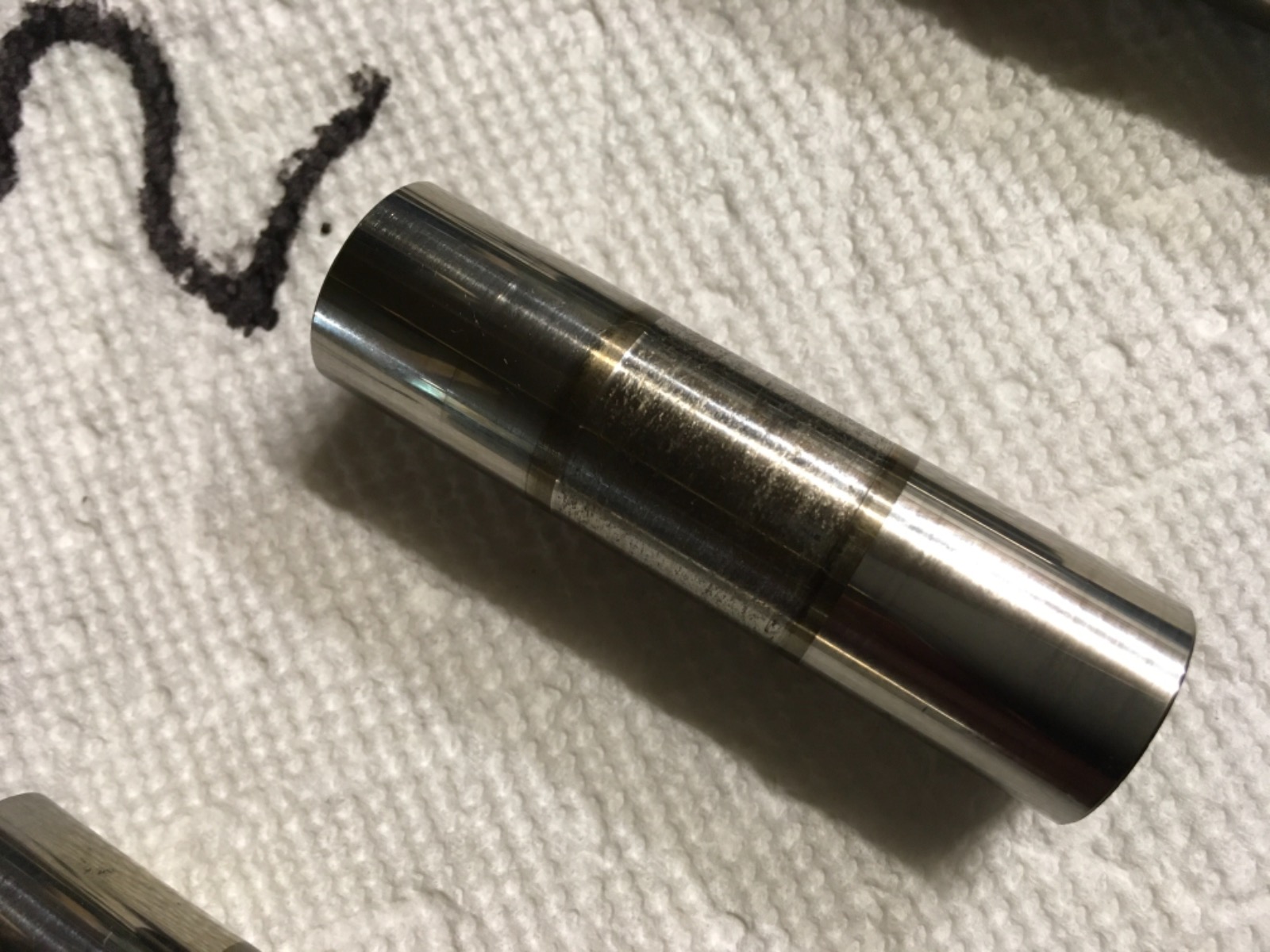

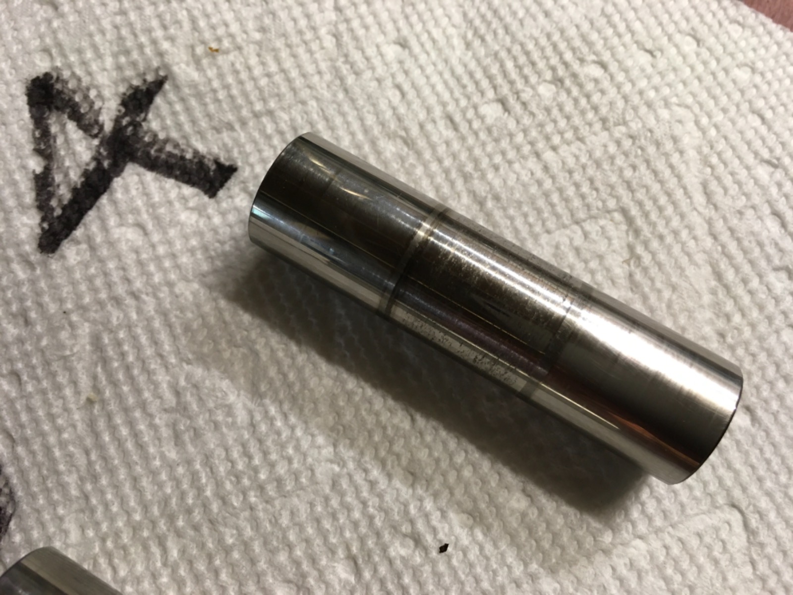

While I’m waiting on the head to be welded up the second time, hopefully I can profile the fins with the second build up and move on to the head rebuild. So I’ve taken to getting lower end parts out and inspecting them pre build. A quick reminder of where I’m at. The engine I bought for this build was an early ’76 without the oil volume cast into the upper case. It’s an unknown to me. Upon tear down it looked good but I didn’t dig deeper than the cases. They were my concern at the time so I could get them out to be vapor blasted. I did notice the pistons were 70mm wiseco. I didn’t want to use them so I have been searching for a good 66mm OEM set. I found them but no wrist pins included. I thought no problem I can use the pins I have out of the Wiseco. I dug the pistons up this afternoon and not pleased with what I find. The pins appear to have metal to metal transfer or gauling. I need advice please. I can get new pins but what if anything needs to be done to the small ends of the rods. Obviously I need this corrected before I build the lower. The backyard mechanic in me checked out the rod small end with my pinkie and it feels smooth but at the oil holes, the edges feel sharp. #2 appears to be the worst.
