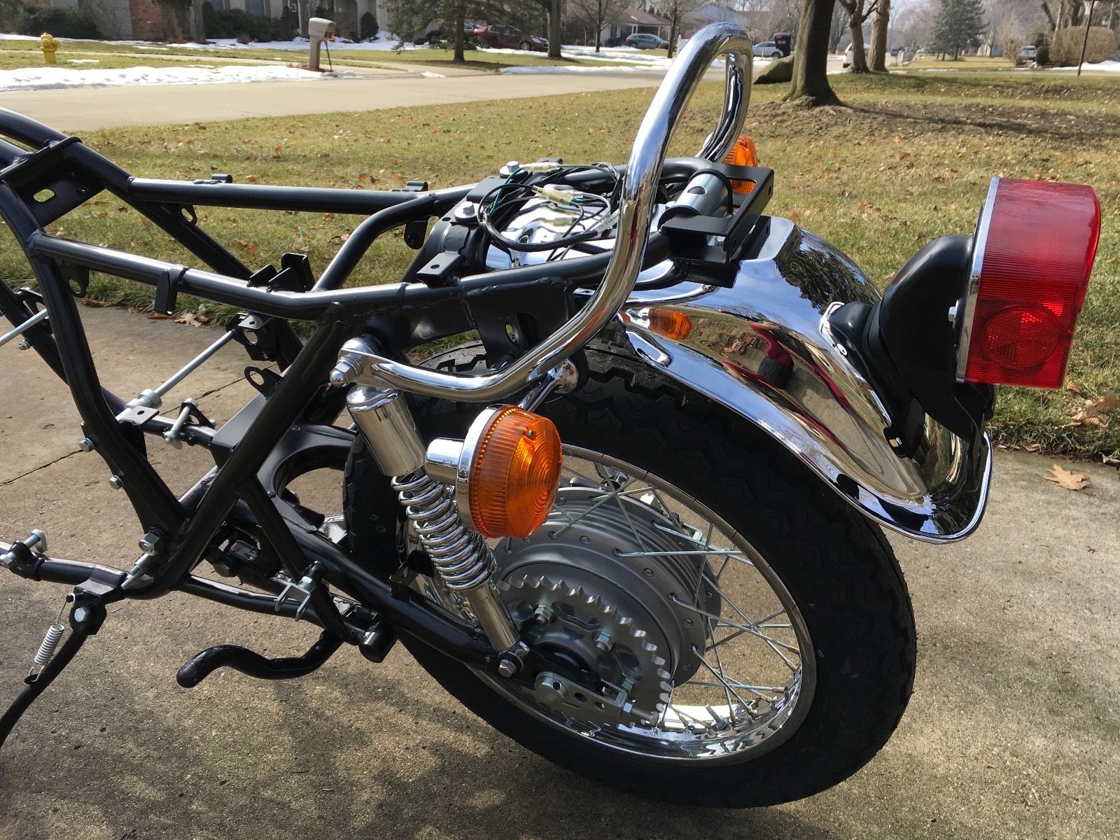

Chrome on fenders and rims was less than perfect back then. Few shops are able to do it correctly. Most make it look too nice. I had my fenders and rims rechromed and they are OK but overdone relative to OEM.

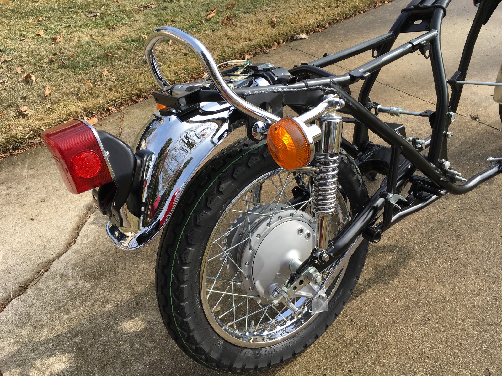

Wow... it’s on backwards... oldtimers? I think so... still getting replaced because the chrome is crap...
Tripp did a great job on my stuff so far. He did the rear rim and didnt over do it. Is just right.

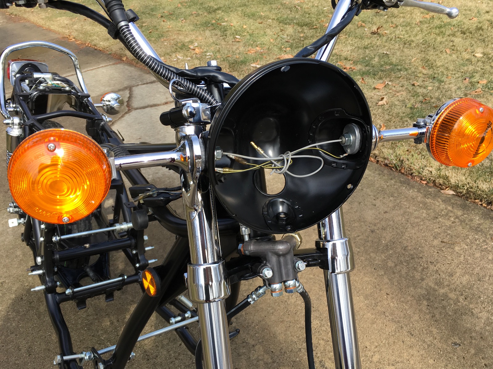

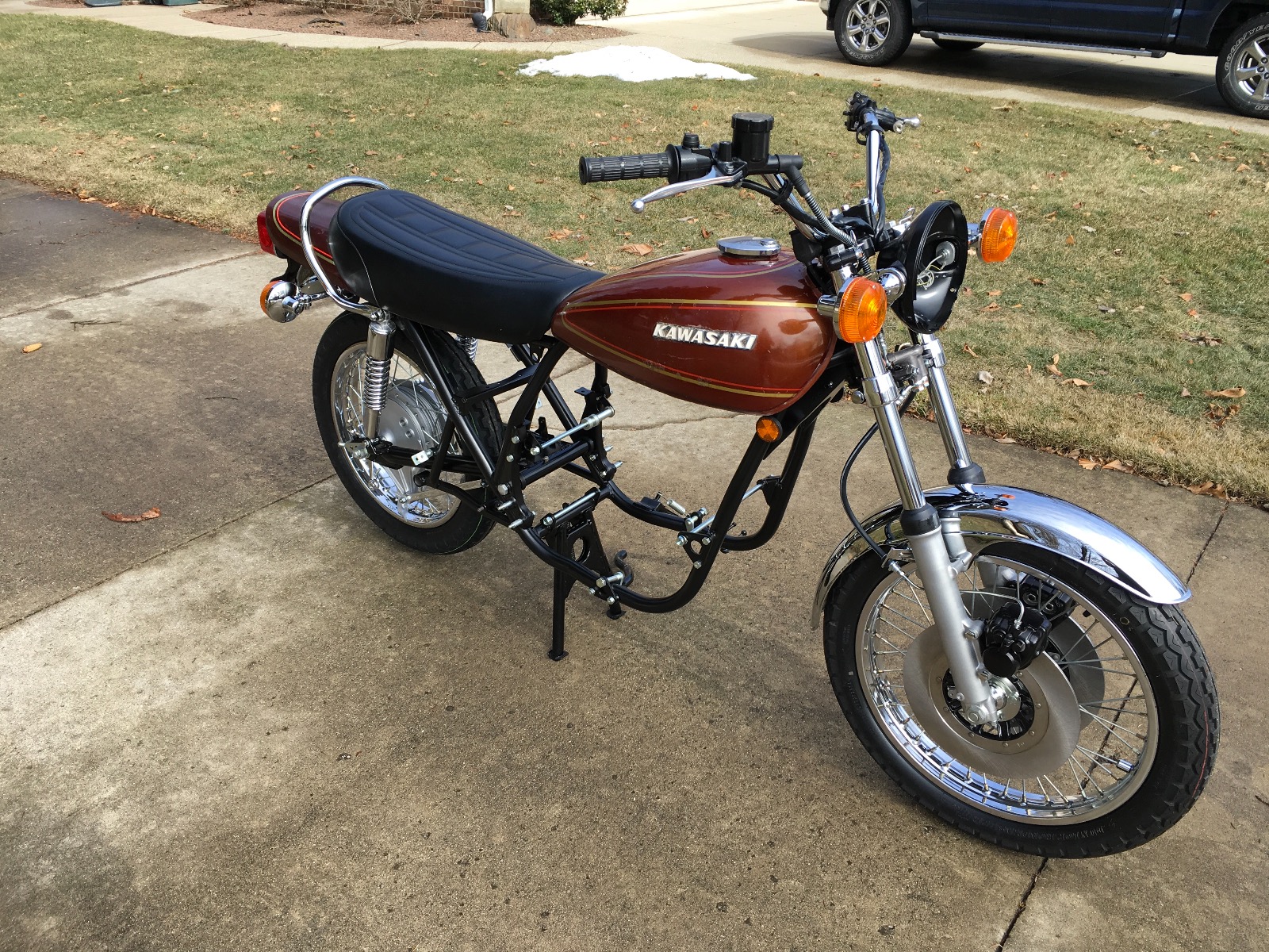

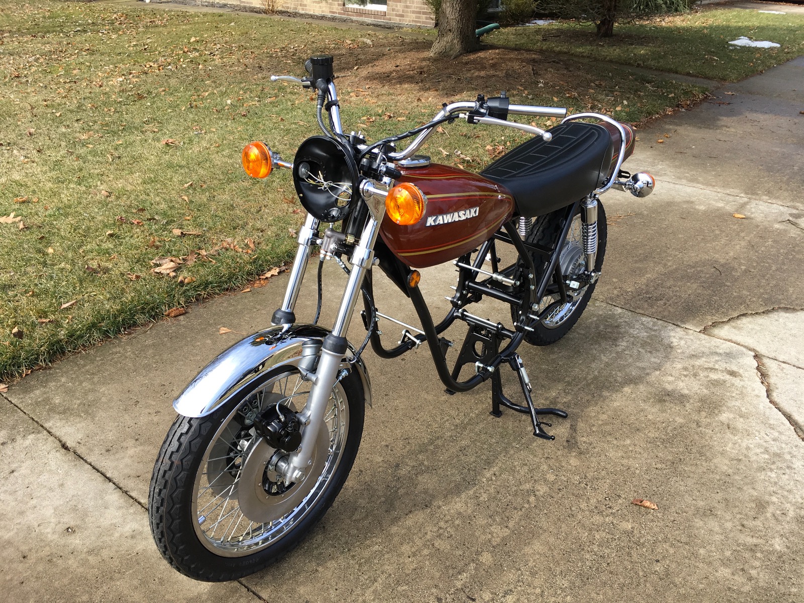

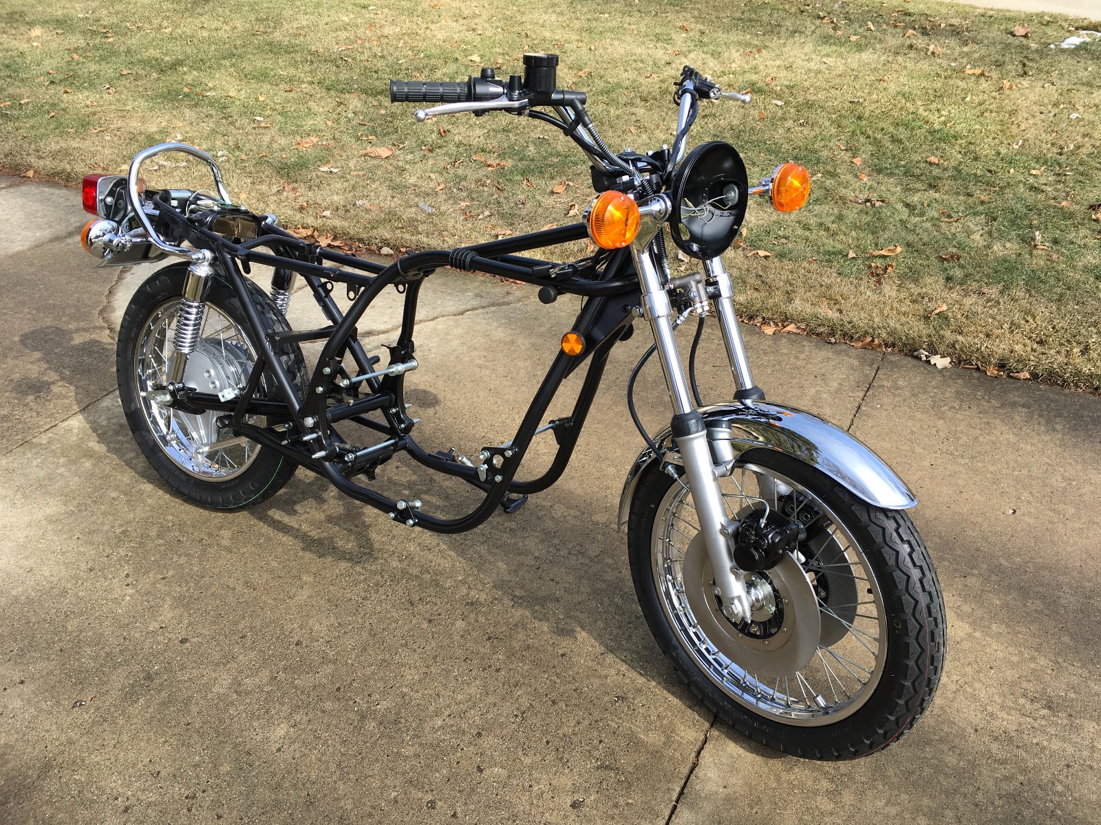

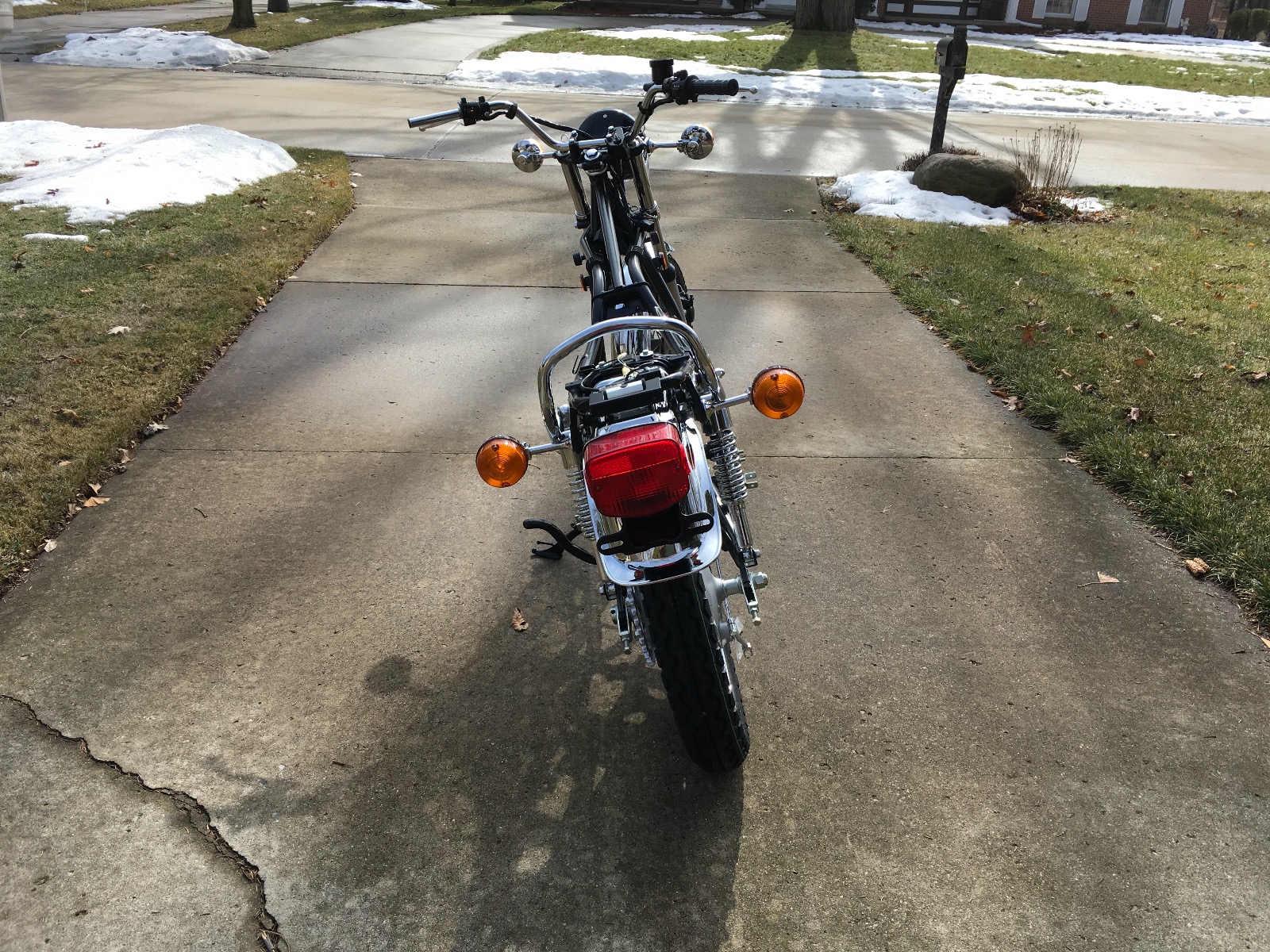

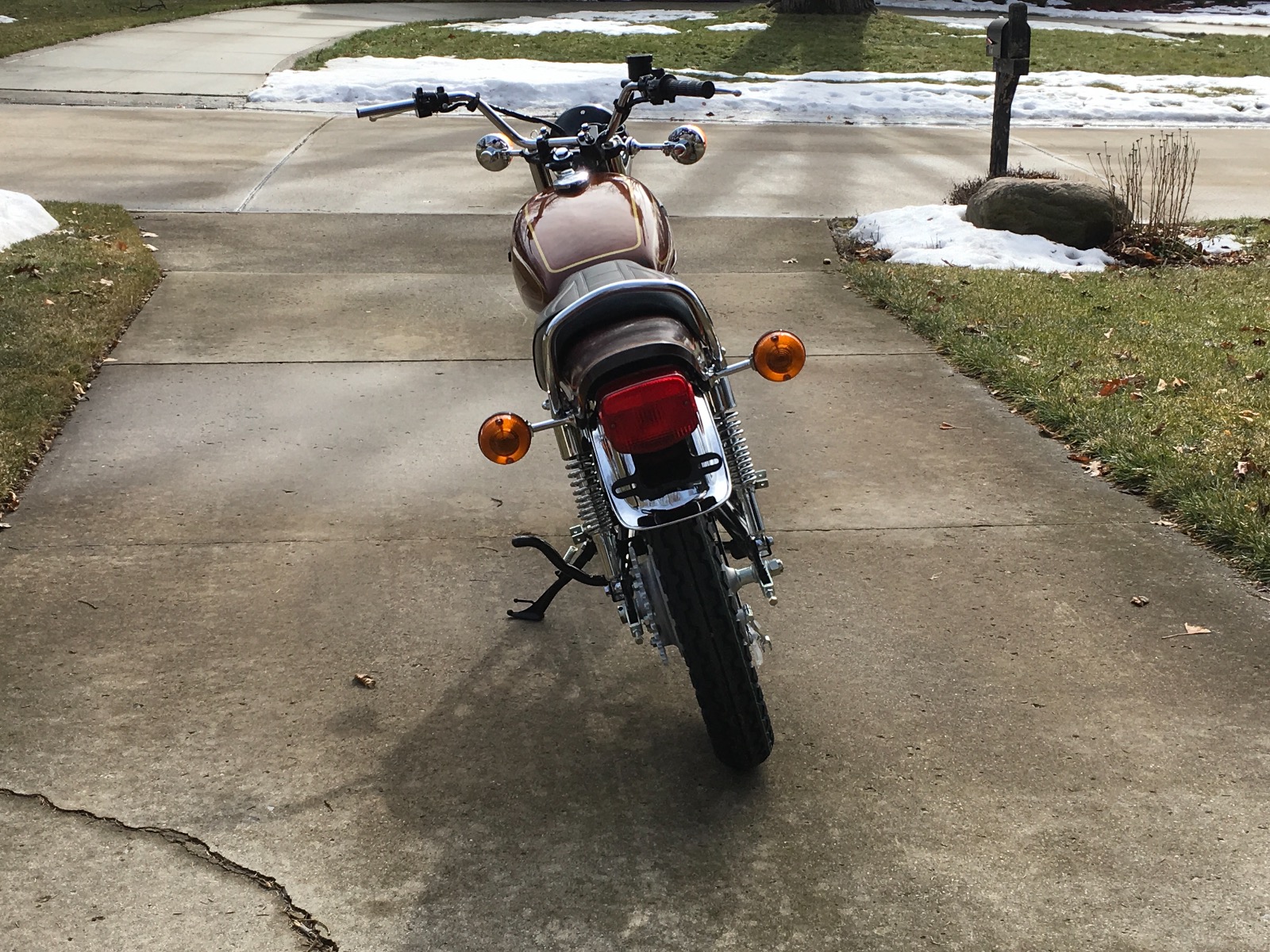

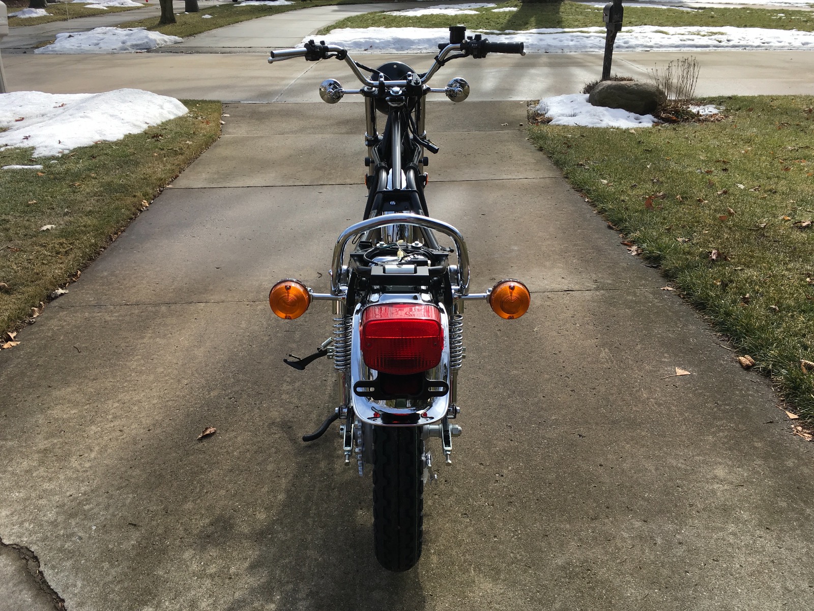

Got the front brake hoses, and splitter installed. Turn signals, rear seat stay and turned the front fender around. Then I played around and mocked up some body pieces I picked up over the winter. They were boxed back up till they can be painted.

Air ride suspension? You might live on a hill.

9er rider wrote: Air ride suspension? You might live on a hill.

That's going to be one sweet bike!

It's looking better than factory fresh!
