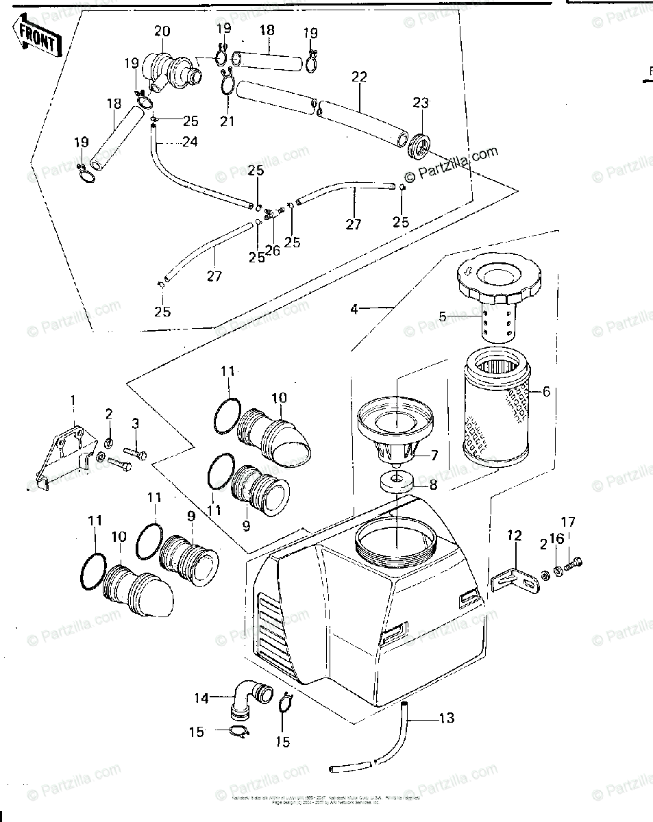

I'll be honest and say that I've never put an airbox on a KZ1000, but I have the parts and am planning to do it. My impression is that it just rests on the little stay bracket and is not bolted to anything but the carbs. My KZ650 box had mounting tabs and bolts, but the KZ1000 does not have any visible mount points, and the diagram for the kz900 looks pretty similar.

A Z1 airbox just rests on a stay. The purpose is to take weight off the carbs to prevent cracking of the intake boots. There is really no place for the box to go as it's jammed in pretty good.

Yup. Just sits there. That stay bracket is attached to the frame. Basically just a bigger space for the airbox to rest. If you want to get technical, the airbox IS secured to the bike, by having it clamped to the silencer, which in turn is attached to the frame.
Was you discover the joys of installing a carburetor rack with the airbox installed, you'll understand that there's no where for it to go.
Fairly certain mine has no filter material. That was probably to keep the critters out.

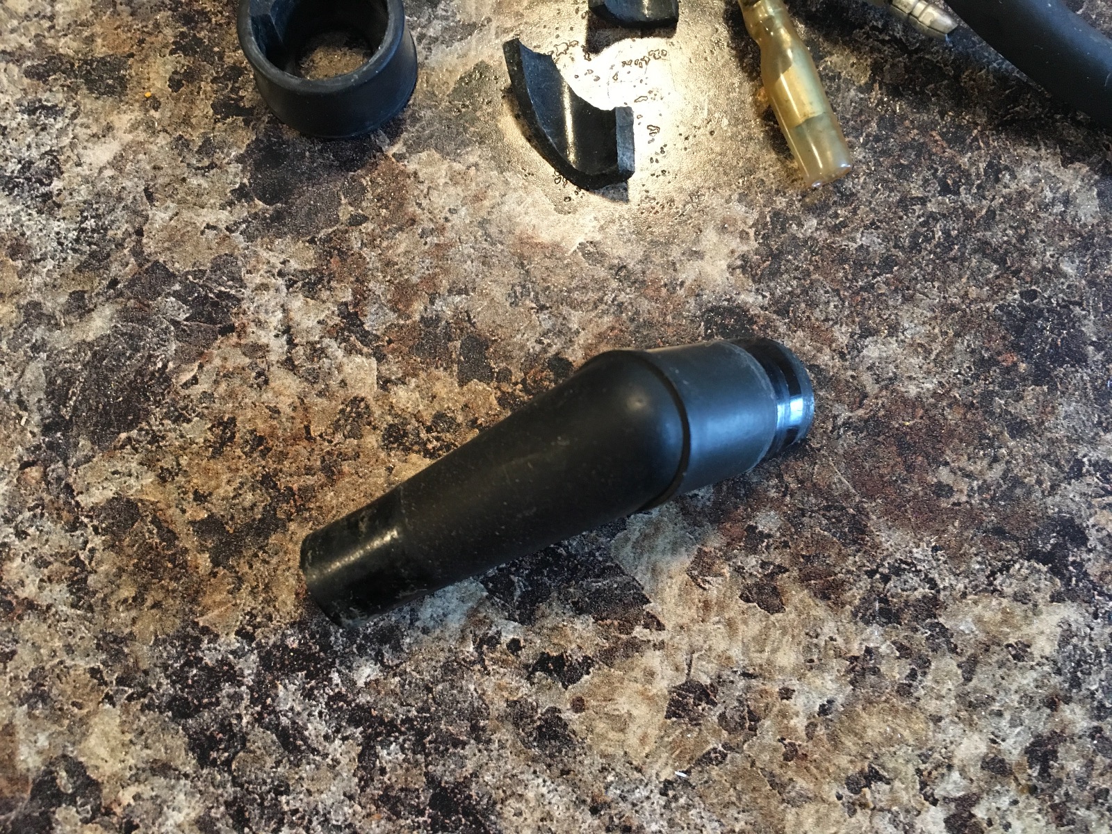

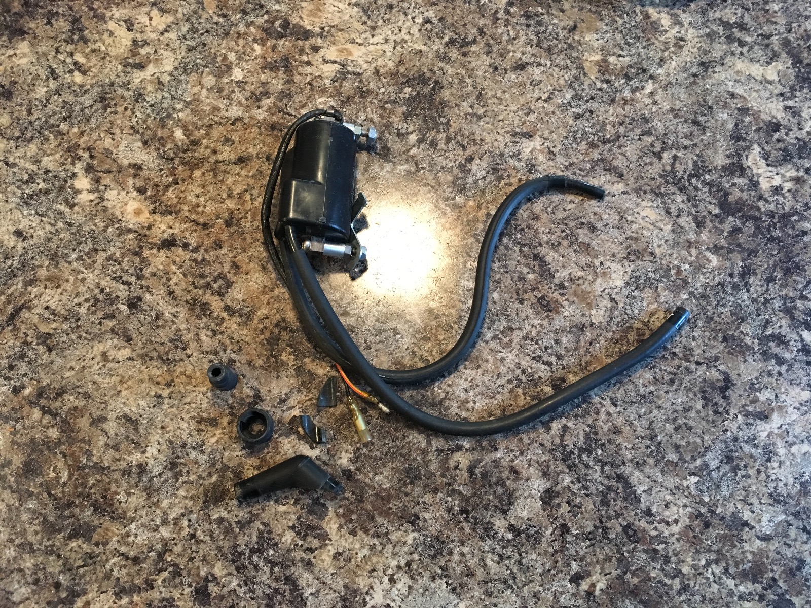

Need help locating spark plug boots. I need angled boots for 1-4 coil. All I can find is NGK and they are not correct. As a matter of fact the number 4 plug wire has an NGK on it now, the OEM is brittle and broke in pieces when I tried to remove the plug cap grommet. So I need leads on NOS or nice OEM 90 degree plug caps. Part number 21160-1014.
