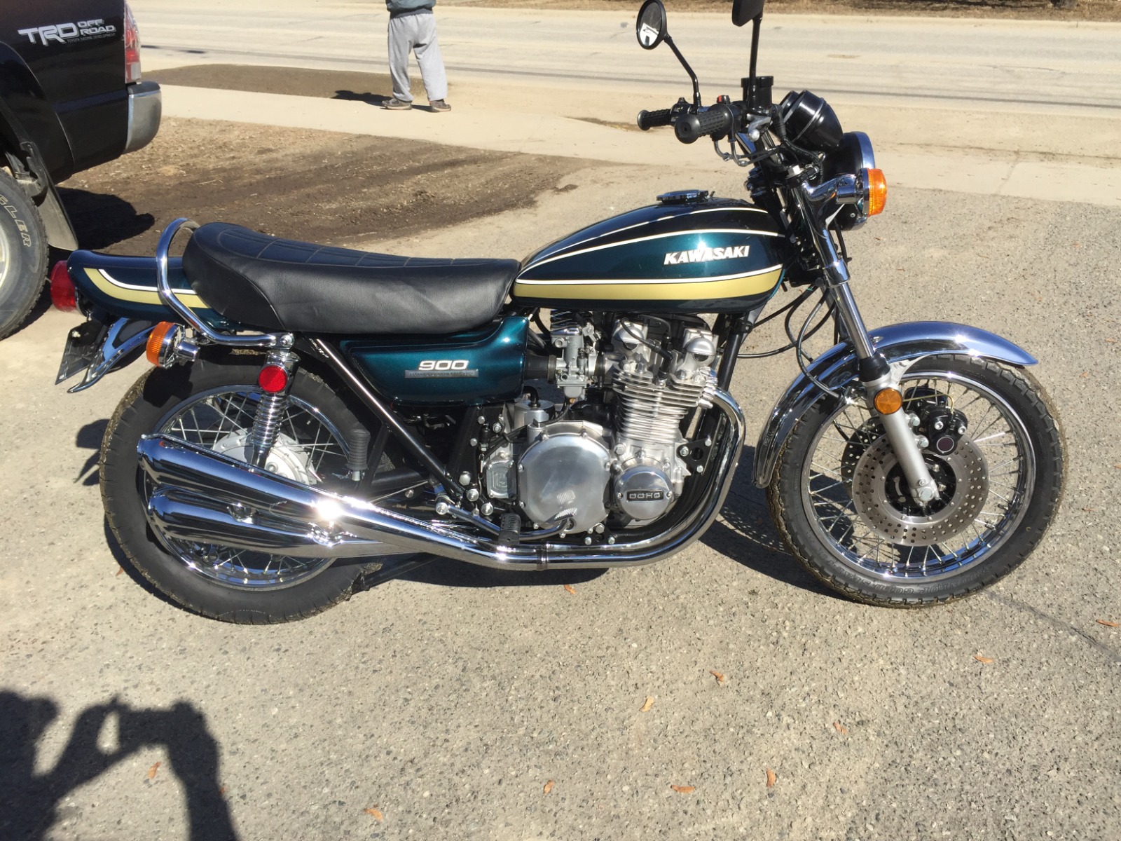

13 Dec 2020 19:37 - 13 Dec 2020 19:41Skidmark wrote: Beautiful bike!
Thank you! One of two. Here is the other one. In the photo it has a close ratio transmission, hence no kicker. This fall I changed the tranny to a standard and added a kicker, but haven't had a chance to ride the bike yet. I have a multi-vehicle classic plate that allows me to run any of my three vintage bikes when I wish. I just have to change the plate to the one I want to ride.
Apologies to Mikaw for purloining his thread.

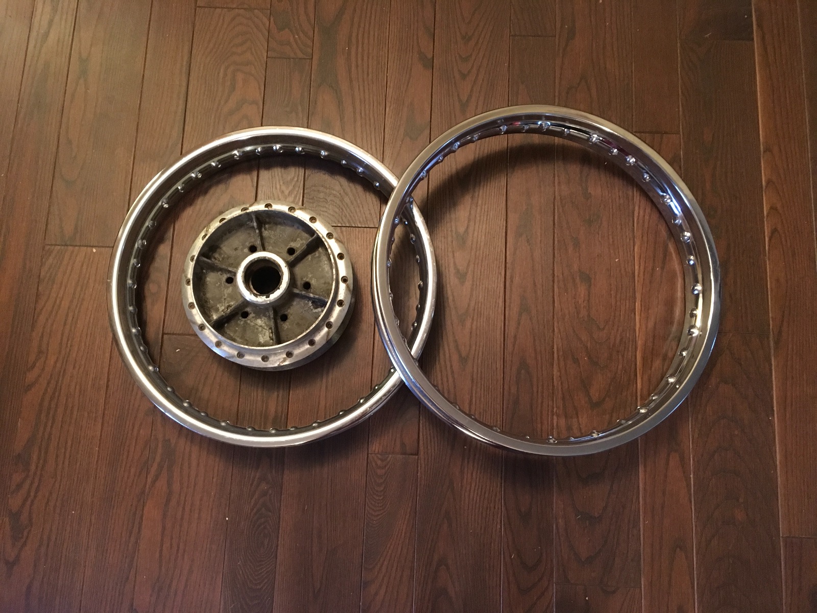

So I chickened out. I found a custom shop about 40 minutes away that will true the rim for $70. A spoke torque wrench is more. But I did get a tidbit of info from a grumpy HD snob. He was initially interested in the job and ranted about how experienced he was and mentioned that Some HD front hubs have a 3/32 offset in the rim. When I mentioned what the rim was for he refused to work on it. Anyway I’m assuming if you measured from outside face of the rim to the Center Line of the hub one measurement would be 3/32” longer. Is this anything that needs to be addressed with my rear rim? Does the hub self center as the spoke tension is equally taken up ? If an offset is reguired then how much, to which side?, and I’d assume the shorter side would need the spokes tighter first to pull the hub toward that side.
Thanks for the help. Go easy on me for wimping out on not taking on the truing.

14 Dec 2020 20:42Mikaw wrote: Anyway I’m assuming if you measured from outside face of the rim to the Center Line of the hub one measurement would be 3/32” longer. Is this anything that needs to be addressed with my rear rim? Does the hub self center as the spoke tension is equally taken up ? If an offset is required then how much, to which side?
I believe bicycle rear wheels are typically offset to allow room for the gear set. But it doesn't look like you need to worry about it. If any offset was required, I believe it would be mentioned in the manual. I looked in the kz900, kz1000, and kz650 manual at the rim replacement section, and it doesn't say anything about offset at all. Just runout specs and torque specs.
Also, I'm guessing that if an offset was required, the spokes would be cut to different lengths for each side. Generally you want the spoke to thread most of way into the nipple, but not poke out. With all the spokes equal length, you're going to end up with very little offset if the nipples are all in about the same place. That may be why the FSM doesn't even mention the offset at all.

15 Dec 2020 05:45DOHC wrote:Mikaw wrote: Anyway I’m assuming if you measured from outside face of the rim to the Center Line of the hub one measurement would be 3/32” longer. Is this anything that needs to be addressed with my rear rim? Does the hub self center as the spoke tension is equally taken up ? If an offset is required then how much, to which side?
Thank you, I did look through the FSM’s I have and didn’t see anything either, that’s why I asked. Having different length spokes makes sense it would cause the hub to offset. All mine were equal length but were different bend angle for inner and outer.

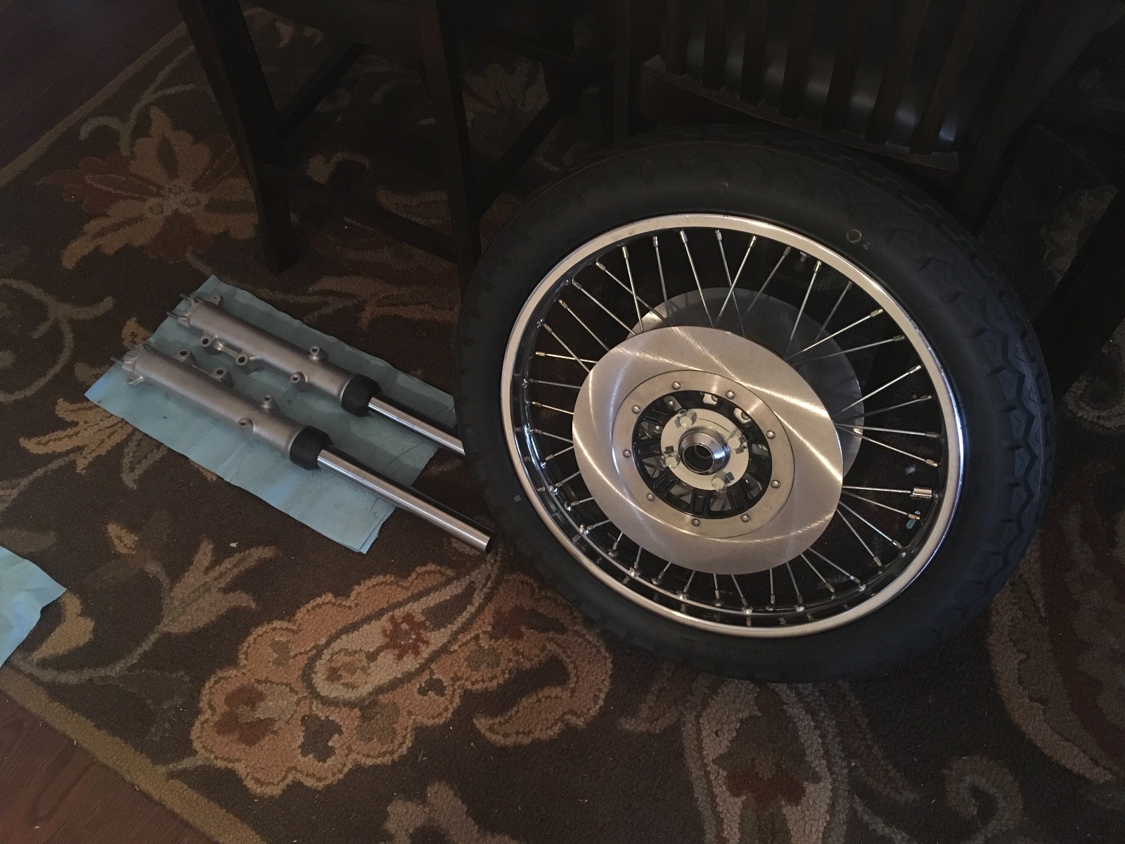

Small progress yesterday. I got the front wheel partially assembled and the forks done minus the springs, top cap and fork oil. I’m posting more as a heads up to not blindly trust your torque wrench. It’s been in the low30’s here over night so a few days ago I brought everything in including the torque wrench. Wanted things to be warm when assembling. The last time I used my torque wrench it worked as normal, it was stored at its lowest setting in a case. But for my better judgment I could have snapped a rotor to hub bolt. I kept pulling waiting on the click which didn’t come and felt like I was way over torque. Turns out I was right and something had happened to the torque wrench during storage. It seems common here that people post “it snapped before the torque wrench clicked”. Never trust a these things, use good judgment and feel. If it seems over tight and no click it probably is. Mine is Craftsman brand so now I have to find a way to have it calibrated or replaced.

I had to replace my Craftsman torque wrench (the smaller in/lb one) due to it not reading or clicking at the set amount. Mine had rolled off the table and hit the floor, though. Before using my new replacement, I put an old bolt in the vise and checked if it clicked. It seemed to be working good. Do a search online for metrology companies to find a calibration house. The Craftsman brand (and most others) say their torque wrenches are accurate to +/- 2 in/lb, or ft/lb on their larger ones. A calibration company would get it closer than that. Since I was in charge of a Quality Assurance department in a machine shop, I know of and have used several calibration companies in So. Ca. You shouldn't have any trouble finding some i your neck of the woods.
