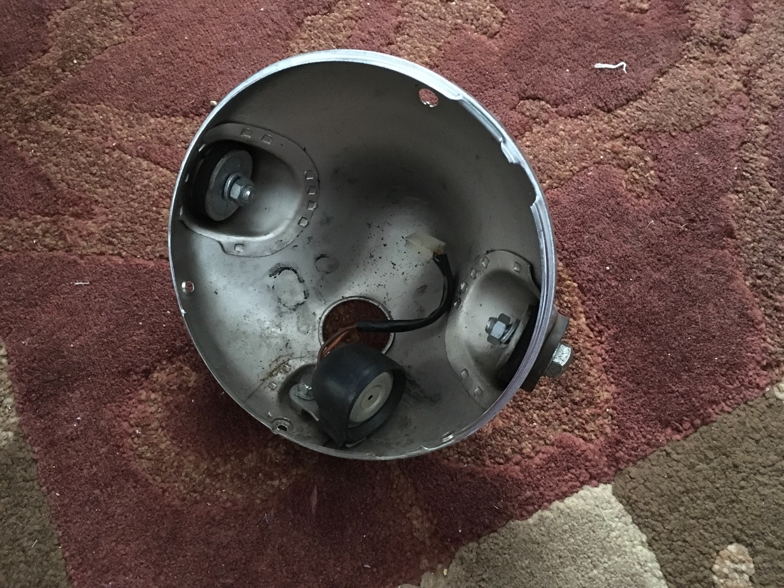

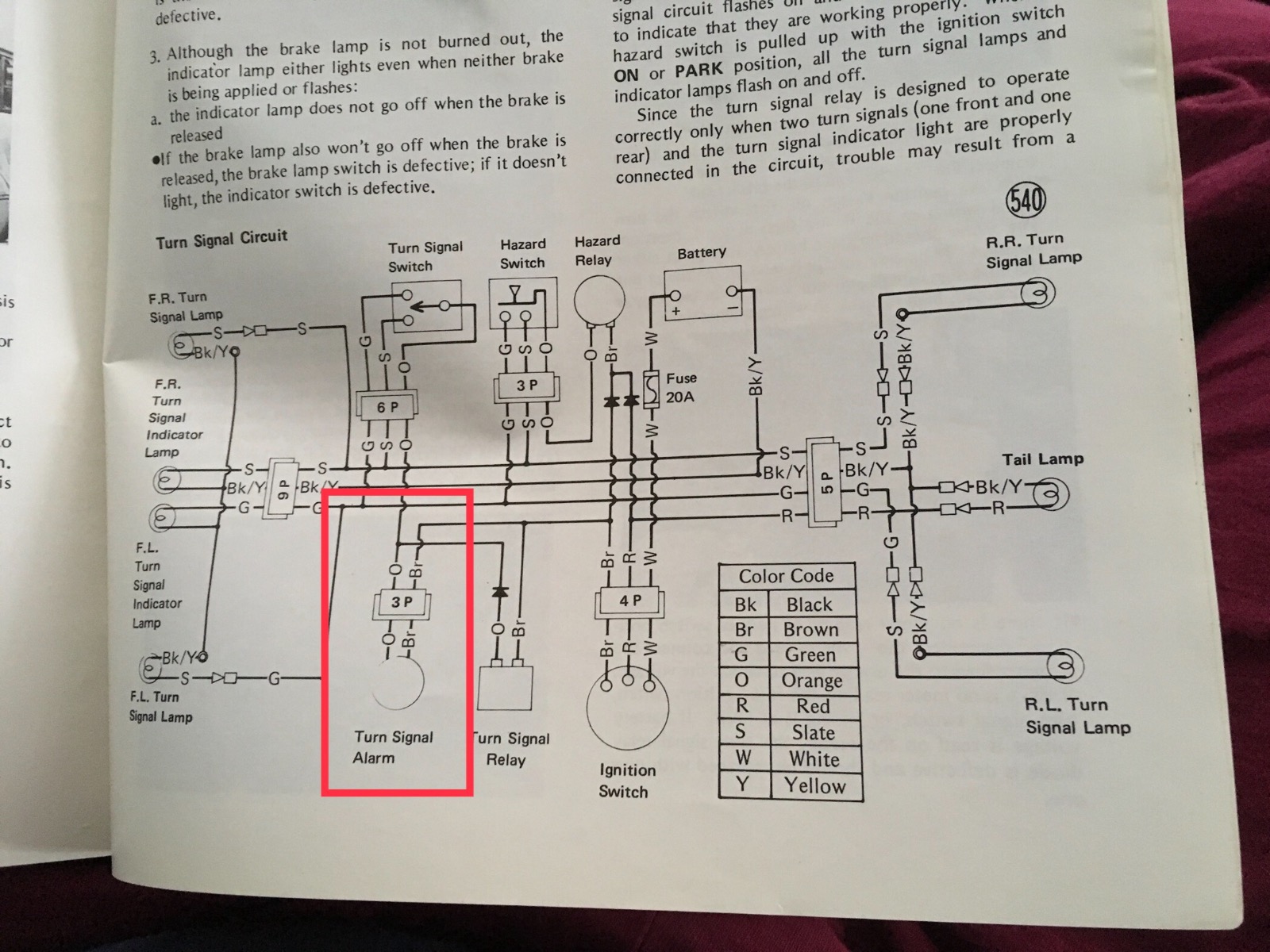

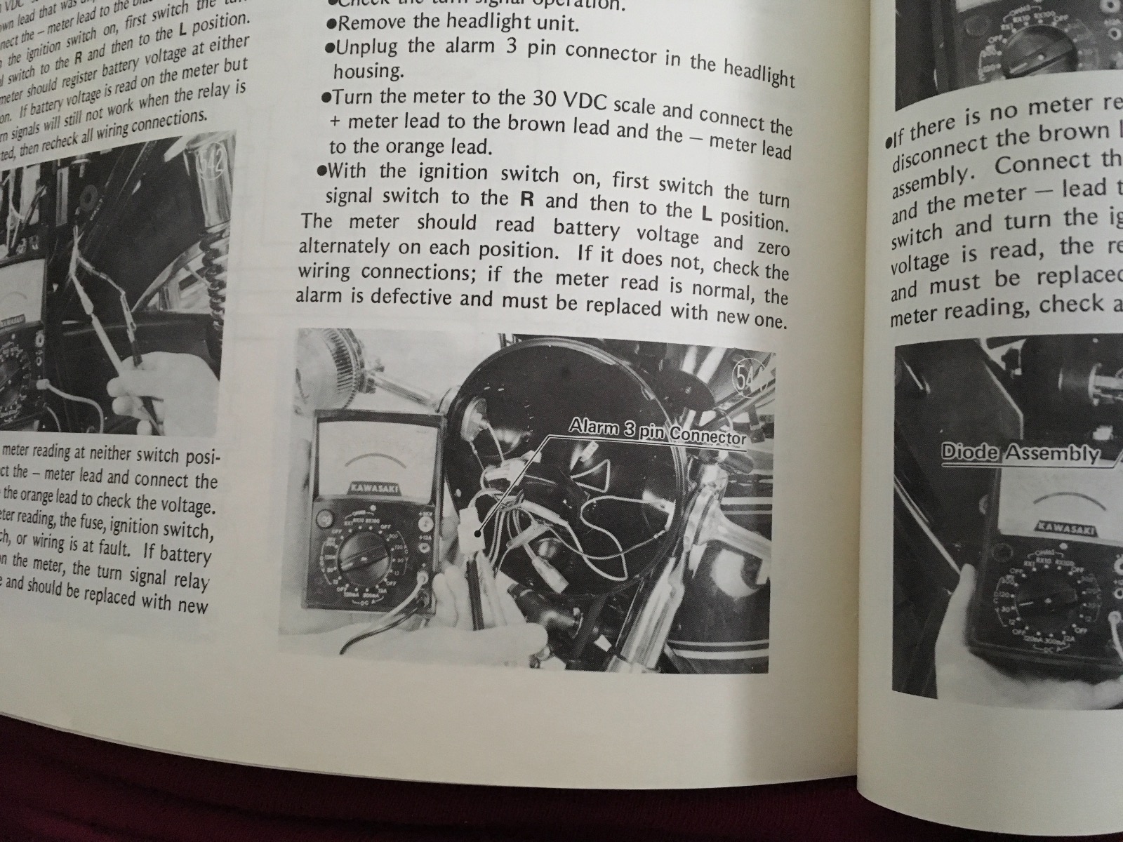

I think I’d be the winner though as shipping for you wheel would be far more than the signal alarm. That said I’m not opposed to helping you lace your rim. Here’s what I found in my SOS (lol) it’s off my ‘76 Kz900 LTD. I don’t remember if I placed the alarm in the bucket for storage or if that’s were it was originally. The male 3P connector on the harness side is short, the female 3P on the alarm is long enough to appear to be designed for the connection inside the bucket and the alarm mounted outside. I can’t ever recall seen one mounted there in any pictures I’ve seen. The only reference to the alarm in the FSM is in the testing and diagnosis section for the turn signal circuit. It shows the connector inside the bucket and meter probes on it for testing. But it shows nor says anything about the alarm itself.

That looks like the piece I found, it doesn't look right to me inside the shell and I'm unsure if the sealed beam would fit with it positioned there. It wouldn't make sense, to me anyway, to have an audible device inside the mostly closed up shell, but maybe that's what made it sound like a "droning duck"! Turn signals and related pieces were some of the first things to come off our bikes "back in the day". Now I'm really nervous waiting to turn left in city traffic, which I rarely do, without something else flashing to HOPEFULLY draw attention to the fact that I'm not moving!

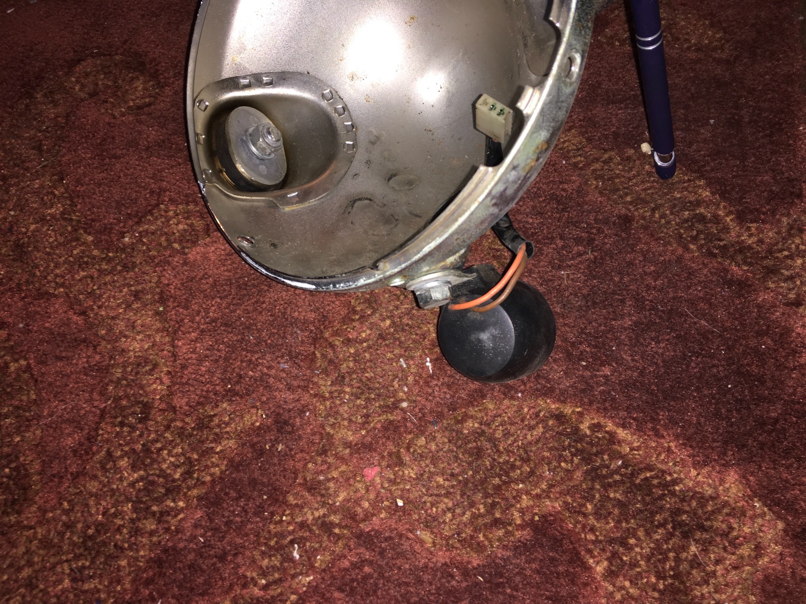

I agree Mike. The more rational threoy was to mount it outside of the bucket. I think like you the sealed beam wouldn’t fit with it inside. It is rubber covered and would appear to be best mounted underneath facing rear. The wire seems to have a natural set that makes that mounting position likely.

It mounts underneath the bucket pointing to the side.
