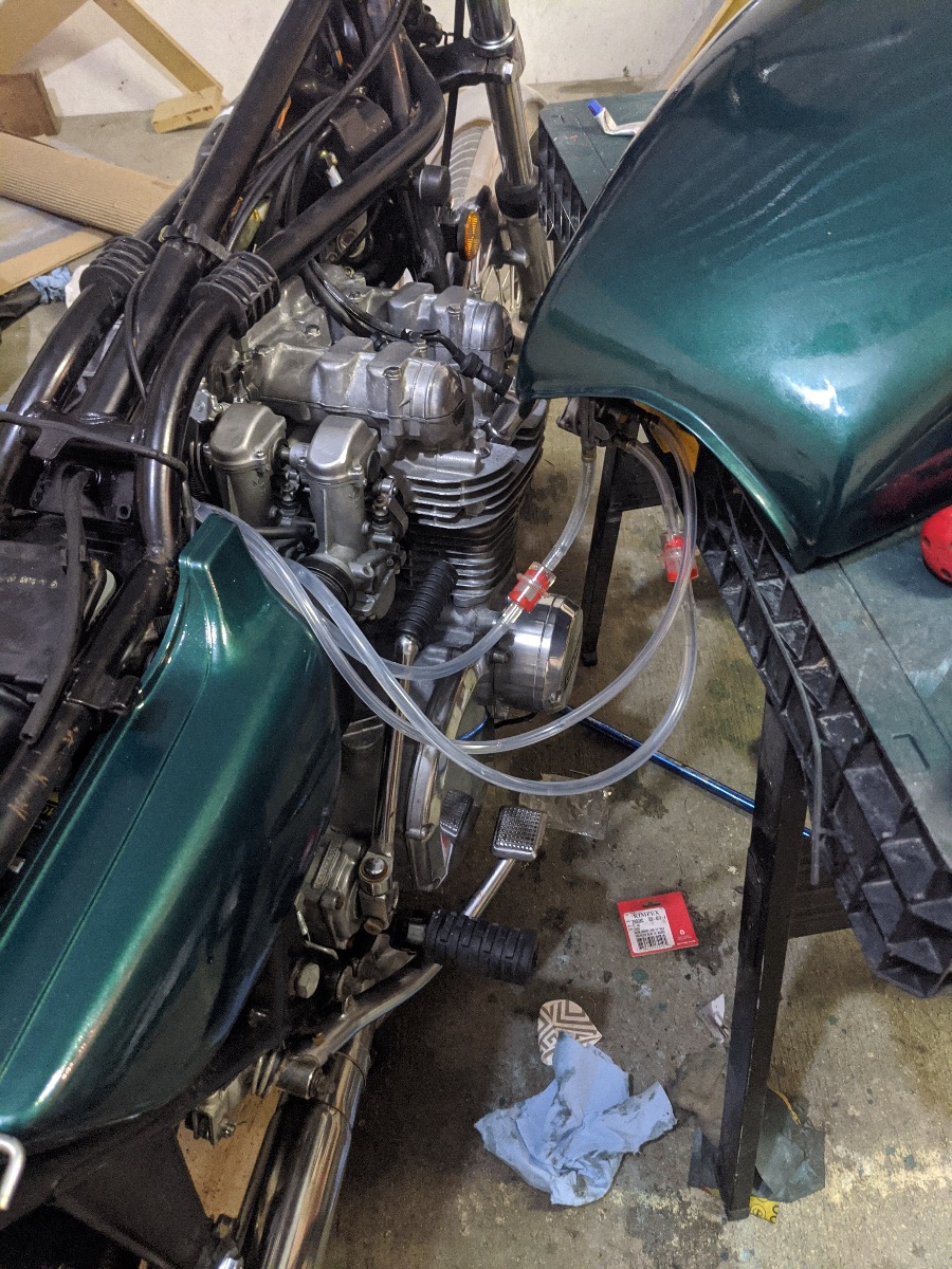

So a few updates tonight. I spent some time the other day adjusting float levels on the carbs. Hope I got it right.
New oil filter arrived so I got that in and filled her back up.
Exhaust is also in, so of course I got that on too. Pretty impressed with the build quality of the Delkevic.
Finally figured out a few issues today. One of them is thatI’ve been chasing a rich condition on cylinder 3, causing it to take quite a while to warm up on that pipe. It was now even a visible issue, as that pipe wasn’t getting the golden colour of the other pipes.
The other issue, of course, was the fuel in the crankcase. Well, today I discovered that there was fuel in the vacuum line to the petcock. Probably would have been chasing my tail on this one for a while as I usually have a black vacuum line installed, but as I needed longer lines to keep the tank off, I happened to use some clear I had laying around.
So I took that hose off the petcock and plugged it, then ran the bike with what was already in the bowls and lines. Pipe 3 almost immediately started turning gold.
So I figure that was the cause of both a cold pipe, as well as the fuel filling the crankcase.

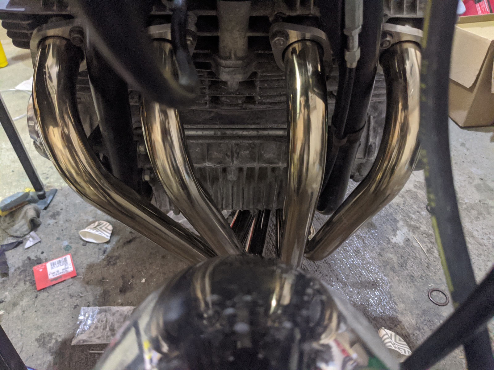

Please post a right side profile picture, I’d like to see how the Delkevic looks. I really like the gold tone the pipes take on.

Not a problem. I'll try to remember to take a picture next time I'm at the shop.

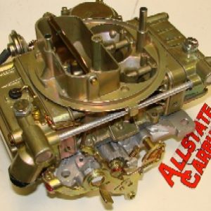

Sounds like a good idea, you could pull all your fasteners and send the out to be zinc coated. Then the can dip them in a chromate bath and you get the “yellow” color. I think that would be a great personal touch. I’d due the axles also. Great idea for a winter project. I’d suggest getting the hardware vapor honed first. The zinc re-coat will be just like new bolts. I bet you’d have less than $300 to do them all.
This is an example of zinc chromate finish.

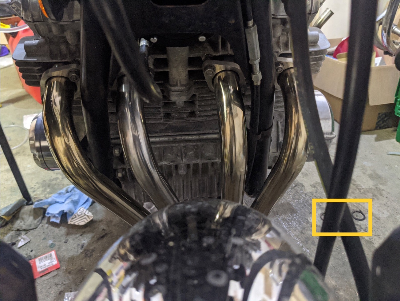

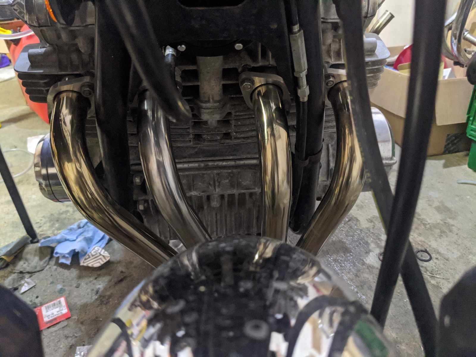

Not insinuating or trying to insult your skills, but these are the “old” exhaust gasket and you installed new ones right. See yellow square
