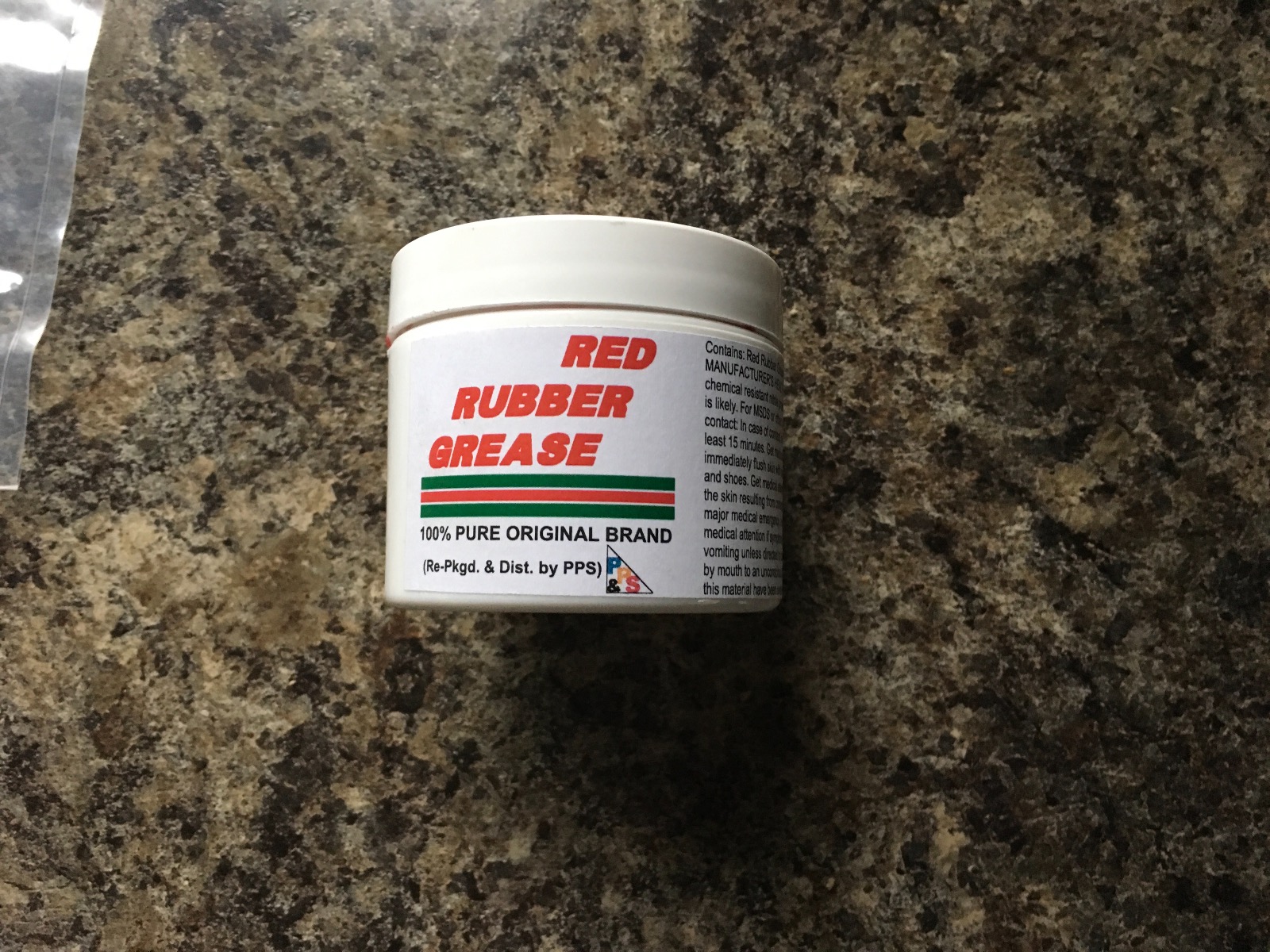

Sorry this is piecemeal but if you need a lubricant to install the piston you can’t use standard grease. You can try using brake fluid or Red Rubber Grease.
