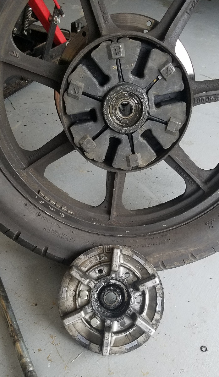

12 Sep 2019 15:53 - 12 Sep 2019 15:54This is exactly what was describing above. I googled sprocket holder and all that really popped up was the dirt bike video plugging a holding tool. Obviously the dirt bike sprocket was barely tight. In using the brake to hold the front sprocket, there is also a rubber damper between the wheel and sprocket that will dampen the impact wrench blows the same way that it smooths out the engine pulses on the chain.
The rubber dampner is #14 in this snip from the FSM.

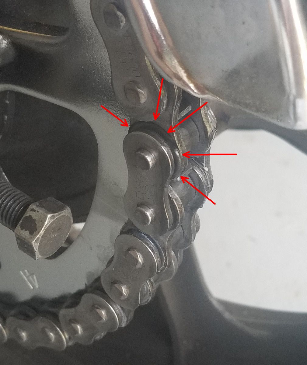

Re: 89 KZ1000P bobber?
20 Sep 2019 16:10
Did you replace the sprockets? Be sure the link isn't too tight.
20 Sep 2019 16:30 - 20 Sep 2019 16:45
Looks like your o-ring is squashed a Little bit to much. You Need the right chain rivet tool for D.I.D chains
EDIT: It could be also a wrong/bigger o-ring under the master link and your master link is not rivet right!!!
Last edit: 20 Sep 2019 16:45 by Scirocco.

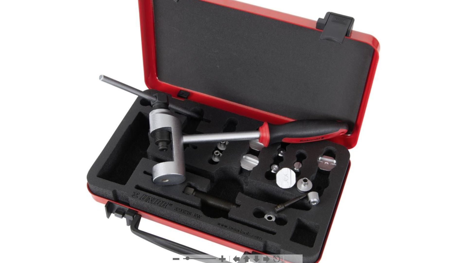

20 Sep 2019 16:49
The DID tool is expensive, but worth every cent. It worked perfectly on the RK chain I recently installed.
20 Sep 2019 20:36
It's too tight. I'm trying to get it opened up a bit. Used a cheaper Amazon chain tool. May have to cut this off and put other snap link on.
22 Sep 2019 07:54 - 22 Sep 2019 08:13Wow, Jim.. that o-ring is REALLY squashed out. lol Don't feel too bad, I screwed up my first try too, then bit the bullet (not too hard) and ordered in a new rivet link that matched my new EK chain perfectly. It did take some looking to find the right link, but as everyone knows, a chain is only as good as it's weakest link.
It doesn't take an expensive tool to rivet a chain, although the link needs to be pushed onto the pins properly before riveting.
