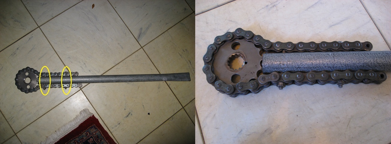

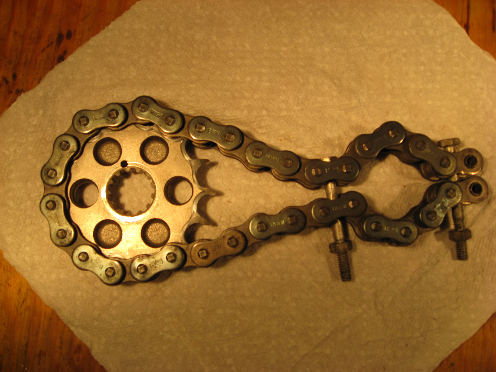

PLUS, using the brake to hold the sprocket while loosening will act as a damper to the impact blows and hinder removal of an extremely troublesome fastener. A couple of long 1/4" or 5/16" bolts through the chain links will hold the sprocket solid.
Here is a neato tool to hold the sprocket while loosening the nut. Not necessary with a few bolts.
