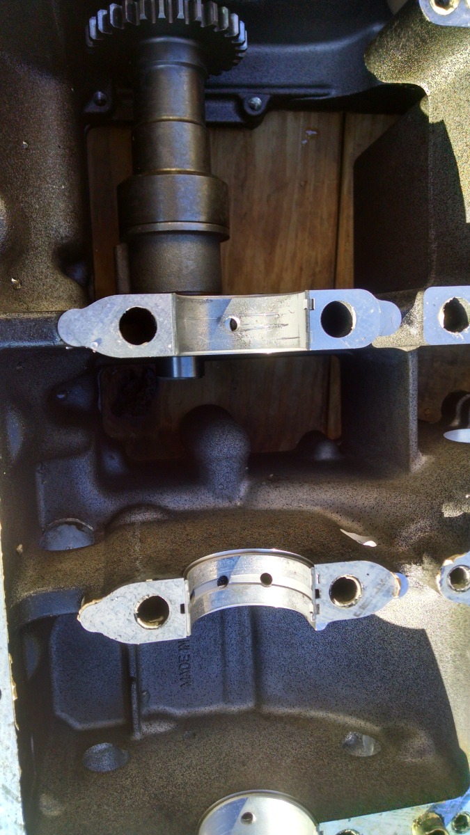

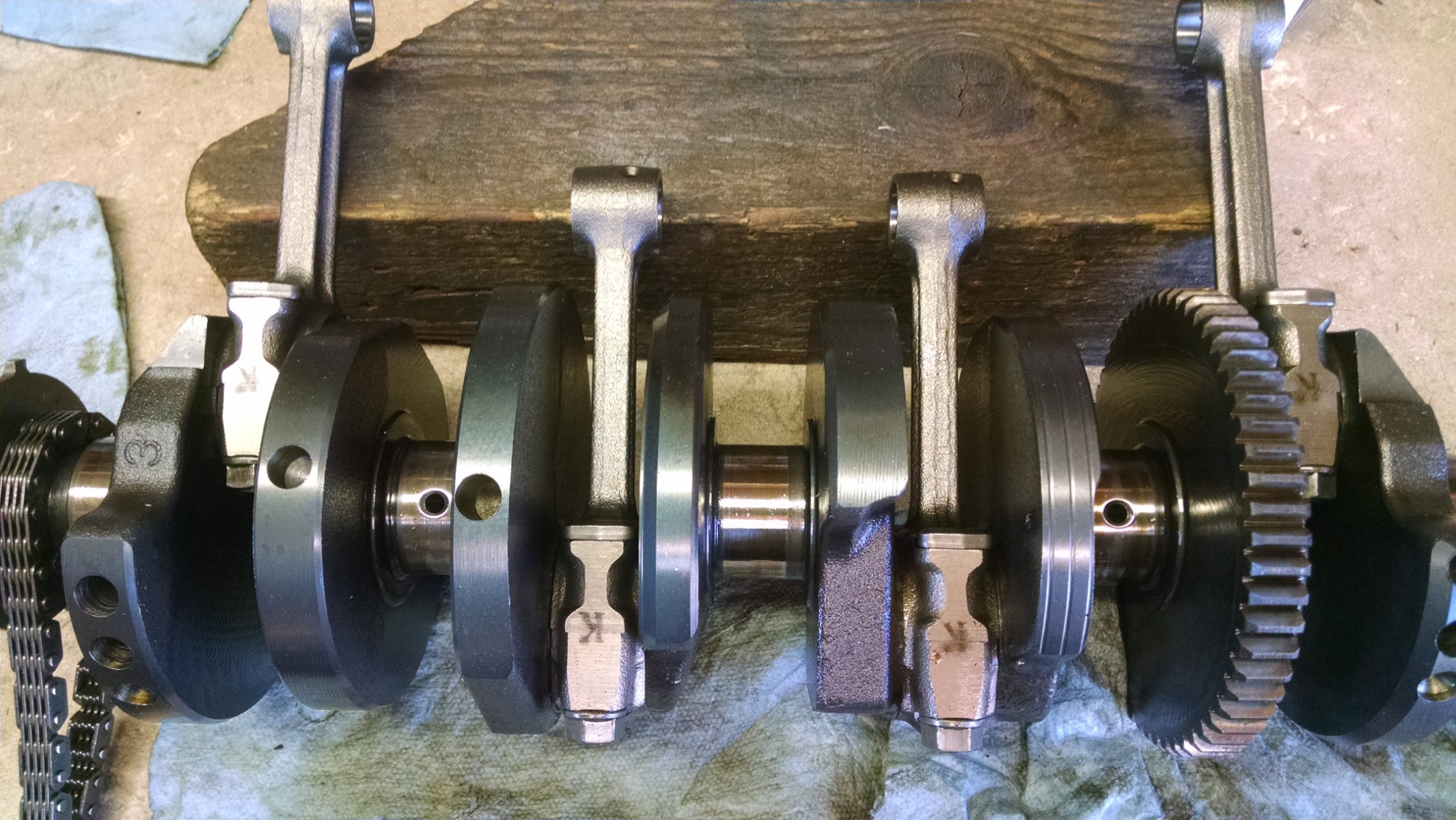

I finally disassembled the original engine that does >not< have custom ventilation. The bearings look worse than the parts donor engine. Also the same misalignment of the #3 main bearing insert. At least KHI was consistent. I can't believe QC let this slide! This whole lube oil system is a complicated mess!

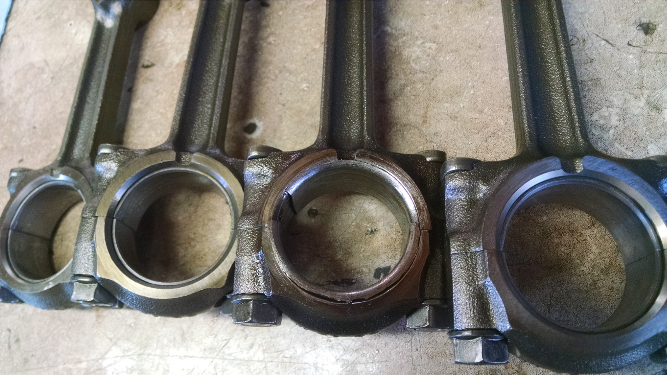

The big end of the rod is still intact, but I am willing to bet is is wayyyy out of tolerance.
I tried to number stamp these rods, but that is some hard metal. I think I ruined my number stamps trying to number these rods.

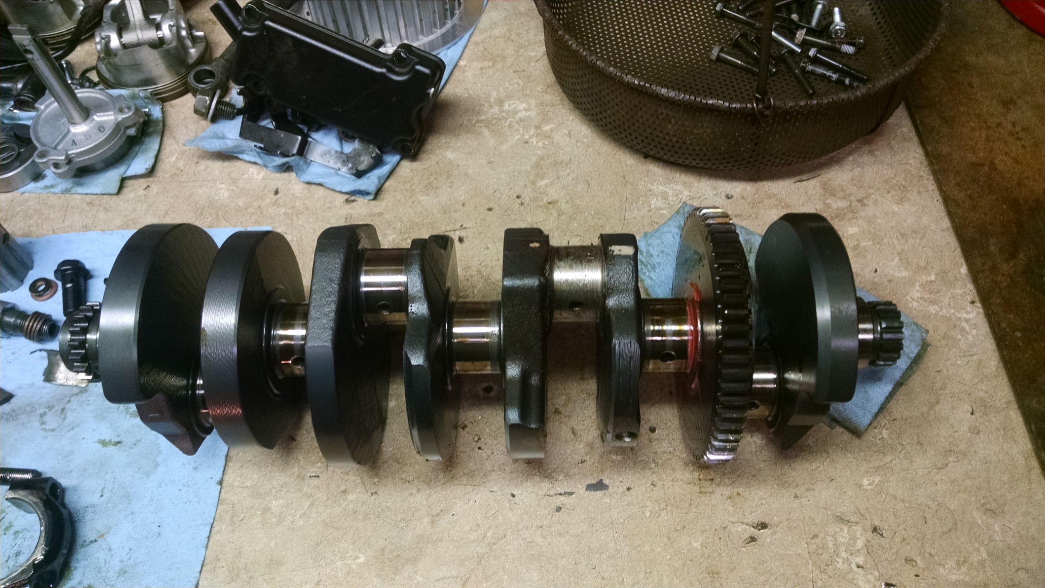

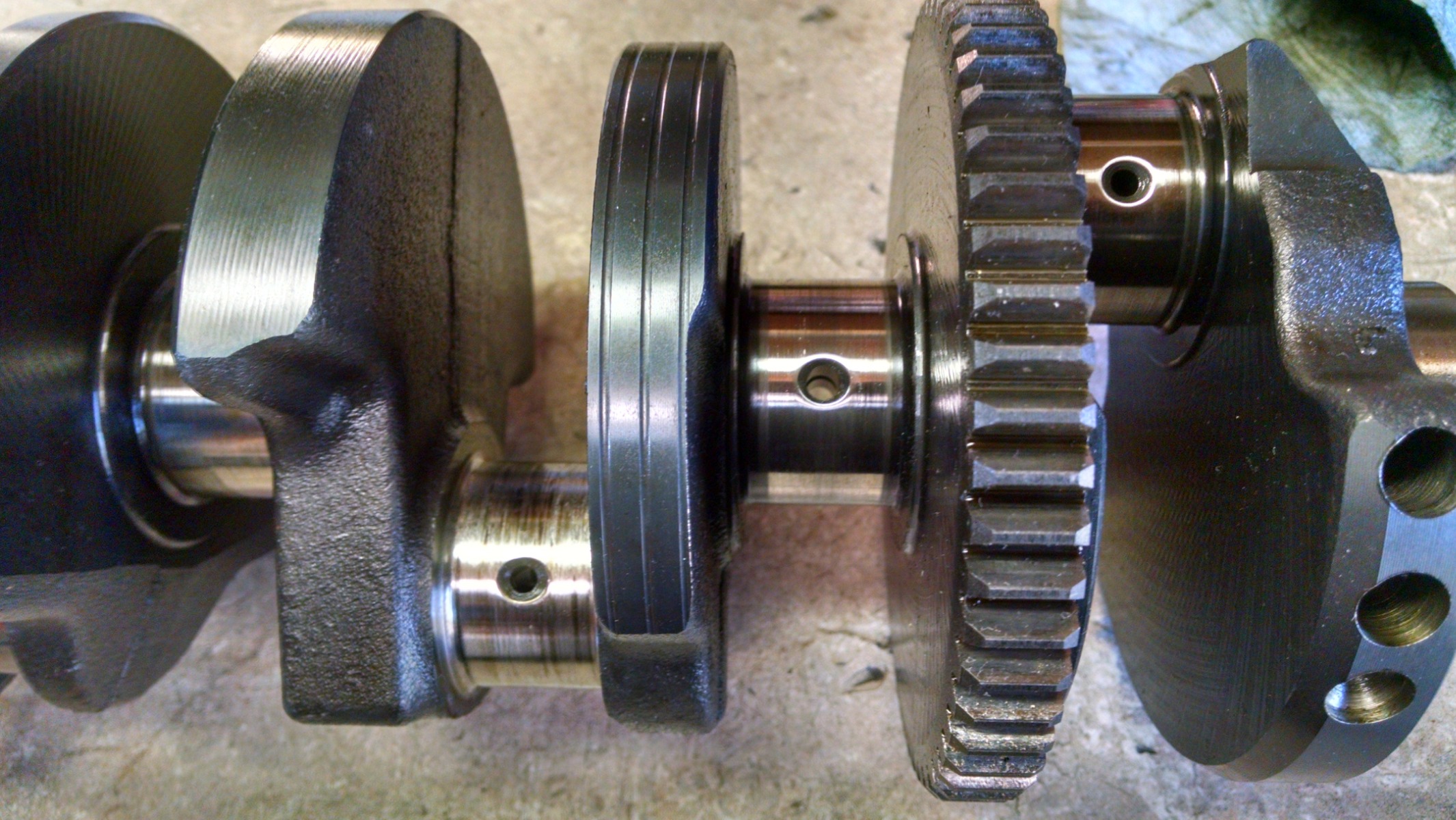

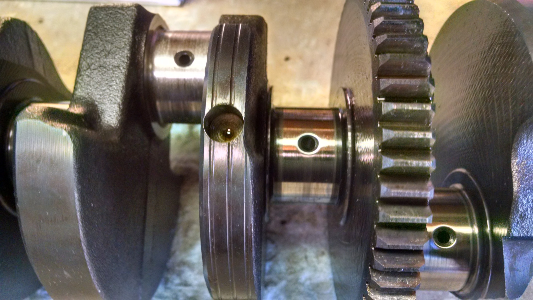

The crank looks mucho better, yet still about .015"-.020" smaller (1.395") than the other 3 rod journals. (1.416") using my veneer calipers for measurements.
The down-stroke side of the journal.

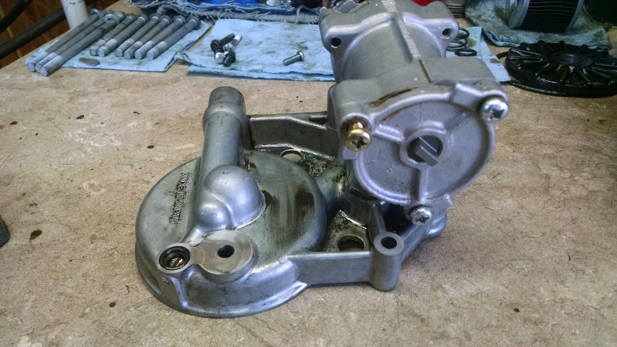

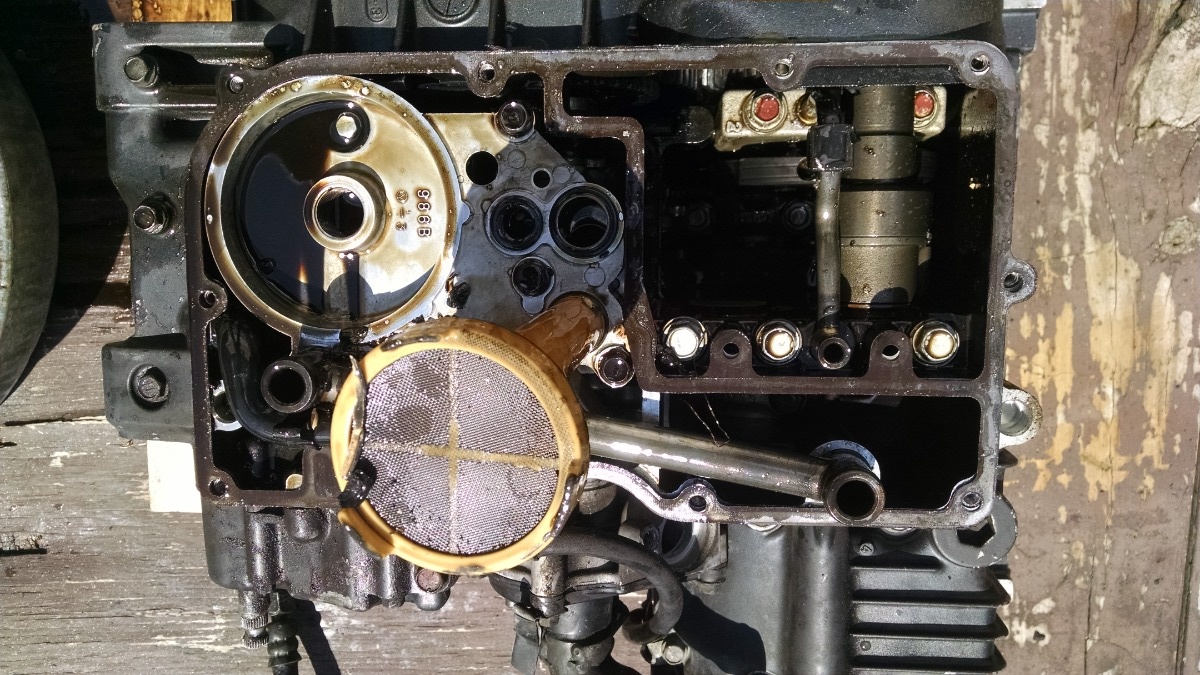

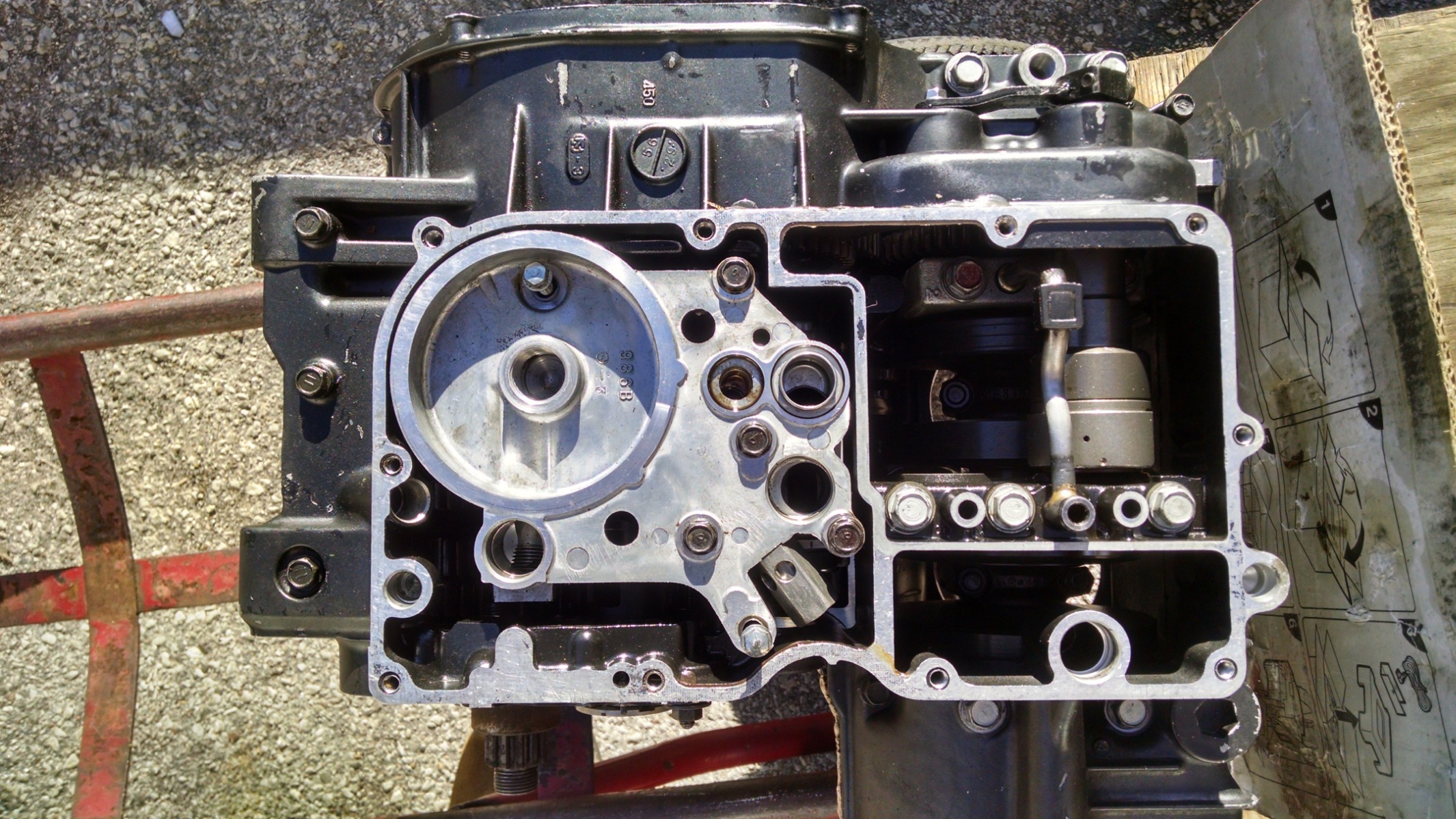

There must be 100 o-rings in these oil tubes, orifices and passages. Bottom view of the ZX oil pump / oil filter area with the pan removed. The #3 main bearing cap is pictured down inside the case with the J-tube still inserted in the feed hole. It is the one main bearing cap that does not attach to the lower case. It goes on before the lower case. this is also the main bearing that feeds the #3 and #4 rod bearings. I don't completely understand why the #3 rod shucks while the #4 rod lives on. Hmmm.
The oil pumps (plural) A gerotor pump is located on each end of the shaft that also drives the water pump on the drive end.

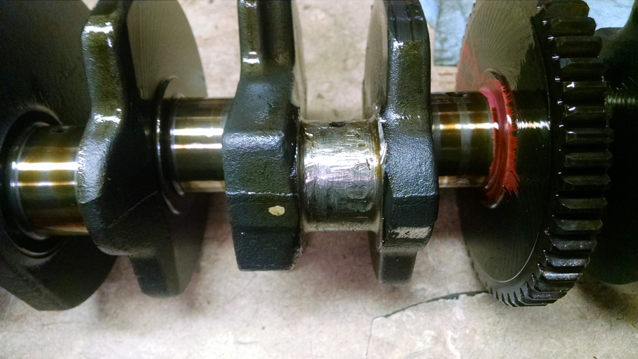

The crank from my ventilated engine. (has red paint on crank gear) #4 looks good in this motor too while #3 is totally screwed.
This is about the most beat up crank journal I have ever seen. It's no wonder the rod decided it no longer wanted to occupy the same space. OR, as they might say of it on a fleabay auction.. removed from a good running engine with a barely noticable "tick". :S
