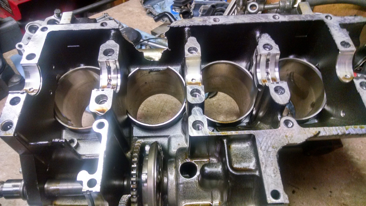

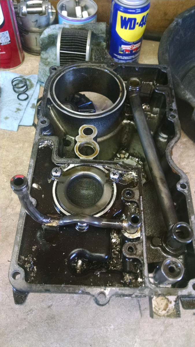

There is no way an engine running 26K miles might run that long. Pretty unlikely. The crank is cross-drilled at bearing through the same passage the #3 rod is lubed from. the oil feeds. The pressure regulator valve and indicator switch (sw not pictured) are located in the lower part of the first pic.
The lubrication schematic shows main journal #1&2 being fed from the short oil galley, while the 3&4 mains being fed from the "j" tube, both of which get their pressurized lube oil out from the "I" tube (LOTS of o-rings and places to leak internally.) The I tube also feeds the #4 rod through main bearing #4 oil passage. #5 main is fed direct from the pan P/R passage. in the pan. The oil pressure indicator switch and the pressure regulator valve are both located in the oil pan. The tubes act as oil passages external to the block casting if that makes any sense. The "I" tube originates at the out put of the oil filter. (both tubes pictured.)
Only #3 has catastrophic failure. The other bearings look barely broken in. Motor is totally contaminated with all kinds of chunks and goodies. The rod nuts look like they were spun off with a socket. I am finding loose fastener all over both motors. Alternator center bolt loose was the latest find.
The manual explains the reasoning on a lot of the functions.

Update! I am still disassembling the blown spare, cleaning and dissecting the lube oil system. There are soooo many little places and o-rings to leak internally it is uncanny. The oil squirting tube that sprays the transmission gears is a sloppy fit into the oil passage with a lame fitting o-ring on the end. One thing that jumps out at you upon disassembly and inspection is the mis-alignment of the #3 main bearing and the case oil passage.

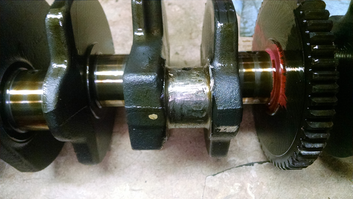

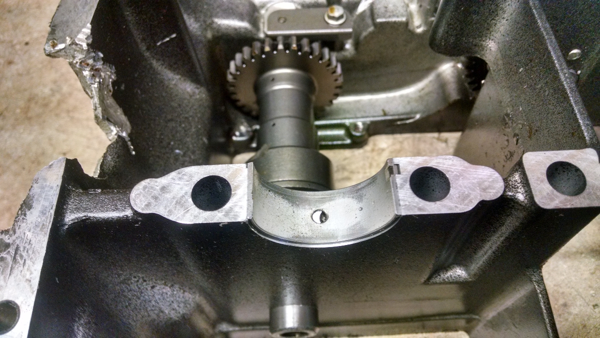

I think I was able to capture the cause and effect in one pic. A misaligned oil passage, and a hole in the case cause by lack of lubrication. (** Note all other bearings look great)
This particular passage lubed the #3 main bearing and #3 and #4 rod bearings.
#4 rod bearing looks fine, btw.

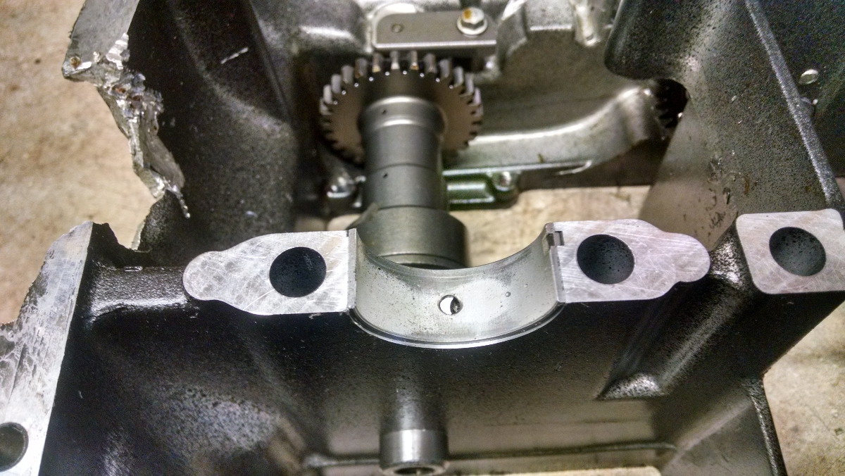

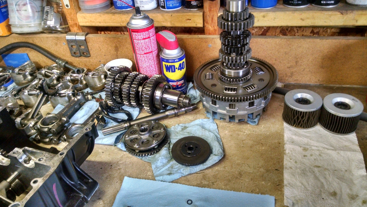

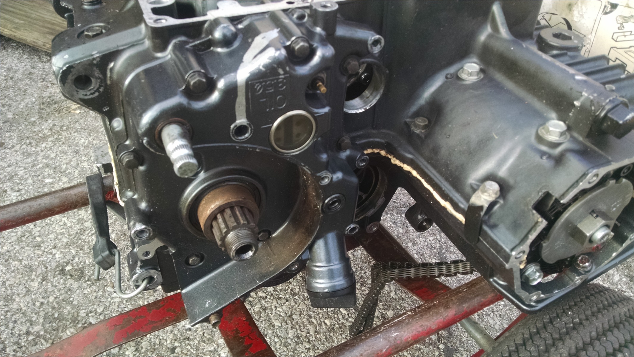

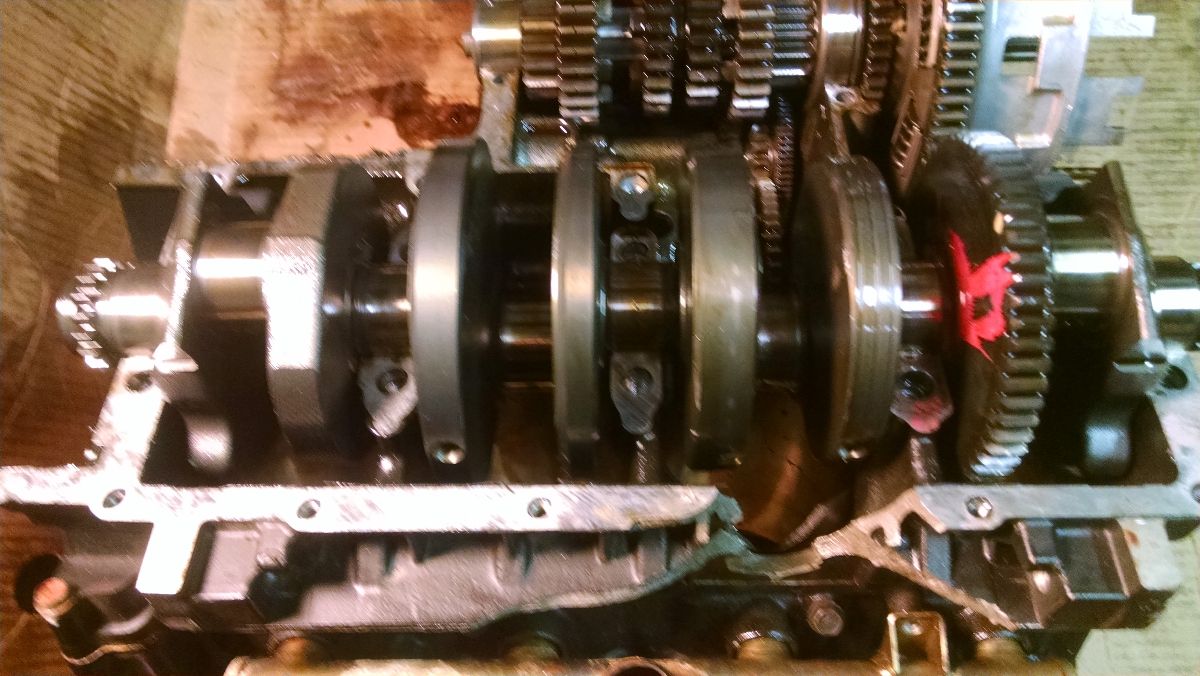

This is the clutch basket and 6 speed trans. There are 6 good pistons laying on the bench (taken yesterday) 3 good rods .The starter clutch is laying next to the alternator shaft.

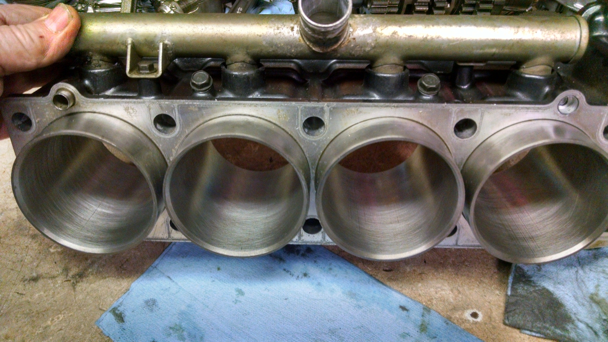

I hit the cylinders with my craftsman 3 stone hone. Very light de-glazing. I don't plan on buying pistons or boring anything. This is the economy build. The pistons feel good sliding in their holes. My instructor in college was all about knurling pistons to make them fit worn engine bores. This piston is too short to knurl. The bores look good with no noticeable ring wear at the top or the bottom. I do not want to remove any more metal. These sleeves look good, and the pistons good also. I've seen some screwed up engine bores run great. These holes look as good as >any< running engine has.
There was a time when the top ring ridge was so deep that you could not beat the pistons out of a ford motor. Everyone remembers the crank type ring ridge cutters? LOL
The donor engine has a broken sleeve in hole #3. The starter clutch is behind the broken sleeve.
I do want to get the original crank out to see how bad it is. It would be nice to find a local shop that can fix the cranks, but it seems that the nitriding is somewhat special.

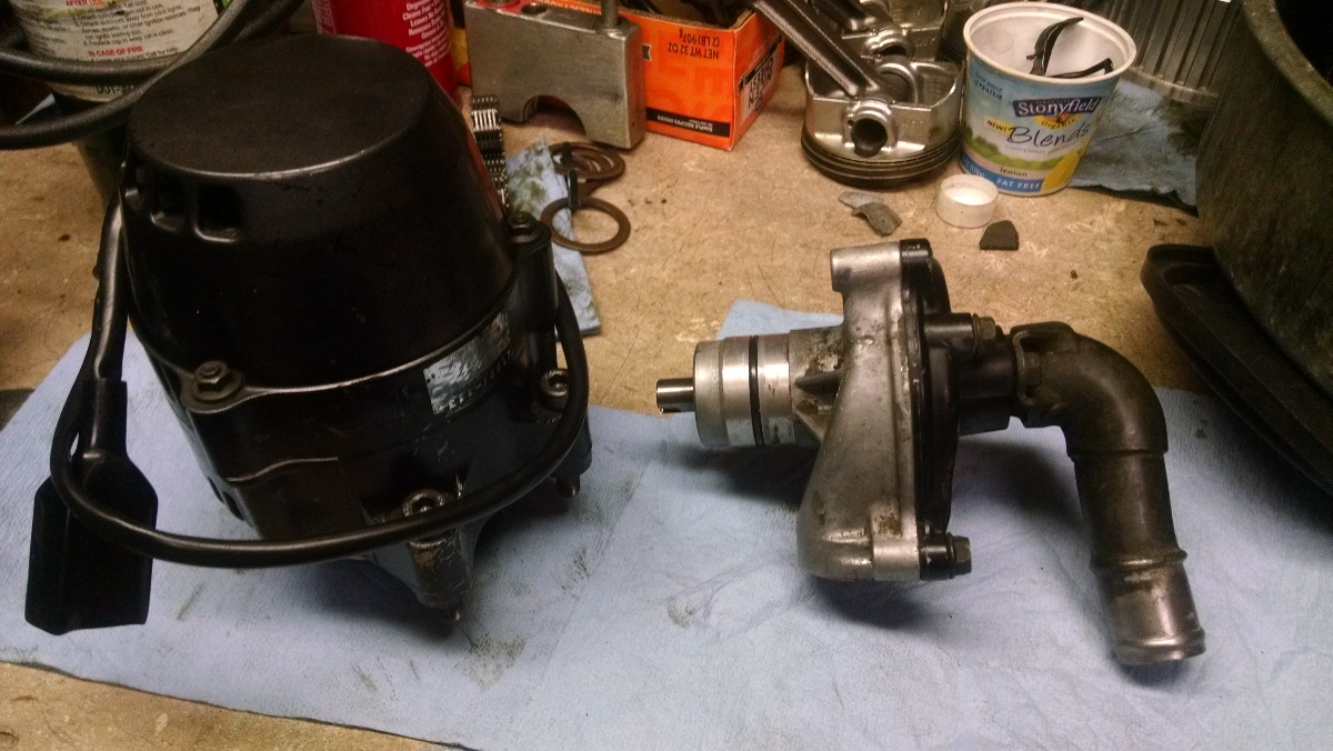

Zx1100 alternator and water pump.

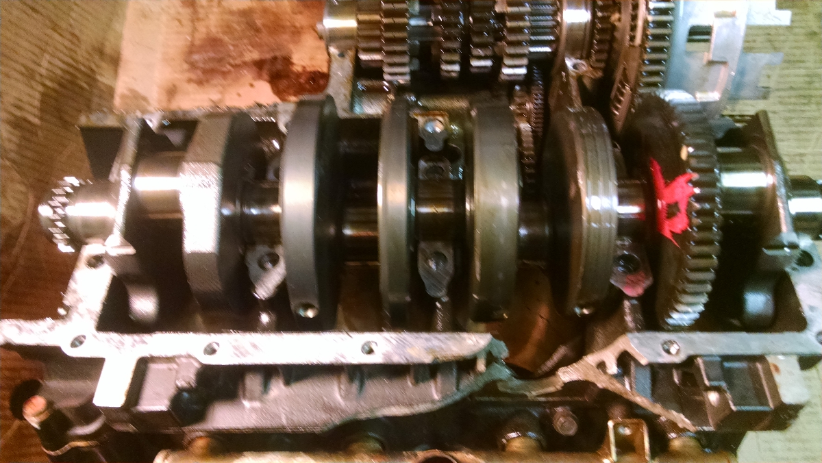

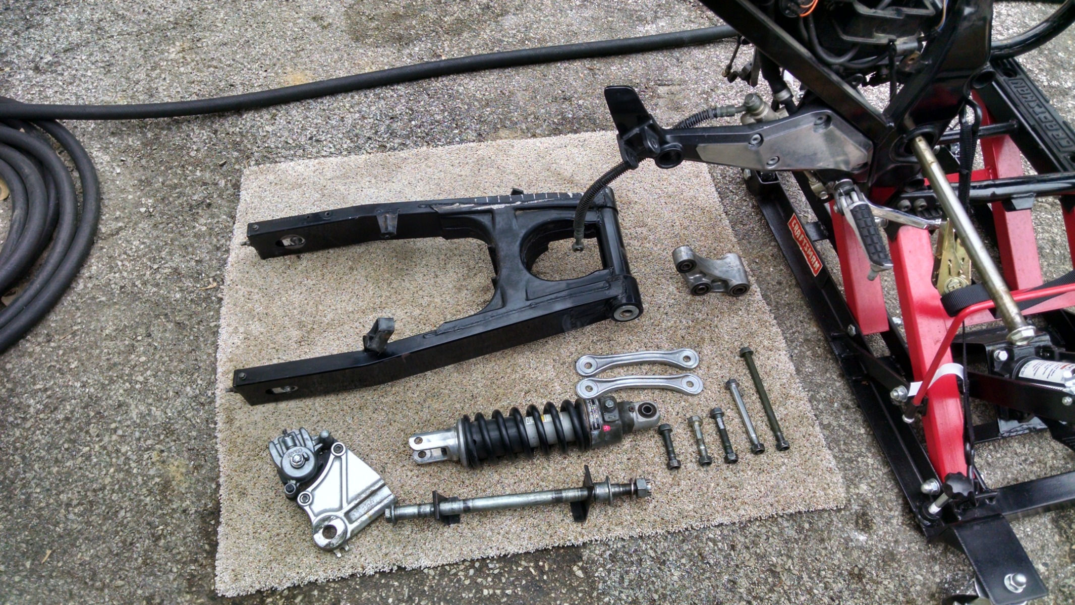

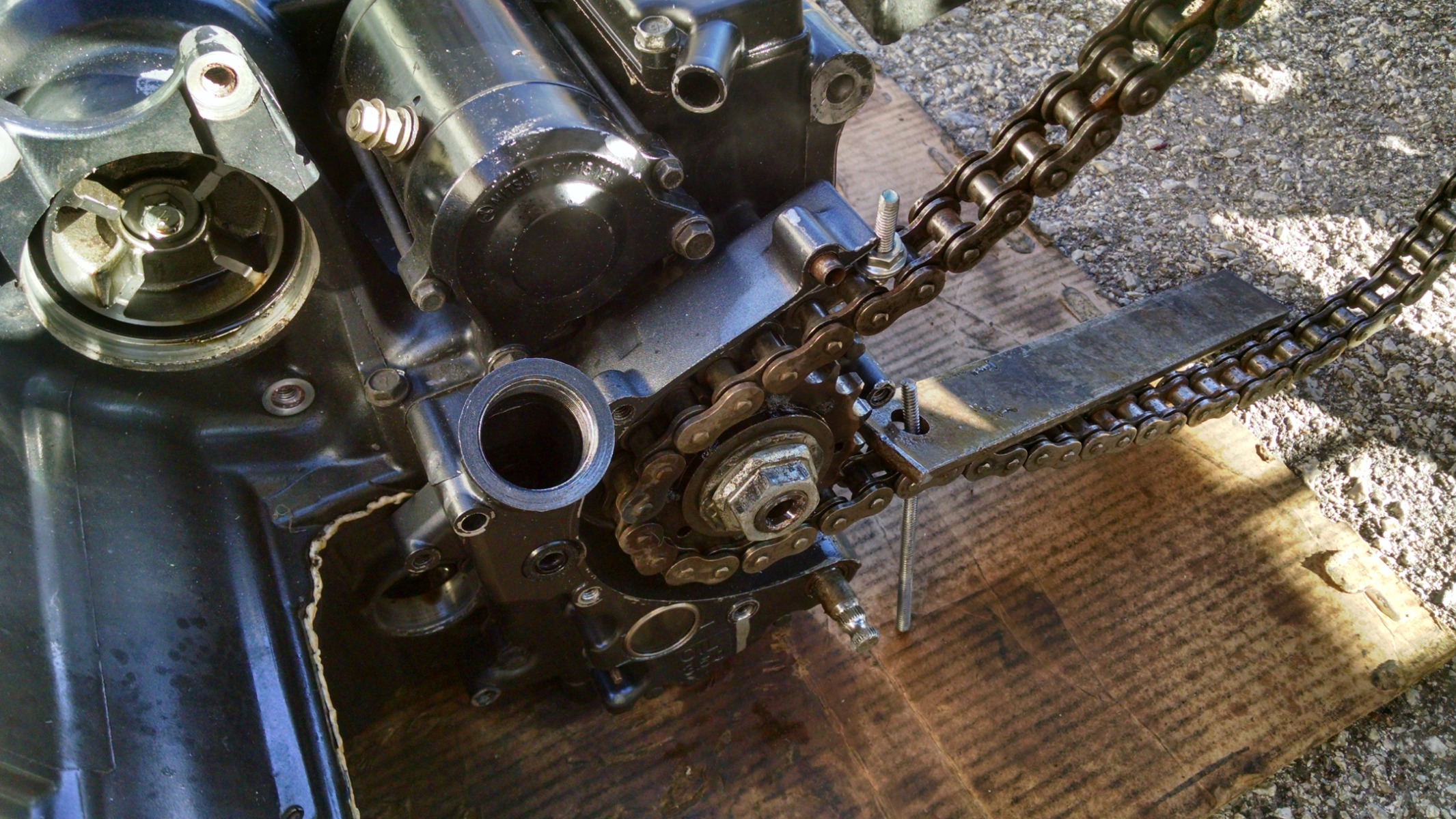

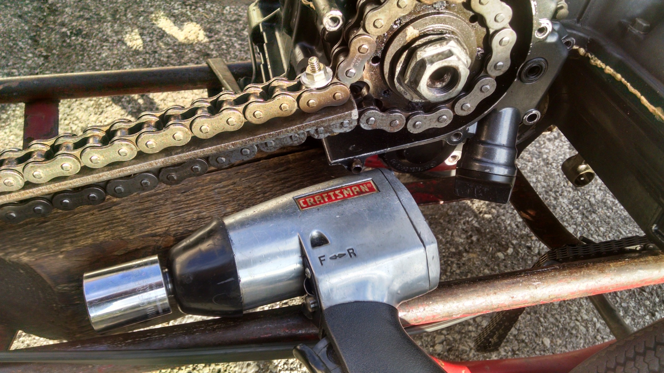

I finally got the counter-shaft sprocket nut off of the original engine so disassembly can resume. I ended up removing the uni-strut shock and swing arm assembly to remove the chain so that I could use the chain to hold the sprocket for removal. My 2 wheeler had to replicate the frame to hold the engine steady enough to get the nut off.
My Craftsman 1/2: impact wrench didn't seem to have enough oooomph to remove the nut until I went and bought some (grade
1/4" bolts to hold the chain together solid enough that the impact had something solid to hammer on. I let my compressor charge fully then shut off, shot WD into the impact air hose fitting until it was spitting oil out of the exhaust, then as the oil was spitting from the impact wrench exhaust port.. The nut zinged right off! (after bolting it solid). ZING!.. done deal. Yipee!
In getting the counter shaft sprocket off, I removed the swing-arm to get the chain off.. THEN, while I am cleaning it all up I notice the chain has a clip type master link so the swing-arm removal was not necessary. I did clean up all of the suspension hardware and reassembled it all so I could park the roller back in the carport. Not a total loss, All of those dirty, rusty parts needed some attention anyway.
Now I can resume disassembly. I am also having trouble getting the timing plate bolt off too. I am not certain if it is a LH thread or not, and have not found it in the service manual so far. The part description does not mention LH threads so I am assuming it is standard RH threads and just stuck hard. The sprocket nut is RH threads.

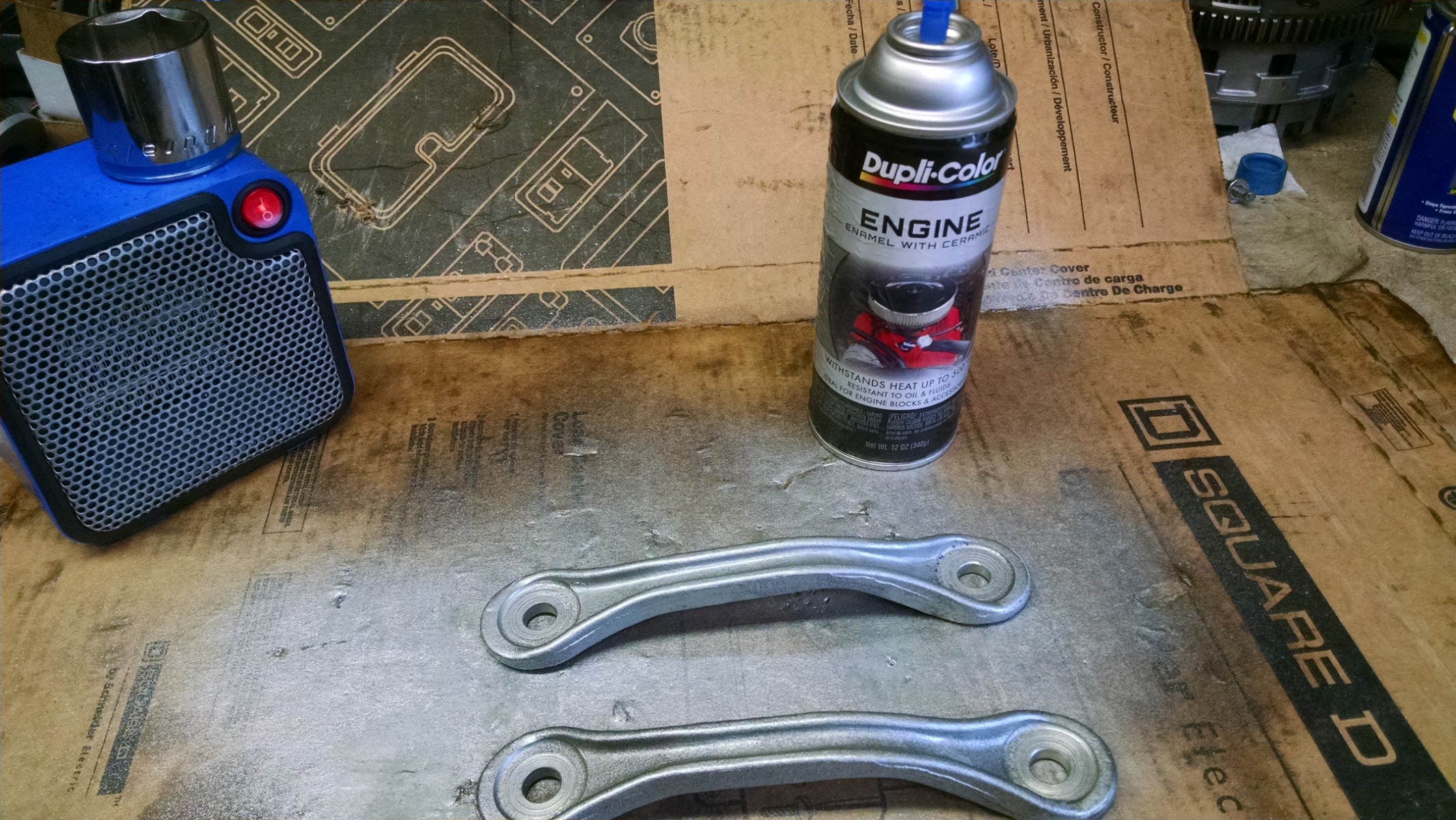

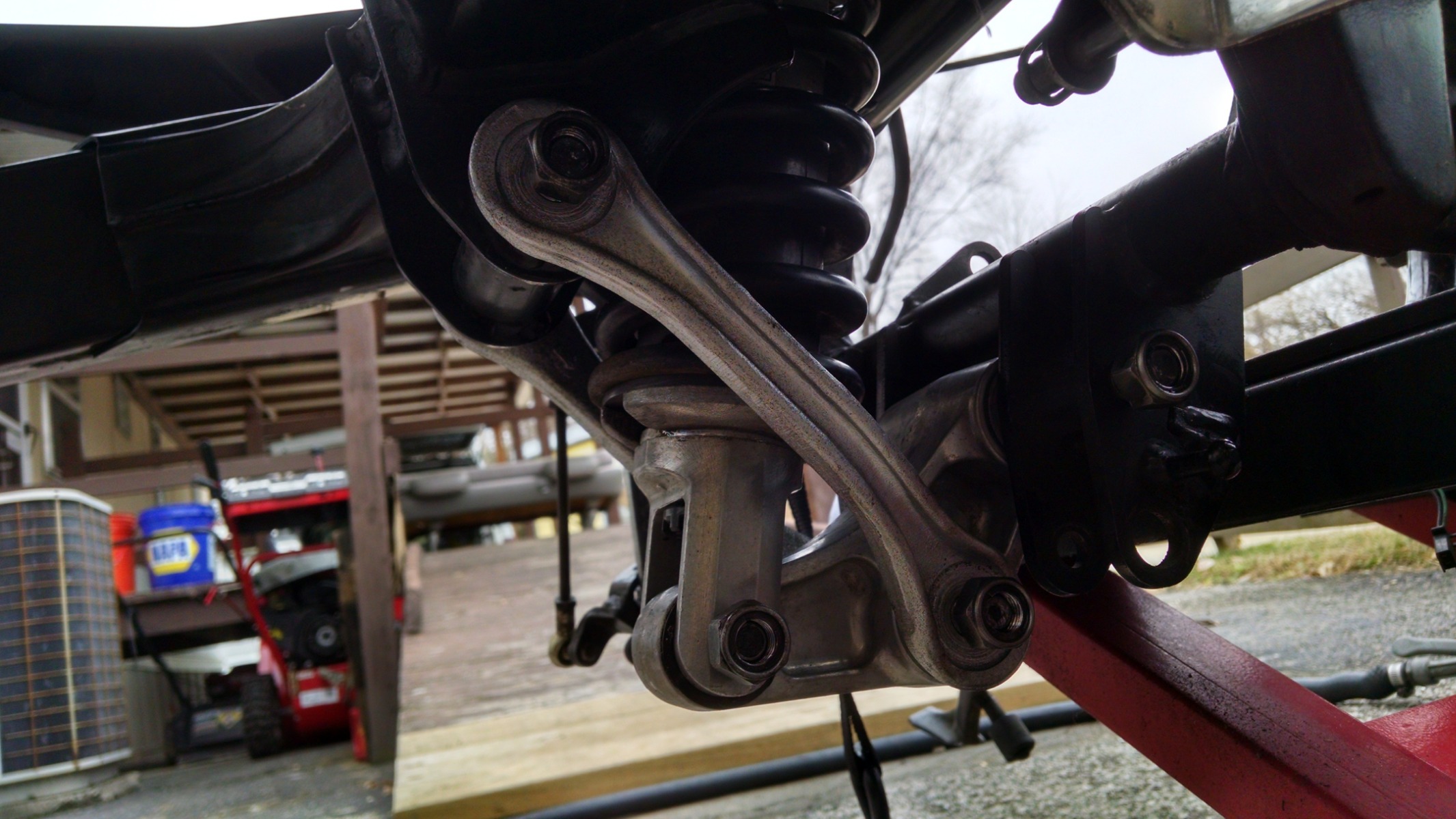

Painting / cleaning the shock linkage. The little 250 watt heater aids in paint drying on chilly days while keeping the shed at somewhat tolerable temps in the winter.

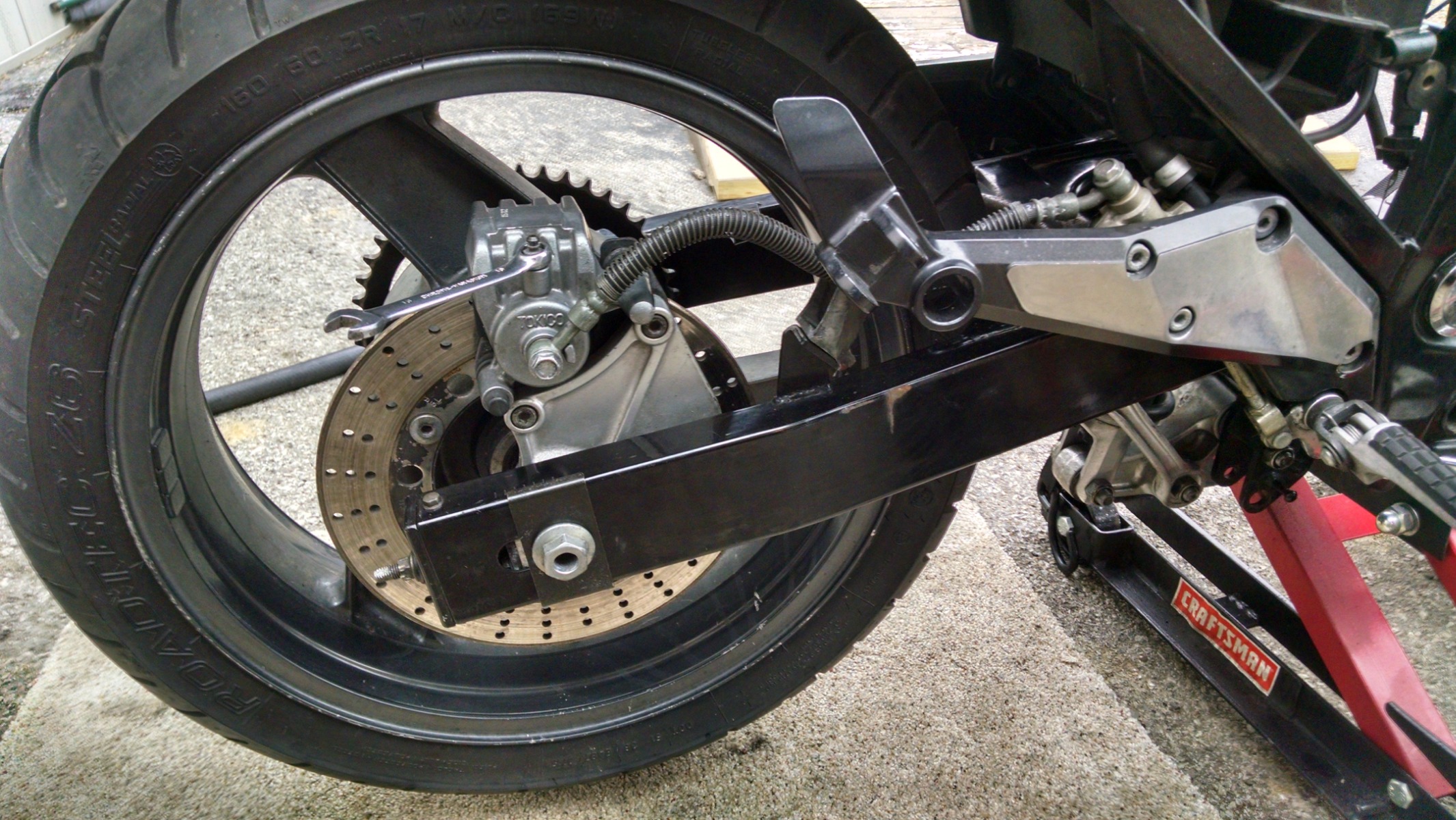

I bled the rear caliper mainly to flush some fresh fluid through the rear brake hydraulics. Fast bikes (and cars) need good brakes. The Metzler rear tire looks almost new, not so much for the front tire.

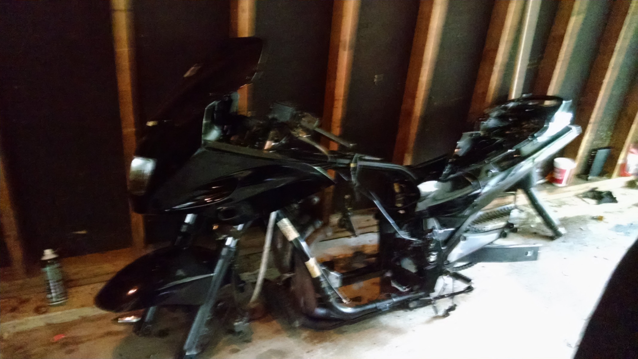

This is the "dragger" Zx1100 in question. I picked this up off the garage floor and shoved it into my van.
