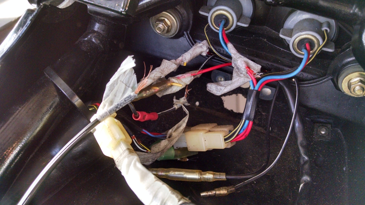

Check out the wiring this guy did to hook up LED's under the rear fender and faring. He really is a brain surgeon, using medical supplies on the electrical connections.

My zx 7 must have been wired by the same guy :evil:
