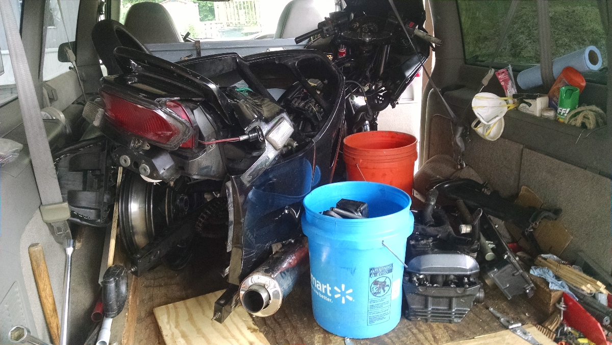

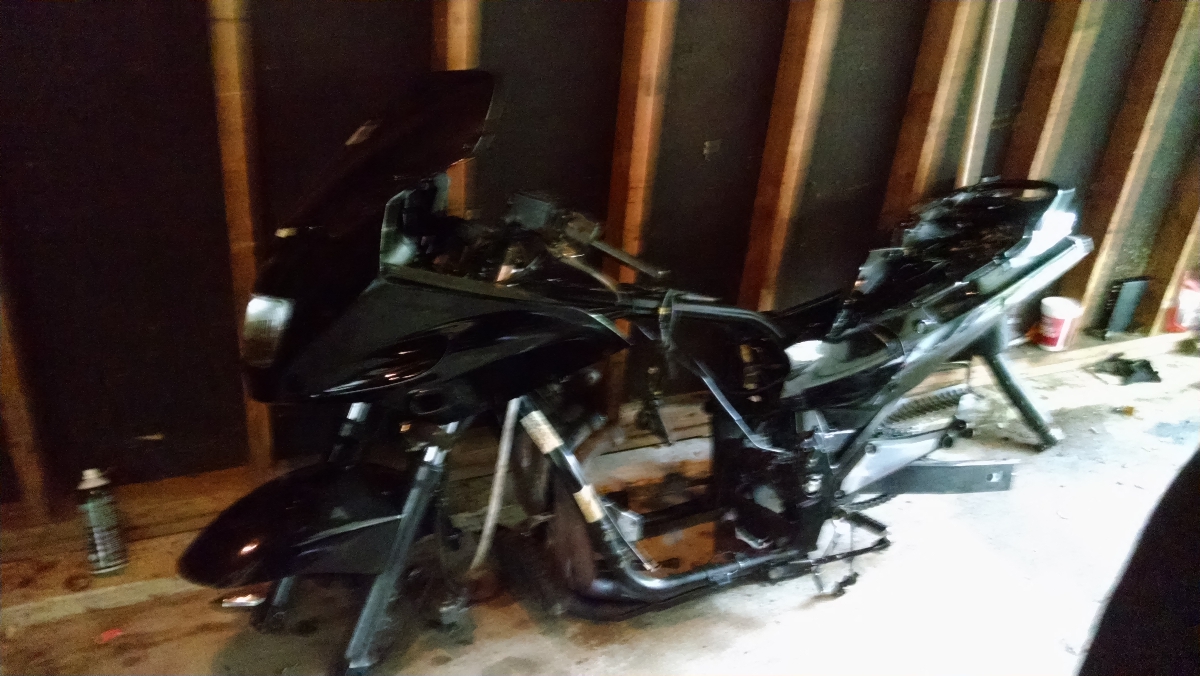

My trolling the local CL motorcycle parts section popped with another Kawasaki muscle bike rescue this week. This is a 1996 GPz1100 water cooled monster. Rated at 129hp on the web sites I hit. I need a owners and service manual. A total basket case in the true meaning of the word. I was literally picking up parts and fasteners that were scattered all over this guy's garage floor. I did try to show up prepared by taking my 2 wheeler and a few empty 5 gal buckets, shop towels and citrus hand cleaner, but this genius had already scattered the engine, He had even dismounted the tires from the rims. BUT, I was thoroughly amazed that this guy had a clean MO title >in his name< AND a key that fits all 3 locks. The title is already applied for. He had been advertising this for about a month for parts.. he had 4 pictures of the tires he pried off of the rims and one vague pic of the empty frame sitting on the floor.. Had this rocket surgeon posted some better pics, and left the bike unmolested, it would have sold faster and for more money... his loss, I hope is my gain. We shall see.
He said he did not check the oil for quite some time.. Kinda lame excuse considering checking the oil is just a quick LOOK.. sight glass under the sprocket cover. It has one rod bearing shucked hard. and up and down movement can be felt checking it by hand.. He took all of this stuff apart with no idea how to fix this engine while scattering the entire bike. duh.

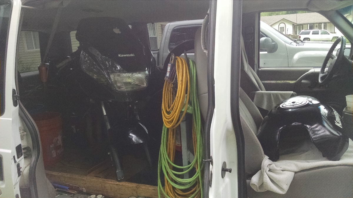

It was a truck load to bring home. The first thing I did was remount the tires so I didn't have to drag it around on the exhaust and oil cooler lines.:S He didn't remove the exhaust or anything else, just let it hang.. smh
It is missing 8 out of 10 head bolts, He unbolted on front caliper so he could get the wheel off and those bolts are nowhere to be found in the pile of parts that I bought.
AND, I noticed on the chain adjusters that a channel lock and slip jaw pliers is his favorite tool. I am thrashed after cleaning up all of these parts and dragging this derelict old muscle bike home. At least I found all of the cam caps for that line bored head, and I do seem to have most of the parts. I will try to call him later after I sort more things out and ask him about some of the missing fasteners. I retrieved all of the axles and spacers out of the mess.
I will be pressure washing the frame and parts / head / block etc. It has 26K miles on the clock. He scratched the rims pretty good. It looks like he used a screwdriver instead of tire tools. I will get more pics of the roller frame tomorrow in the daylight.

One of my favorite bikes. Thanks for saving it. That bad rod bearing may be the result of a crash, and the resulting oil starvation from running on its side.
I am looking forward to this resurrection.

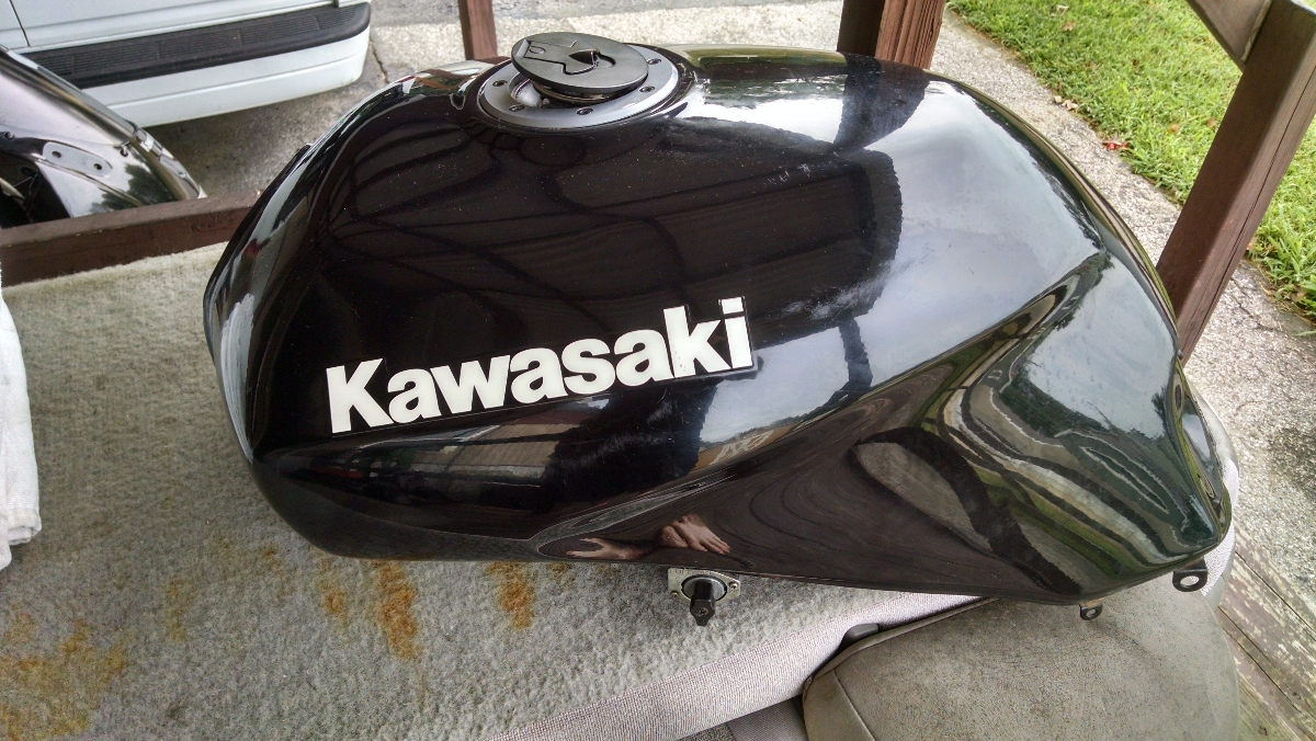

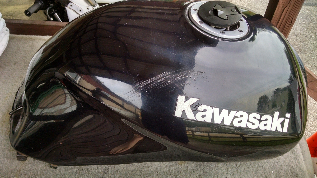

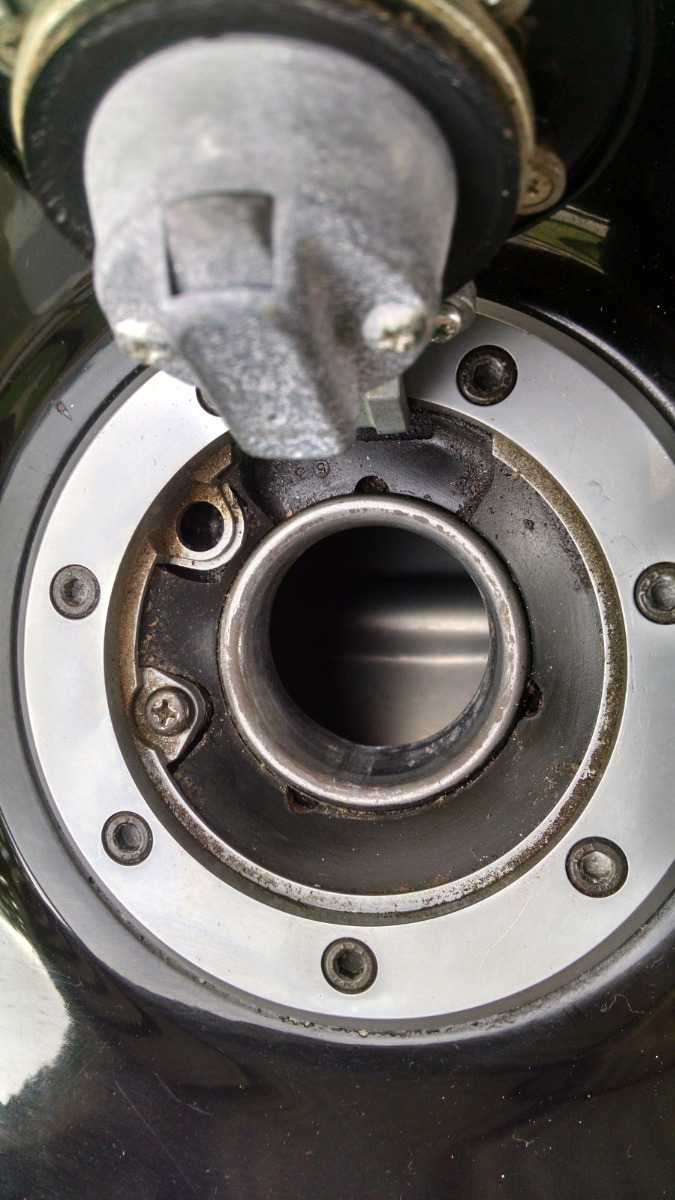

The tank looks clean inside so it's looking like the carbs should be usable as is. That's great considering all of the other things that DO need attention.
Only a little garage rash.

Nice score . Looks like you will be busy for a bit . The dings on the clutch is probably from the starter chain tensioner . Its a known issue on these motors . My zrx has the same issue . Heres the fix when you get that far .

Old _kaw, are you a member of ZRXOA? If not, you may want to sign up. The starter chain tensioner is a known problem on those engines, and its failure can be catastrophic. The ZRXOA forum has a mountain of information about that engine family, and a bunch of really helpful members.
