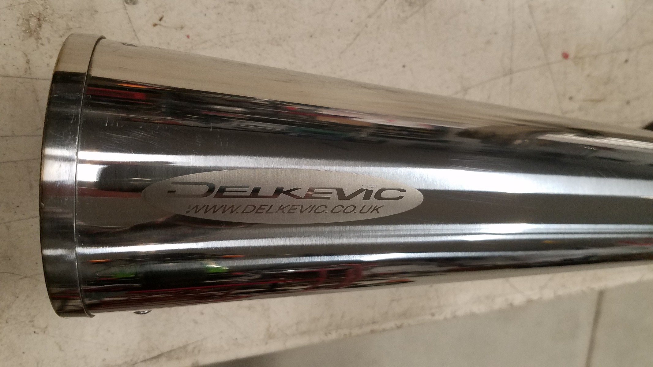

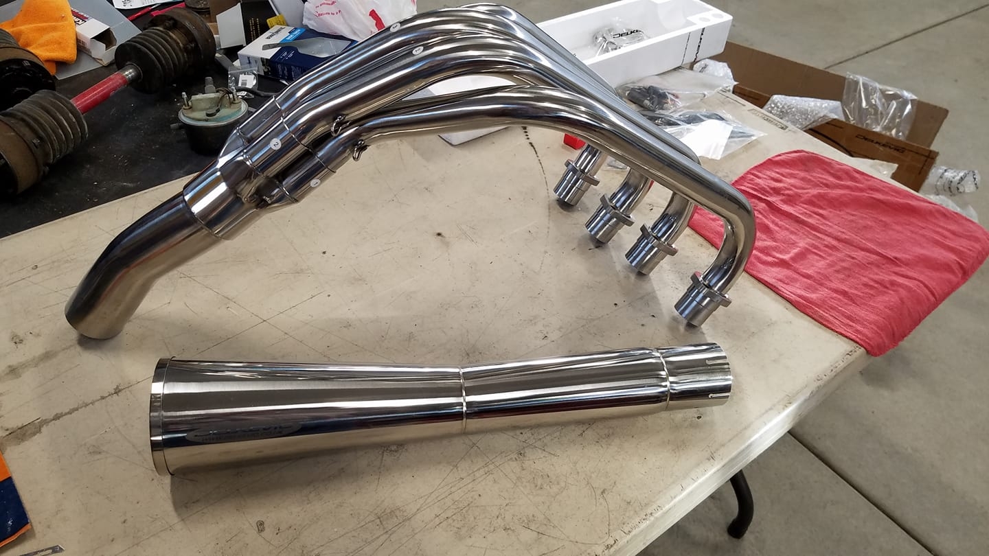

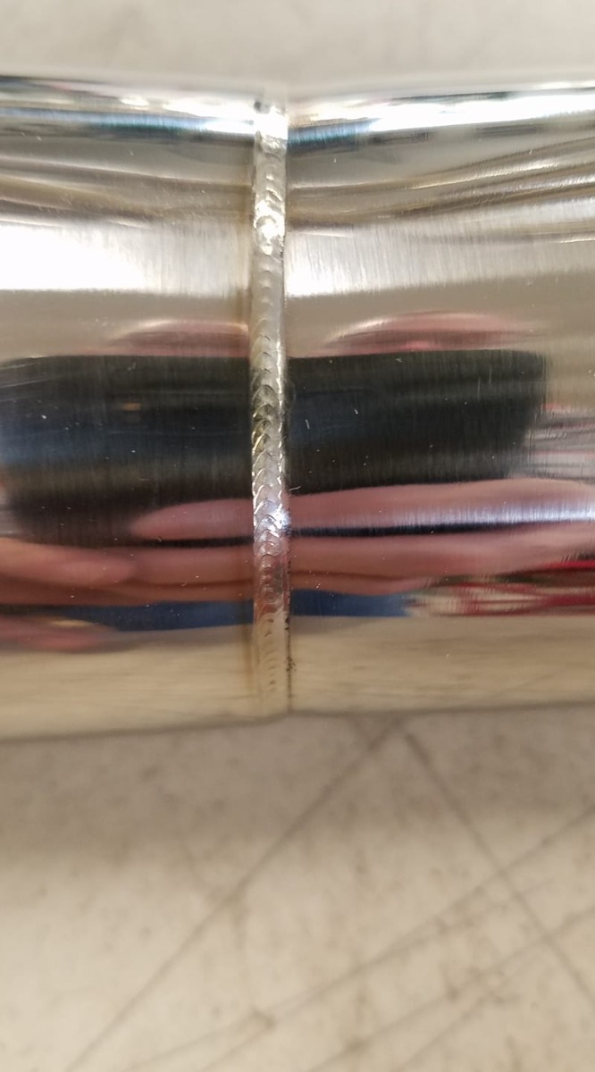

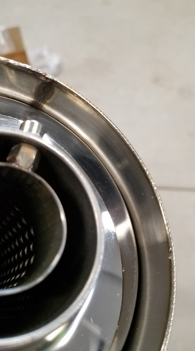

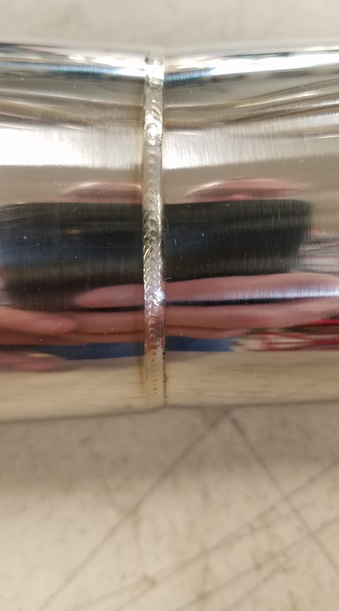

I finally got around to unwrapping my Delkevic header. I am pretty impressed with the quality of manufacture, and the welding looks top notch. Most likely robotic from the extreme consistency. The company I worked for had a Panasonic robotic welder, but it was a MIG. I'm getting excited to see this exhaust on the bike!

15 Jan 2021 17:28Skidmark wrote: I finally got around to unwrapping my Delkevic header. I am pretty impressed with the quality of manufacture, and the welding looks top notch. Most likely robotic from the extreme consistency. The company I worked for had a Panasonic robotic welder, but it was a MIG. I'm getting excited to see this exhaust on the bike!
I’d be excited too. That thing is nice. I bet it will look great installed

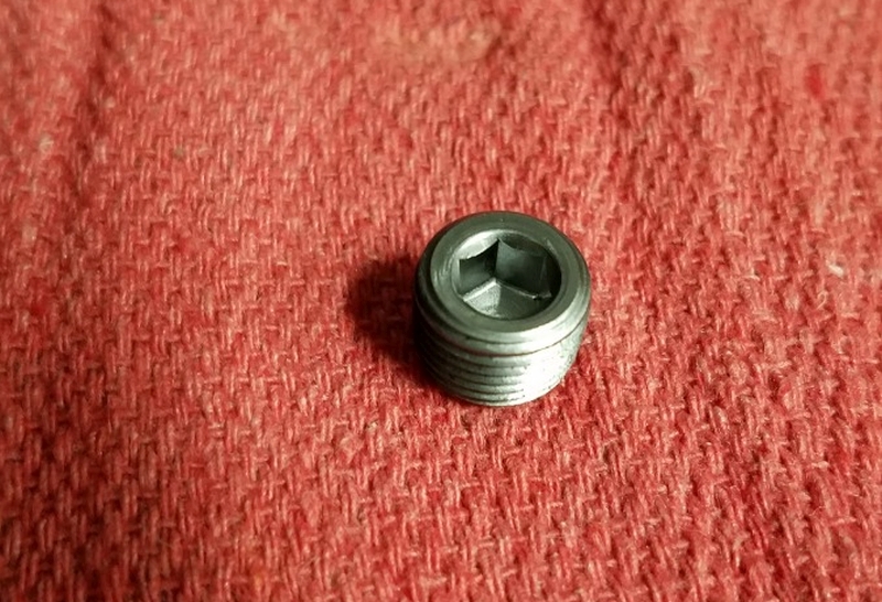

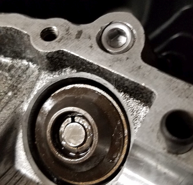

I am using a 1/8-27 NPT plugs to block the fresh air ports in the head. The holes the factory drilled into the head are the exact size for this thread, which meant no drilling.

15 Jan 2021 18:33I’d be excited too. That thing is nice. I bet it will look great installed[/quote]
I am hoping for an upswing more than parallel to the road. If it mounts too parallel to the road I may modify it and have it welded at the angle I like.

I'm sure you'll love it. I'm very happy with mine. Shouldn't be anywhere near parallel to the road if it's anything like mine. Clears above the rear axle.

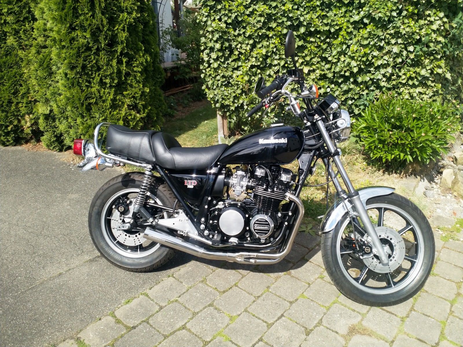

- calum
- Posts: 1148
- Thanks: 415
Re: Saving a '81 KZ750-E
16 Jan 2021 02:39

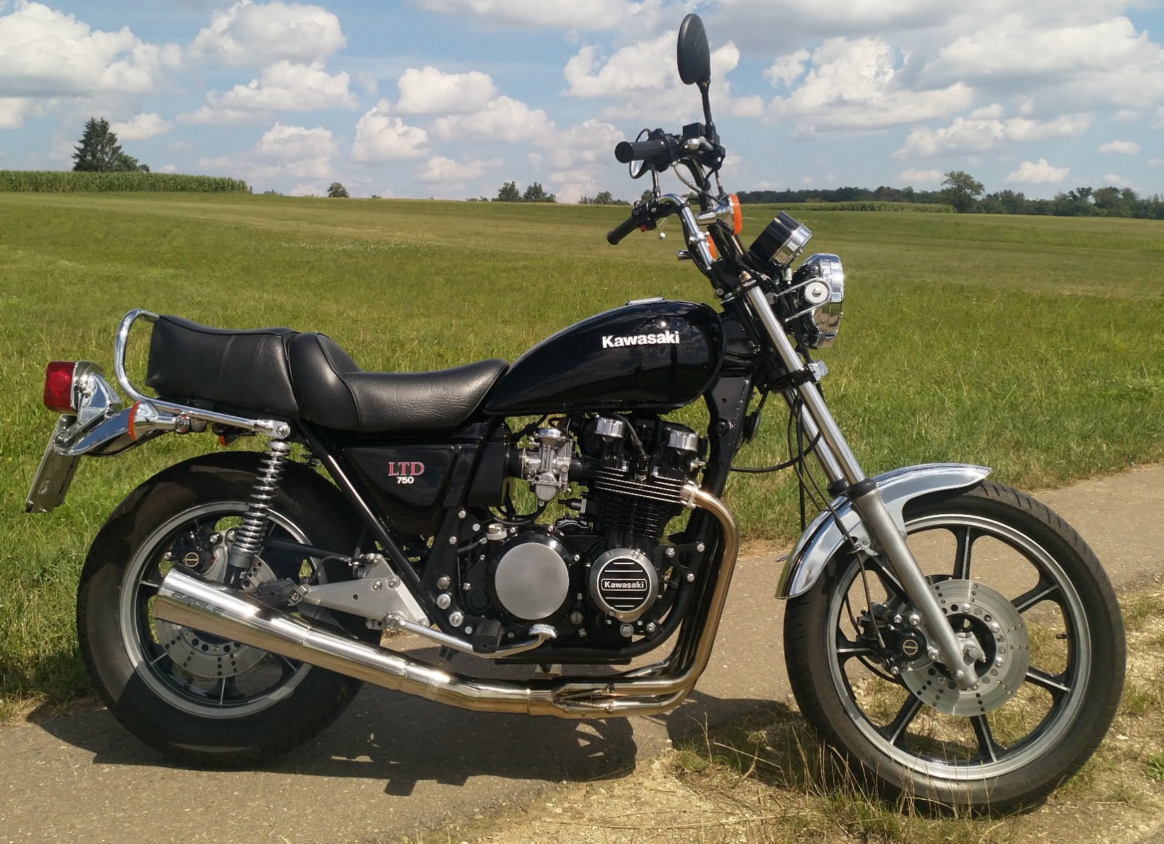

This is what it looks like mounted to the stock footrest brackets. There's a bit of leway to mount it higher, but not much or the pipes won't seal at the head.

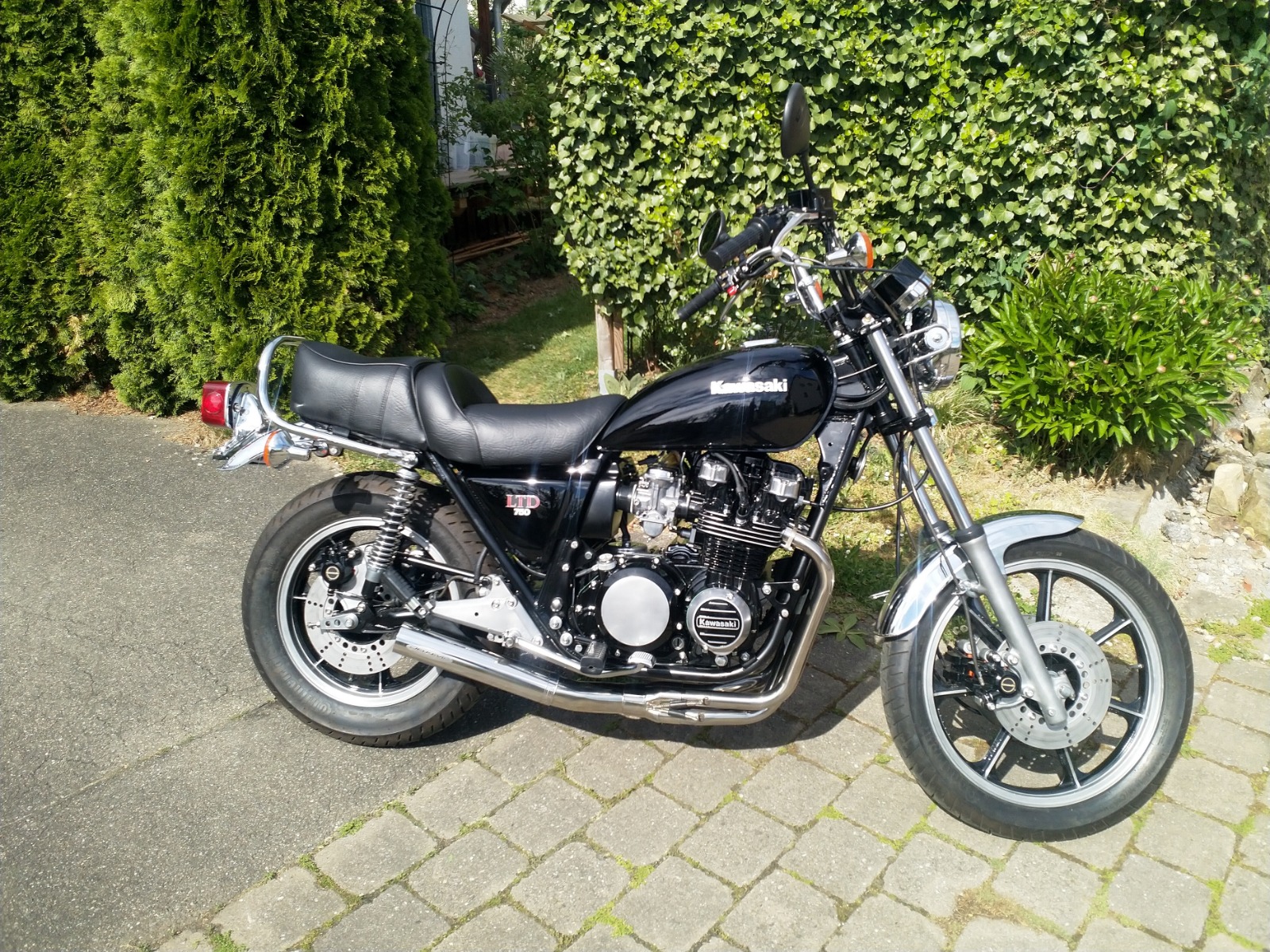

- calum
- Posts: 1148
- Thanks: 415
16 Jan 2021 02:43
