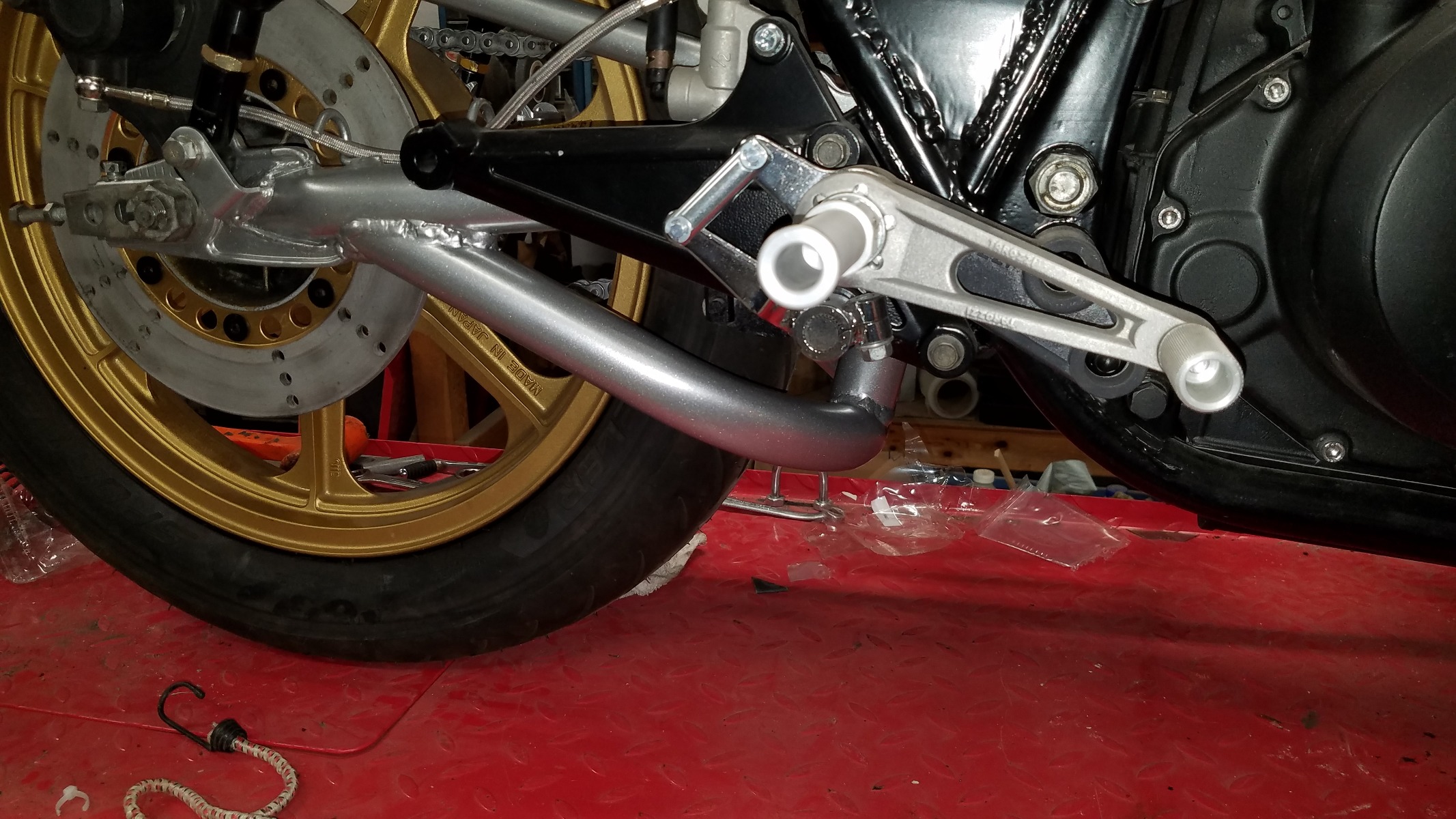

10 Jan 2021 18:09calum wrote: Loads of space!
I imagine you can hardly see the change to the swingarm from the side. Nice work.
It seems to blend better than I expected, for being asymetrical and all.

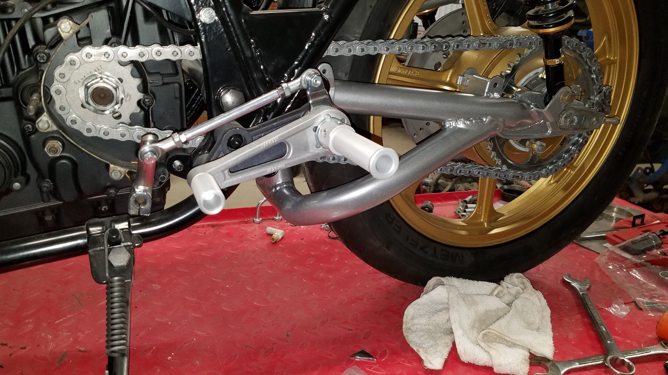

12 Jan 2021 17:08
Tinkered on the bike for a while today, but it all seems to be "invisible" work. No real changes in appearance. I cut my chain to length, and riveted the master link on. Adjusted the chain tension and torqued the rear axle. Finished with all of the engine mount bolts - a couple had to be hand ground since the same size bolts I could only find with bigger hex heads. All of the motor mounts are torqued now. Filled and bled the rear brakes, and torqued the counter shaft sprocket nut. Sometimes you can tinker for hours and step back and say you got a lot done, but none of it shows!
