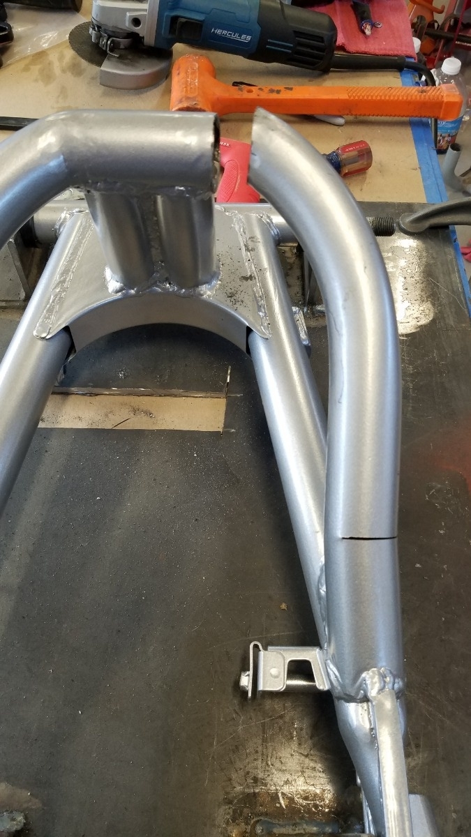

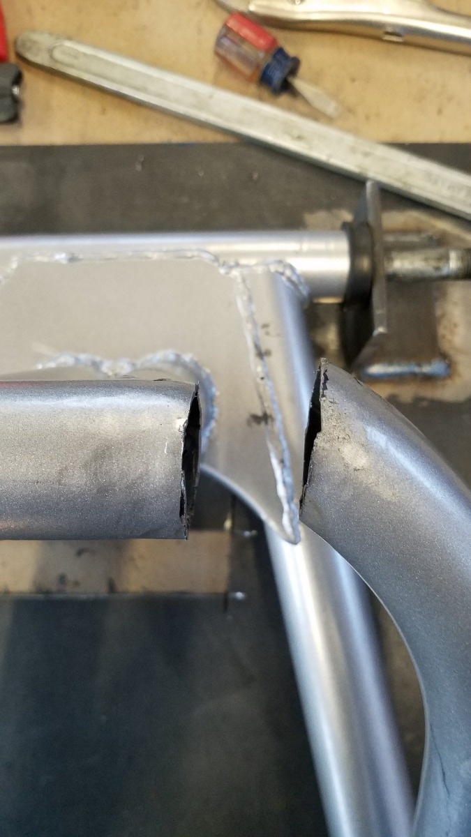

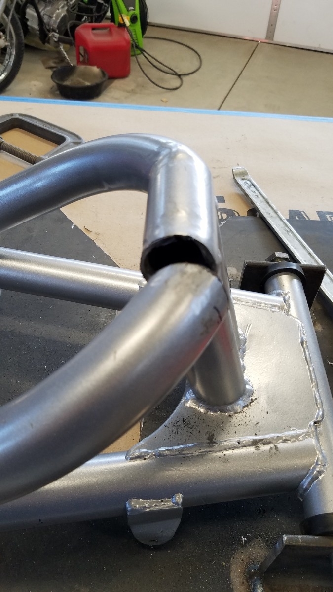

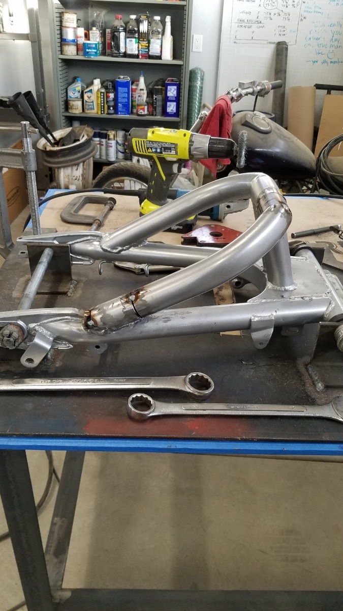

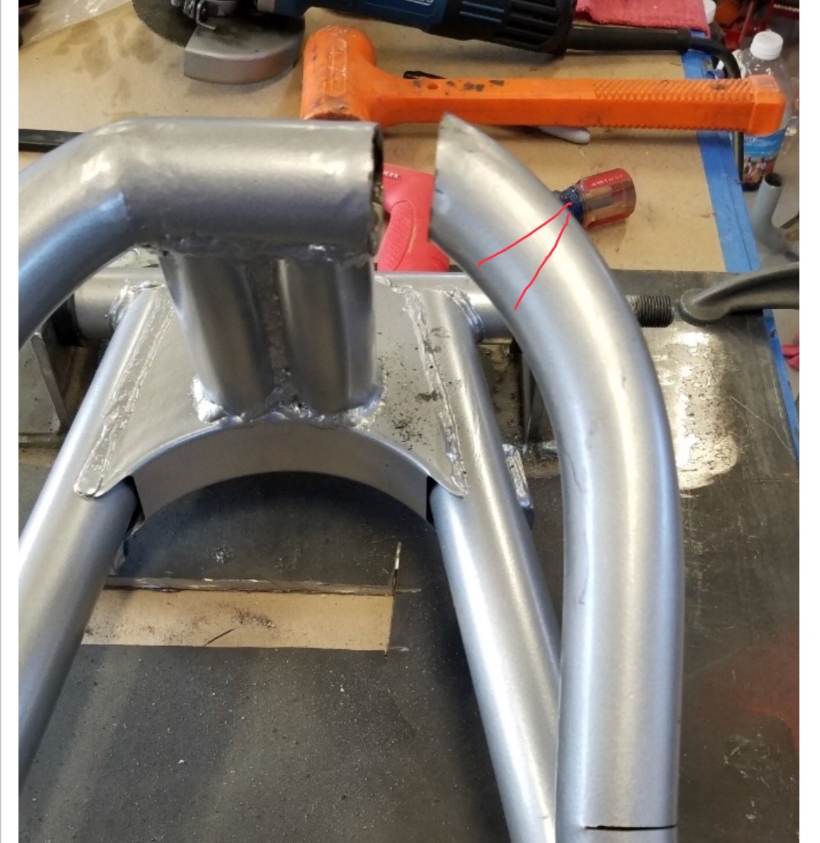

Starting the repair on my swing arm brace. Ending up with some misalignment, so I am not sure how well it will turn out. It will be tacked and reassembled to ensure there isn't any chain contact prior to full welding.

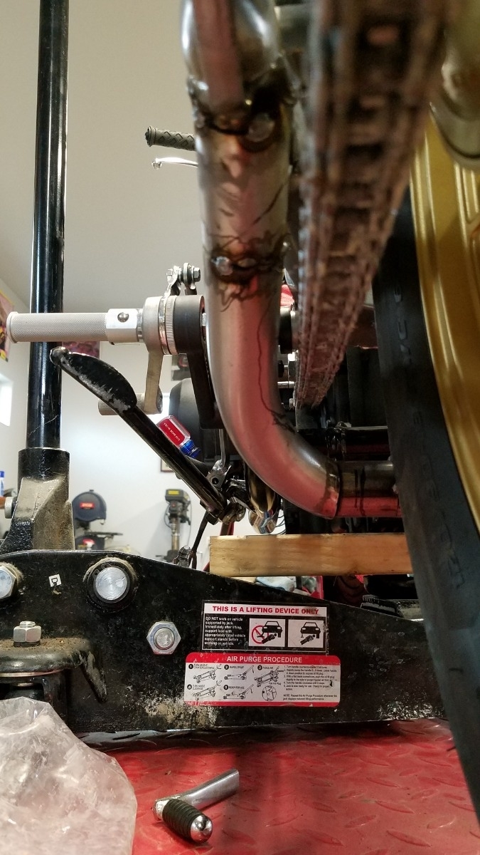

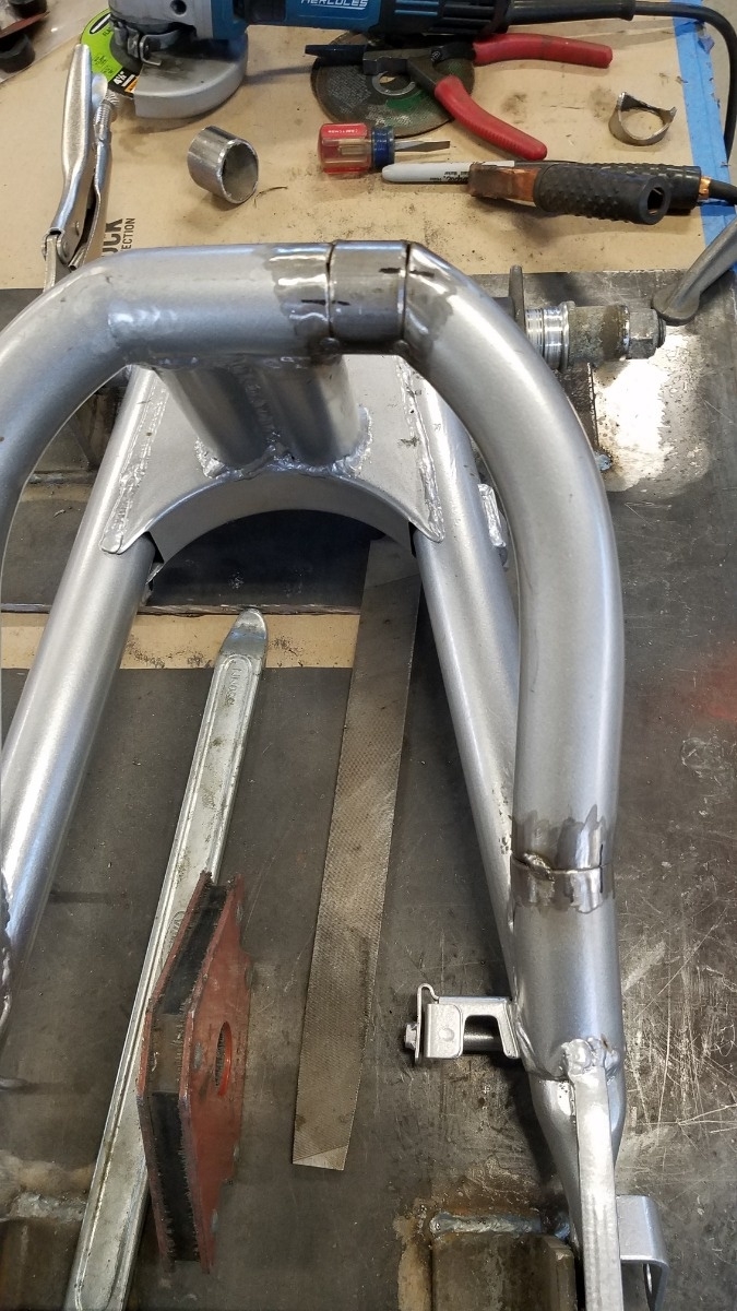

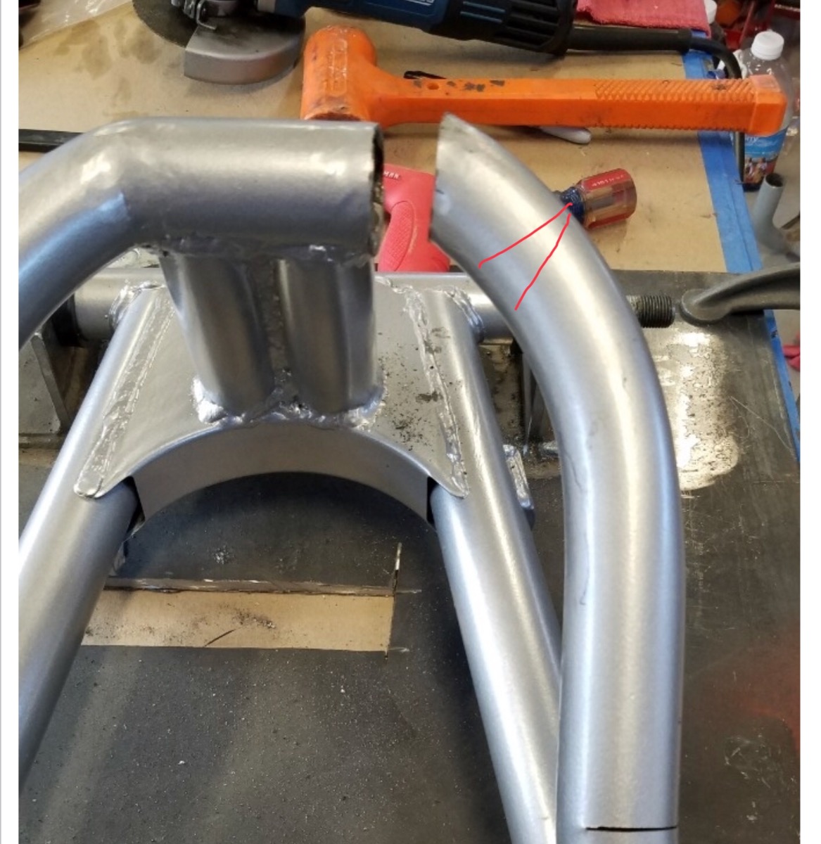

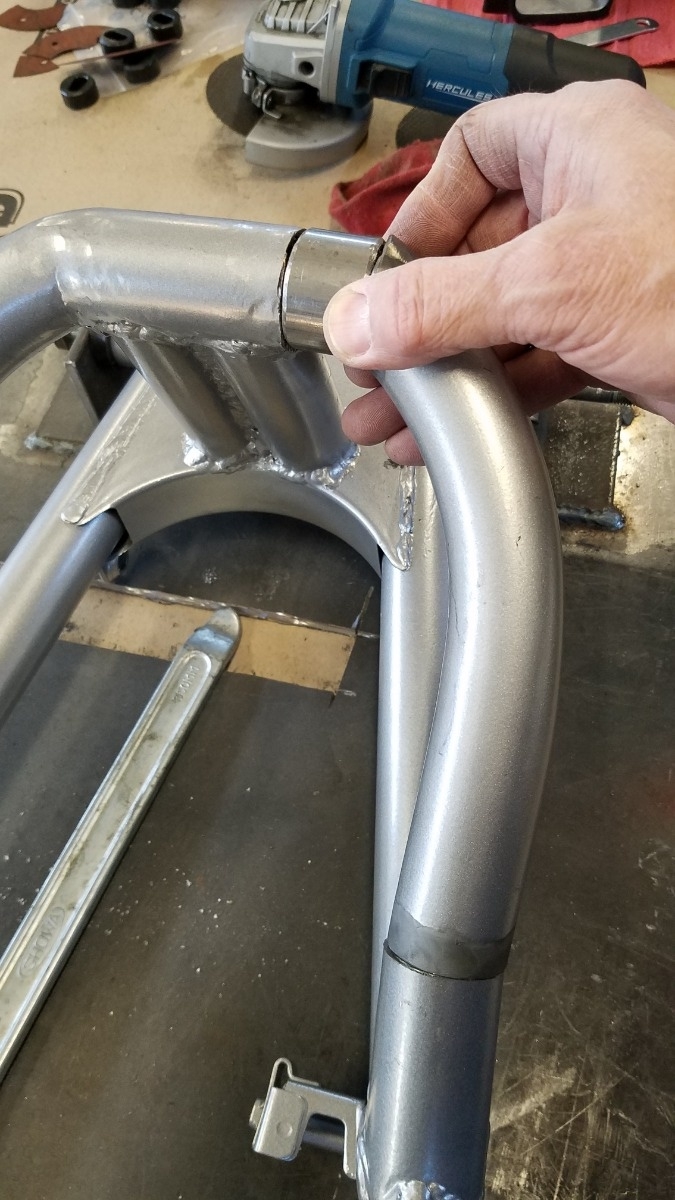

Time to pull it out of the fixture and reassemble. Fingers crossed!
Mikaw - I already had it cut all the way out when I saw your suggestion.

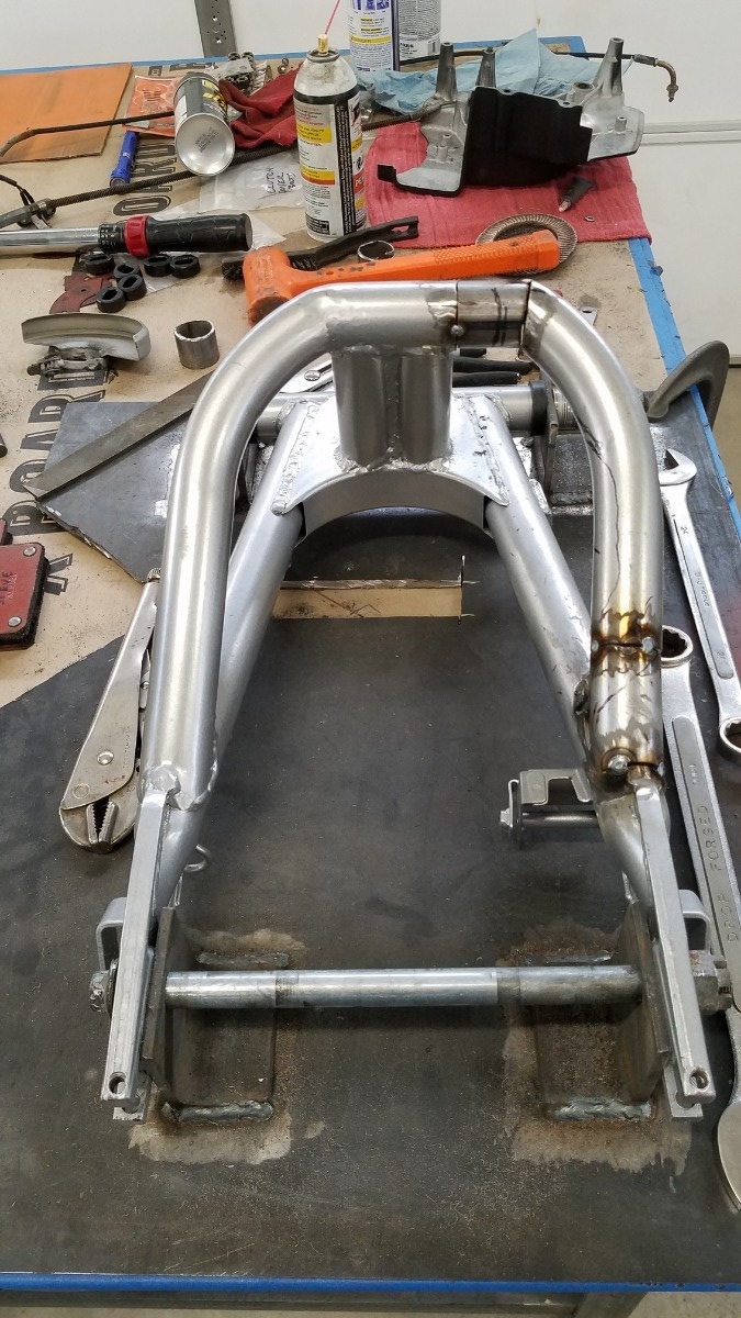

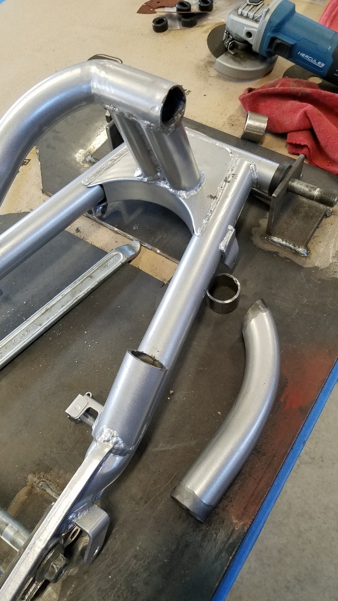

Definitely better, but still not enough room. Looks like I will need to take a section out of the tube wall and weld a plate back in to create enough space. Since this is the slack portion it has to have room to move around.

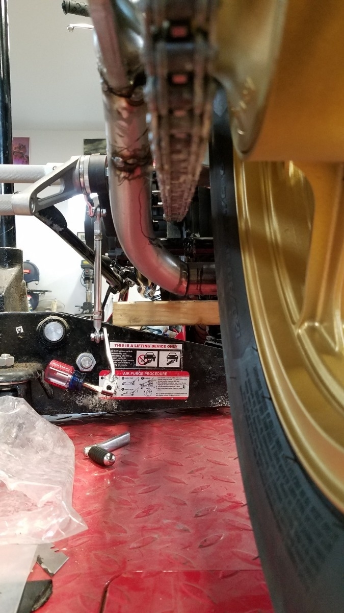

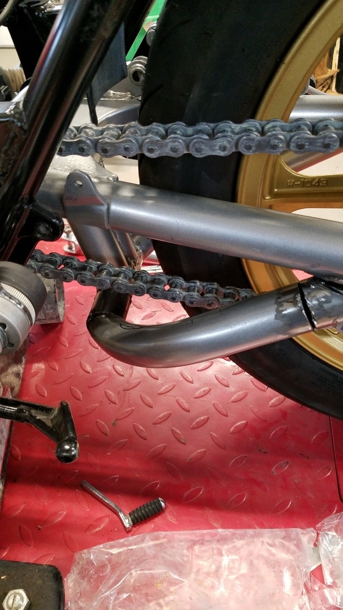

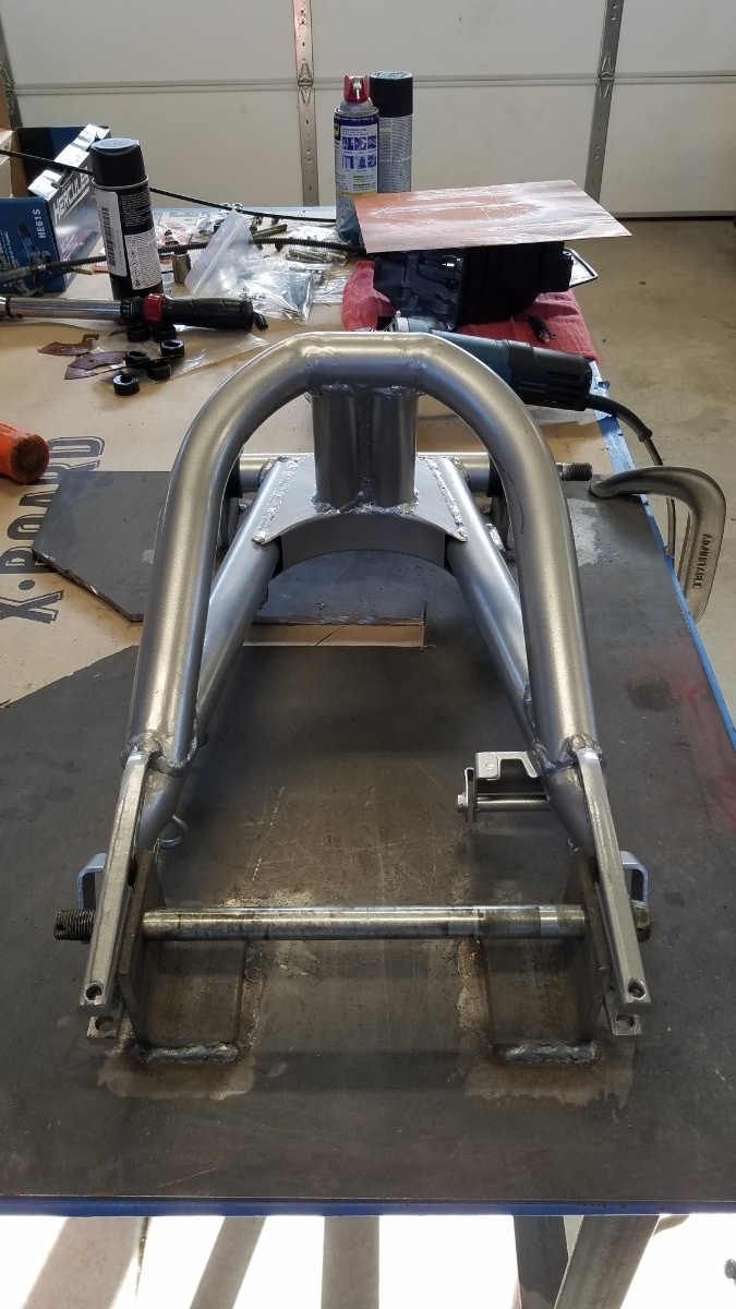

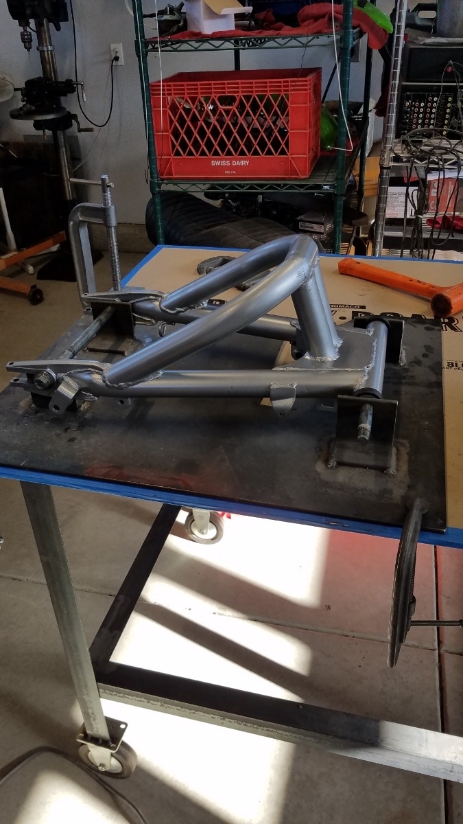

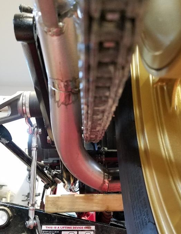

I have been cutting, grinding, and tack welding attempt #3. As soon as it's cool I will reassemble and recheck the chain clearance. Looks good from the side, not so much from the bottom or rear. Waiting to see it on the bike before anything is final.

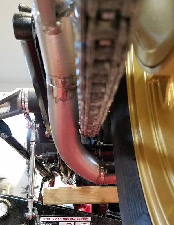

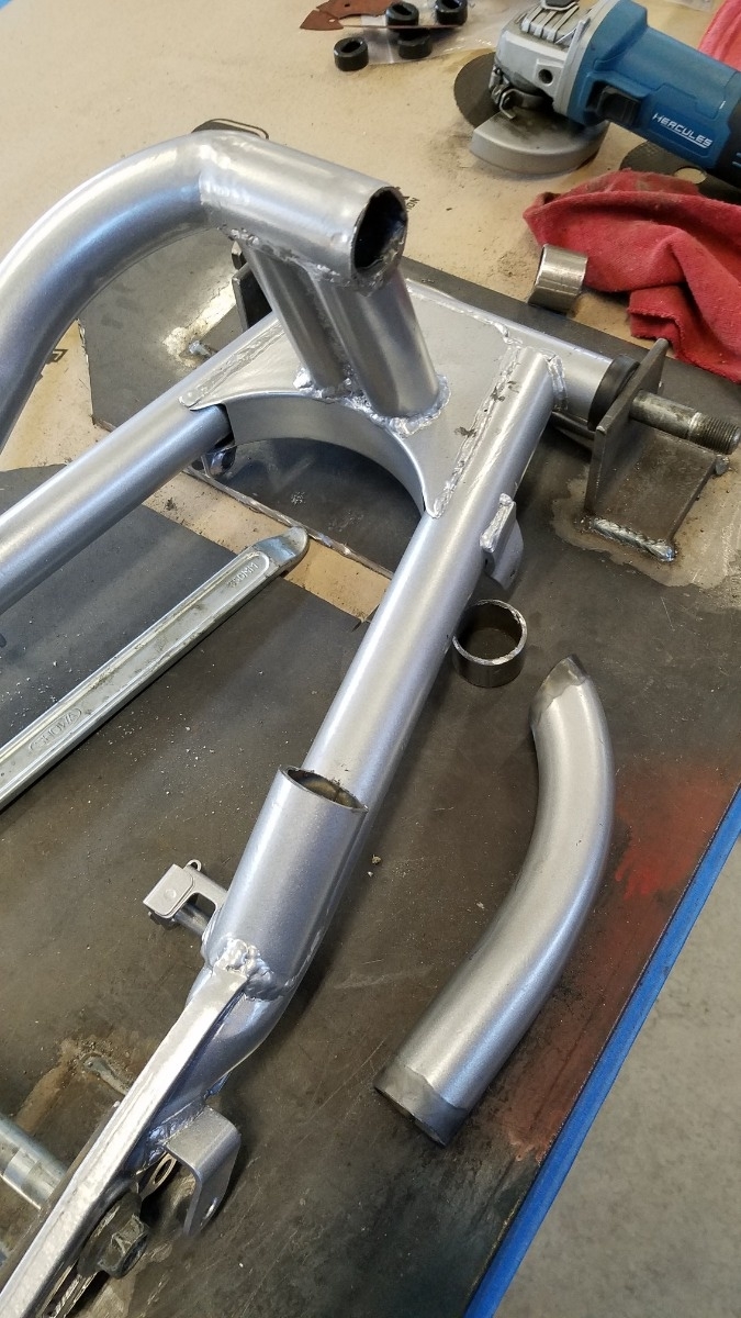

I am comfortable with the new chain clearance. Final weld sequence will be important to keep it straight, even with a fixture.

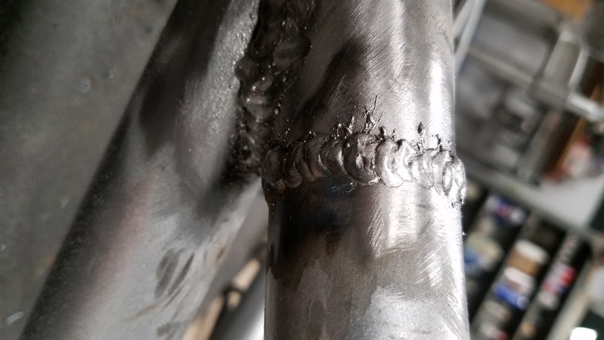

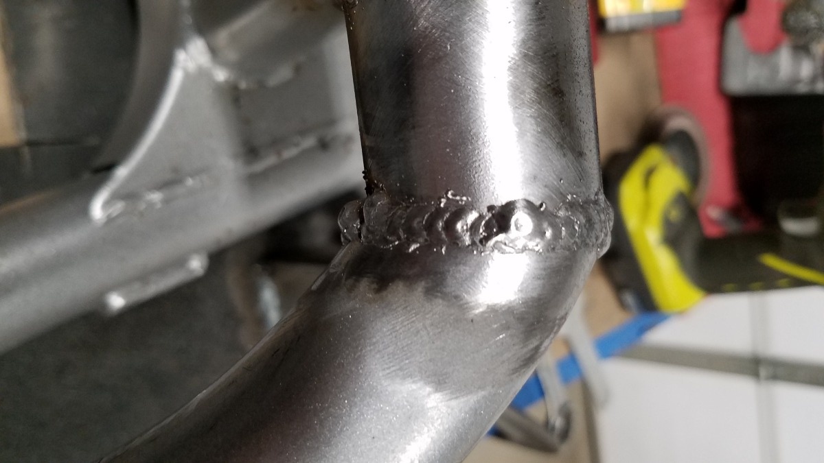

Normally don't post close ups of my welds, for obvious reasons. These are turning out better than my usual though.
