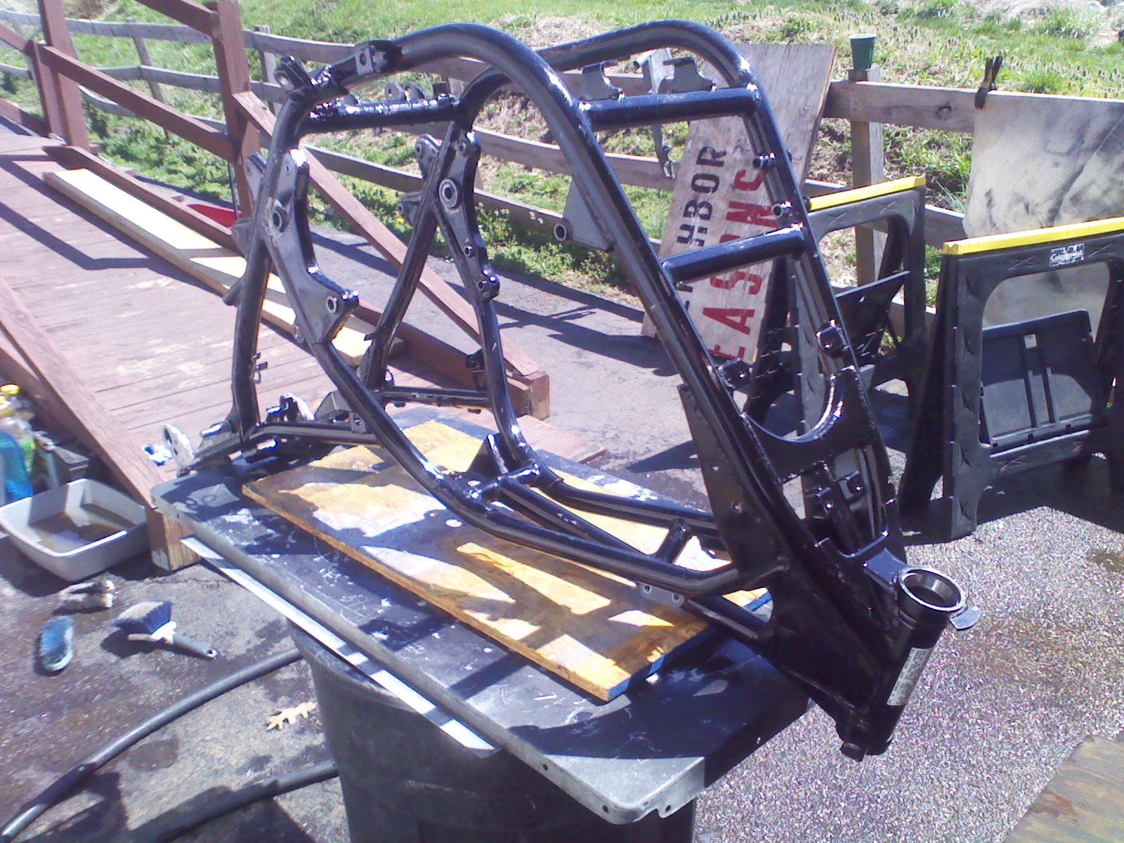

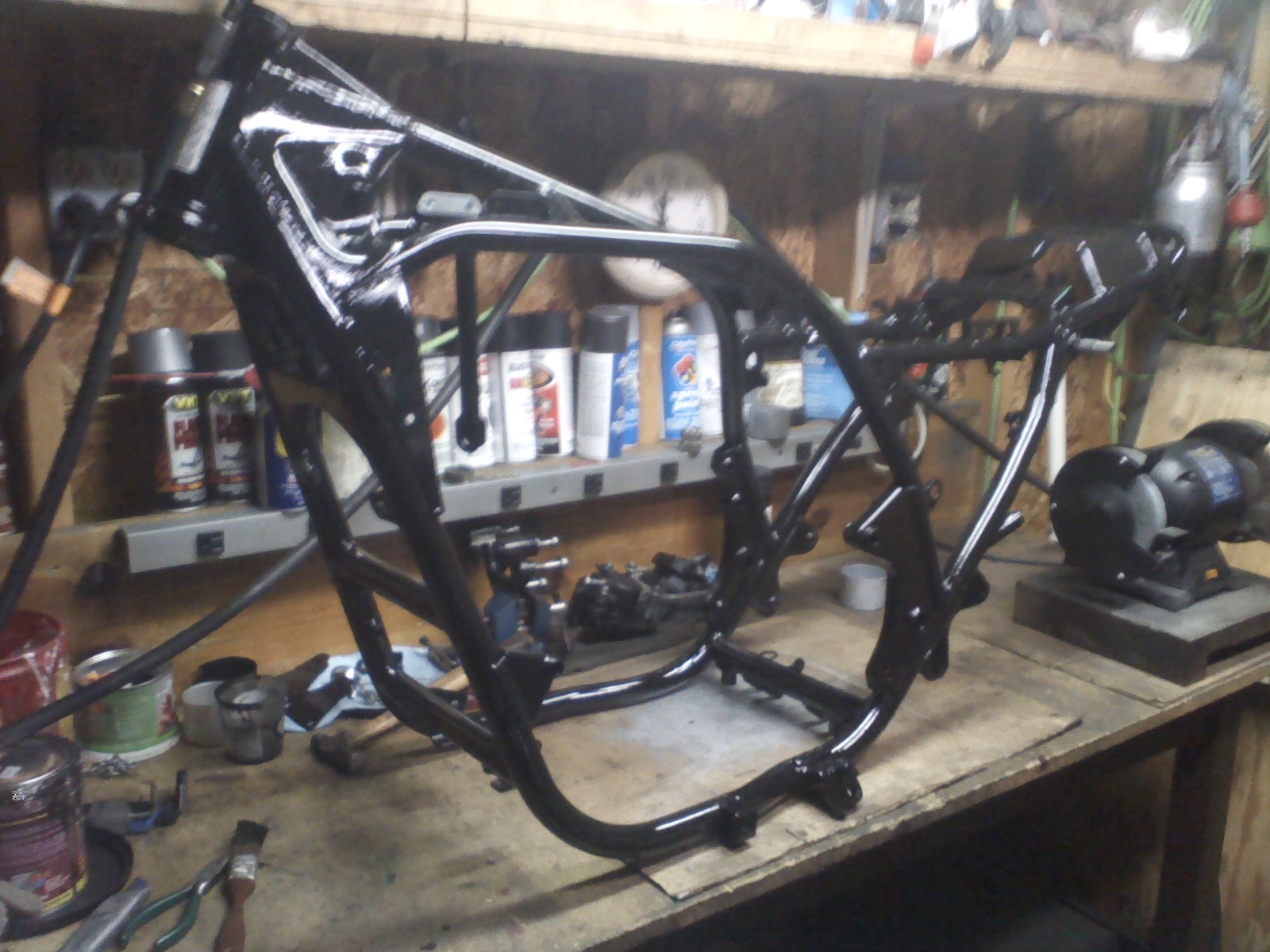

I'd be stripping some black paint

Yea it’s getting blasted and powder coated. I don’t want to ever do this step again.

31 Oct 2018 13:47 - 31 Oct 2018 13:51waktaylor wrote: Yea it’s getting blasted and powder coated. I don’t want to ever do this step again.
Smart move. I don't think POR-15 can be stripped with paint stripper. I had trouble chasing the threads in the frame with a tap, after I painted on the POR-15.
I used POR-15 on my frame. The worst frame paint ever. IMHO. EVER! I tried spraying it, and the over spray made a mess, while the area I was shooting looked good, so then I would go to fix the mess, and then the nice paint then looked like crap. I finally brushed what I could and slapped the bike back together, planning on blasting it back off.. eventually.. hasn't happened YET. It is also turning grey after 5-6 years on the road.

Yea I like how hard por15 is but it’s hard to work with. Nothing dissolves it except more of it so subsequent coats blister. If you get it perfect the first time then top coat it I imagine it’s worth the effort.
Generally I wish I had the $100 back.
