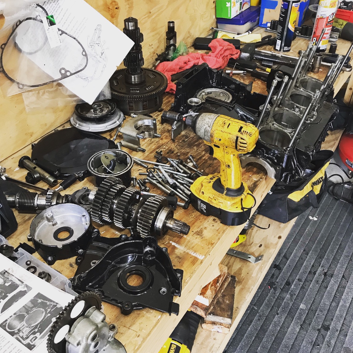

Cleaned the block/transmission and liberally applied Por-15. now NONE of the screws will be removable. This shit is like metal when it dries. Not what I was going for.. minor mistake

NONE of the screws will be removable......
I really hope that the clutch springs that have been compressed for the last 40 years are not shot, or that the clutch plates are not badly worn, or that there are no bent shift forks, or bad transmission gears or bearings, or broken parts of the missing chain tensioner in there, or scum clogging the oil pump screen, or ..........................

I have had the covers off so the screws will come out with a little work. I should have done this properly and taken apart the engine. Wont do it again, i promise.

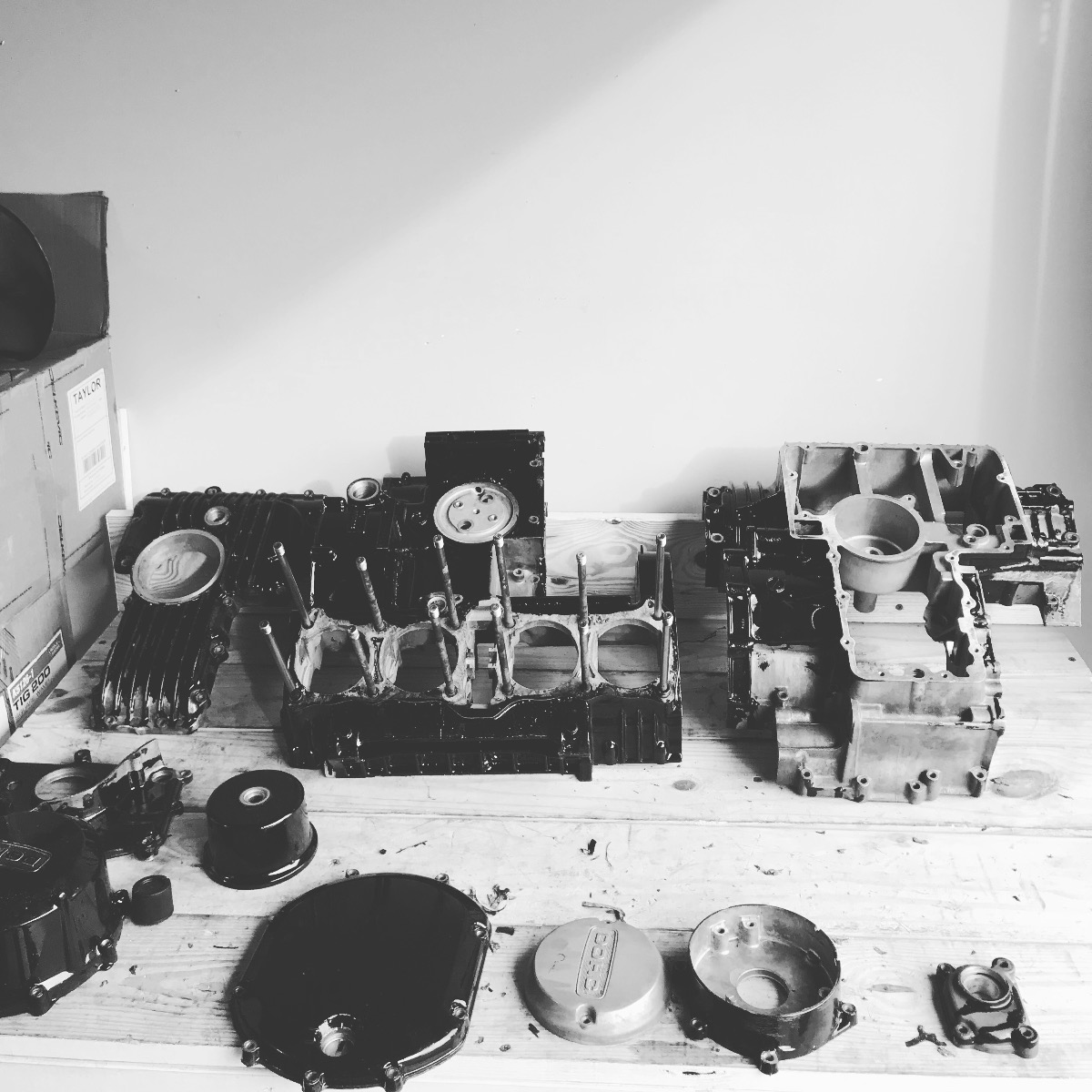

21 Oct 2018 20:26waktaylor wrote: Cleaned the block/transmission and liberally applied Por-15.
One thing to note about POR15. The color is not UV stable without a top coat. Eventually it turns dull and gray. From this page
www.por15.com/POR-15-Technical-Information_ep_62.html
"POR-15 is sensitive to UV light (sun) and must be topcoated before prolonged exposure to sunlight"

I remembered reading that. I’ll have to add that. I’m gonna redo the clutch and alternator covers. I should have have taken the block apart all the way first.
