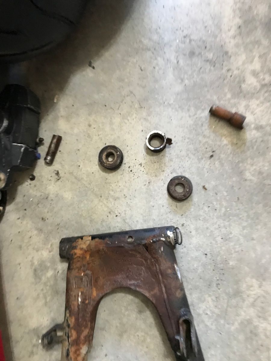

Trying to BEAT the pivot bolt out. What a pain. PB blastered it a week ago and more today. Used a propane torch and was able to pound it flush with the side of the frame now Im stuck till I find my bigger hammer and someone dumb enough to hold the punch.

Keep applying liberal doses of penetrant two or three times a day. If PB isn't getting the job done, you can mix up a 1:1 batch af acetone and auto trans fluid. It will often work when others do not.

Do KZ1000 swingarms have a grease fitting in the center of the pivot tube behind the motor like Z1's do? If so, unscrew the grease fitting & inject copious amounts of penetrant into the the middle if the swingarm pivot area might help.

It do and thank you for that I kept looking at it thinking that would work. I've pbblasted it. Hoping it will move.

I cut and ground and beat and pulled and I won.

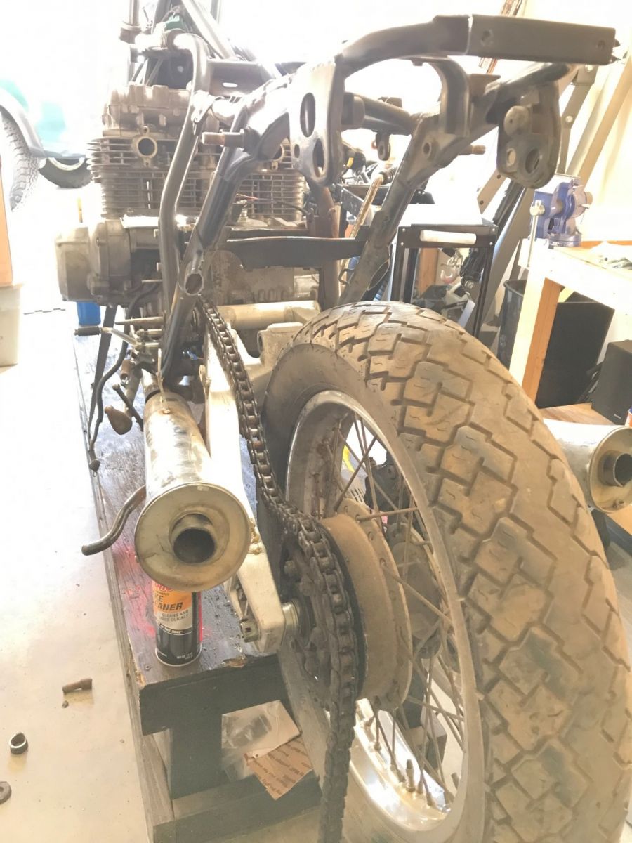

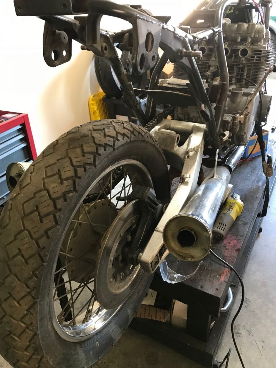

Test mounted my Bandit swingarm. The KZ wheel slides right into place... maybe I can go ahead and build my spoke wheels instead of running gsxr wheels.

Removed the bent garbage fork today. Also went a little nuts with the cut off wheel. modified rear fender. removed passenger pegs. Bandit swing arm hits them.
