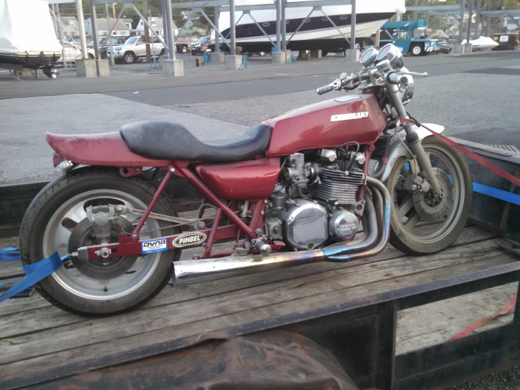

I have decided to redo the bike I have. The bike I have is a 1980 KZ1000. It belonged to my friend, a long time friend, someone I called my brother. He passed away 11 years ago, the family contacted me last year and asked if I wanted the bike. Of course I said yes. At the time of his death I have known JB for over 32 years. With all that said, I am going to strip the bike and start from scratch. From time to time I will ask some advise. I will continue to post pictures of the progress. Thank you all for helping me bring my brothers bike back to life.

That's a nice gesture to do for an old past friend! Early style drag bikes are very simple. Plenty of parts are floating around regular on eBay. I know 3 guys in Ohio, A guy in Topeka, KS. As your finding out all these old bikes were mis-matched hybrids of parts The engine with the "E" says Mark II case. I always buy shaft drive 1000's for the cases when I can. I have a few saved. But with a 16 tooth bottom pin in center of crank, crank is welded! with a 124 tooth cam chain, then 32 tooth cam sprockets. You got to be careful when putting these old engines together with different parts. When this is all apart show us the engine pics! BUT I would not think the CC's are that big 1428?? that is a lot of modifying! Lots of oil leaks with those big cylinder liners and bored out cases But good bones. Nice wheels that will polish up like new! Nice swing arm.

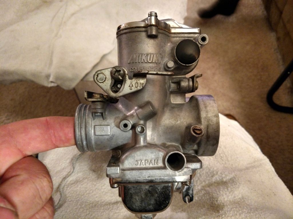

You are right I am finding out that the bike is a bit mismatched, but I'll make do. Nice bike you have, here are a few pics from when I picked it up and now. also 1 pic of the intake port.
