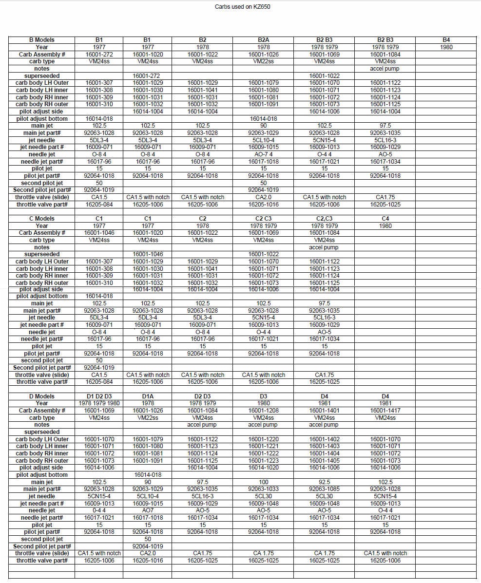

Since the stock air box and filter are in place (a good thing) if it was mine I would install the stock jetting. Take a look at the image below, notice it shows a 90 main jet for the VM22 carbs. Those are the original jetting specs. Ed

If these are 22 mm carbs I think the air screws you talk about are really pilot screws...... my manual shows 24 mm carbs with air screws (what I have up high and pilot screws (which are on the bottom of the bowl)...... Ed's chart shows that the 22s have pilot screws..... it says in my manual to set em at 1 and a 1/8 th turn out not 2 and a half but then again that is for 24s and you need a proper factory manual for yours to know what 22s are to be set at.
