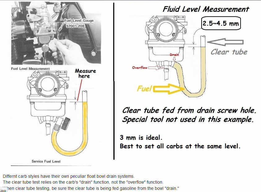

The stock float height for the VM22 carbs is the same as that of the VM24 carbs: 2.5 - 4.5mm. Here's a pic showing where to measure. Ed

I'm assuming you can do this off bike and simply use water as a substitute for gasoline? I currently am going back through the carbs and replacing every o ring that has a vac seal. Then its chemtool B12 and a little bit more than healthy dose of compressed air.
Proud Confused Owner Of A KZ650B2A

You can perform the clear tube test with the carbs off the bike. To do so it is best to mount some old carb holders to a board and then clamp the board in a vice or other device to hold the carbs level.
HOWEVER -
Water is not a good substitute for gasoline for setting fuel levels (adjusting floats). This is because gasoline has only about 70-75% of the density of water (0.739 vs. 1.00). So if you set the fuel level using water the floats will rise higher in the water than they would in gasoline because water is more dense, and this would cause the float valves to close prematurely which would cause the level of water in the carb bowls to be too low. This would then lead you to bend the float tangs to adjust the fuel level higher. Then when you switch to gasoline to run the bike the floats would not rise as high in the gasoline as they did in water because the gasoline is less dense. This then would cause the fuel level to rise too high before the float valves closed and might cause an overflow condition. If you want to use something other than gasoline you will need to find something that has the same (or nearly the same) specific gravity as gasoline that will not damage or clog carb parts.
The density of alcohol is fairly close to that of gasoline. To see a chart of specific gravitys do a google search using the words: specific gravity liquid . This may help you decide what to use for your clear tube test if you decide not to use gasoline.
HOWEVER -
