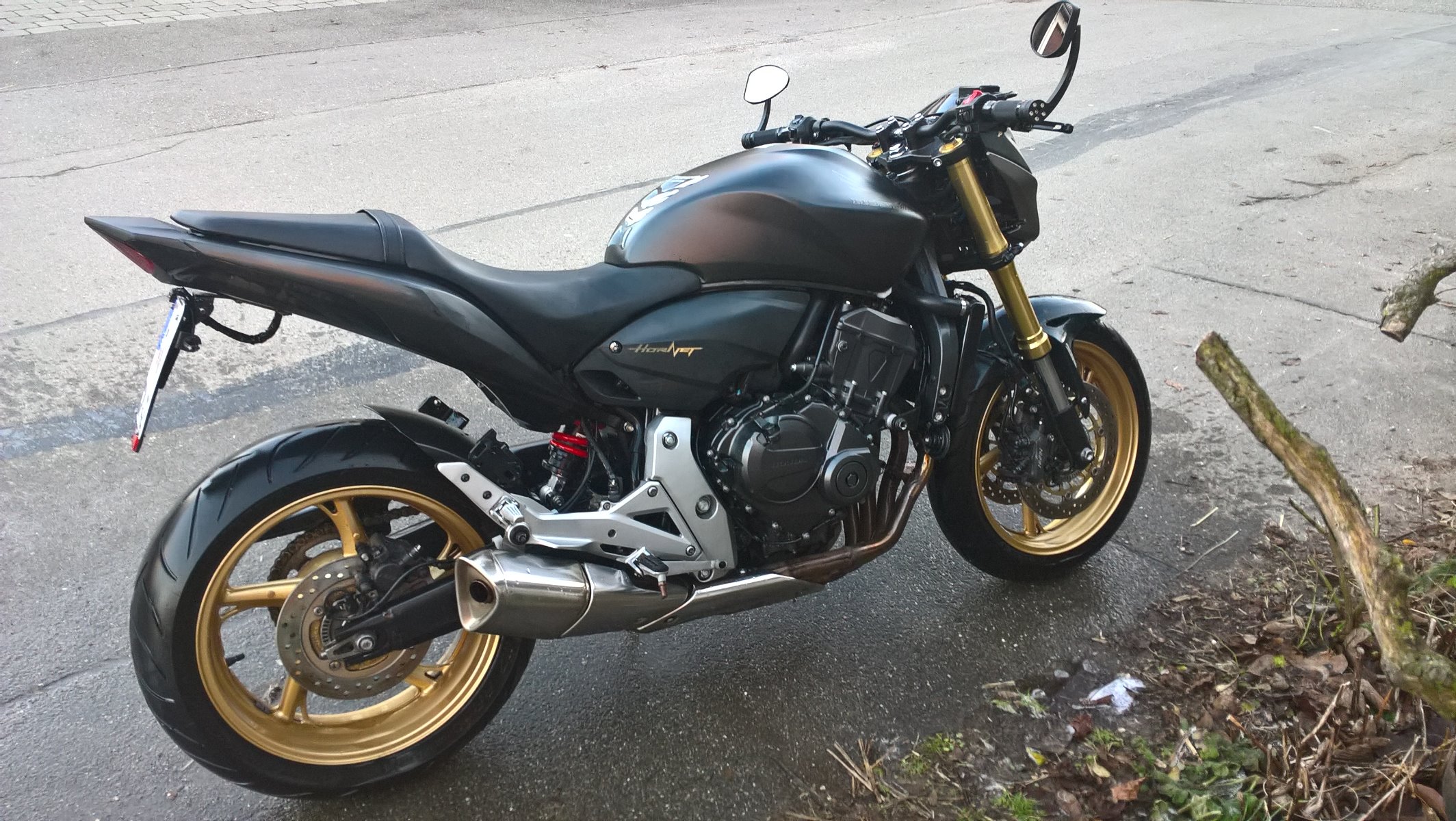

If you don't want to or can't bake the wheels after painting you could get some 2k acrylic made up to Honda colour code YR-112 M-U. Or just go for an acrylic or water-based base coat in this colour and cover it with a couple of coats of 2k clear - would probably be cheaper and definitely be easier to maintain.
That code is for the colour of the wheels on my hornet:

Thanks for all the comments guys, there's so many shades of gold the more you look , the harder it gets, then the gold really changes with differing light too. Thanks for the color code calum, I like that honda gold, its a little darker than some i've looked at. Nice bike too...!!

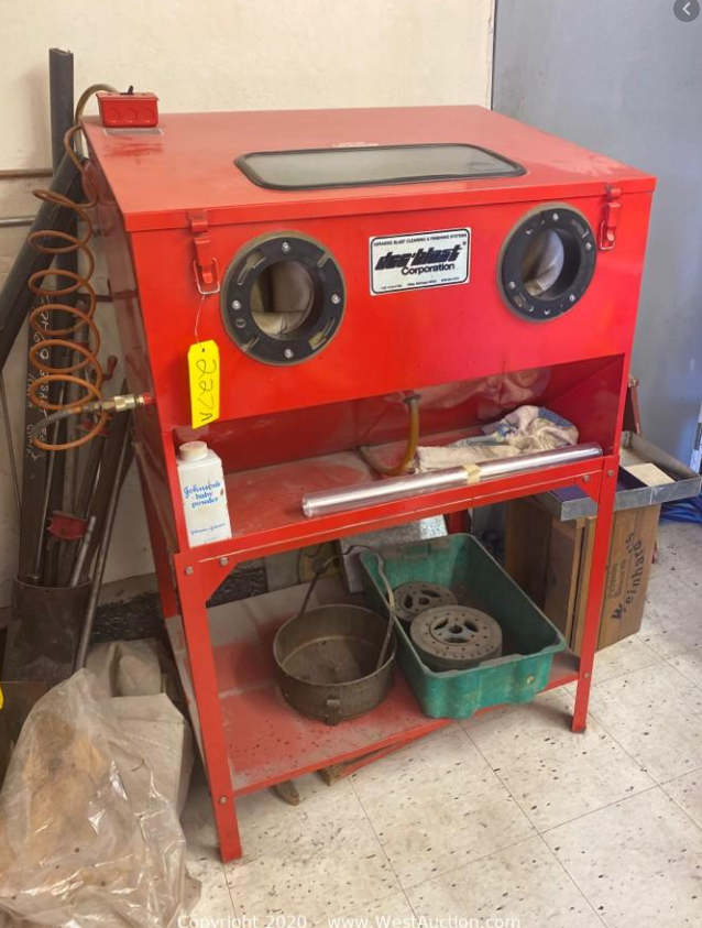

Wow! Very nice restoration. This is along lines on what I want to do with my 650. Now after spending an hour I have many more different ideas.
I assume you had to strip and work with frame separately because it wouldn't fit into your blast cabinet? I was planning to take my frame to the shop to get it blasted and powder-coated but now I am not sure.
Which cabinet do you have? I kind of want one and have good compressor already but feel like now is a time to pull a trigger on compressor. With so much work coming in with this bike looks like it's going to be needed.

My blast cabinet is a craigslist special. It's an old all metal hobby level jobbie that won't win any prizes but gets the job done. The dust filtration system uses a squirrel cage motor w/sock hanging outside.

08 Dec 2020 17:03Nessism wrote: My blast cabinet is a craigslist special. It's an old all metal hobby level jobbie that won't win any prizes but gets the job done. The dust filtration system uses a squirrel cage motor w/sock hanging outside.
Need pictures!!
And link. Did you do wheels in a cabinet as well?
Does it move easily? I have pretty clean garage and wondering how much dust will be there or maybe I should move it outside for when in use.
Do you use one kind of media in cabinet or switch depending on use? Feels like steel needs something stronger and engine/carbs need soda?

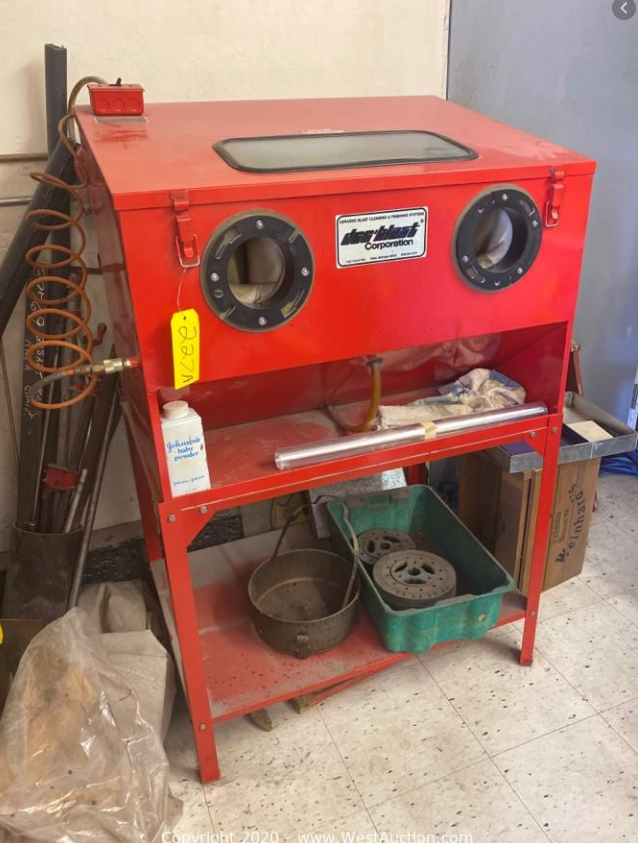

This photo is not my cabinet but it's very similar. It's made by Dee-Blast, which interestingly enough is still in business. USA made. I use glass bead on clean parts and aluminum. Aluminum oxide to strip steel parts. I've tried coal slag but it's a little too coarse to shoot through the nozzle. Soda is not good in the cabinet either because it denigrates on contact and creates a cloud that you can't easily see though. Both of these medias have great uses though; I used coal on the frame and soda on the head. Anyway, I can't imagine restoring anything old without a blast cabinet. Nor can I imagine not having the zinc kit. You can get away with a more minimal kit than what Caswell's sells with good results. The key thing you need from them is the chemicals.
Edit: oh, and I put wheels on the legs and wheel the cabinet outside when blasting. It leaks dust so I wear a mask and do it outside to avoid too much dirt inside the garage.

08 Dec 2020 19:58 - 09 Dec 2020 08:30Nessism wrote: I use glass bead on clean parts and aluminum. Aluminum oxide to strip steel parts. I've tried coal slag but it's a little too coarse to shoot through the nozzle. Soda is not good in the cabinet either because it denigrates on contact and creates a cloud that you can't easily see though. Both of these medias have great uses though; I used coal on the frame and soda on the head. Nor can I imagine not having the zinc kit. You can get away with a more minimal kit than what Caswell's sells with good results. The key thing you need from them is the chemicals.
Sounds like soda is great for carbs too (to clean outside). Since you use different medias (and I haven't done any blasting so sorry for stupid questions) - do you collect it back and reuse or just throw it away? I know soda is not reusable, but what about others? And since you change them, do you have to clean cabinet somehow every time?
