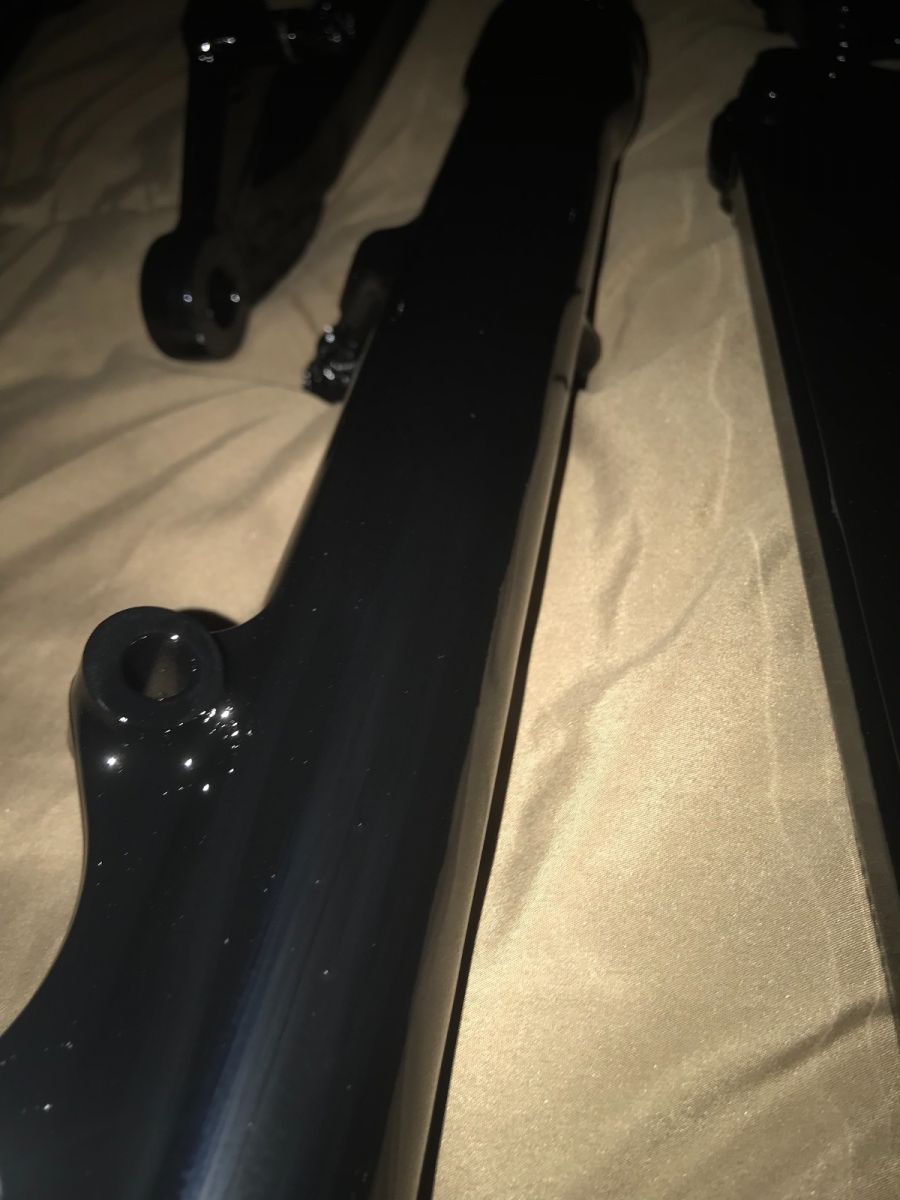

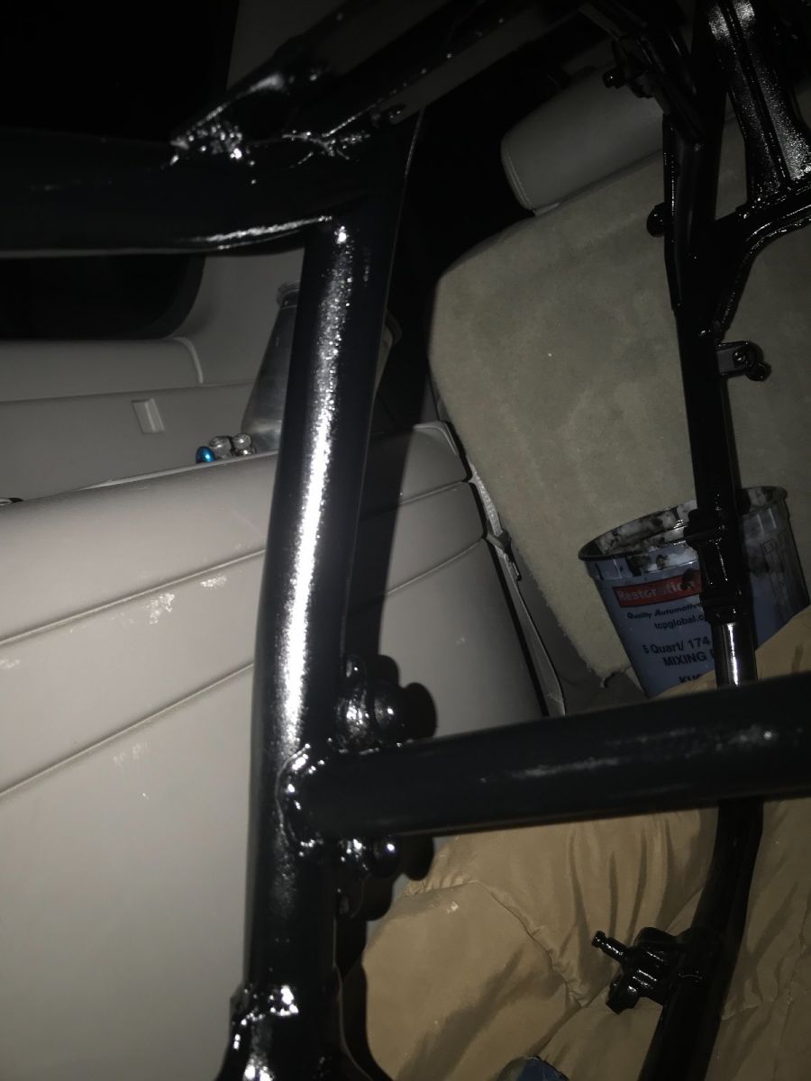

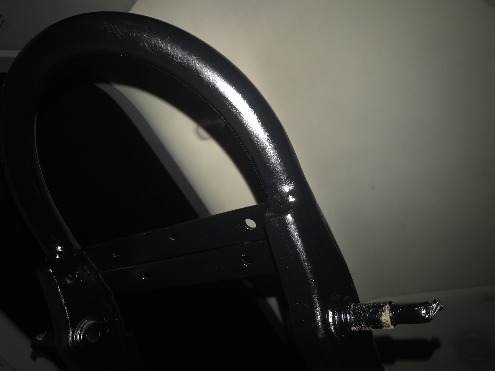

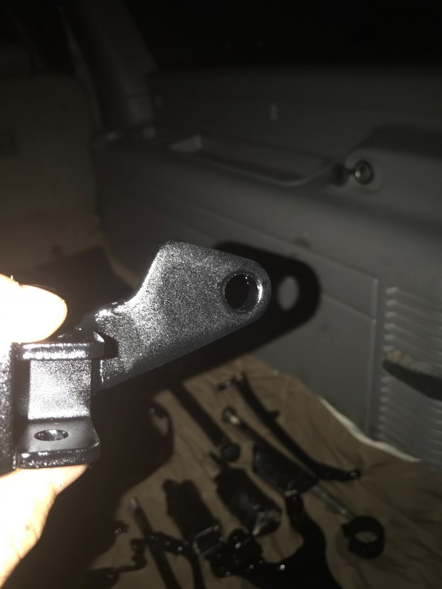

So the first time I painted I did it to light. So the finished product looked and felt horrible. So I scuffed everything up and sprayed everything again until the paint had enough time to build up and not run. Now it looks fabulous. It’s just on a few places where as soon as I moved the gun upside down it didn’t spray. So my question is, can I mask off or whatever every thing I don’t want repainted, scuff up the area I want to fix and the spray it? Of course allow enough time for the paint to build up and really shine. Here are some photos of what I need to redo.
The seat hoop has some scratches from where I scuffed before. I wasn’t able to get that part cuz I was upside down.
As for the other parts I’m not sure.
Thanks!
Thanks!

Yes, you can mask and respray. A gray scotchbrite pad works well to scuff paint for respray.

As for masking, if I just mask off the area I need to scuff up and respray won’t that cause a ridge or something when I remove the tape? Maybe when you say mask off you mean something else. The reason I ask is because I’m running out of activator. Stuff is expensive and I don’t know where to buy it. I kinda feel like I need to decide what parts I want to respray because I feel o don’t have enough.

10 Oct 2018 16:59JohnLuke wrote: As for masking, if I just mask off the area I need to scuff up and respray won’t that cause a ridge or something when I remove the tape? Maybe when you say mask off you mean something else. The reason I ask is because I’m running out of activator. Stuff is expensive and I don’t know where to buy it. I kinda feel like I need to decide what parts I want to respray because I feel o don’t have enough.
Thanks!
Yes, you will get a tape line...but it's just a frame so that won't matter very much. And if the tape line upsets you there is always color sanding and polishing that can be done.
