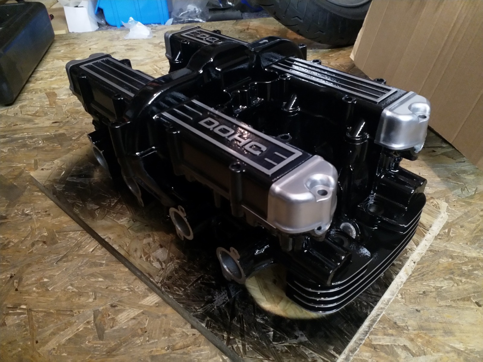

Hi Ed,
slowly but surely making progress on the KZ. Just finished painting the engine and covers (strayed from the original aluminium block and went with the black engine like yours - the crankcase was too beat up to leave as it was).
I clear coated the head and valve cover after sanding the highlights. The fins chipped in a couple of places when sanding so I wanted the extra protection, the valve cover I did mostly to hide the scuff marks - oops.
Was wondering if you put clear on the covers. I'm tending to not do it at the moment as it takes away the shine a bit, just not sure about the paint chipping around the edges. Have a good 2k engine lacquer that I could use, what would you recommend?

01 Nov 2019 16:58calum wrote: Hi Ed,
Sorry but I don't have any recommendations for 2k engine clear. If you find one let me know. I used crappy rattle can VHT and it's one of the weaknesses of my rebuild because it's nowhere near as nice as the paint Kawasaki used originally. If anyone knows what kind of paint they used please share. They painted the raw castings, including lots of overspray on the inside, and then machined the surfaces. Engine oil doesn't affect the paint one bit.
