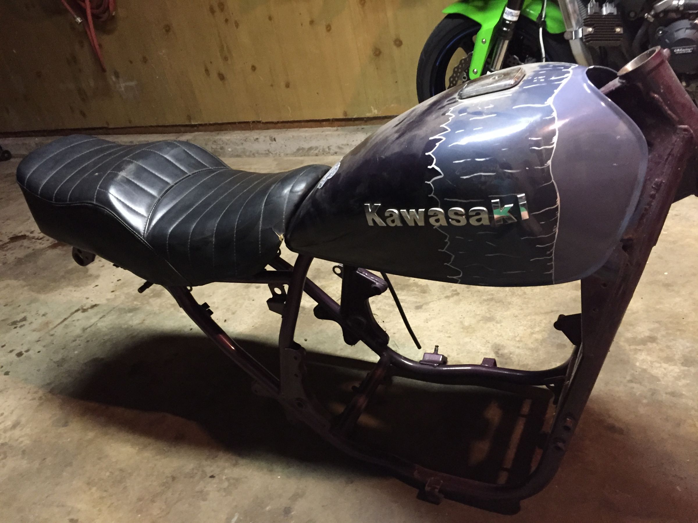

Picked up a frame for 82 kz1000
Looking to do a 04/05 zx10 front end and wheels with gs1100 swingarm
All hard parts powder coated satin black
Looking into using 03/04 z1000 engine and wiring
Hoping to have it done by spring
So far I have stem bearings and picked up a new seat cover
Bike will use stock tank and body work with aftermarket headlight and taillight

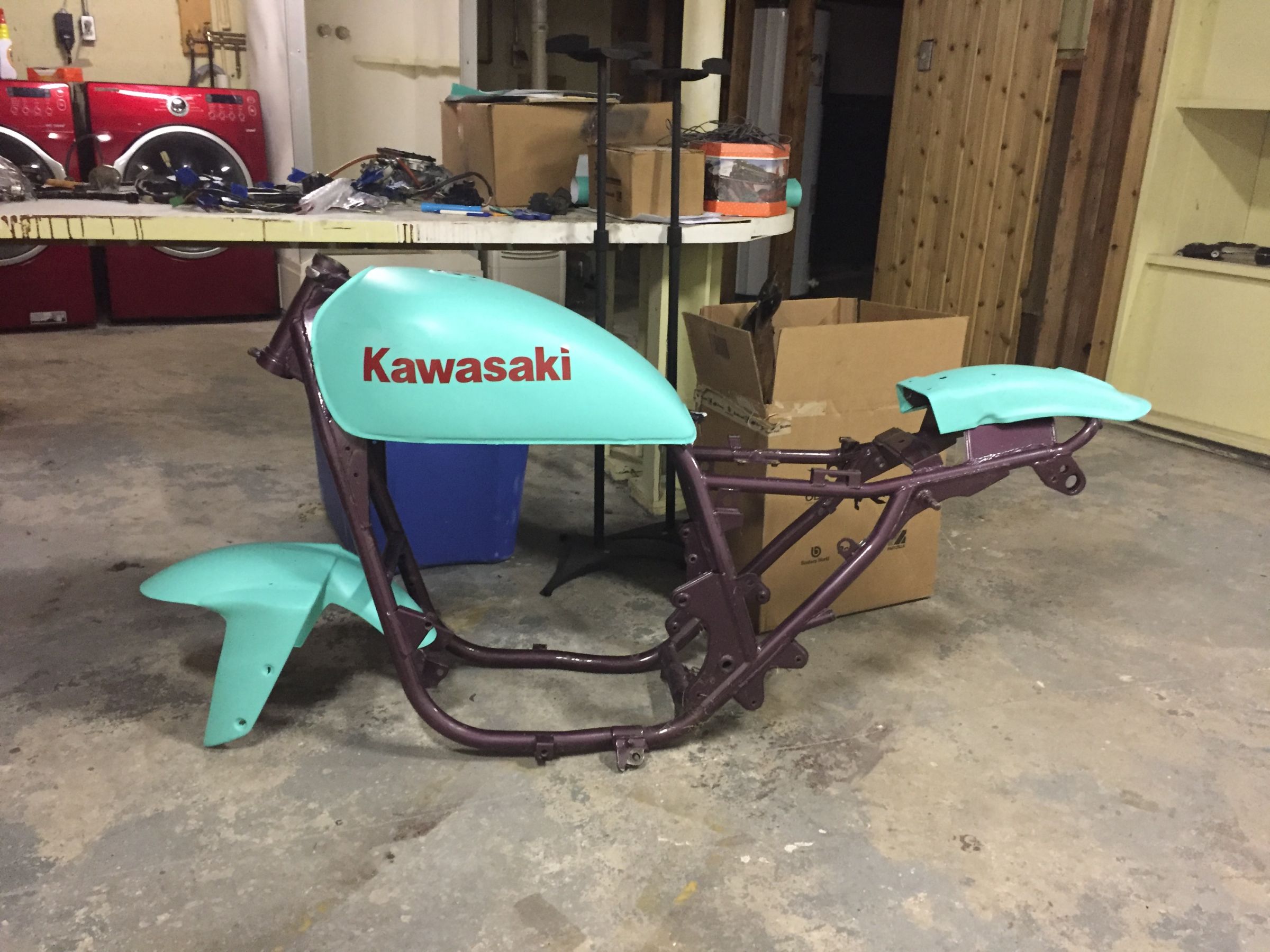

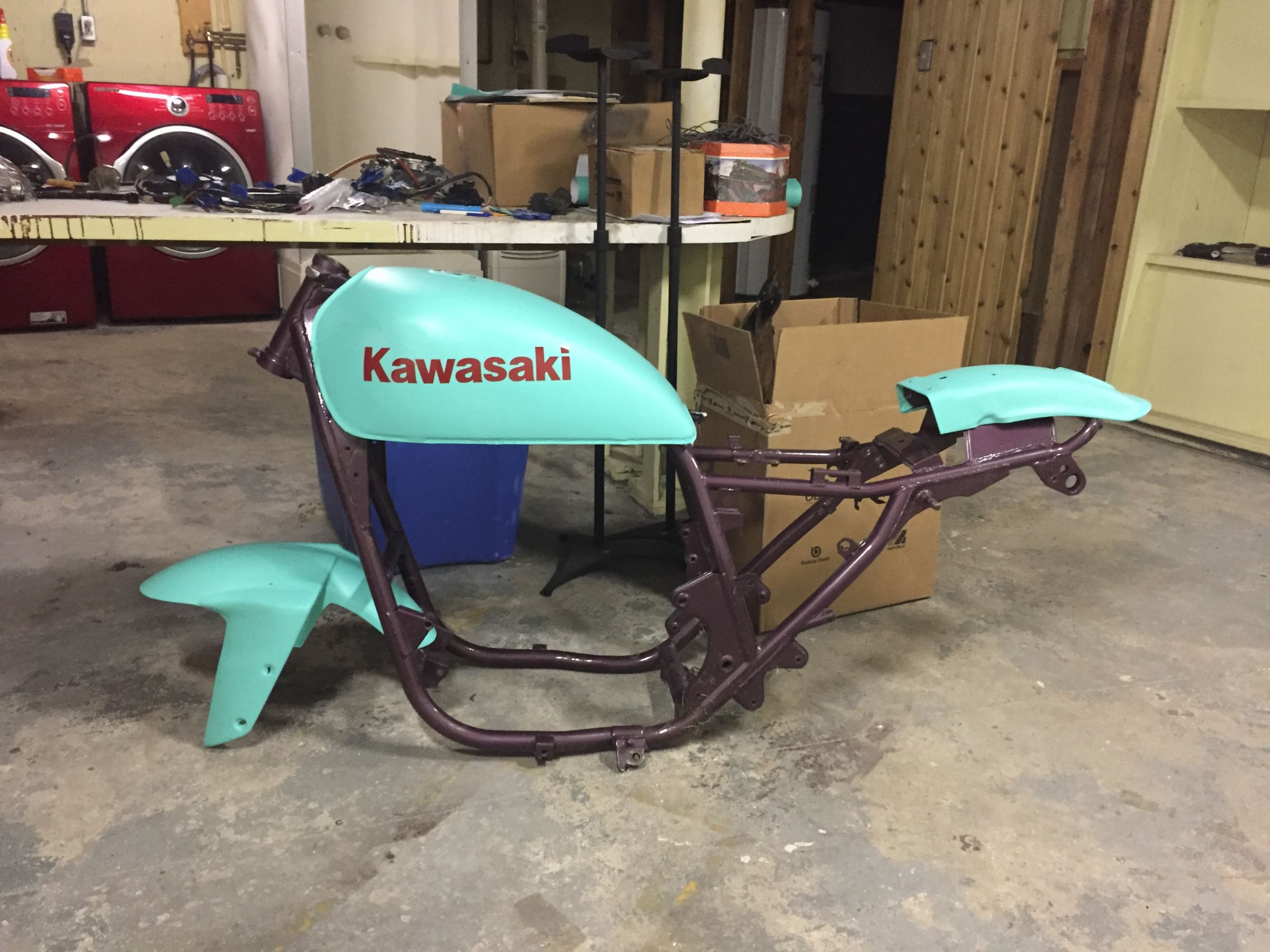

Matte Tiffany blue vinyl wrap with gloss red graphics

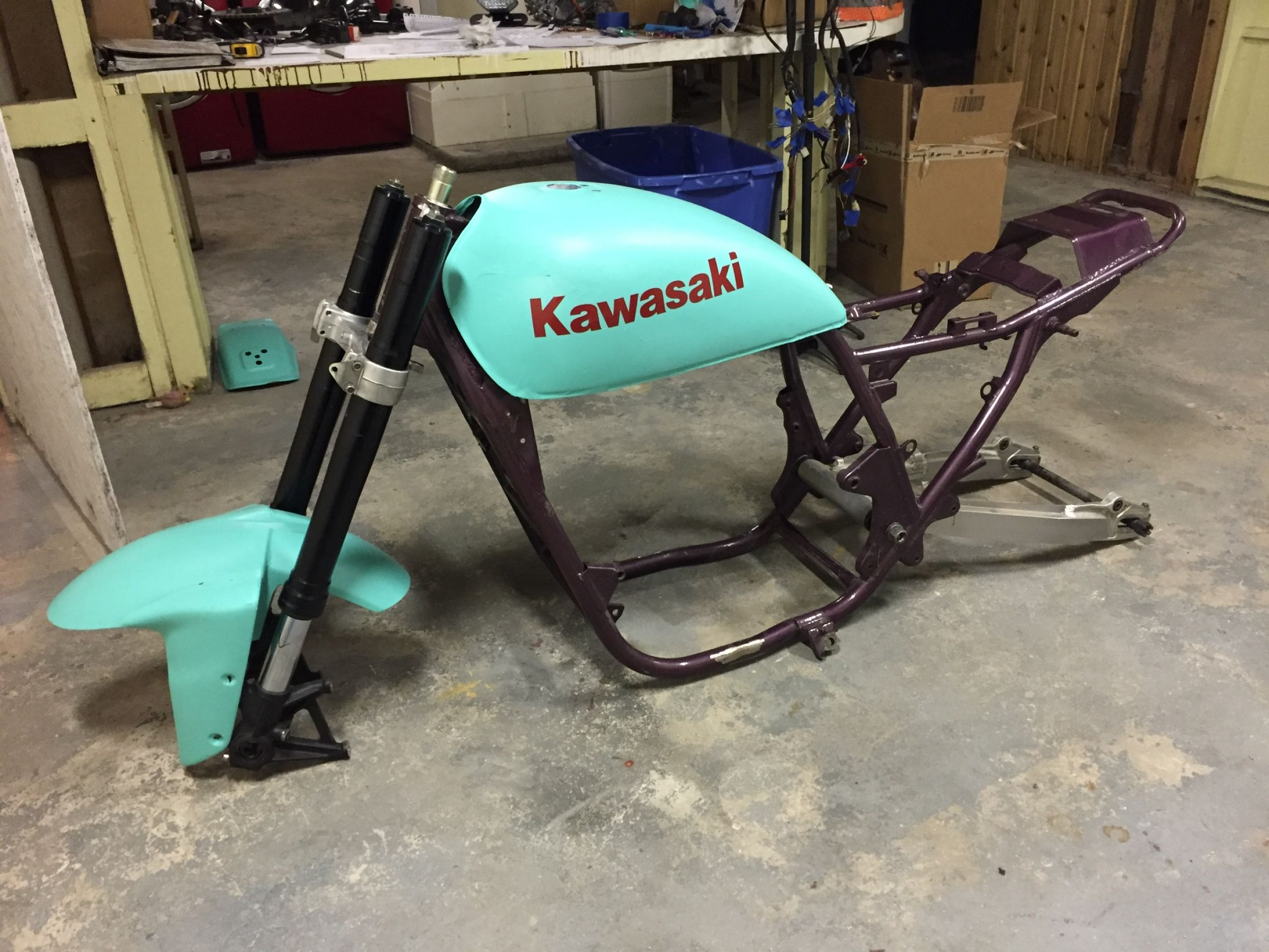

Got a good deal on a gs swingarm and zx6 rear wheel
Looking at YSS shocks as well
Met with shop last week and guys really cool and interested in helping out
Going to sort out the rear end then get the engine fitted

Rear end is ready for spacers and upper shock mounts from the fab shop
Got the new bearing, Cush drive rubber and seal for the sprocket carrier
Going with a 525 chain and sprocket since I'll have sprockets leftover for my track bike
Ordered clip ons shocks and front wheel
