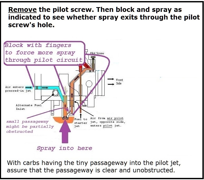

Spray exiting into the carb bore from being sprayed into the starter pick-up is good, but doesn't indicate that fuel is flowing through the tiny passageway from the main jet to the pilot jet, which tiny passageway may still be obstructed.
Using the same block and spray method for the pilot circuit, first remove the pilot screw, then block and spray into the main jet to see if spray exits through the empty hole where the pilot screw usually fits.
If spray exits through the empty hole, the spray is passing through the tiny passageway, which indicates that fuel can also flow though the tiny passageway.
If spray exits through the empty hole, replace the pilot screw, and again block and spray into the main jet to see if spray exits into the carb bore.
If spray doesn't exit into the carb bore, it indicates that the orifices in the carb are obstructed.

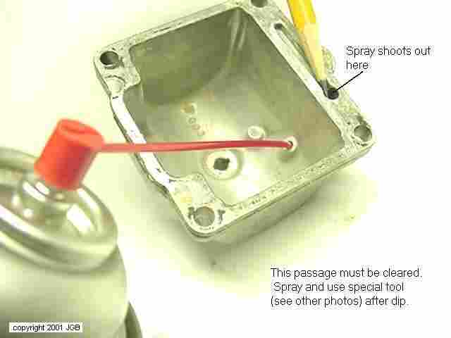

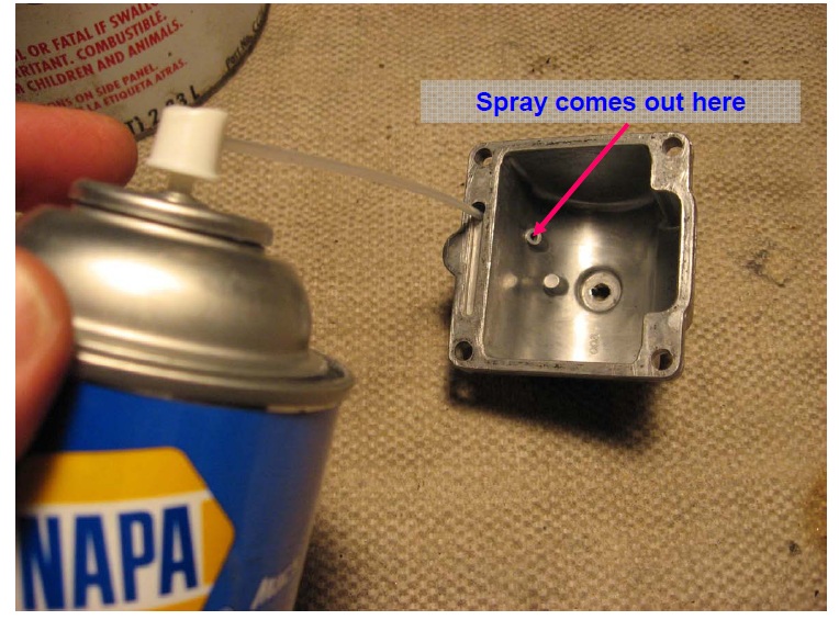

03 Oct 2016 19:30I carefully read all the notes on the images Patton with regards to what to plug and where to spray. It really would help to have a third arm. Two hours and a can of carb and choke cleaner later, i cannot make anything come out of the enricher circuit or the pilot circuit. My confidence about having a quality 'seal' on the areas to be plugged is low. That coupled with a far less than perfect seal with the straw on the carb cleaner can. Maybe those things don't need to be perfect to get some flow out of the pilot or enrichner ports into the carb body. The lack of flow would certainly explain the fact it won't start. I was able to drop a carb wire down the brass tube and each of the openings in the carb bore. So what is the next step? Strip them down and back into the ultrasonic cleaner and jack up the heat?Patton wrote: Are the plugs wet with fuel after an unsuccessful starting effort? Which would indicate that the carb pilot circuits are providing fuel that's being sucked into the cylinders.

Bowl passages are clear. No I did not touch the throttle grip when trying to start the bike. I did see a few bubbles at the pilot circuit port in the carb bore on Friday but could NOT repeat that today. It is really tough to try to match the carb cleaner can straw to the brass pilot circuit fuel pipe. Hard to believe there is much pressure that makes it into the pipe without some sort of tubing seal to act as a coupling.
