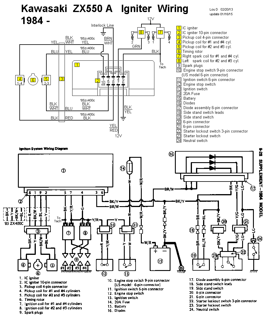

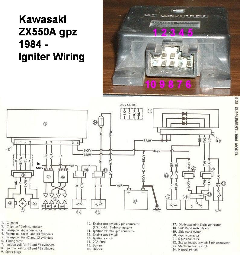

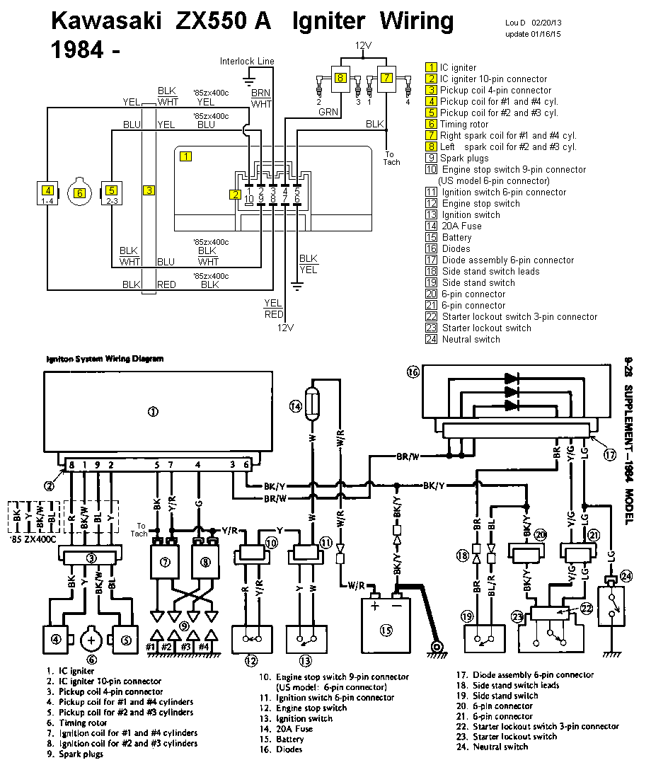

The green wire for the coils should not get mixed up with the green wires for the turn signals. They are completely unrelated wires even though they are the same color.
My buddy had a Kz650 broken down on the street with blown fuses and had started messing with the wiring. So when I got there I found him a 12v source and the bike started right up... but it would rev and then stall, then rev then stall... backfiring along the way. It turns out we powered the ignition with the turn signal circuit. :laugh:
We found another power source and he rode it home. We eventually just re-wired the whole thing from scratch.
Power for the igniter should come from the kill switch.
Here is the pinout for a 550, but it may be similar to the 750, if this is what your igniter looks like. The wire colors are probably different since the 550 went through some different changes, but the pinout, I would guess, but am not 100% positive, would be the same.
This is the only photo I have of the Zx550 igniter. Ignore the diagram attached to it if it's different from the one above.

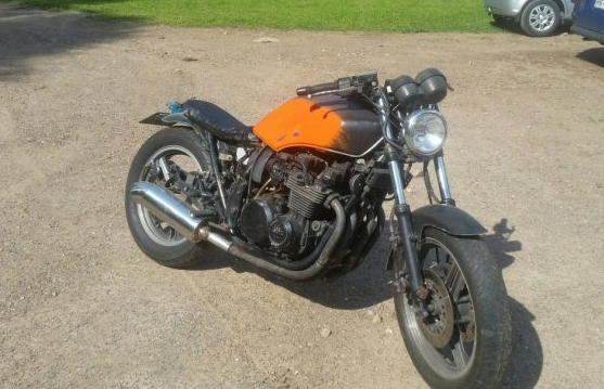

After seen tons of bobber builds on ZX750A where the builder shows of his/hers fab mechanical skills like in this good example that is currently for sale here. :sick: The seller has recently dropped the price by 400 USD and is now asking 800 USD.
I must say yours is an absolutely ”Kawai!” build! :woohoo: :woohoo:
The 800 USD bike? Yeah it’s still unsold, three months and counting. . . . :whistle: :whistle:

That is simply a hack job. I will say it again some people just shouldn't own tools.

That's what I'm talking about, while that bike clearly has other issues as well, the original tank doesn't work, at all, on that style bike.

Thanks, Baldy, I'm hoping you are referencing the orange one.
