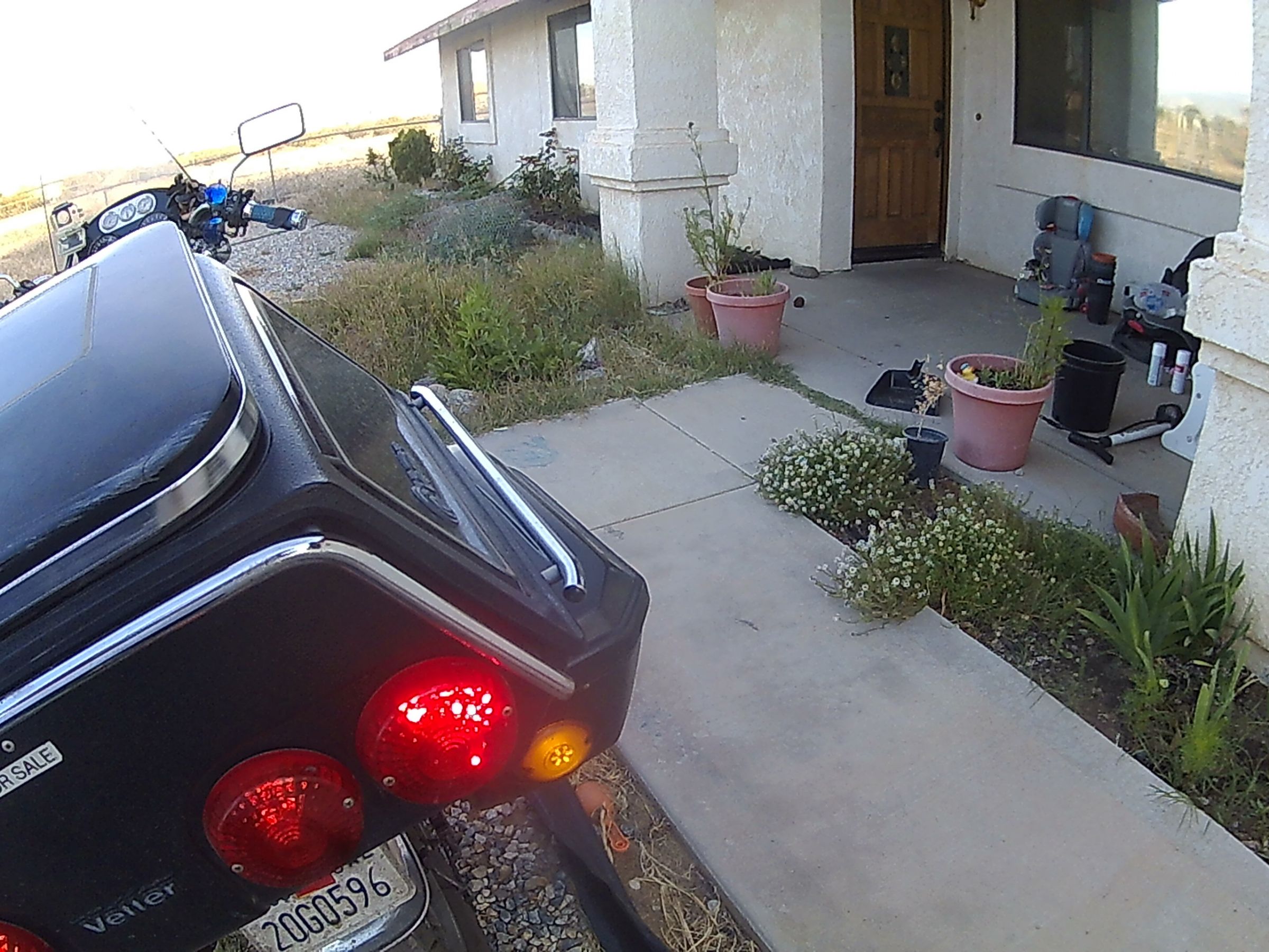

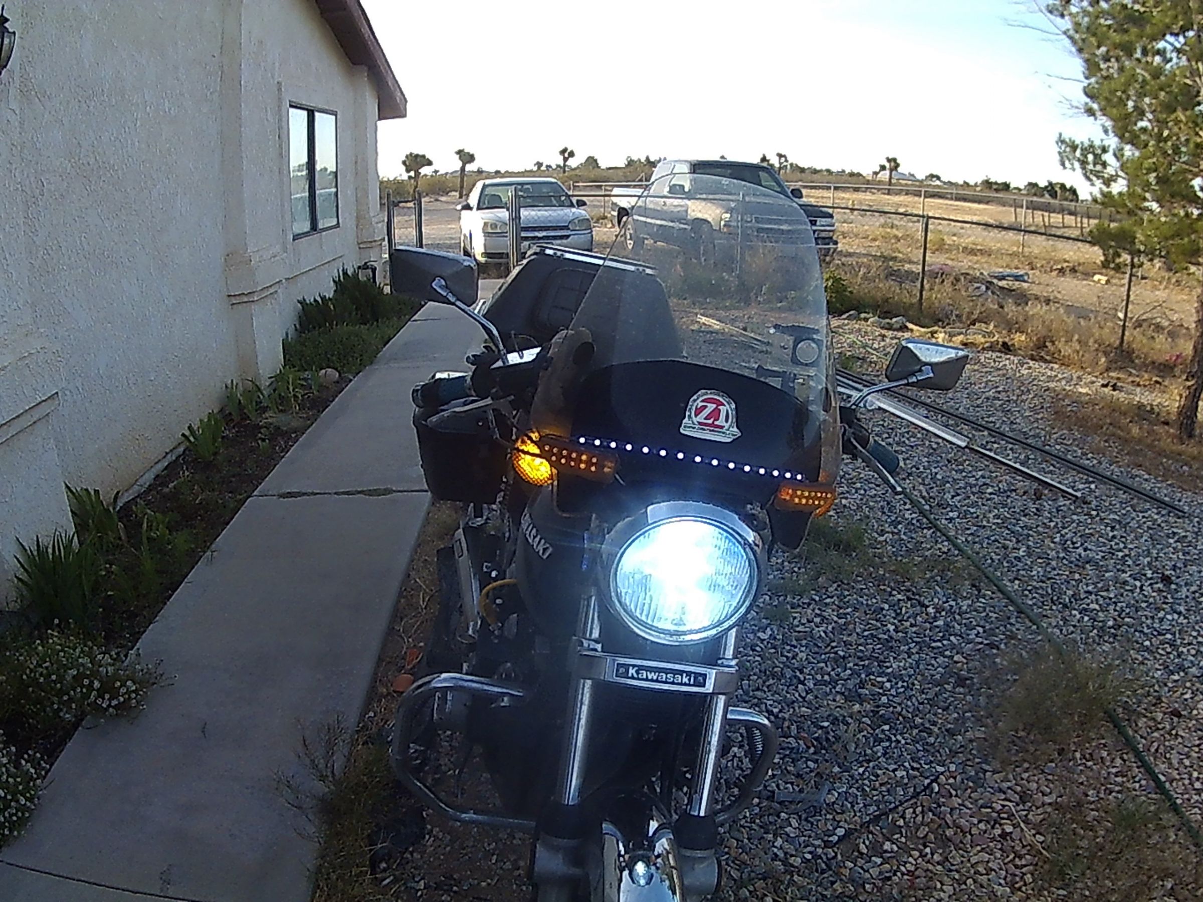

Z1's didn't have running lights so I bought these at Z1E. Due to the extra load I went LED's.
www.z1enterprises.com/product/KS25-2195
For my top box I got LED arrows so I could have running lights, brake lights and turn signals.
Went with a HID headlight too. All the light were over taxing the system. I replaced everything, all good now.
