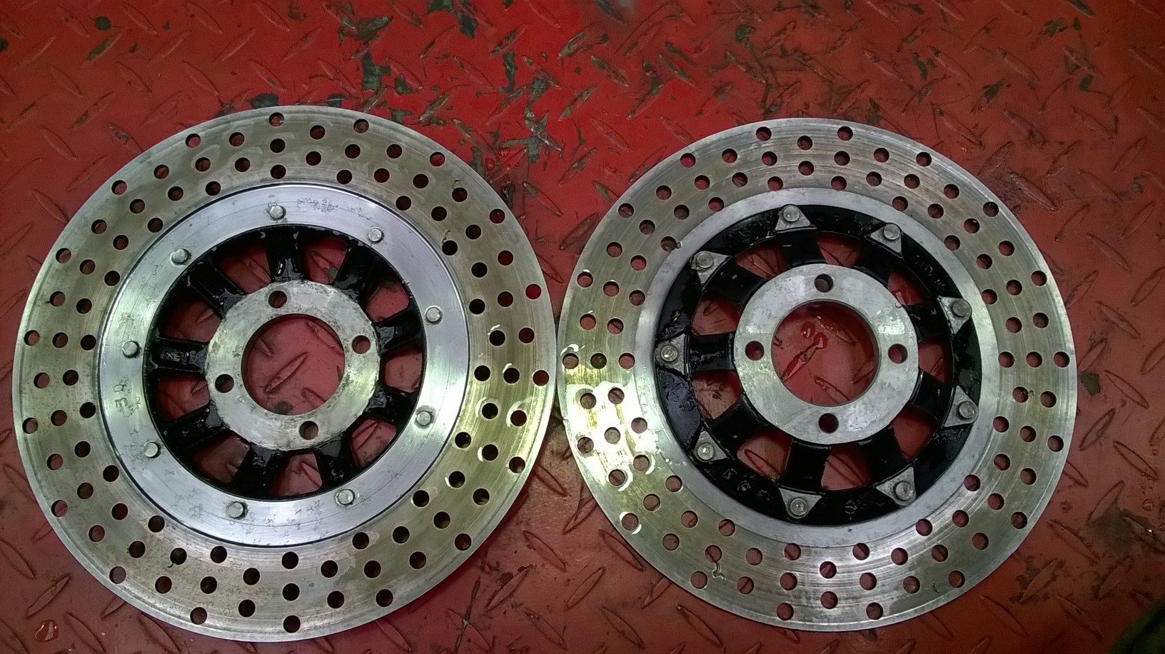

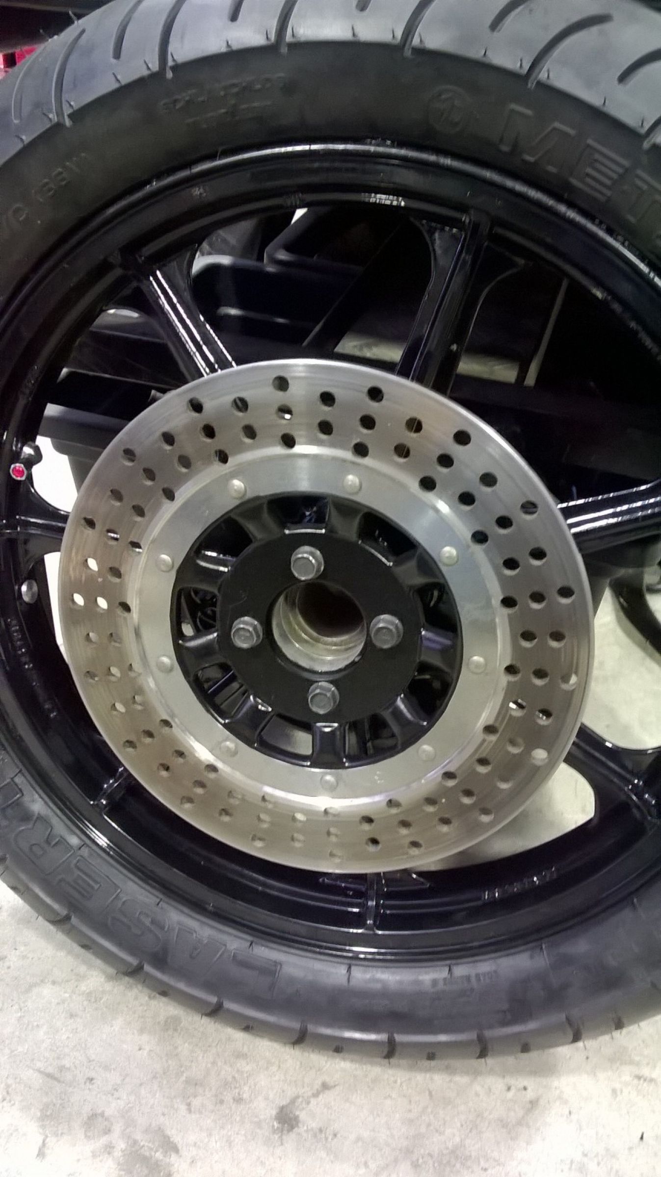

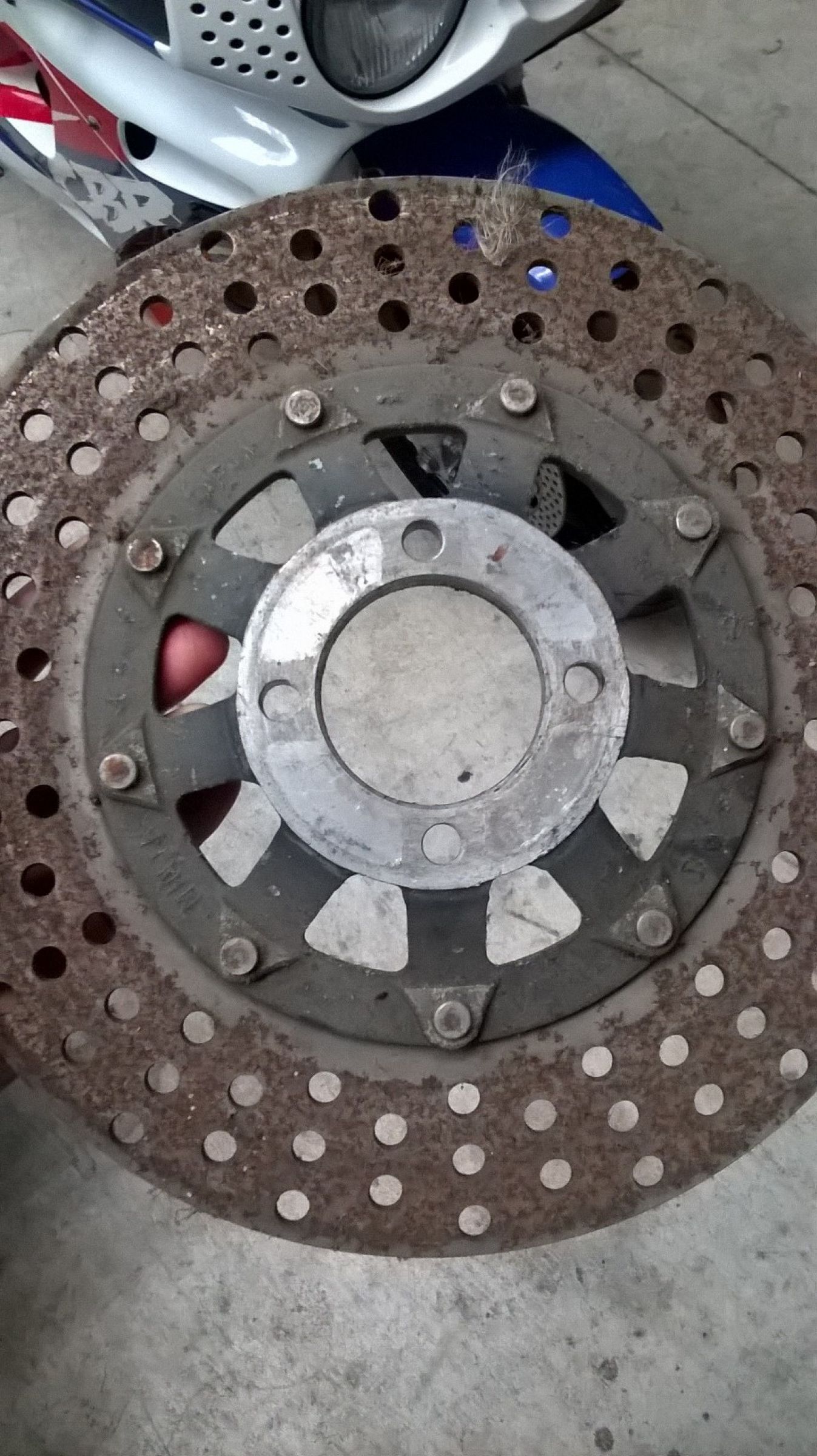

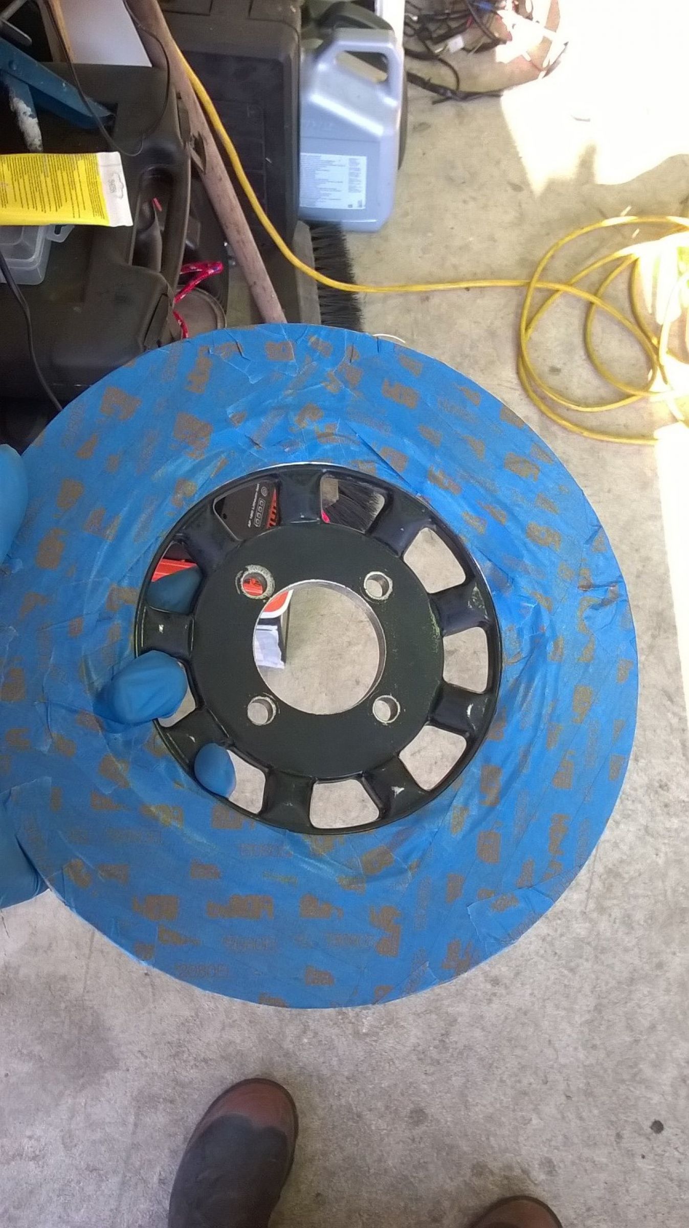

18 Aug 2016 23:10 #739206 by larriken
Replied by larriken on topic Kiwi Z1R
Started sorting out the disc rotors. Attacked the rear one first. Taped, sanded, and painted, then back on the rim. Job's done!
Remember those rusty rotors I scored for the front............................
Here they are now after a bit of scrub and a bit of love. Just need to get the inners sanded tomorrow and get them painted.

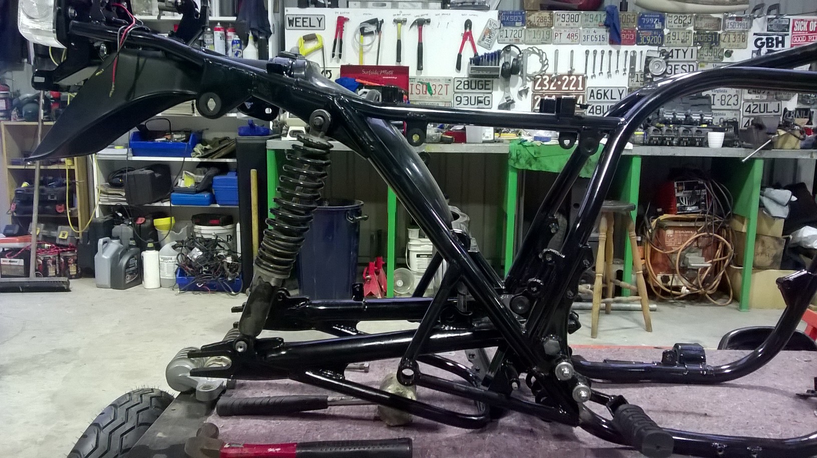

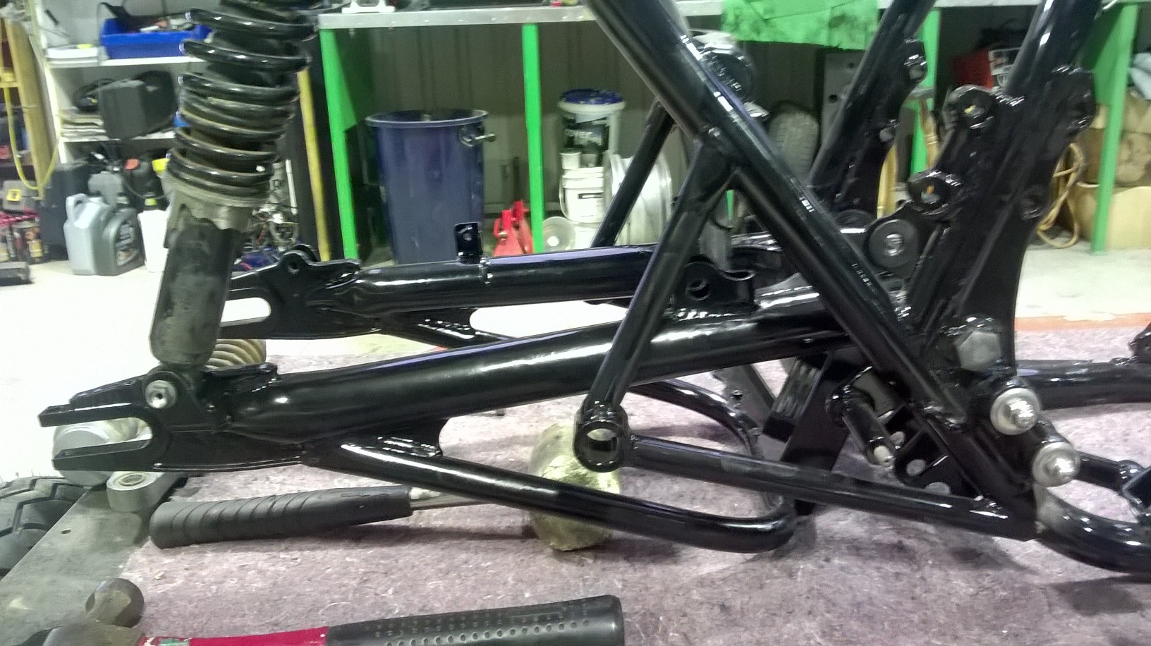

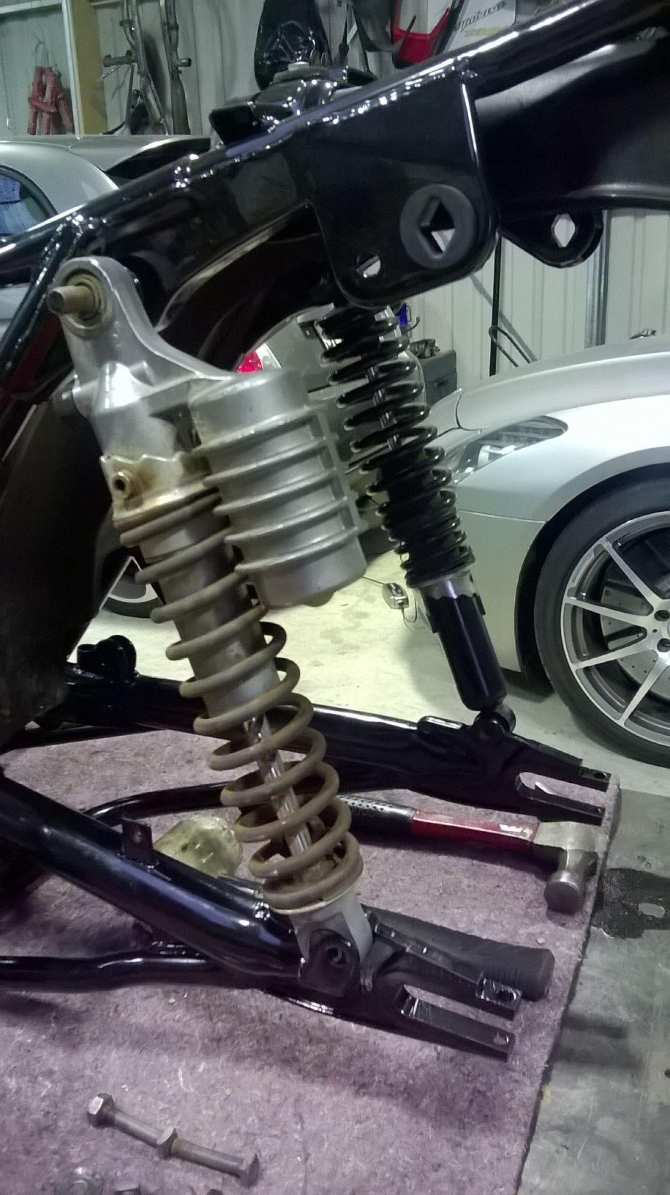

18 Aug 2016 23:16 #739208 by larriken
While I was on a role I thought I should get off my arse and fit the swingarm that has been sitting there looking at me for ages. Bam! It's in! Should have done that a while back but just been a bit busy with work and other peoples bikes lol. Have changed my mind about ten times on rear shocks and currently don't have a set. I would still like to go with a piggy back style shock and still pondering the best way to lay down the shocks a bit more but I will keep working on this one.

19 Aug 2016 05:54 #739218 by 531blackbanshee
Replied by 531blackbanshee on topic Kiwi Z1R
nice job on the rotors!
they actually grew hair eh? :whistle: :woohoo: good save,or shave as it we're :P
arm looks good in there.
are you wanting to lay the upper shock mounts forward like the sanctuary guys etc.do?

20 Aug 2016 20:31 #739354 by larriken
531blackbanshee wrote: nice job on the rotors!
Still think I will do it by going backwards with a bracket off the rear of the swingarm. Not 100% yet but will get a bit more serious once I have the bike up on wheels.

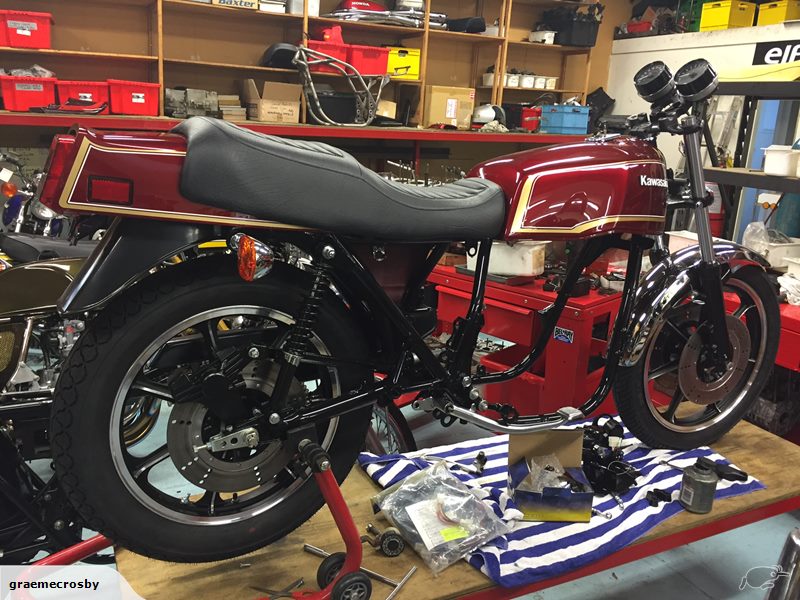

20 Aug 2016 20:34 #739355 by larriken
Anyone remember that horrible looking looking MKII of mine that I swapped with Graeme Crosby? It's coming back to life.............
