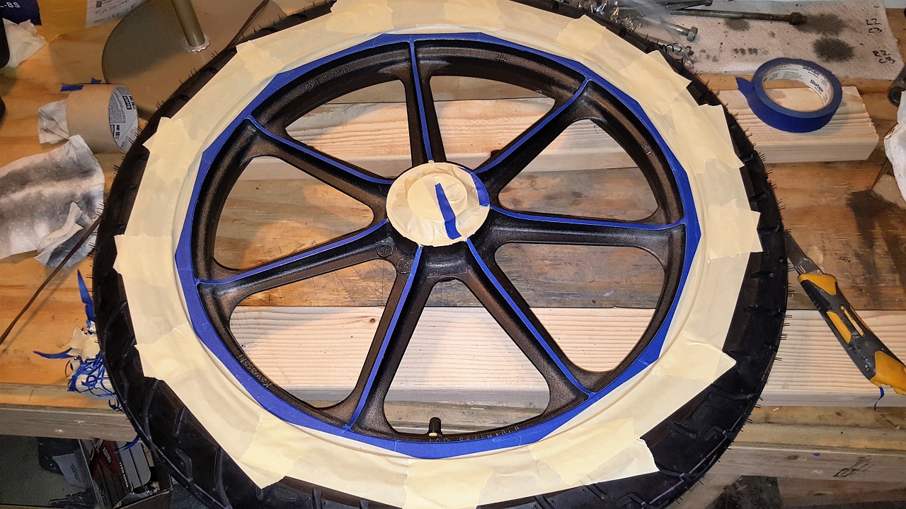

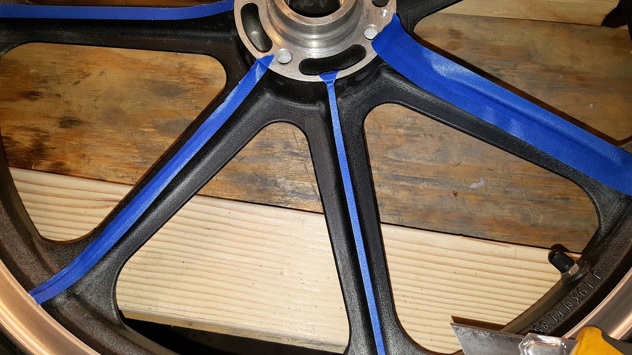

First step was to mask off the wheel spokes:
I am cheap so I masked-off one spoke and then carefully sliced-off the excess and re-applied it to the next spoke.

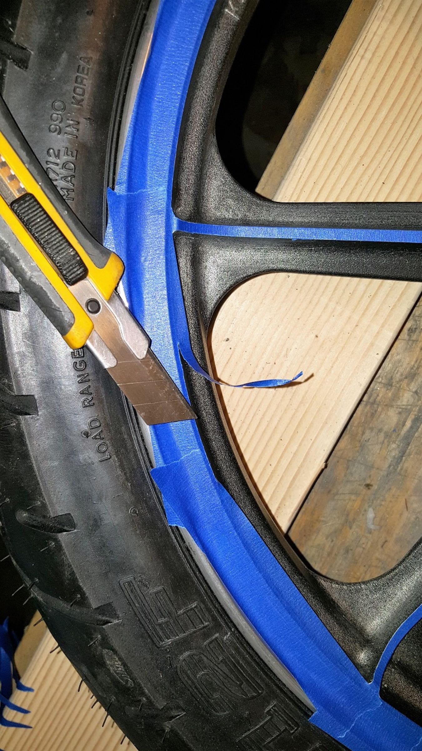

Then it was onto the nicely polished rims:
I applied short lengths of masking tape around the wheel's perimeter and then came back with a razor knife to neatly slice-off the excess, following the inner radius of the polished face in the same manner as I did the spokes.

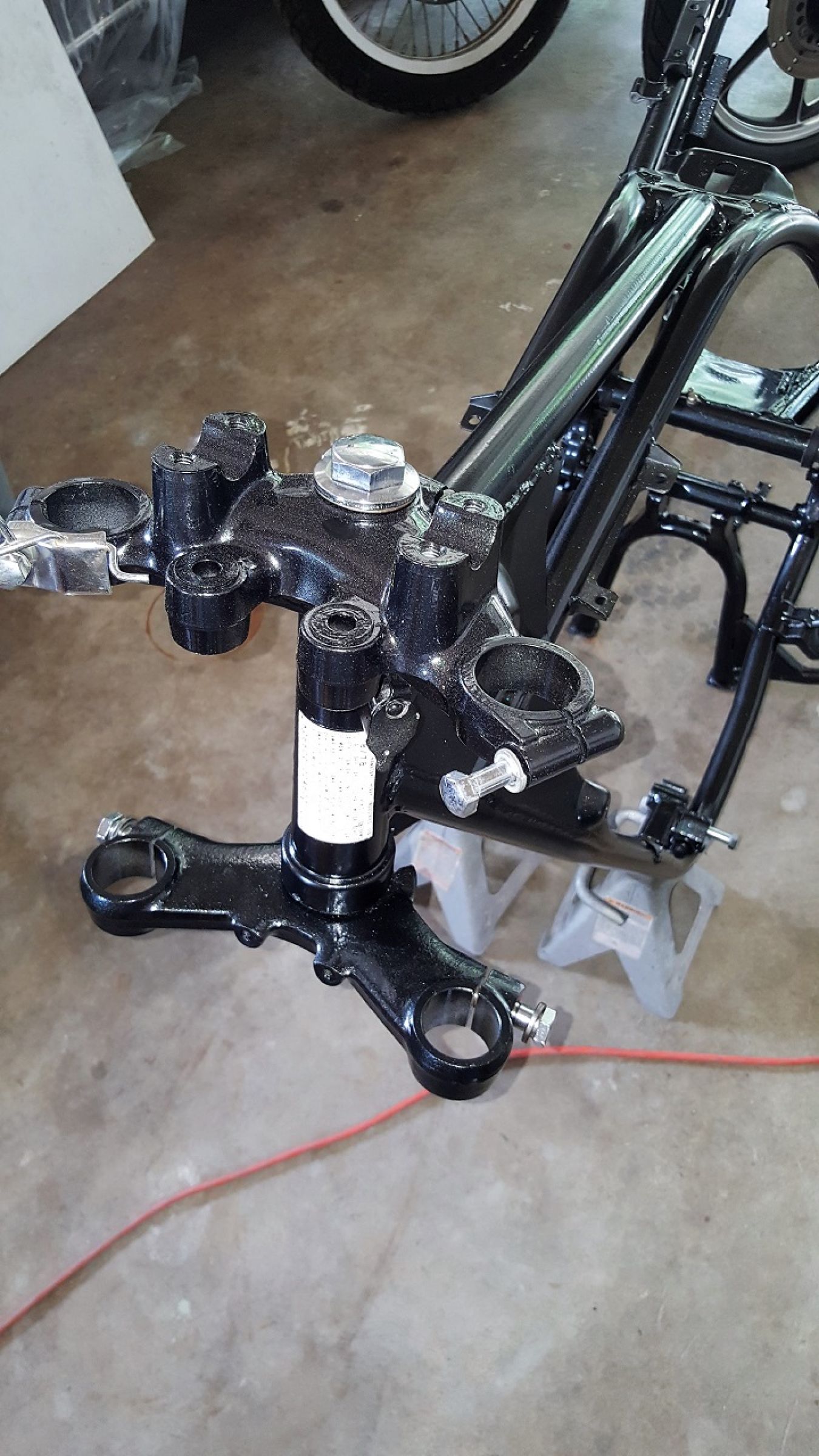

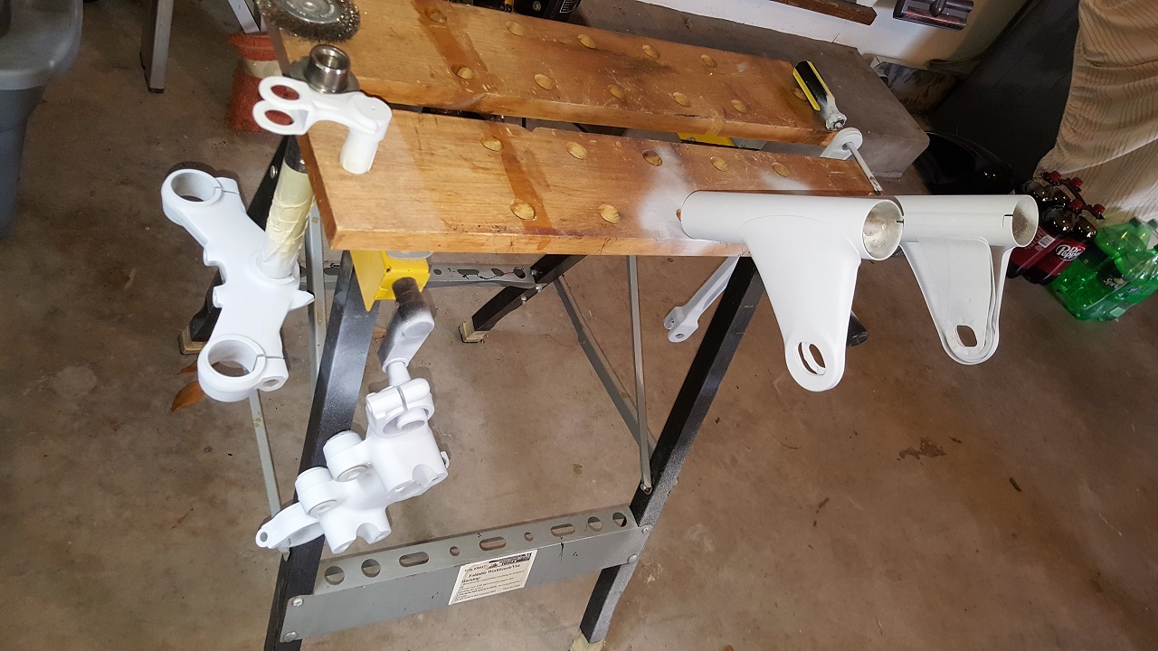

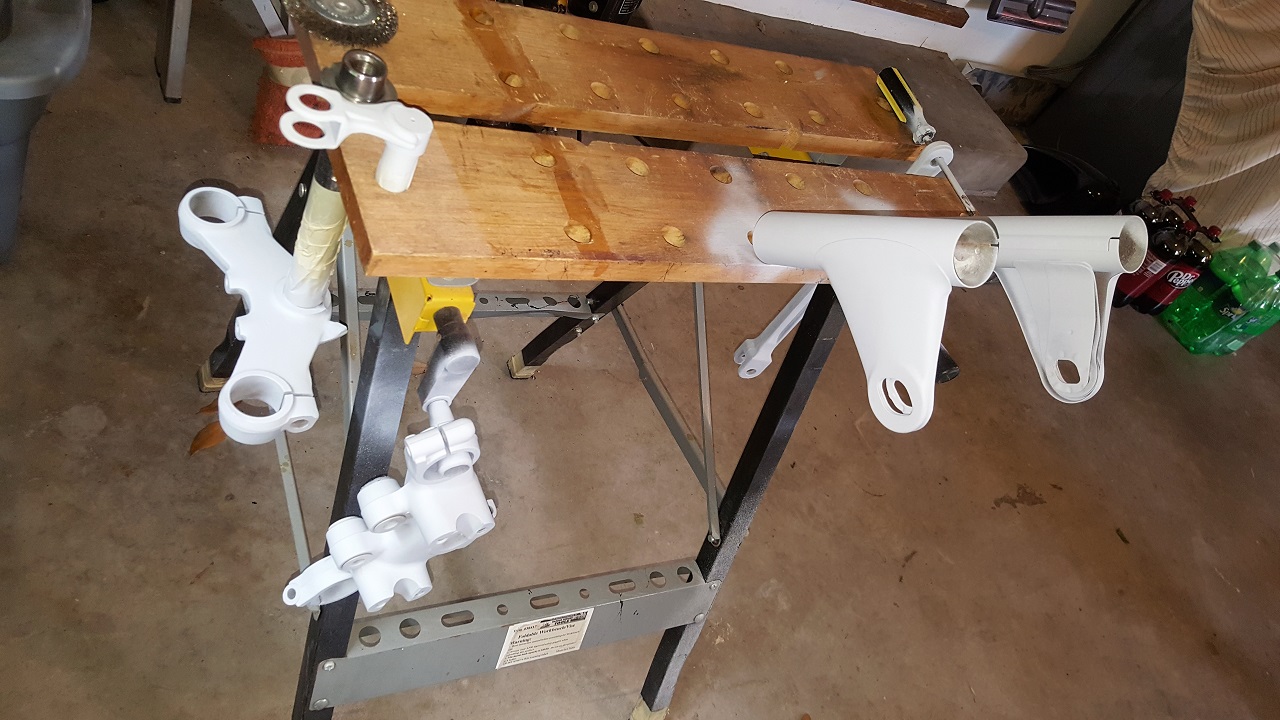

By noon, I had all the random engine mounting brackets, brake torque arm and triple tree pieces etc cleaned and primed:
I had to pretty much turn every workbench and spare tool into parts hangers for the priming and painting to come but it was easy and I just enjoy this part of the restoration. So it was onto the first stage of paint - the Harley Black Pearl Metallic went on easy as you please and covered well considering. The first stage of a two stage paint is very ... erm ... thin is probably the best descriptor. It goes on very easy but thin, so you have to apply several coats and keep in mind that you're dealing with a metallic so the paint pattern has to be cross-hatched in order to prevent so-called "tiger striping" in the paint. Still with mostly small surfaces it was easy.

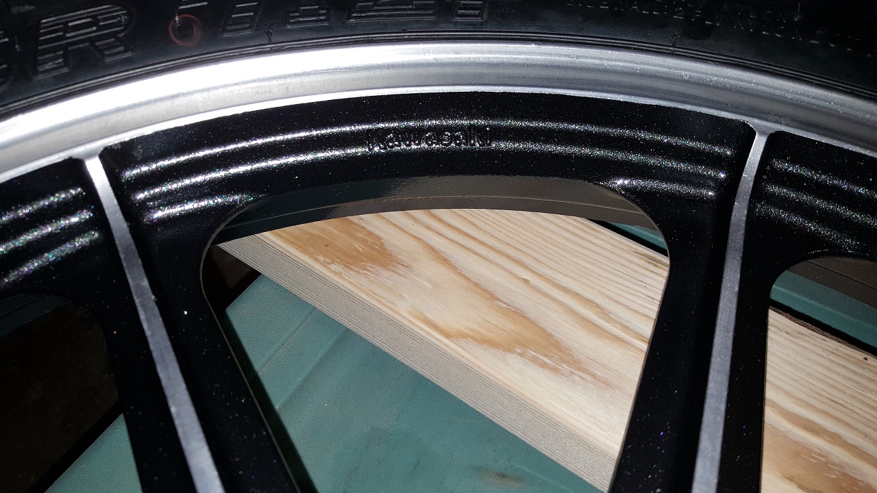

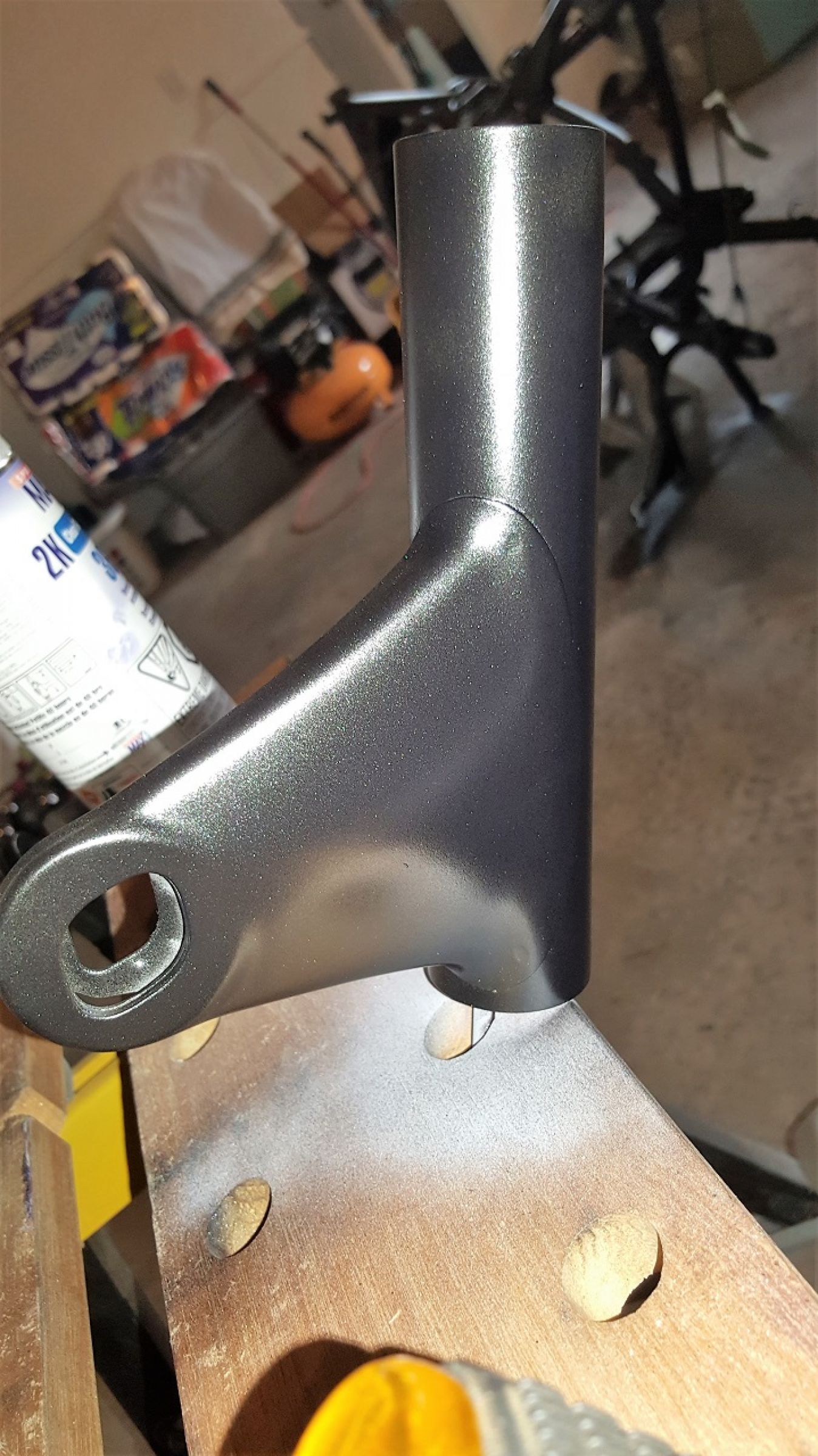

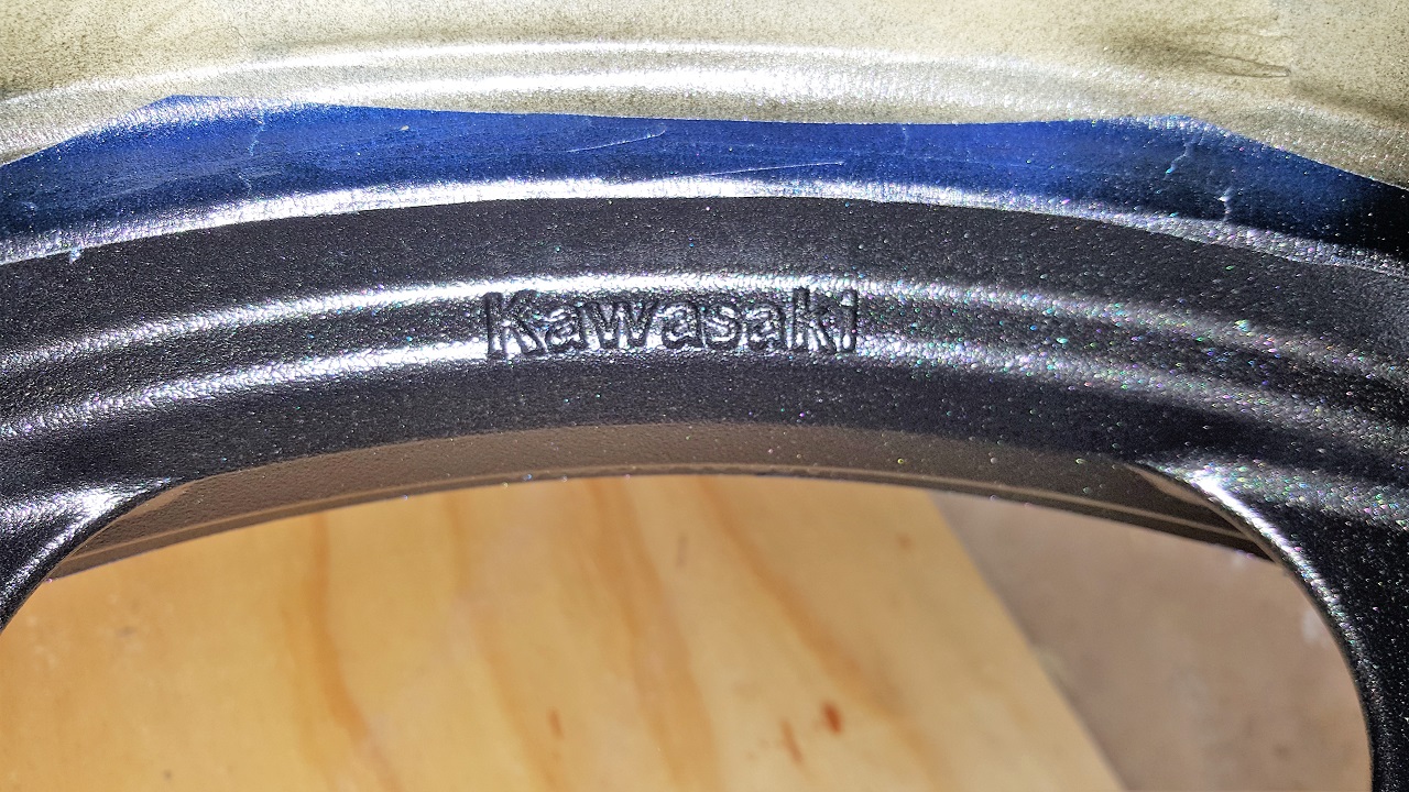

Here's a close-up of a wheel. Can you just barely see pearl?

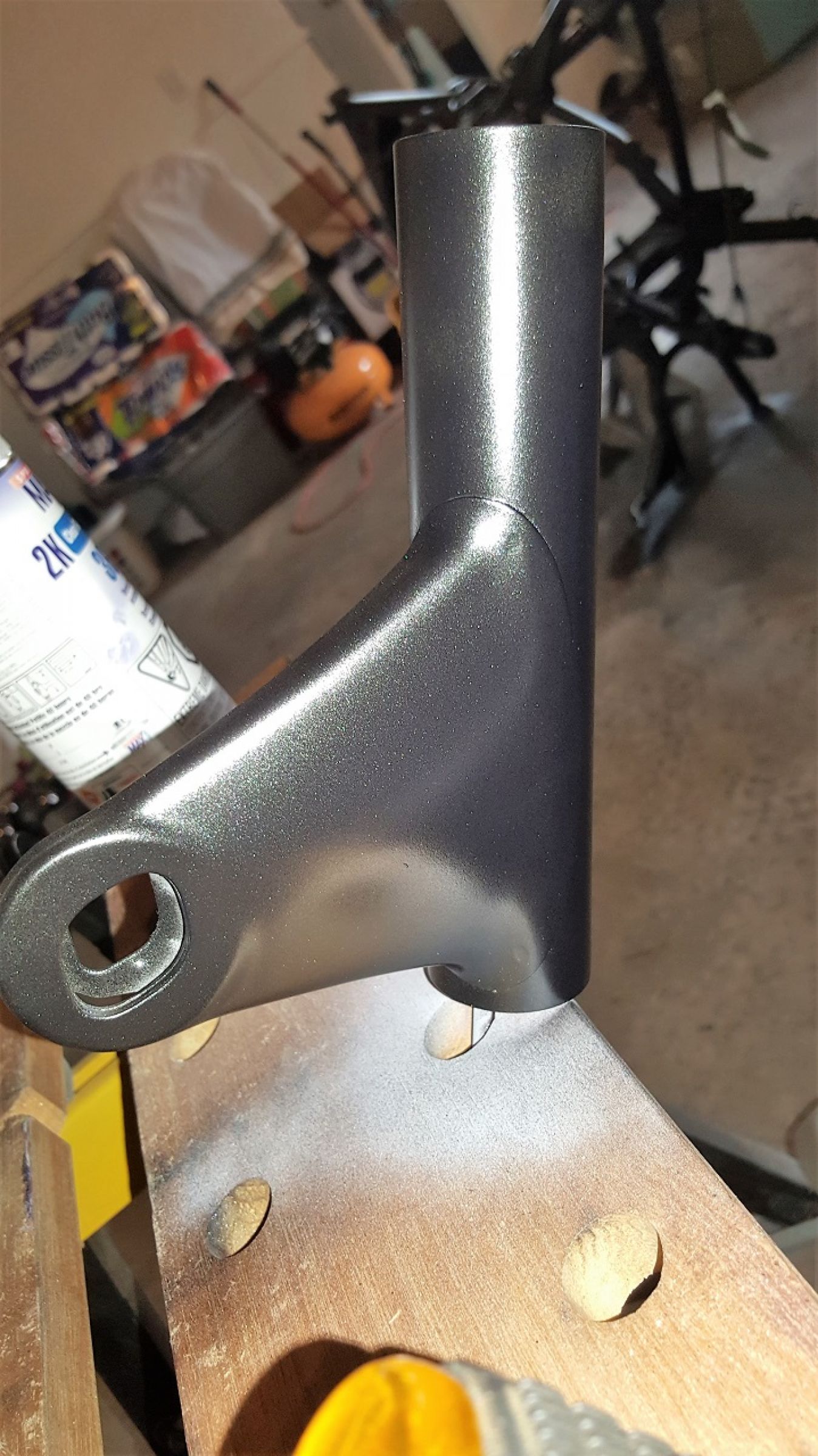

Here's another piece; the headlamp ear:
You can see that it's kind of shiny but closer to satin than gloss. Again the pearl metallic is not readily visible.

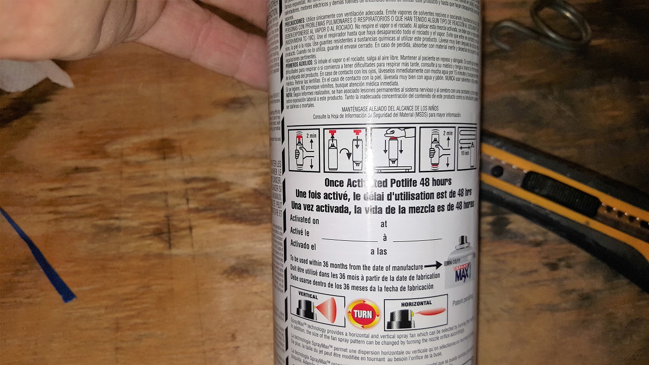

Then came the clear coat which is the second phase of a two stage paint system. If you ever wondered how they can sell a 2k paint in a "rattle can". Well, wonder no more. Their dirty secret is now revealed:
Basically, shake the can, remove a sorta nozzle looking attachment in the cap and then press it into the bottom of the can which looks like the top without a nozzle present - just a sorta nipple and when you press the attachment into the base it releases the catalyst into the clean inside. Then just shake another couple of minutes and begin shooting stage two. Easy right?
I discovered that the first stage and second stage cans did not have that uber cool adjustable nozzle with the rotary dial on top. Only the adjustable spray patter to set your paint "fan" vertical or horizontal etc.

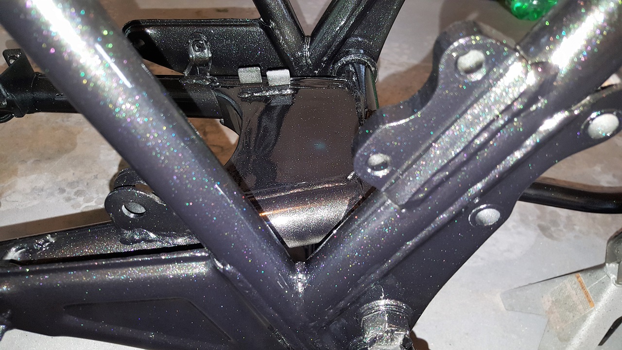

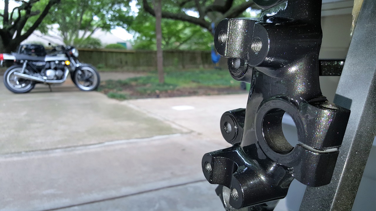

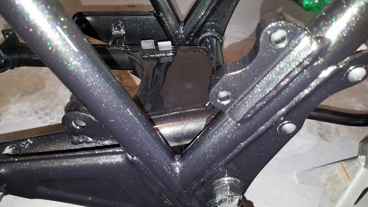

Have you ever seen a black, pearl, metallic paint? Come out of a rattle can? After clear coating? Aren't you just itchin' to slap me and say "show me the damn pictures already!" ? :laugh:
It actually took me several tries to capture the effect. It's very subtle but I finally got a couple. Only close-up showed it:
Wow! This pops! :woohoo:
The wheels are wee bit more subtle. Almost looking stock. (This is after I unmasked them...)
The upper clamp of the triple tree shows it most like what it appears in person.

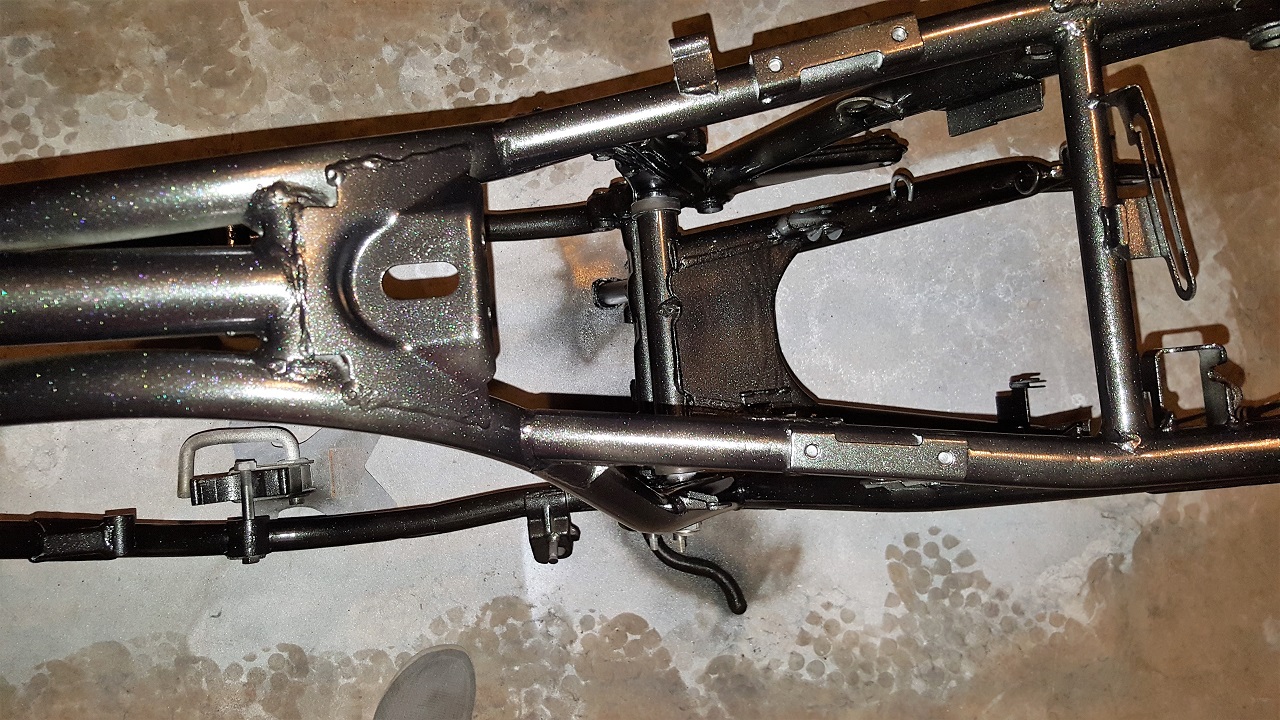

Re: KZombie
14 May 2016 19:59
I'm ok with the results. It's dry & hard. Never got cloudy in the clear coat

Re: KZombie
14 May 2016 20:05 - 14 May 2016 23:12
Last edit: 14 May 2016 23:12 by wrenchmonkey. Reason: Add picture

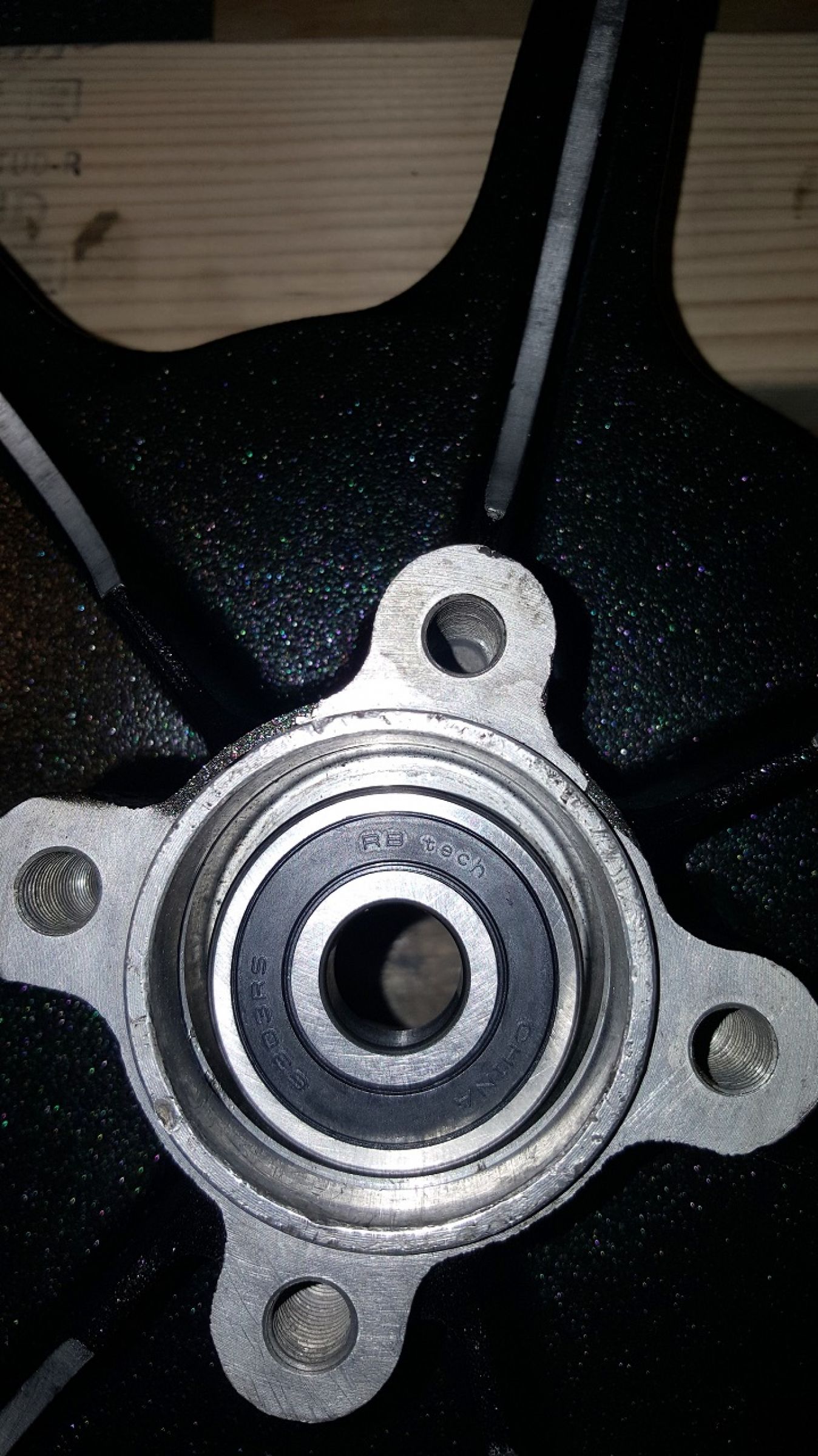

Um? Houston? We have a problem... The 2 smaller bearings for the rear wheel were too small ! :huh:
So I pulled the original bearings out of the baggie I had put them in some weeks back and commenced to teasing my brain into thinking maybe, just maybe I could make these old things work. After all, they have less than 20k miles on them. So I bathed the first one in some WD40 to clean out all the old grease. It looked good! Then I rolled it in my hands. Not so bueno
Sounded like there were rice crispies mixed in with the ball bearings. No amount of cleaning would remove that crunchy sound while rolling the bearing in my super oily hand. Sadly, I know what the cause of this is - rusted balls. Old age. - The bearings not me! The same thing happened with both the upper and lower steering stem bearings. The races were great but moisture attacked the balls themselves and they rusted and pitted and would randomly crunch through rotation.
