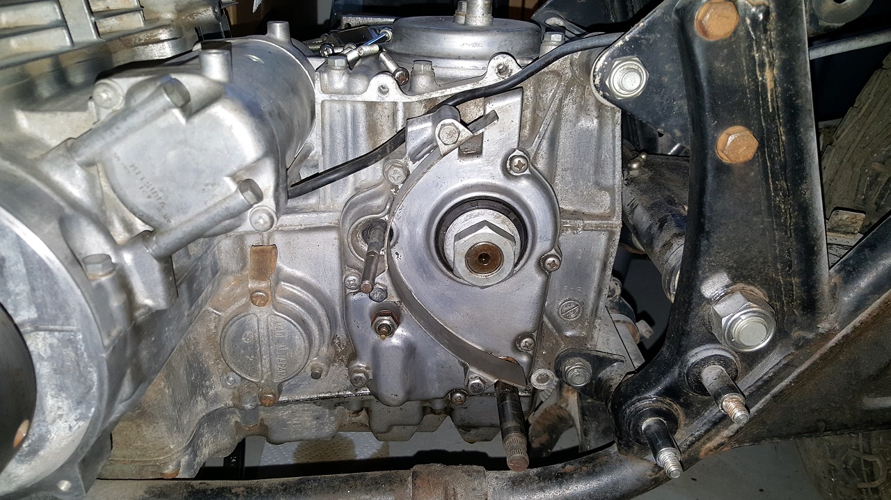

So waiting impatiently all week, I received my new stock sprockets and chain in the mail. I chose to stick with stock 16/42 sprockets and a 530, 102 link chain. I almost clicked on the link to buy a 17/40 sprocket set to try and achieve lower RPM cruising speeds on these 75 MPH highways here in Tejas but it occurred to me that I should probably stick with stock, at least for now, so I can make all comparisons to the manual when the KZombie rises again.
Thus, I had to get that engine sprocket off. Well, I've been spritzin' PB-Blaster on pretty much every nut and bolt on the bike since I first dragged it out of that field years ago and thought for sure I could slap the 32mm socket and a 30" breaker bar on and pop that nut. Mmm? Yeah. Not so much. The manual stated this nut is on with 54 to 62-ish ft/lbs of torque but as you saw in the video above, this one must be more or been glued on. Anyway, cut to the point. I took the advise of the boys here and bought an electric impact and in short order that nut was off!

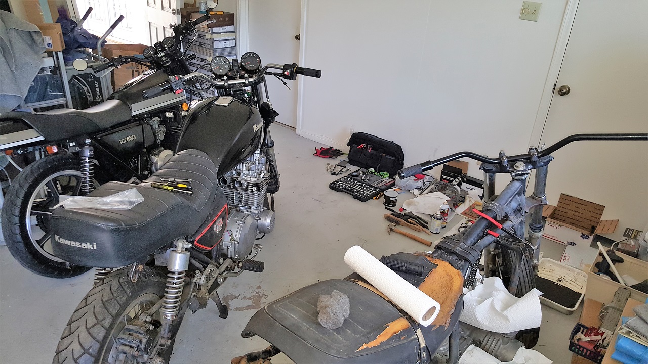

You can see KZombie in the foreground is now sporting the SE sport bars and has one of the new grips that were previously installed on the 1000 sitting to it's left. The 550a is in the far back and has the same sport bars as KZombie now. The 1000 has the chrome bars with a wee bit more rise and sweep.

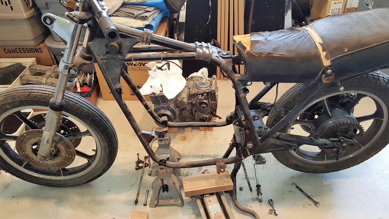

OK. So that went relatively smooth. Now back to the real task at hand - pulling the engine from KZombie. In the pick above you can see the engine is still in the frame and covered in paper towels as all the case covers had been removed.
Turns out pulling the partially dismantled engine was a real bueno. Like always, all the nuts and bolts loosened easy. Stuffed a couple of jack stands and hydraulic jack with a piece of lumber under it and pulled the puppy myself in like 30 minutes:
So I'm leaving the engine like that until the frame is cleaned-up and repainted and then I'll install it and assembled it in the frame to make man-handling it's weight easier on my girly arms

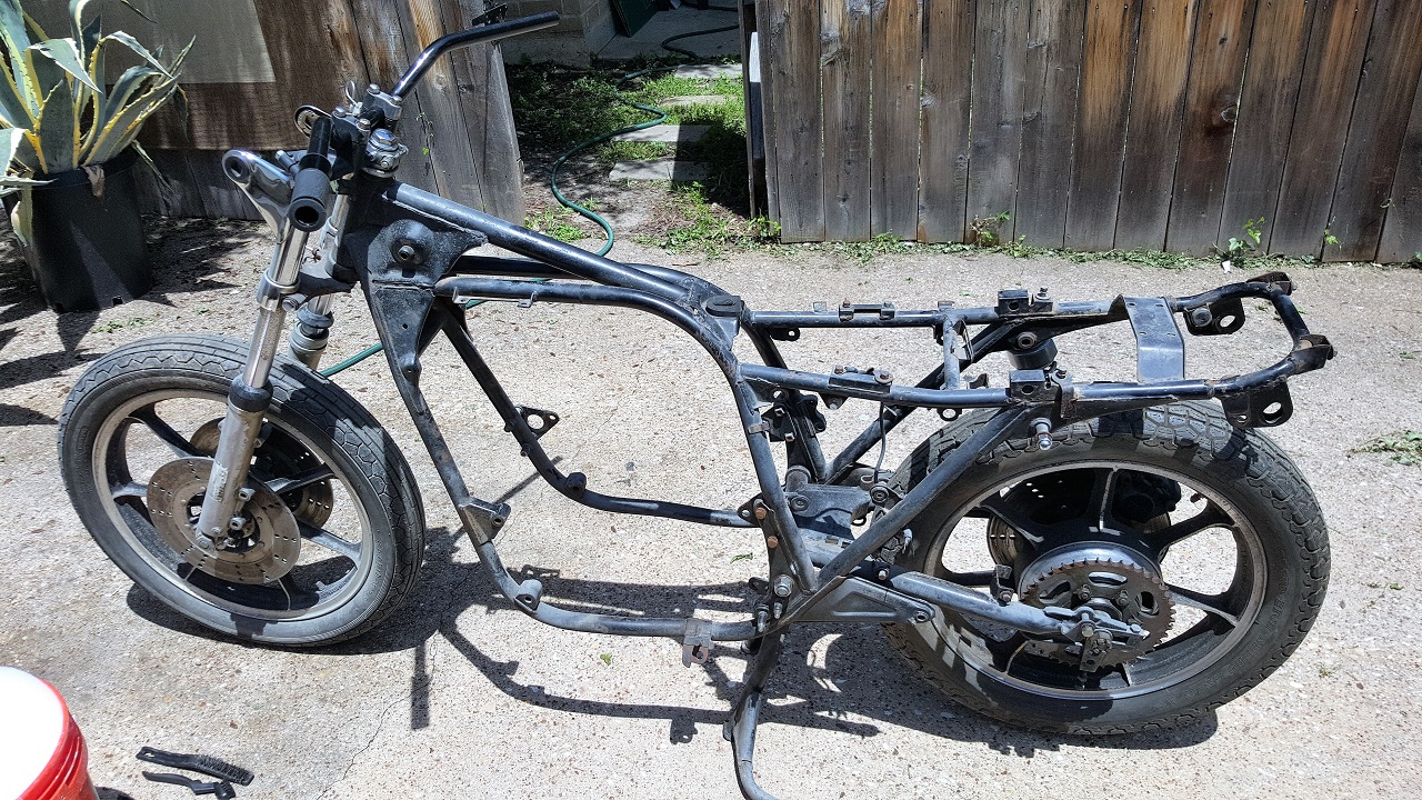

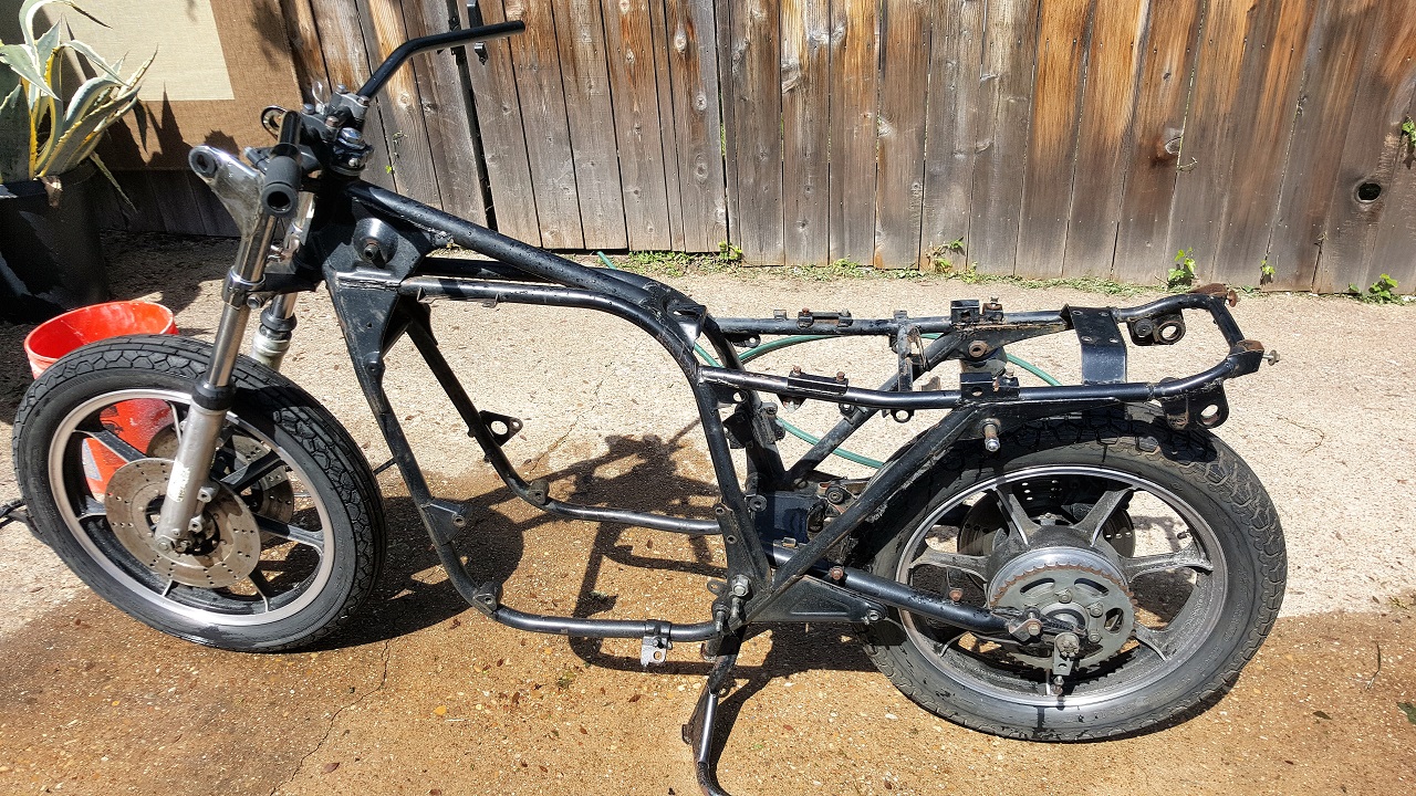

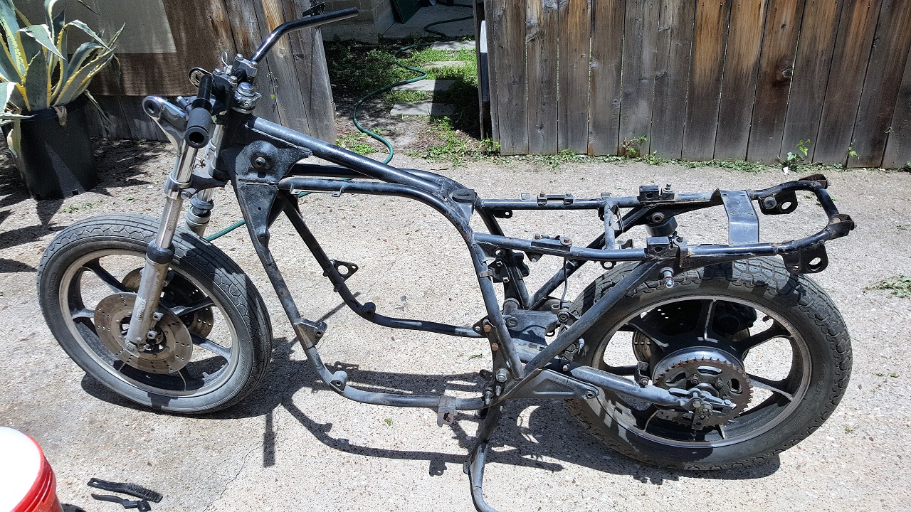

Then I shuffled all the bikes around again and rolled the KZombie frame outside for a bath:
That vintage gray cast on the frame is pure neglect. Dust and paint booth fall-out from a few years. I was really thinking this frame was going to clean up nice and easy but damn that was not the case. I had to take wire brushes and a hot bucket of soapy water and scrub the thing down. I even had a scrubby pad (like you use for dishwashing - scotchbrite on one side, foam on the other) and it wouldn't or couldn't remove that dust. Thank goodness it was an awesome day outside. I just sat in the driveway all day scrubbing and brushing and scrubbing more until I got to this point:
You can really see how the frame is black again. Gone is that gray over-spray-dust layer. Unfortunately, removing that dust-paint layer revealed the frame is pretty gnarly. I was planning to just lightly sand and then spot prime and paint it but now it seems that would be insufficient. On the plus side, L@@K at those wheels! Dayum! They came out pretty nice and that was just a brushing. I will have to paint them again as the black portions of the rim and spokes is pretty worn-out but the alloy shined up great and for this I am happy.
