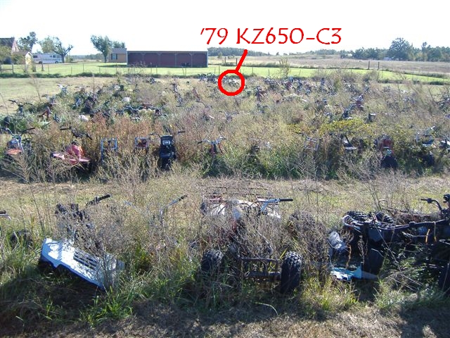

I found this bike at an auction back in 2007:
Incredibly, I spotted this and managed to make my way to it without anyone else showing interest and without picking up any chiggers or ticks!

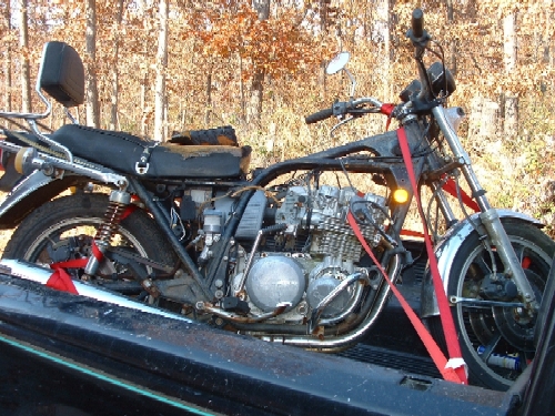

An hour or so and a gavel drop later and it was mine and brought back to the shop:
It was pretty ugly and obviously going to be a long-haul restoration but it had some good points.
Low(er) mileage:

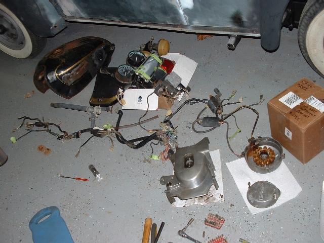

It was "stock" black (or so I thought). It had some "extras" like engine guards and a luggage rack:
My son (pictured above) helped me get it rolling and brought it into the shop. He had picked up a Suzi and a Honda at the same auction so we had lots of hours wrenching together on them and managed to get his Honda actually running and functioning nicely in just a few days. The Suzi (was a GS550) wasn't so lucky.
This KZombie was...reluctant is probably just the term, so I began the long process of tearing it down completely because I just couldn't for some reason, give up on it:
I managed to get some things accomplished including ordering various parts (some I had totally forgotten about) and even got the carbs rebuilt:
The lad and I wrenched for a few days and I really enjoyed the hell out of it. I had high hopes for this '650 being on the road soon:

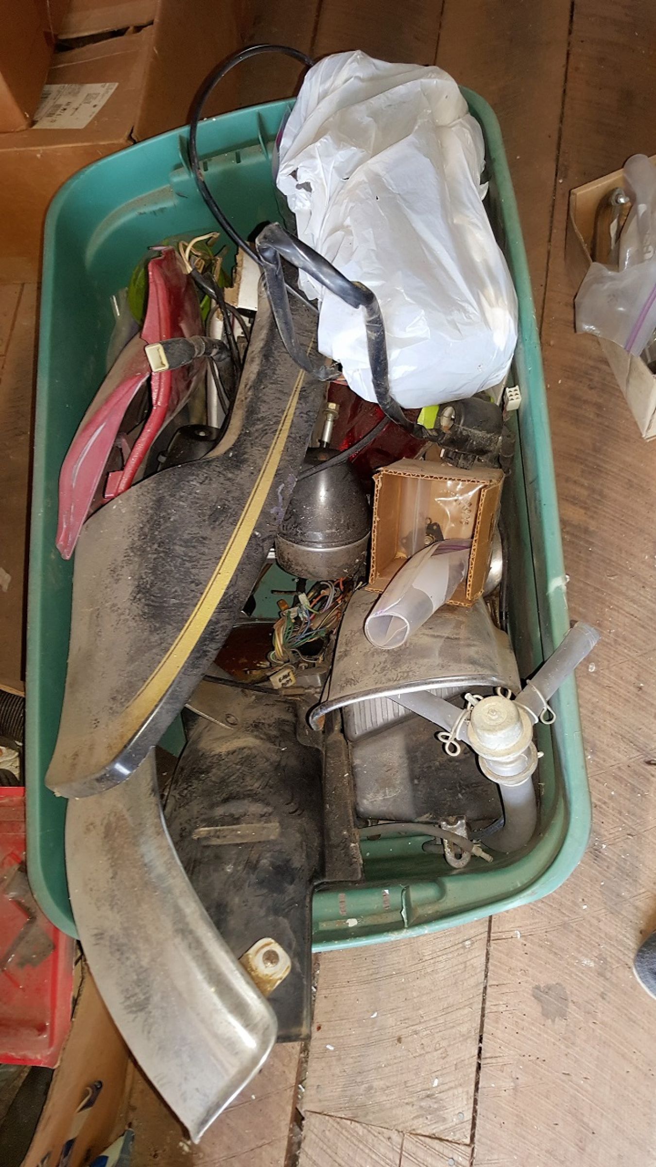

I re-discovered all the parts I had carefully chunked into a tub or left for the mice to play on:

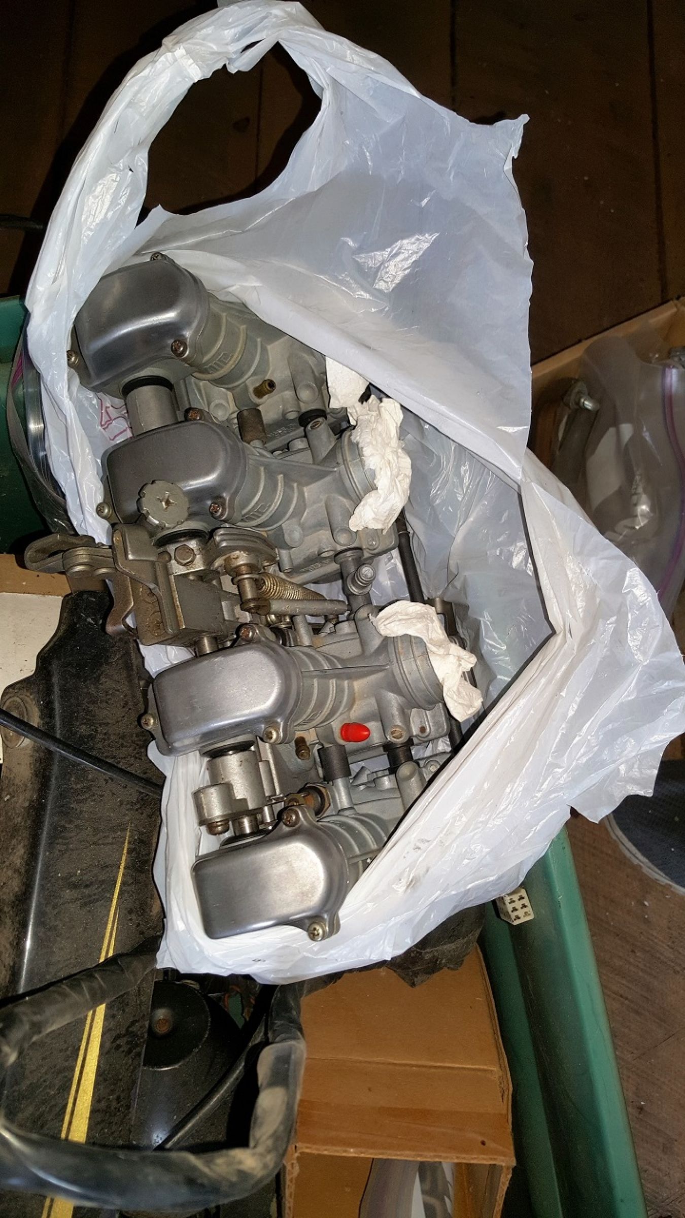

And.... was so happy to see these carbs were still as clean as the day I rebuilt them:

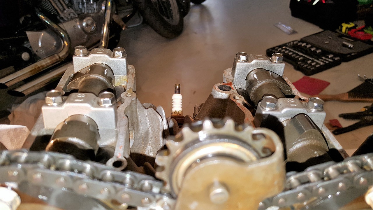

What I wanted to achieve today was to confirm the engine's compression and discover the state of the valve clearances. I have done this before on the 550a so I was hoping for some reasonable progress.
Sadly, the KZombie was not cooperating and I ran into an issue:
- This bike was bought at auction "as is" - missing the cam chain tensioner - which I purchased way back when and installed. I was able to spin the crank full circle without any binding then.
My problem now is that the camshafts seem to be out of sync. My manual is "in the mail" so I've only had the info I could gather from the forum here. Much of which was based upon other model years of 650, so everything was interpreted.
Here's a pic of the situation:
In this picture, the crank is at TDC #1 & #4 mark. I had the the cam shafts aligning (it seems) based upon another forum member's picture from his manual. I drew a GREEN line across the cam gears alignment marks. The problem is, the cam lobes for exhaust (far right, in red) and intake (far left, in red) are not aligned with the case top there.
When I did this job on the 550 a month ago, the two lobes (of any cylinder) aligned like the drawing in the manual - lobe pointing along the case top.
But this is not happening here. While the exhaust lobe is aligned as I expected, the intake lobe is pointing downward at about the 7 o'clock range.
So, initially, I thought perhaps this was normal since I didn't experience any binding during crank rotation and I decided to measure the valve gaps on cylinder 1.
The measures were .10mm on exhaust and .35mm on intake. Hmmmm? Not correct.
The only thing I could find via the forum on what the gaps should be was based upon a 1981 kz650 which states that BOTH the exhaust AND intake have the same range - .008 to (i forget now, it's written down in the garage) but point is I was way out on one valve and possibly right on the other.
To compound things (argh!), I decided to remove the cam chain tensioner since I knew I was going to have to reshim anyway but then as I slowly spun the crank from TDC 1 toward 2/3, the cam chain jumped. Now for sure I am no longer in-sync between the two camshafts.
I shoulda' had more coffee I guess. Sigh.
Lastly, are these camshafts stock? They do not have the same reference lines as shown in the 1981 manual I downloaded but they seem to match those in a picture posted here by another member.

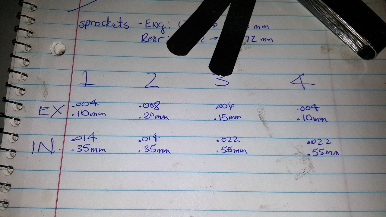

I finally, after an entire day of putzin' with this got to measure the gaps so I could ultimately try to take some compression readings and get an idea of the engine's health.
Here's the valve gap measures:
Hmmm? Suspect...
As of right now, I'm still unaware of what exactly the range of these valves' gaps should be but at least I know they're not so tight as to be holding open the valves and thus messing up compression readings I want to take... tomorrow. LOL

Spun the crank through several careful rotations and just like it was, no problems. I guess this is the correct setting even while there was nowhere near the number of chain-link-pins as prescribed in the '650 manual above; it worked so who am I to argue?
Hmmm? Suspect...

Looks like the intake valves have been nicked.

Thanks for the help Steve. I fear I may be in deeper water than I'm comfortable with. What do you mean by nicked? The valves themselves have a physical problem? I still want to do compression test tomorrow. Will that reveal the nicked valves?

Bent. I've had that happen. It don't take much. I hope I'm wrong.

You need a 79 KZ650 manual ...... the correct pin count on mine (78) is 36 should be that on yours too..... search "KZ 650 first time valve adjustment" it has info and a good pic but you still need the correct manual to get it right..... "But" as Steve says sounds like you have 4 bent intake valves due to the large clearance.......... Not sure if you should do a comp test till you have the cams right but as Steve says again I think the damage might be done already ...... hope I'm wrong too.

Ah. Ok. I understand now. So essentially the intake bank of valves are stuck into the combustion chamber & not fully returning to seat. That makes total sense.
This engine spins freely thru all cycles, so this is why i wanted to do the comp test.
I do have a complete engine gasket set so if a tear down is needed, i am willing but maybe not quite ready until my FSM arrives. Lol
