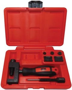

While I'm waiting for the brake lines I went back to work on the drive line. I had failed to consider how one might add a master link to an RK O Ring chain. The answer is you can't, not without a special tool to press the side plate onto the pins. I decided that the rivet style master link was the only safe way to go so I dumped another hundred on one of these:
Once I had the chain cut and installed I lined up the sprockets and welded the pinch blocks to the axle tubes.
