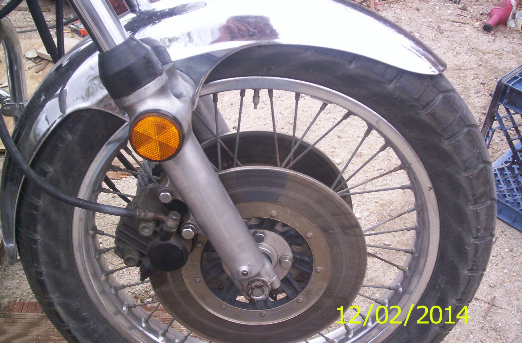

That must be a KZ 900 front hub. No matter, the disks are easier to come by.

Awww, really? WTF. Can you elaborate please Steve?
EDIT: Nevermind, I used the Google machine and found knowledge. Stock wheel has the black flange, larger hub, eh?

The Z1 had a different axle style and the hub had more holes. I went to a KZ 900 hub because I had two disks for it. Good thing too. I was able to buy two drilled disks for next to nothing. The Z1 hubs are pricey.

Thank you Steve. There are Easter Eggs (hehe) aplenty on this bike, more to come I'm certain. At a glance my hub looks smaller, and that makes me think my new spokes aren't right for it. Do you happen to know?
