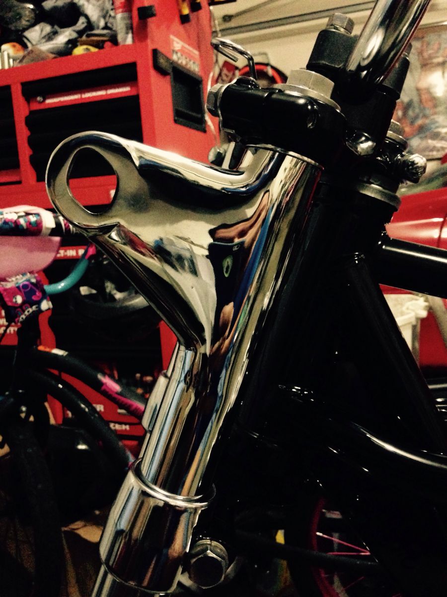

yes patton steve is referring to the ones in the headlight mounting.
Re: The Friendship Bike - NobleHops restores a 75 Z1
17 Jul 2015 06:18
Yes I'm talking about the rubber dampers on the top and bottom of the fork ears.

Which part on this diagram is rubber? I see #14 "gasket" but the other two (13 and 9) I'm pretty sure are the metal ones.

#14 is rubber. I had two on mine. Top and bottom.

17 Jul 2015 07:49swest wrote: #14 is rubber. I had two on mine. Top and bottom.
2 a side would certainly prevent anything rattling! I do not see it in my disassembly photos but I wasn't great about photographing that area when it came apart either. I'm going to spend an hour re-sorting parts today, old and new and see if they turn up.
Thank you Steve, and all of you guys that are following along, I really appreciate you speaking up when something is incorrect.

I tried a toilet gasket. It worked for a while but came apart. Next will be some fat O rings. I'm sick and tired of paying for gold when all I get is NOS SHT.

17 Jul 2015 09:41swest wrote: I tried a toilet gasket. It worked for a while but came apart. Next will be some fat O rings. I'm sick and tired of paying for gold when all I get is NOS SHT.
That's the right idea right there: I've got a couple of O-ring sets, perhaps one of the big ones will work perfectly for this. If not I'll buy a big giant one from the hardware store and slice and re-glue it to size. That'll work great and I can button that up, and not have to wait a week for some overpriced NOS Kawi part. Stay tuned, I'll show what I figure out.

Now I wish I'd measured the bearing stacks, old and new, we'd have some data to make sense of what I found. Does the 76 have ears between the triple clamp and the top clamp like my 75 Z1? And if so, did yours fit snugly with no vertical play when you were finished?
