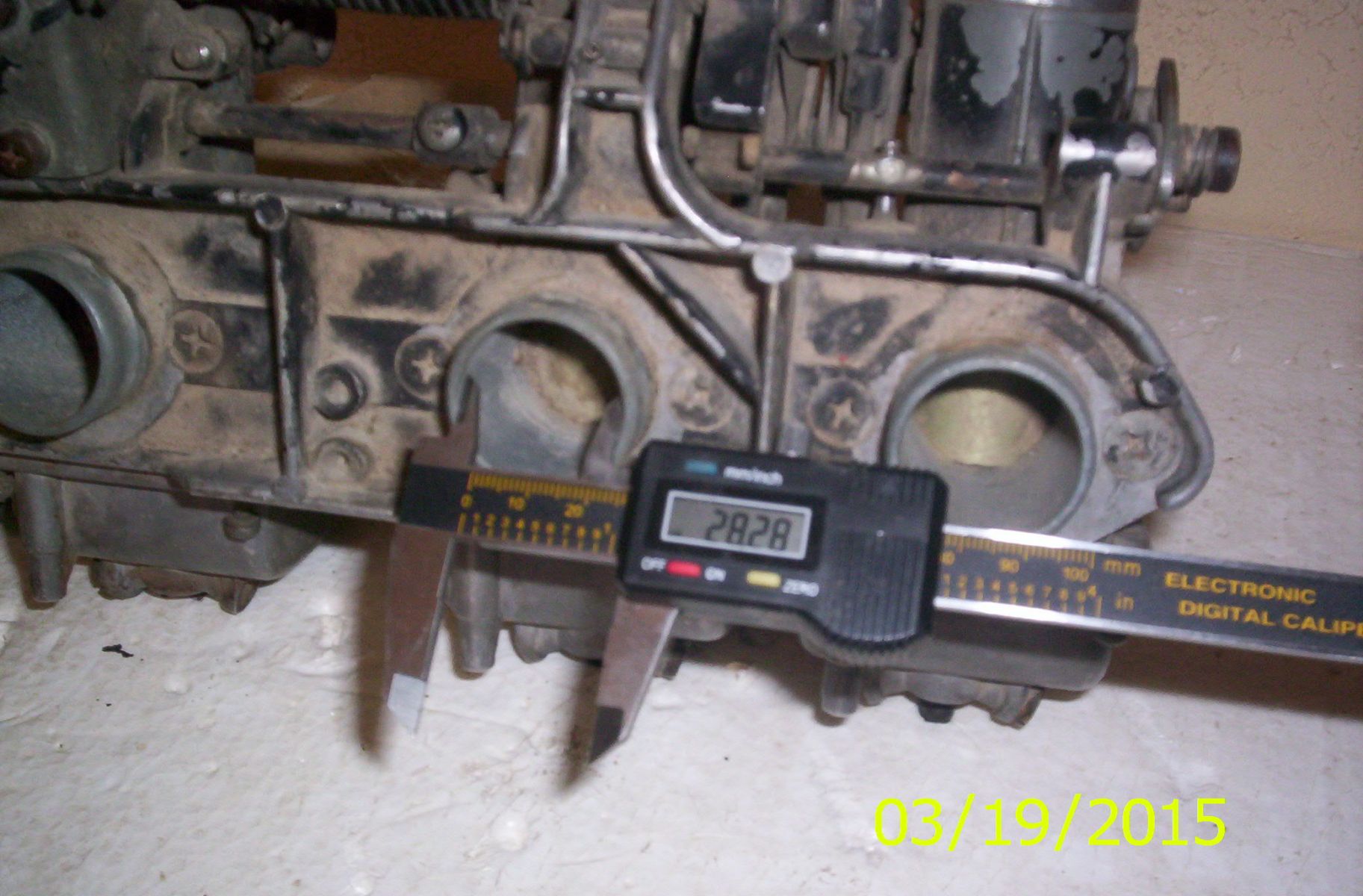

19 Mar 2015 14:40swest wrote: The pilot jets are correct and the main should be 112.5 but the 26's were on the KZ 900 and KZ 1000. Too bad they're not 29's. They were the hot setup for the bike. You can get stock 28's if you want to keep it stock. That will depend on how much has been changed. Z1E has a chart of codes. I'd compare the parts to see if it's a clone or not.
Great info, thanks a bunch.
I am not shooting for a highly original result, it's going to have a bunch of repro parts on it and it has a Dyna ignition already. Going to get Cartridge emulators, better shocks, etc. It might make sense for me to see if I can find a set of 29s before I rebuild these - I'm going to be buying jets and and and.
I'll go look at that carb info in more depth tonight, see what years had what carbs and see what I'm shopping for.

Yeah, all research says these are KZ900 carbs, and a quick skim of eBay shows that the 29mm smoothbores fetch as much as $500 for a set, Probably not in the cards,

No eBay APP ID and/or Cert ID defined in Kunena configurationHey-O, whaddya think about these?

1978 KZ1000-D1 (cafe racer) and 1979 KZ1000-A3 (Mark II) and 1979 KZ1000-D2 (cafe racer) came with Mikuni VM28SS carbs (being the 28 mm carbs with three-screw top caps).
1976 KZ900 came with Mikuni 26 mm carbs.
28 mm carbs were not stock carbs on KZ900.

Those look like 26's not 28's.
If your not concerned about being original, the 26's will work. 28's would be good but the 29's are best. Don't fall for phony's on eBay.They just want your money.

KZ900 26 mm carbs came with the dual fuel lines as shown in the ebay ad.
I might be mistaken, but thinking the 28 mm carbs came with a single fuel line.
Re: The Friendship Bike - NobleHops restores a 75 Z1
19 Mar 2015 17:22
Didn't the good 28's come with a accelerator pump on one bowl?

VM29 smoothbore would NOT be a good choice for what you're doing.
they were designed as a full on race carb. for road racing
and don't really have good idle/off idle manner's.
I run a set on my GPz750 motor and they have been a pain in the ass
to tune at idle/off idle.
Unless your building a hot rod motor they'd be a waste of money
VM28's would be a way better carb for the bike.

My 28's have duel fuel inlets.

They are definitely 26s, have dual fuel inlets, and the petcock has dual outputs obviously. They are in very good condition, and they have the common throttle shaft that some folks seem to think makes it easier to keep them in sync from what I read. So I'm gonna stick with them, give them a full strip, ultrasonic clean, swap the main jets for a smaller size and make sure the needle and air screws are adjusted correctly.
