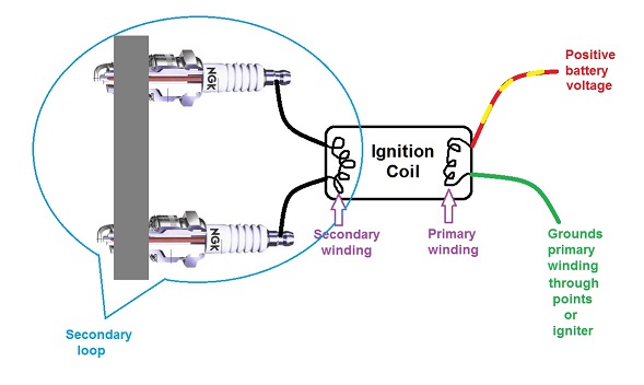

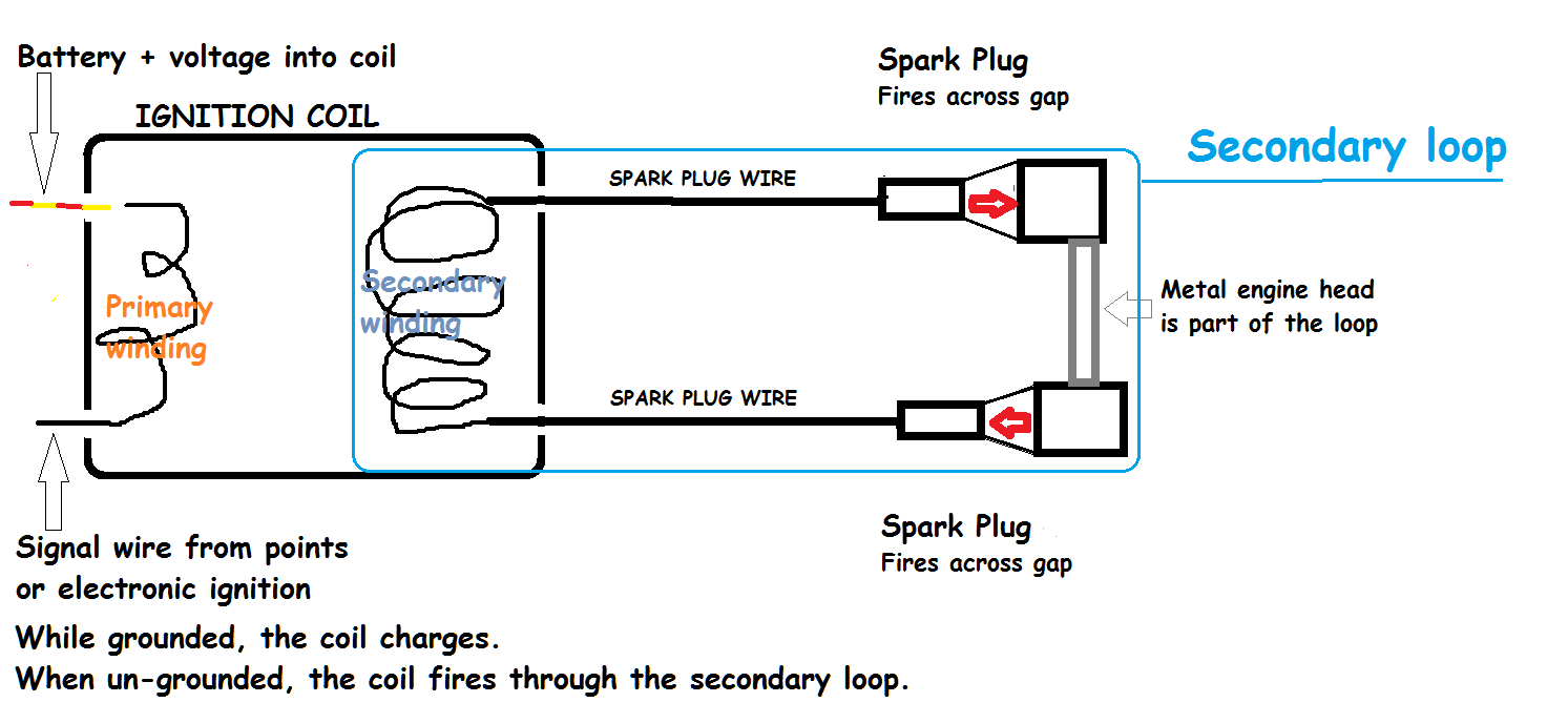

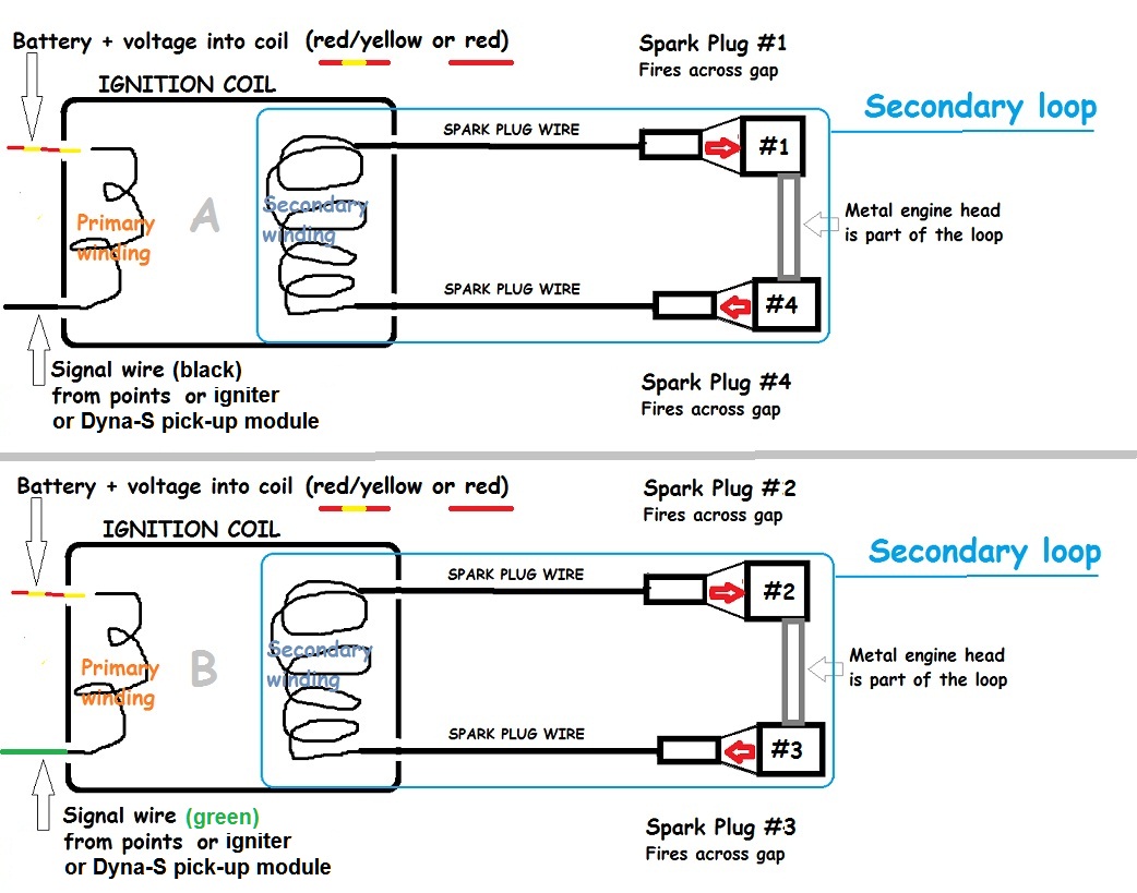

Ugh i am not good at electrical. Even with the diagram it seems imposible.
'80 Kz1000B4
MTC 1075 .375 webcams Mikuni RS34
KZ440 Project
81'KZ750E2 Project
Past- '81 Kz750H
KZ440 Project
81'KZ750E2 Project
Past- '81 Kz750H
- Posts: 18564
- Thanks: 2103
Re: Kz1000B4 Ground Up.
16 Sep 2014 11:00
Sometimes helps to keep in mind that the ignition circuit (to produce properly timed fat blue sparks) is all that's needed for the engine to run and perform normally.
The diagrams are to help visualize how the ignition circuit functions.
Battery positive to the coil "charges" the coil while the coil remains grounded through the points/Dyna-S/igniter.
When the coil becomes ungrounded (by the points opening, or the Dyna-S magnet passing by the pickup, or through the igniter), the coil "fires" through the secondary loop (including both spark plugs).
When again grounded, the coil re-charges, and so on.
There's other wiring for chassis components (lights, horn, etc.).
And more wiring for the charging circuit (generator, regulator/rectifier).
