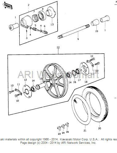

Re: Kz1000B4 Ground Up.
06 Aug 2014 11:37
What does the circlip look like?
06 Aug 2014 12:00 - 06 Aug 2014 12:03
No eBay APP ID and/or Cert ID defined in Kunena configurationNo eBay APP ID and/or Cert ID defined in Kunena configurationPer kawasaki.com --
Part No. 92033-1040
Kawasaki calls it a Snap Ring, 43.5 mm, used on 150 Kawasaki models.
Supposedly an "active" part that's still available at Kawasaki dealerships

- DobbinsCMA
- Posts: 299
- Thanks: 13
06 Aug 2014 12:18
funny I didnt see this anywhere when I took it apart. Also dont see it in my diagram in the manual. Where does this clip go and what does it do?

- Posts: 18564
- Thanks: 2103
06 Aug 2014 12:26DobbinsCMA wrote: funny I didnt see this anywhere when I took it apart. Also dont see it in my diagram in the manual. Where does this clip go and what does it do?
Perhaps not using a genuine Kawasaki Service Manual for the model at hand.
May help to view the diagram at kawaski.com which does include the clip.
Lots of good info on kawasaki.com, including parts diagrams, part names, part numbers, models sharing same part, availability, etc. Here's a link for help with navigating the site and finding information.
www.kzrider.com/forum/13-bike-related/37...imitstart=0&start=20

- DobbinsCMA
- Posts: 299
- Thanks: 13
06 Aug 2014 12:40
Oh ok ya. I was looking up near the frame for the clip. I havent done anything to the wheel assembly.
