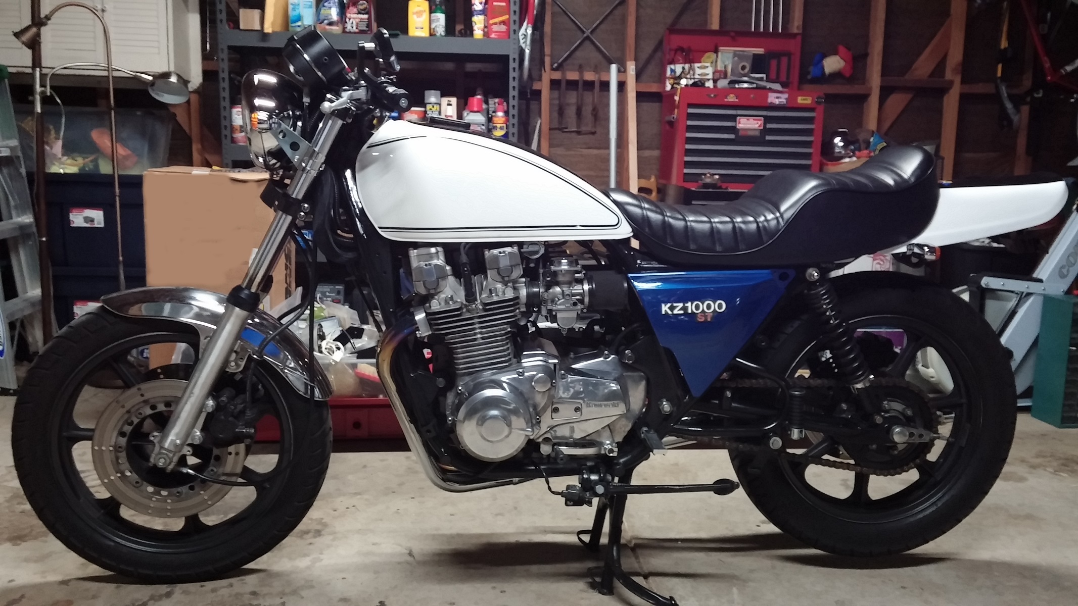

Great job on your bike! Sounds great as well. I have a 1994 Kawasaki KZ1000. I stripped off all of the cop stuff and cleaned the bike up from top to bottom. I am running drag bars with standard KZ controls. The original controls were to bulky and clumsy looking. I've replaced the stock exhaust with the 4 into one Vance & Hines, completely went through the carbs, rejetted carbs for header and intake pods.
Took me a couple weeks to clean up the wiring on the bike and to get everything electrical working as expected! I got the bike running strong, took it out for a high speed cruise and blew off the left side cover that........I searched for afterwards and never found it. That' s OK because I hated the way those covers looked. I replaced the side covers with Z1R style covers. I think they look much better!!!!
Also added the KZ tail and LTD seat. Bought myself plenty of polishing wheels from Haborfreight and polished all the engine covers. Well worth the time and effort!
Before and after pics below:
I plan on painting bike as soon as I figure out what color to go with. I also plan on changing out the swing-arm so I can run a wider rear tire.
The bike is ride-able for now so I will ride it through the summer and tackle the remaining upgrades later.

I just have to say this whole project is awesome and it's very cool to witness and see. I am actually in the process of doing the same thing but I am in the beginning. Whoever started this post and this topic I am glad you have done it. My question is how did you make that seat for it? I want to do the same thing however I do not know if it is acceptable to do this the shocks look like they go right to the front seat. I want to know if a rear seat pad is put on is it going to throw the balance of the bike out of Sku? Or are the shocks on this bike the same as a regular Kz 1000? What sissy bar did you use and how did you make that Seat? I think that is awesome.
Last edit: 07 Jun 2015 09:40 by Hawk111.
- Hawk111
- Posts: 41
Re: 1982 KZ1000p project progress
07 Jun 2015 09:47
How did you make or get that rear seat for the bike? What sissy bar did you use that actually fit on the bike ? I assume you made the seating pad but I'd really like to know how you got that sissy bar on there and what it was from. Great picture of the bike next to the boat in the garage you got an awesome set up.
