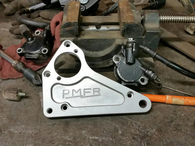

- Posts: 7442
Re: Phoenix Fighter
12 Apr 2016 06:44
No eBay APP ID and/or Cert ID defined in Kunena configurationi've been vocal about not being a fan of hyd.clutches in the past.it's down to the lack of feel for me,personal preference.
but as a machinist and fabricator i get into some stuff i wouldn't normally do for myself :whistle: .
i currently have one such case of modding a pmfr outboard support to use a
i had to slot the mounting holes on the slave and bore the hole open to match the slave body but it was a straightforward deal.
here you can see the slotting that had to happen.
thanks to Kawboy74 for his information sharing.

- Kawboy74
- Posts: 341
- Thanks: 66
Re: Phoenix Fighter
12 Apr 2016 15:50
531Blackbanshee On my 74Z1 a friend supplied the parts but I think the slave was from an older Yamaha, maybe the FJ1100 and it only took a small amount of cutting to work it into the stock cover. If I have it off in the near future I will snap a picture and post it. On my current project, ooops, I used the PMFR outboard plate as a template and had a machinist friend fabricate a little more custom looking unit. To utilize the three bolt holes in the slave I bought, (not the same as the previous one) was the main reason for the different type and it also allowed me to rotate it to suit my slave and for bleeding. The plate is only 1/2" stock and the spacers can be made to suit sprocket widths and as the actuator rod is only 1/4" stock, any length can be made cheaply.
I will try and post a picture of the newer plate tomorrow night.
