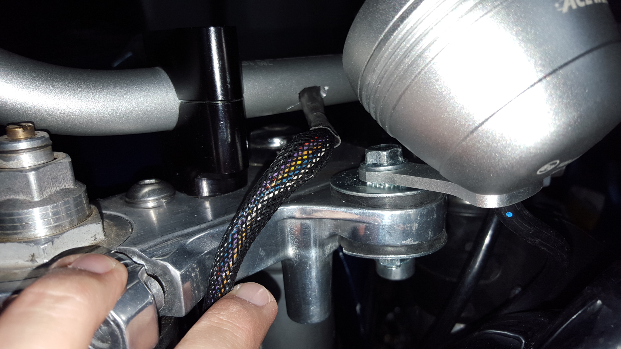

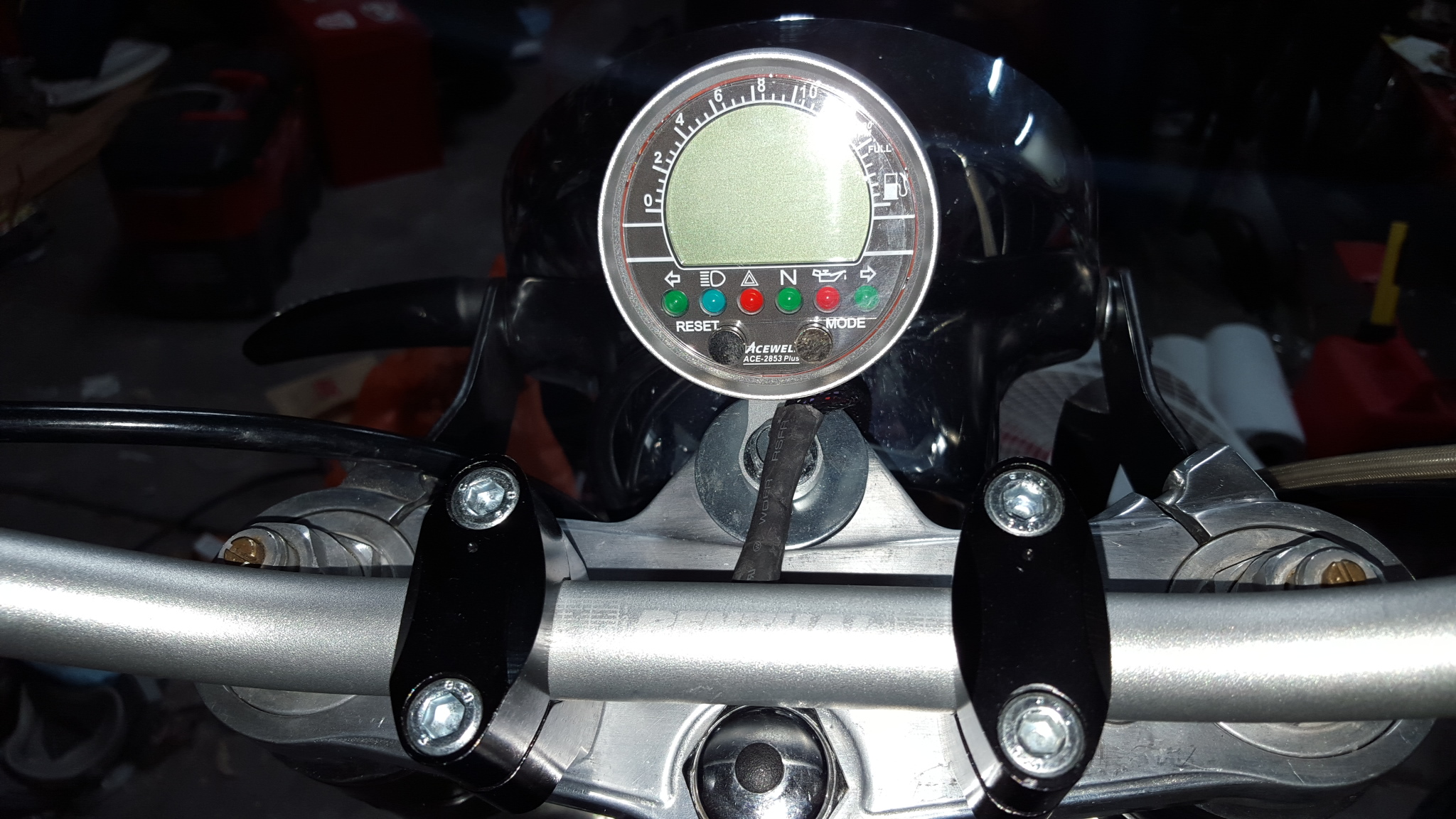

RS34's are installed and synced. Float levels are finally adjusted correctly. I could not do the clear tube test as the main jets get in the way when I tried to a couple methods to get the tube in in the cap whole. I went old school and kept setting them by float height and filling them with gas until they were right. PIA. That aside I used the color tune to get the pilot circuit tuned correctly. Until I can get a test ride in I won't know how they are going to run. They seem to run very well in the garage. No smoke out of the tail pipe and no excessive heat while riding.
I got my new gauge mounted at least temporarily until I get my new triple trees. It's not wired yet but should be by tomorrow.

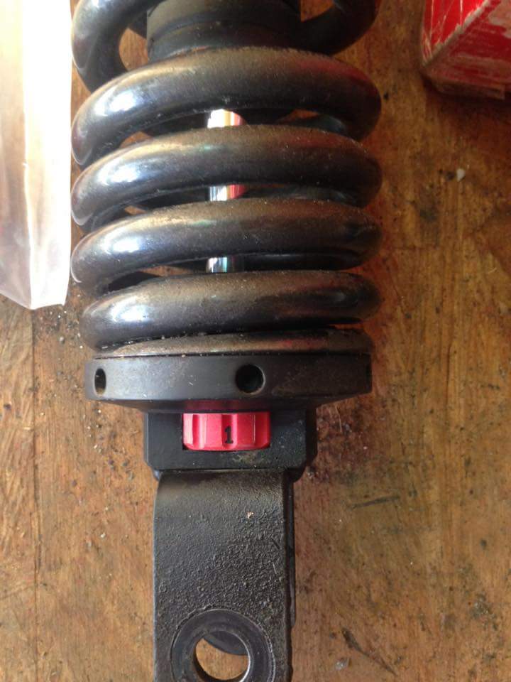

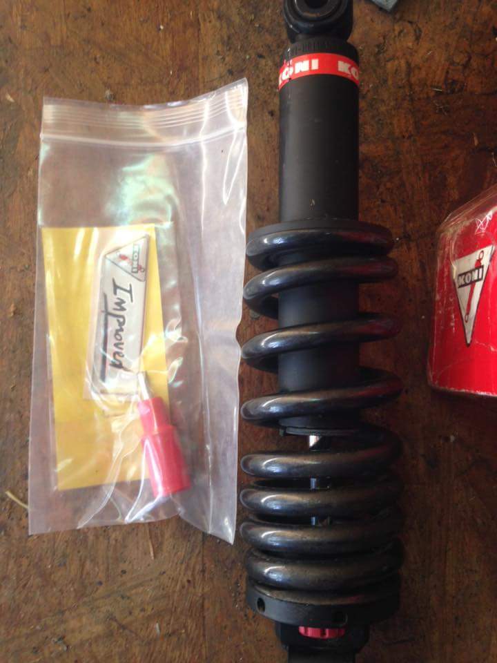

Bought these bad boys on Face Book KZ Market today. I think they should work well on the bike. If not they should resell easy. I got a good deal on them.

nice score on the ol" shockaroos as well :evil:
