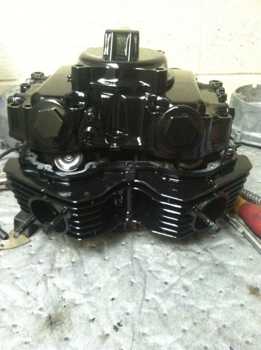

Budget build of the 81 kz440. Bike $150, Athena gasket kit, led blinker set, rear brake/running lights, all hand controls, tires (Shinko), paint for motor and wheels and the starter rebuild all for 254.98.
So the starter has burnt brushes. Pulled the motor apart and everything looks great/smooth. Got rid of the front light assembly and brake line hose. So next stop is wait for parts and clean up the frame and wheels. To bad you can't buy time and elbow Greese cheap. This is the pics so far.
Pistons look alright. Except for the carbon
Cleaned with brake clean to knock off welded of road tar. Followed by acidic aluminum wheel cleaner. Self etching hightemp primer. Then black!
Have the case done but no pics right now.
Block sanded the head only.
Attachment image_2013-09-13.jpg not found
Attachment flint2.jpg not found
Attachment flint3.jpg not found
Attachment flint4.jpg not found

Nice bikes, I moved to Seattle from Gillette Wyoming 3 years ago right after highschool. What did you use for the glossy finish?
