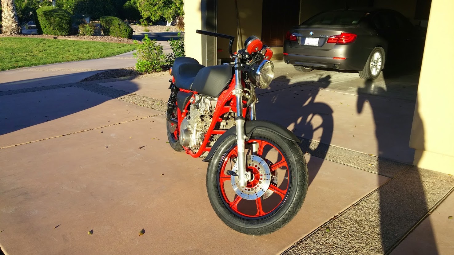

Figure it's time for another update. Had to put it on the back burner for a bit, but i'm taking two weeks vacation and coming back strong! Got a few parts bikes lined up at the local bike shop for those random misc pieces i'm missing.
So here goes!

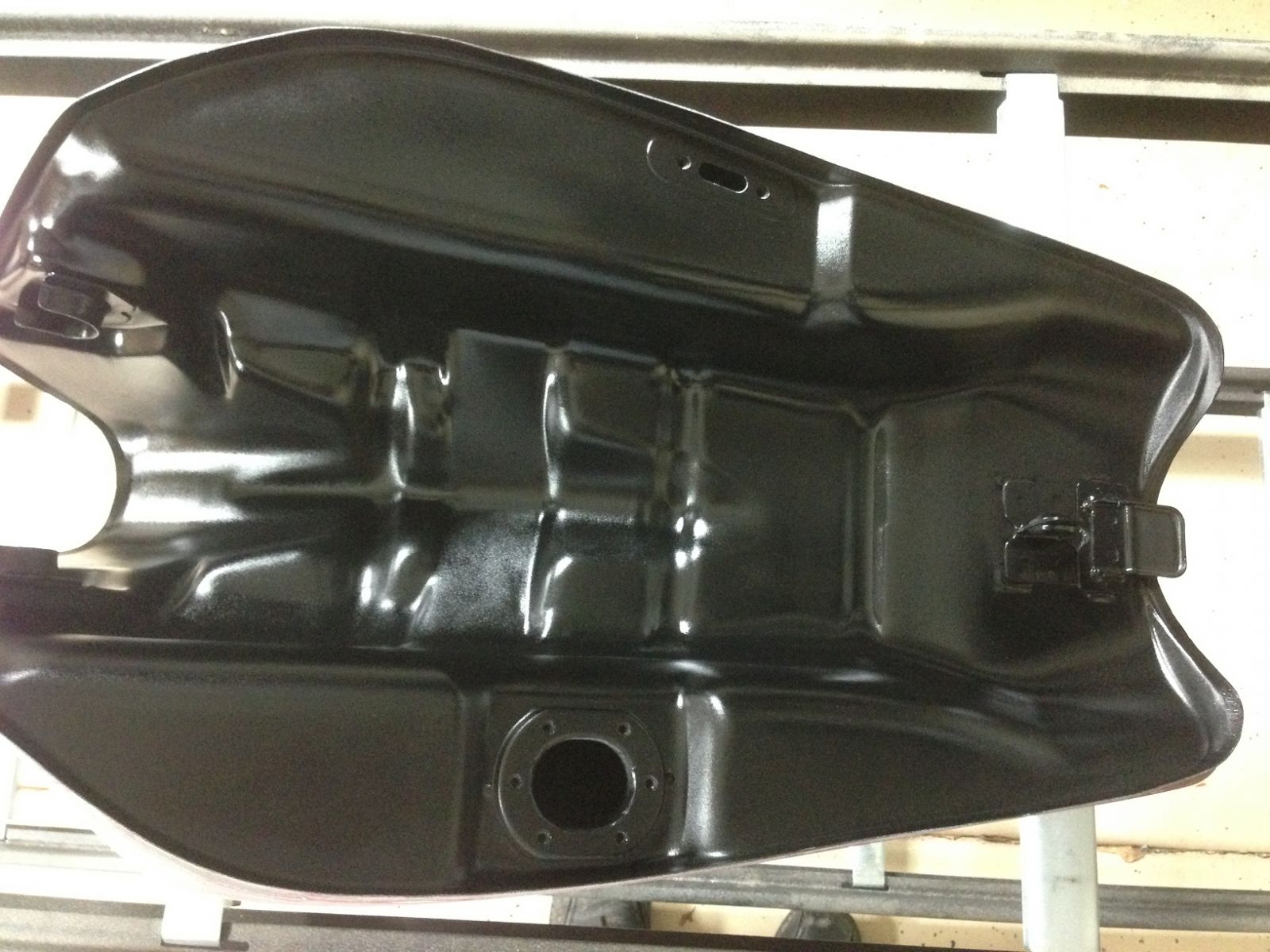

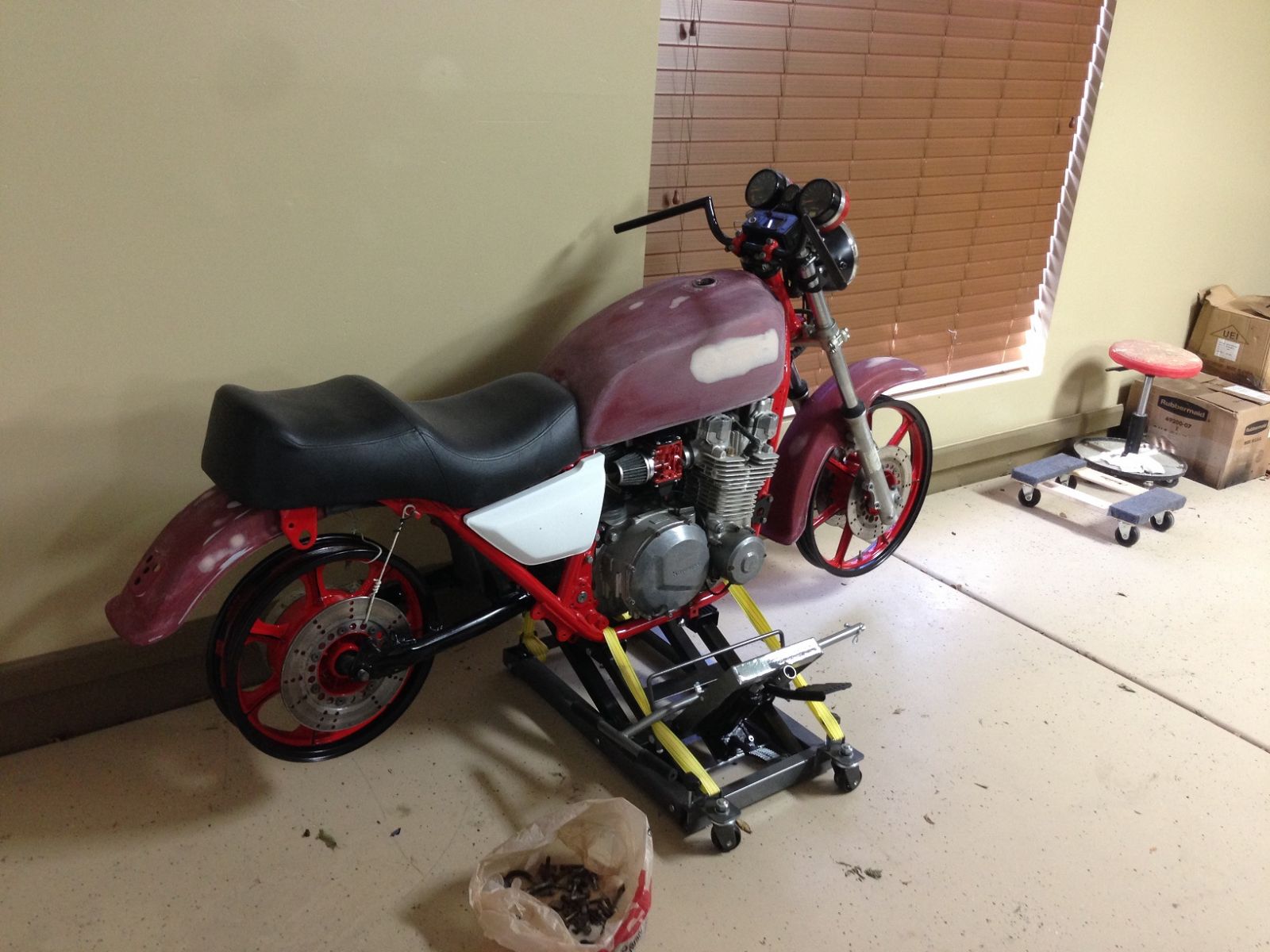

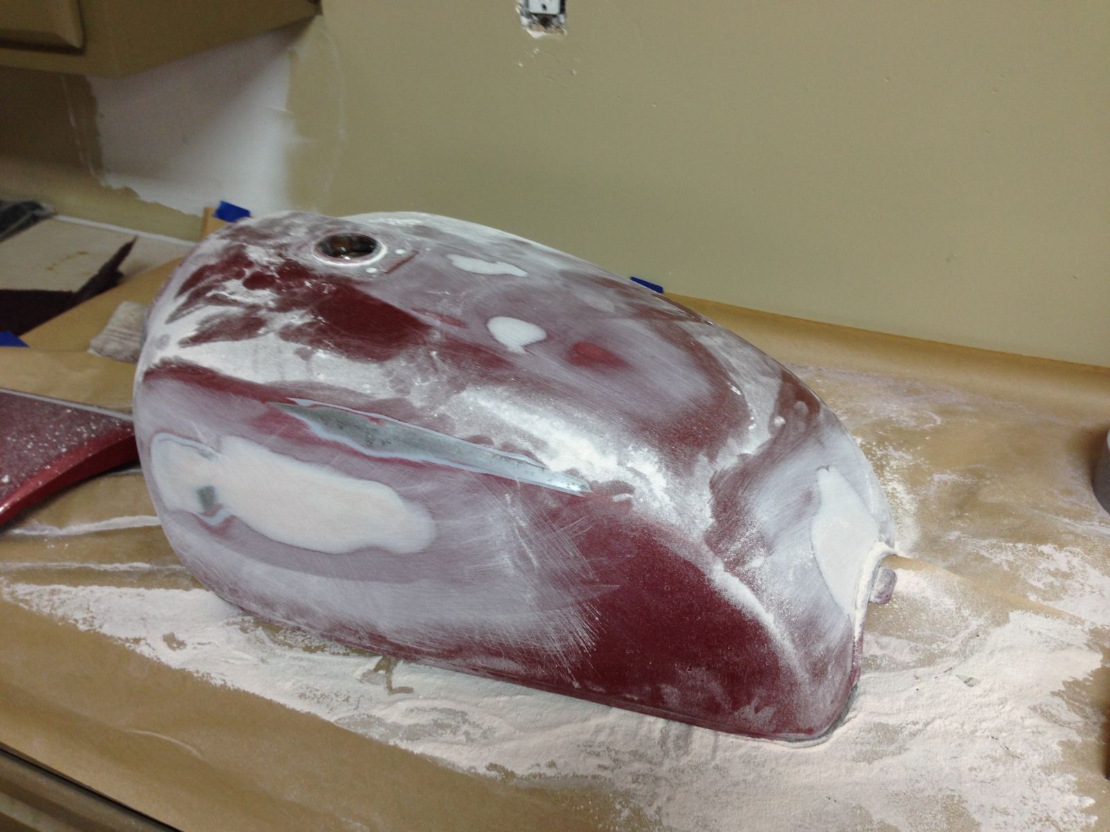

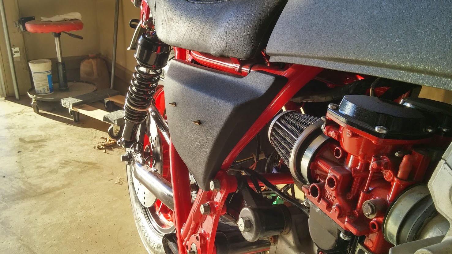

Spent too much $ on the tires, so I copped out and used truck bed liner on the tank/tins and side covers. Looks way better than I expected. I pulled off the 'saki logos from the tank and filled it in with metal filler and feathered some bondo to smooth it out.

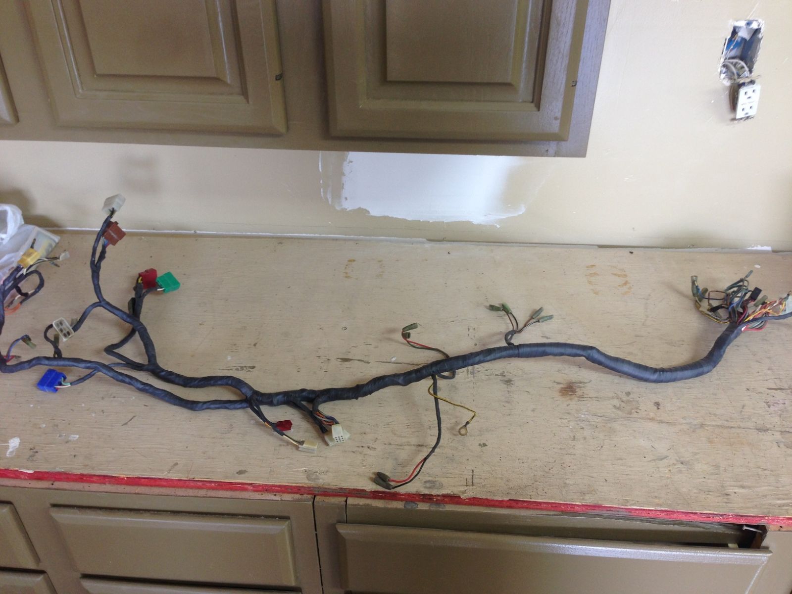

Got a bunch more parts back from powdercoat. Also went through the wiring harness, cleaned the contacts all up and re-wrapped it.

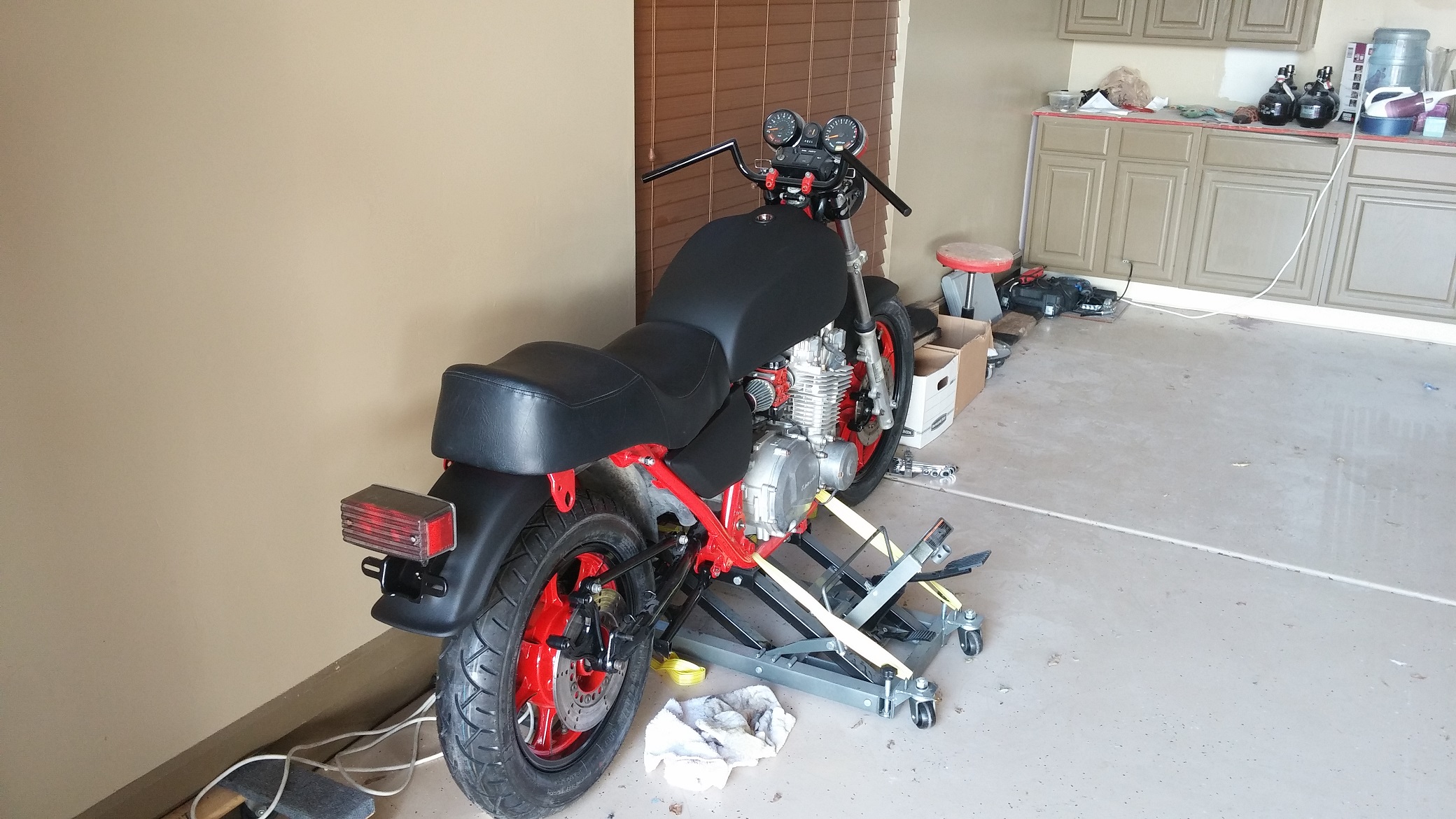

04 Nov 2014 16:51

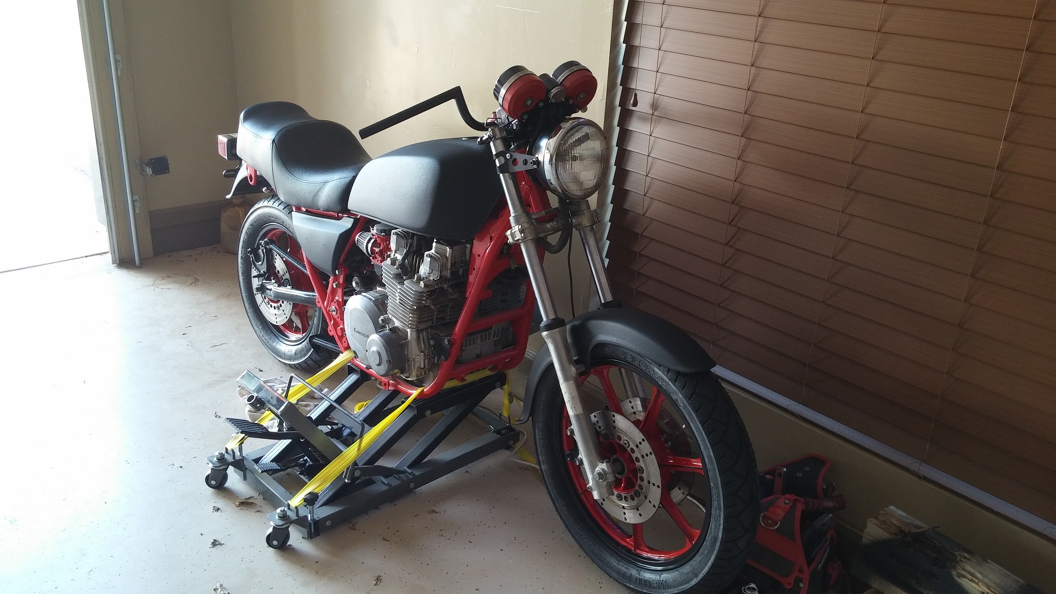

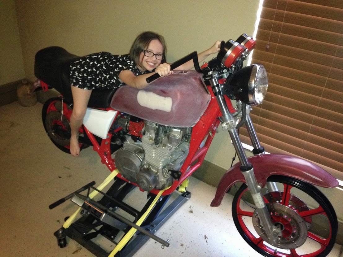

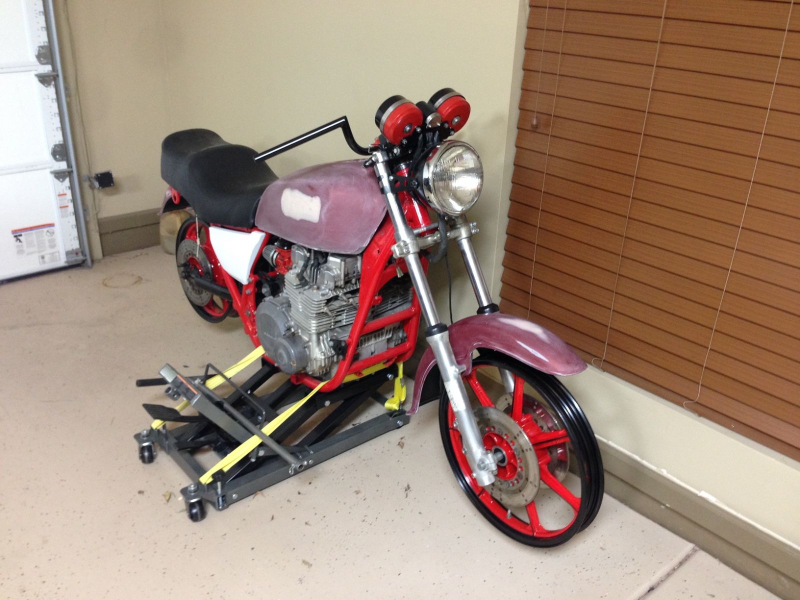

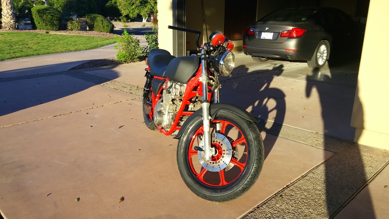

And she can stand on her own two feet now!
Had to put something in the holes on the side covers where the old emblems went...

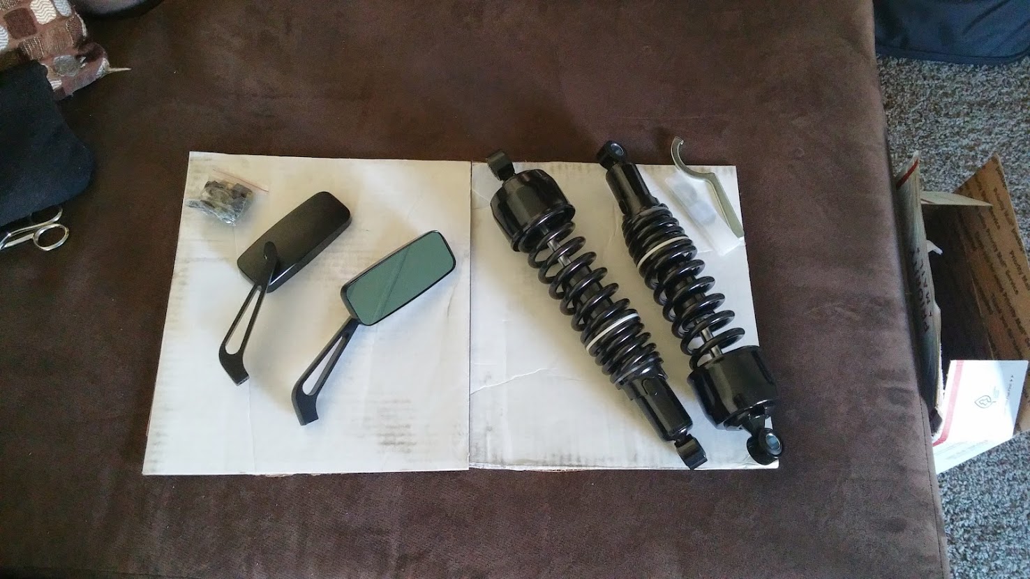

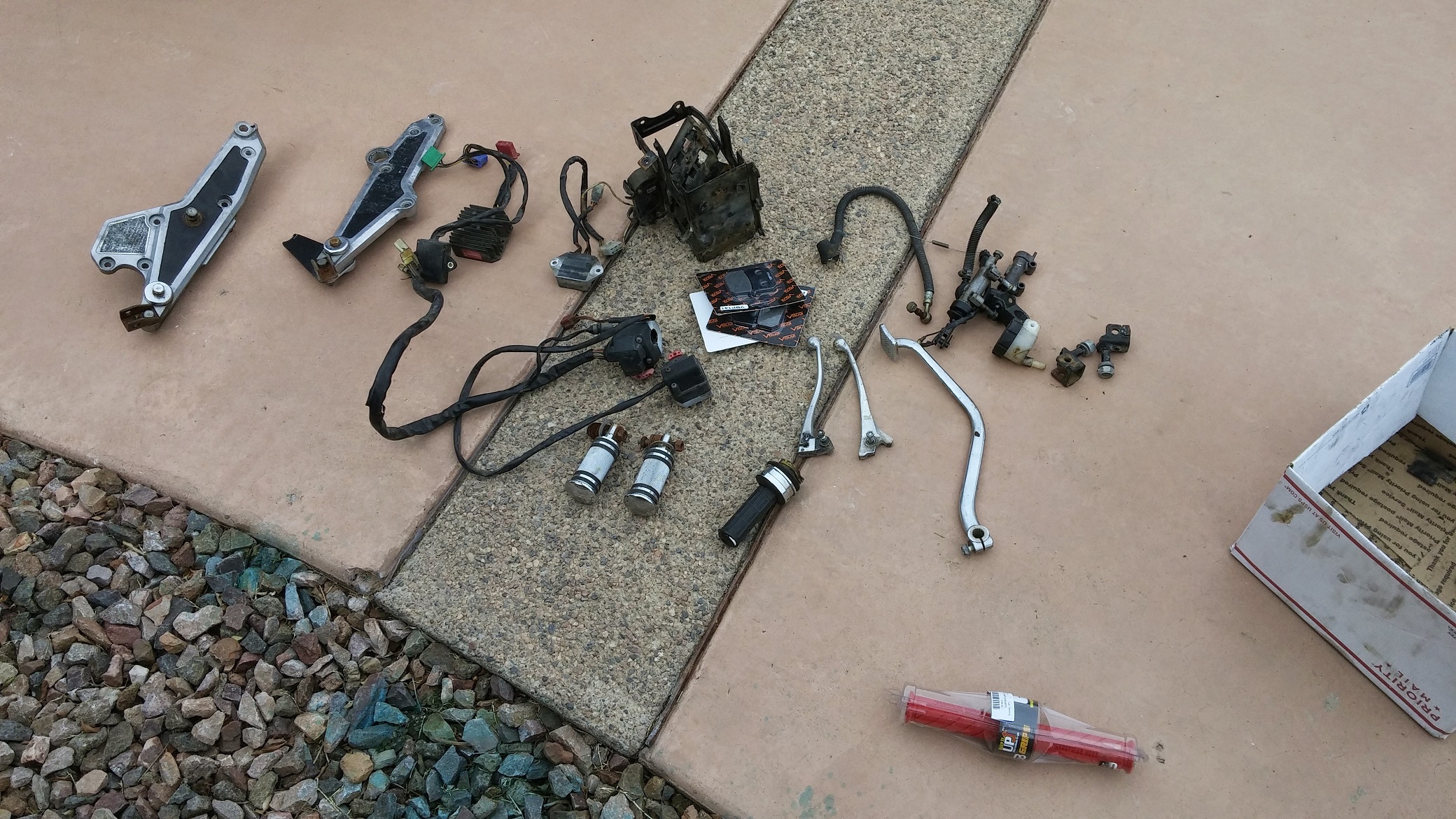

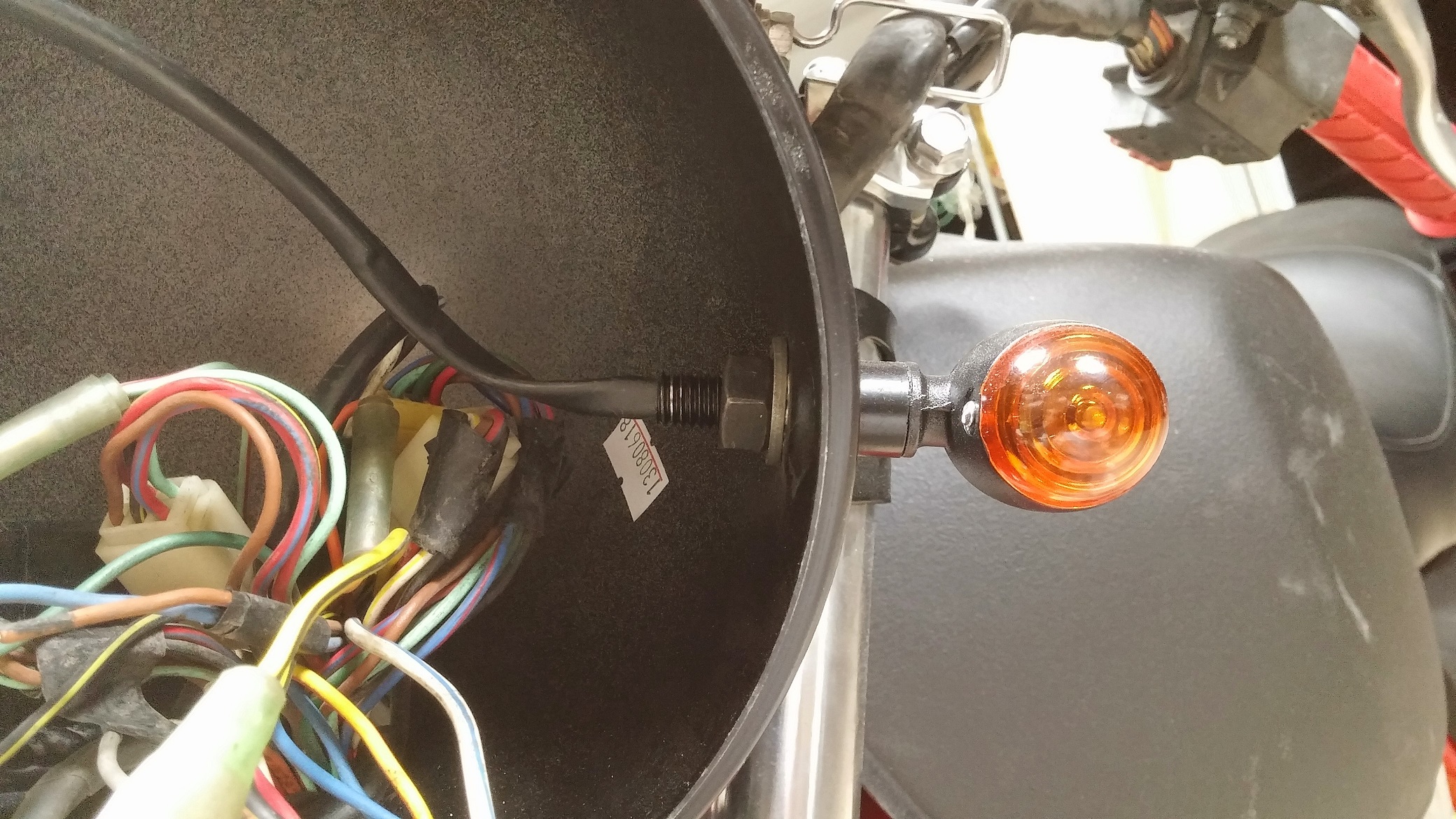

More parts! picked from two different salvage bikes haha. Few more pieces to pick up tomorrow, as well as a fresh battery. Clutch and throttle cables are on their way from Parts Unlimited as well.
I got these turn signals for $30 on ebay for all 4, the quality was surprising, metal housing and everything, i just hope they output enough light.
I couldn't find a good mounting spot for them on the front, so I just drilled through the headlamp bucket clamp where the bucket bolt goes and cut off the nut inside the bucket. Hides the turn signal wires nice, but may make it a PITA to aim the headlamp later, oh well :laugh:
Just a few more small electrical parts to go, but then gotta save up for some exhaust, freaking expensive for some bent tubes IMHO.

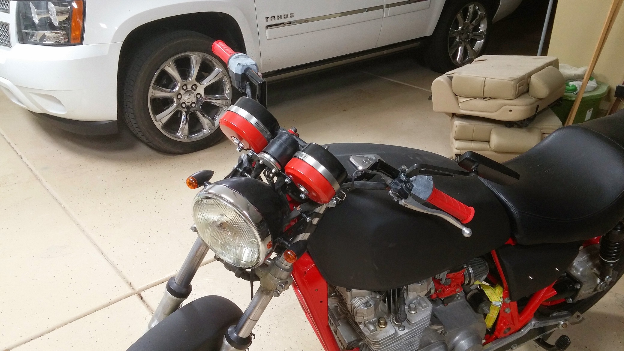

I may change that out eventually, but for now it works and it kinda fits in.
On another note,
:evil:
On another note,
:evil:

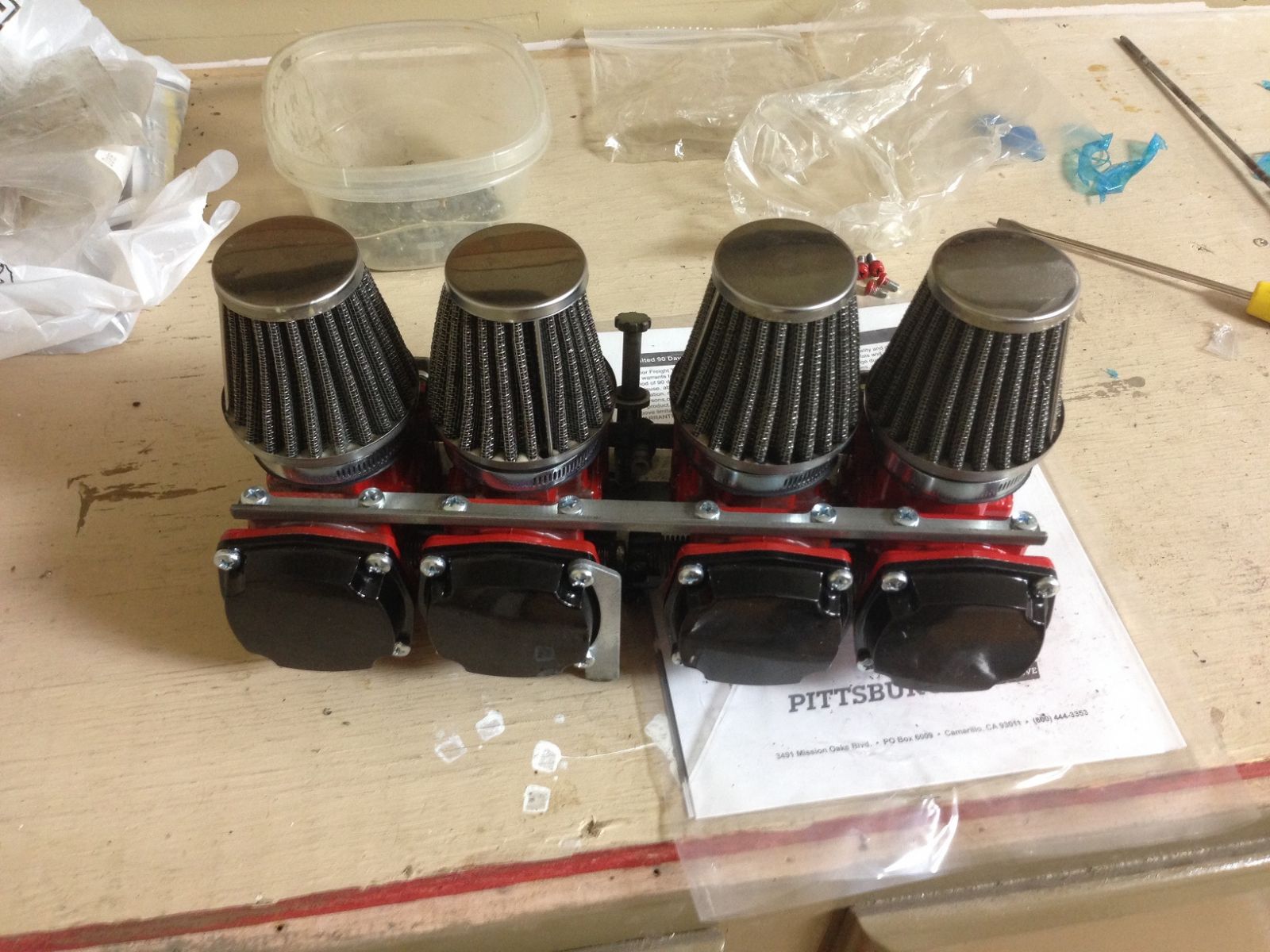

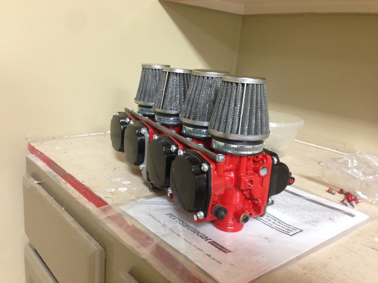

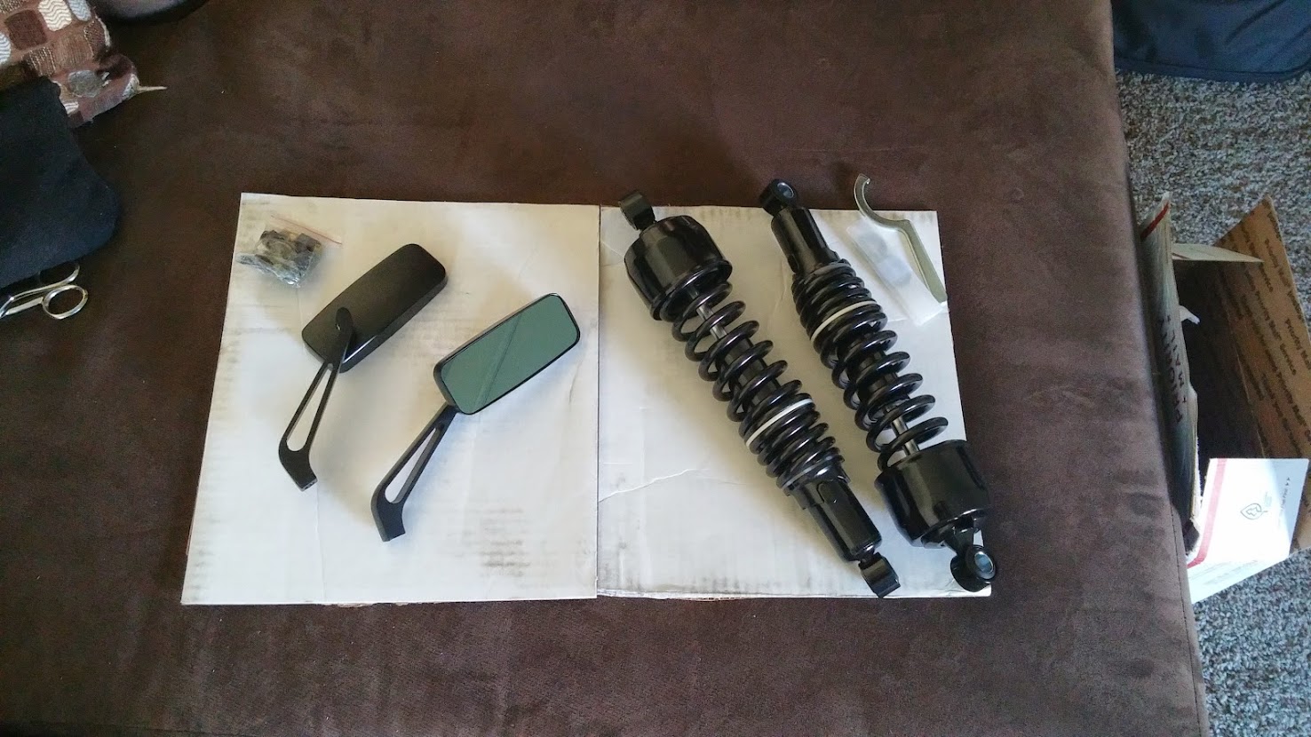

Re: 1982 KZ1100A-2 Shaft LTD by Vetter Cafe/bobber
19 Dec 2014 19:31

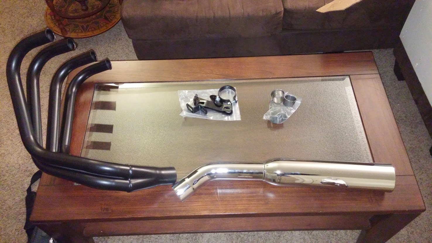

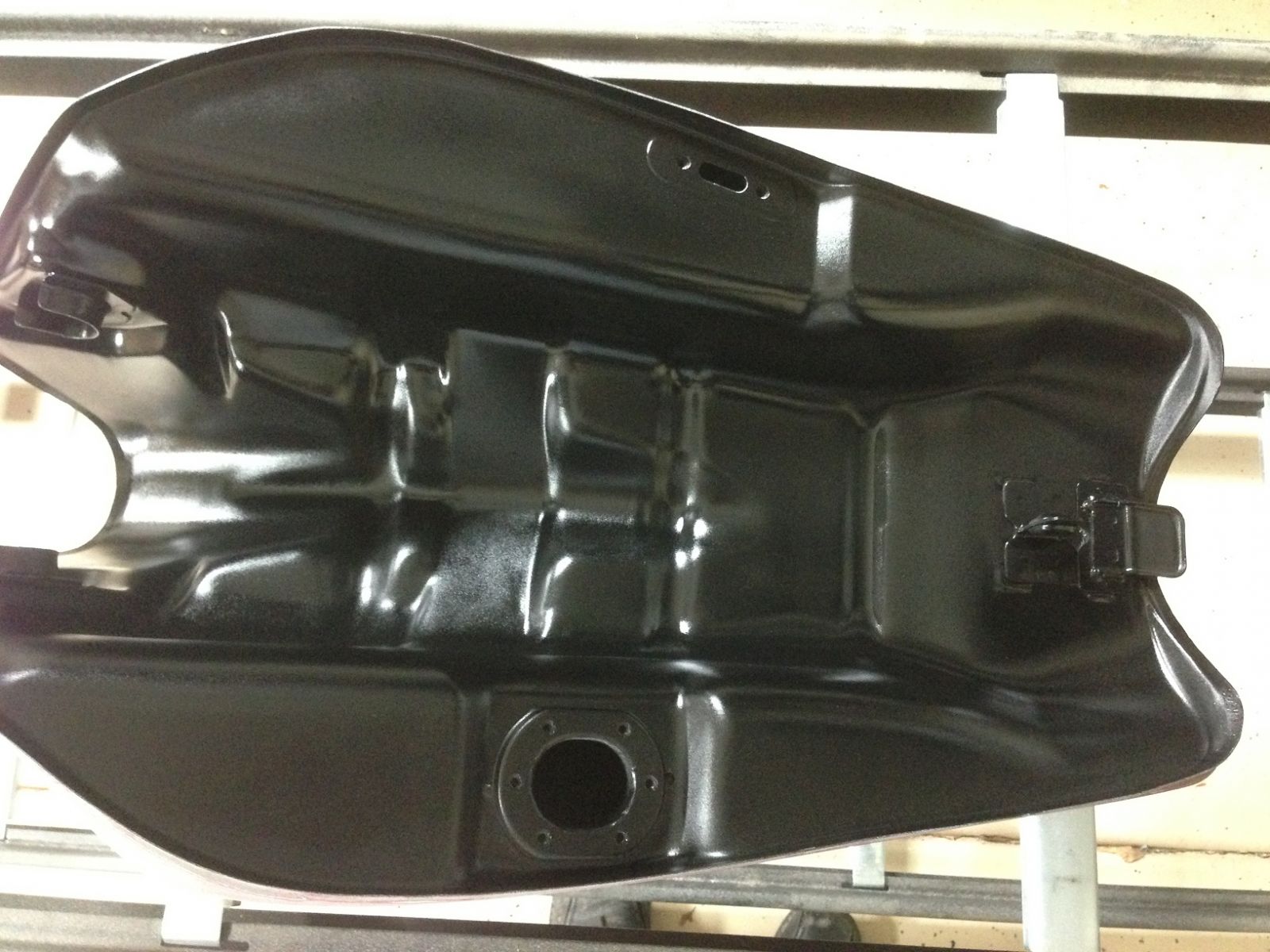

Mmmmm shiny stuffs came in. Got the petcock rebuild kit, put it back together. New front master cylinder is here too, and this!
