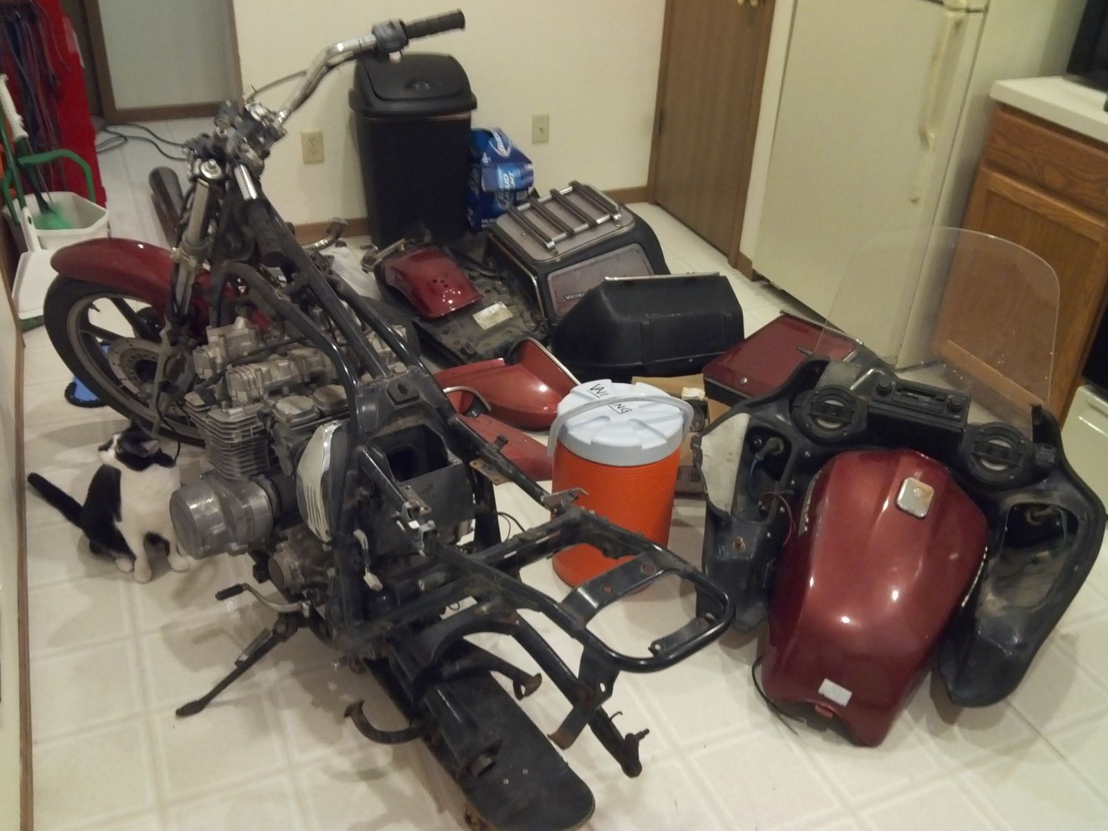

I decided to put together a project build on this bike after seeing how much work I'll have to out in this.
As seen on Craigslist
Arrived at home!

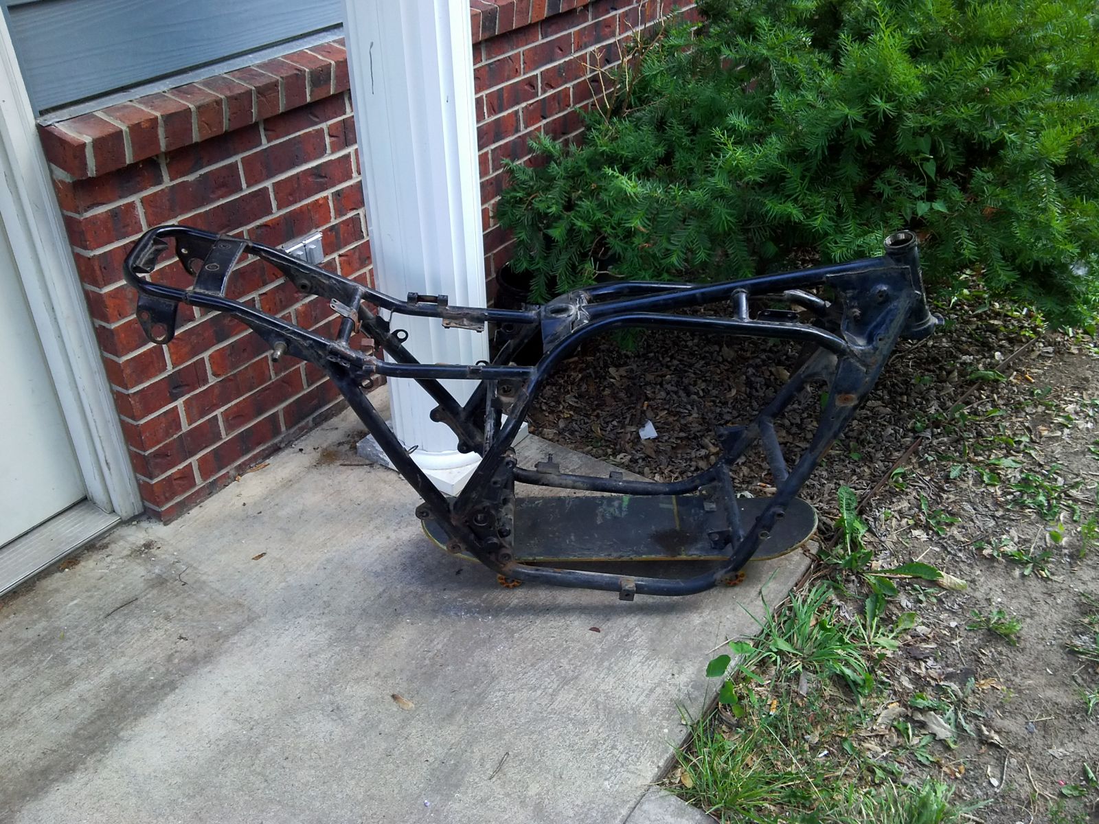

Frame stripped and ready for powdercoat!

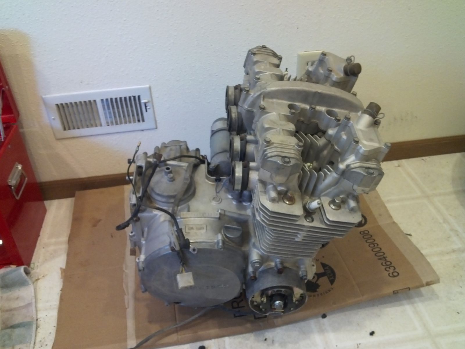

Engine is out! I ordered a complete gasket kit, but after some inspection/cleaning I won't be doing a tear-down on this.... yet.. ;)

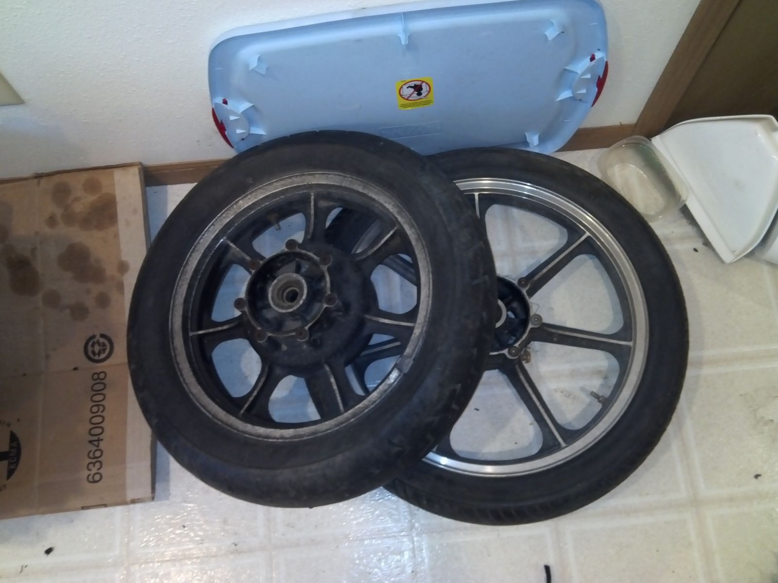

Wheels.. yummy... to go for powdercoat and rubber soon

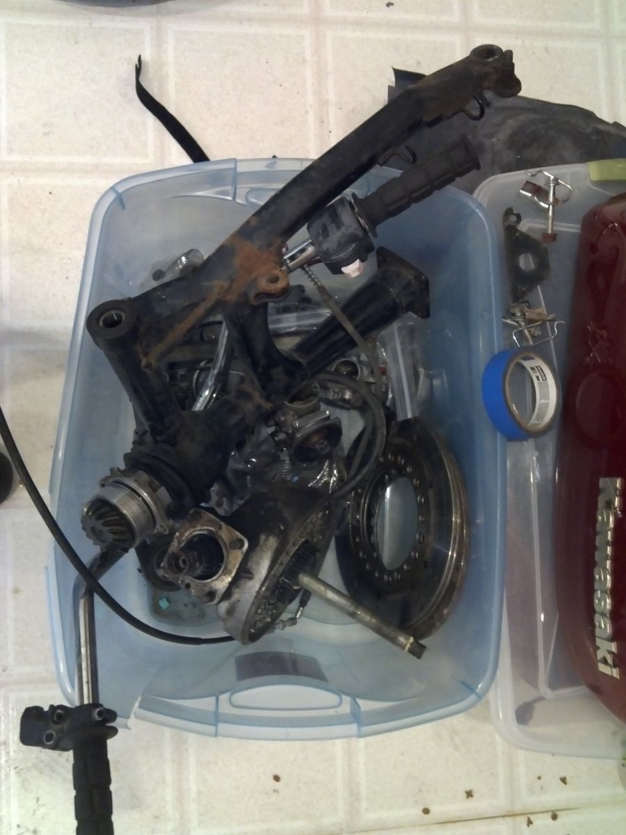

Box o' parts

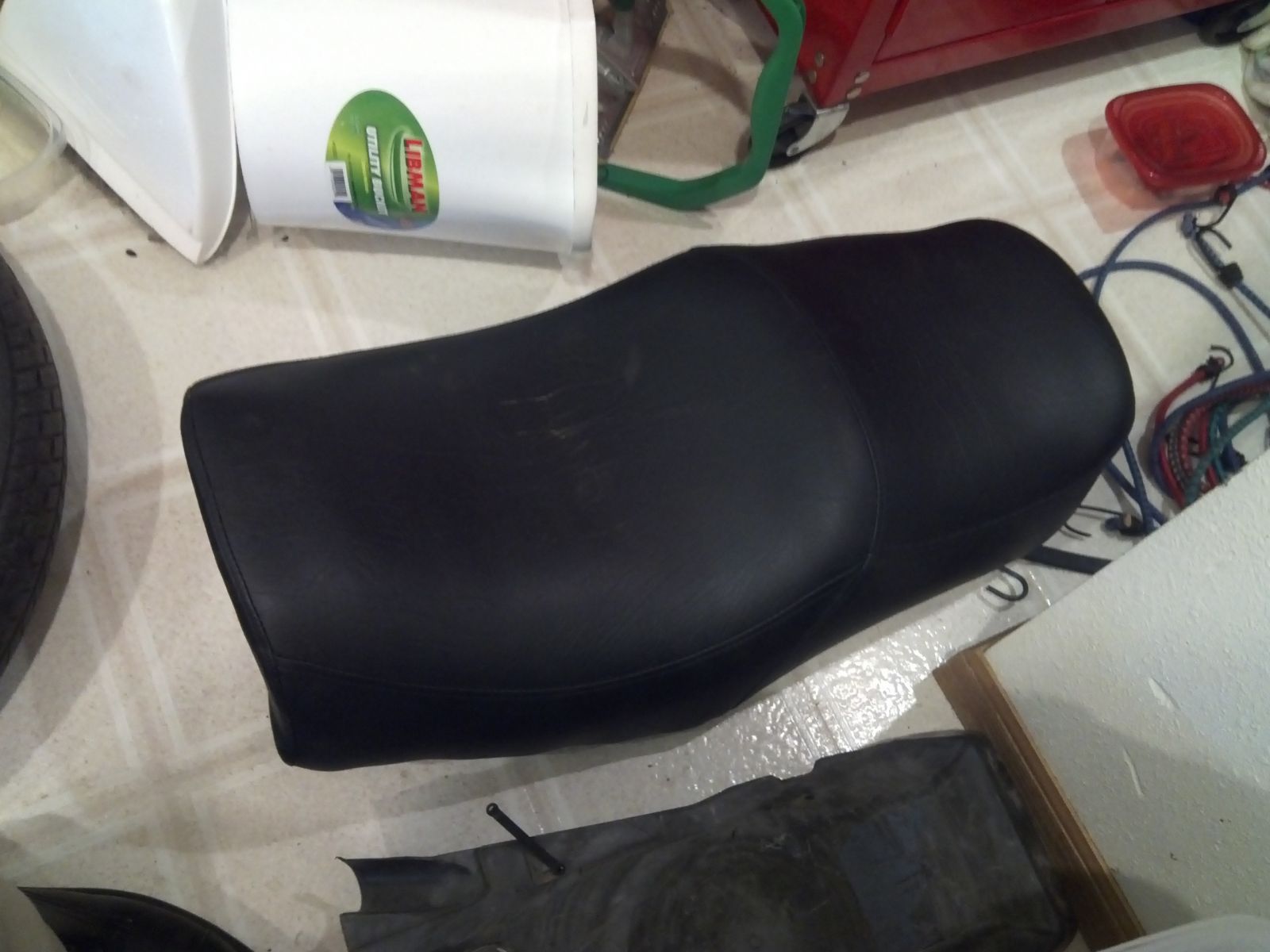

Seat, recently re-covered, looks good.

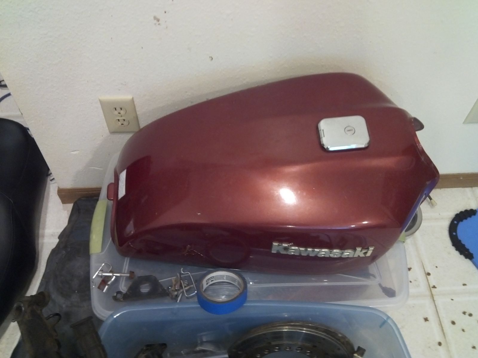

Tank. Not bad, only 2 small dings. Really clean surprisingly.

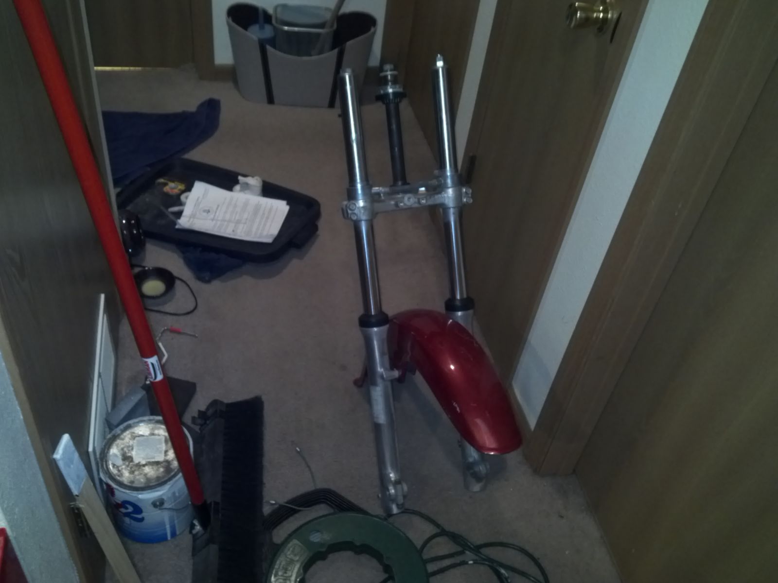

Front forks

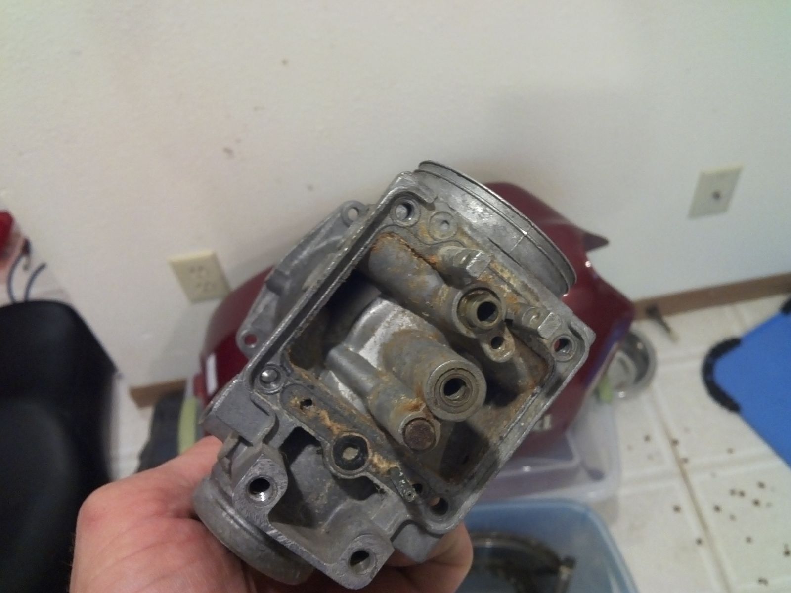

Bottom end of carbs, they all look like this... yech- rebuild kit is on the way. Floats still good somehow.

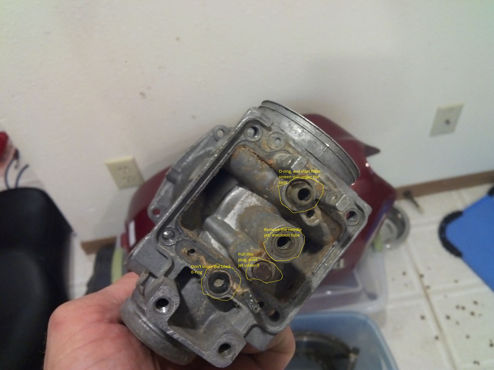

Welcome to KZR.
You need to pull some more parts from the carb body and get some rebuild kits.
Lots of cleaning there to be done.
Here is a link to a Factory Service Manual for you. www.kawiworld.com/index.php?option=com_c...icle&id=77&Itemid=99
Don't lose the black o-ring, pull the plug above the pilot jet and the jet, remove the needle jet/ emulsion tube, remove the inlet valve seat as there is a o-ring and filter screen there.
Soak and clean those babies real good.

The pilot jet is seized in the housing, rebuild kits came with new pilot jets, can I just drill it out?
  • Patton
  • Patton's Avatar
  • KZr Legend
  • KZr Legend
  • Posts: 18564
  • Thanks: 2103
Re: 1982 KZ1100A-2 Shaft LTD by Vettel Cafe/bobber
19 Jul 2013 14:53 - 19 Jul 2013 14:58
#597317
rokit_armor wrote: The pilot jet is seized in the housing, rebuild kits came with new pilot jets, can I just drill it out?
Will presuppose that the exposed head of jet has by now been sufficiently damaged to disallow normal grip with a screwdriver. But if not, would soak with Kroil or other penetrant (such as Liquid Wrench or ATF/acetone mix, etc.) for day or so which might help dislodge the screw.
Yes, it may be drilled out -- best to use a reverse-cut drill bit, and the jet will sometimes come right out while drilling.

Couldn't get a hold of a reverse-cut bit. Ended up drilling the center with a small bit, carefully tapping a small phillips bit into the jet, and it was just good enough to break it loose and remove it with no damage to the housing.

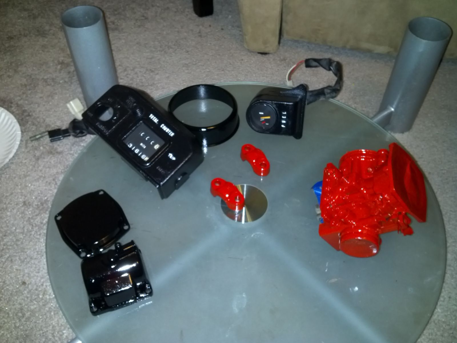

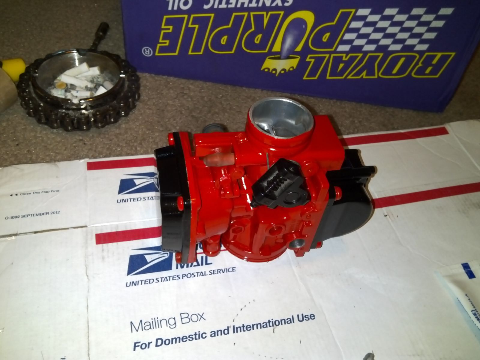

I like paint :woohoo:

Thoughts?
