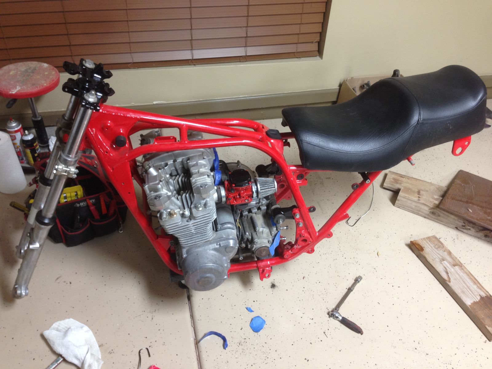

Alright, had to put the KZ on the back burner for a bit.
Starting to throw things back together bit by bit. Budget is super tight right now.

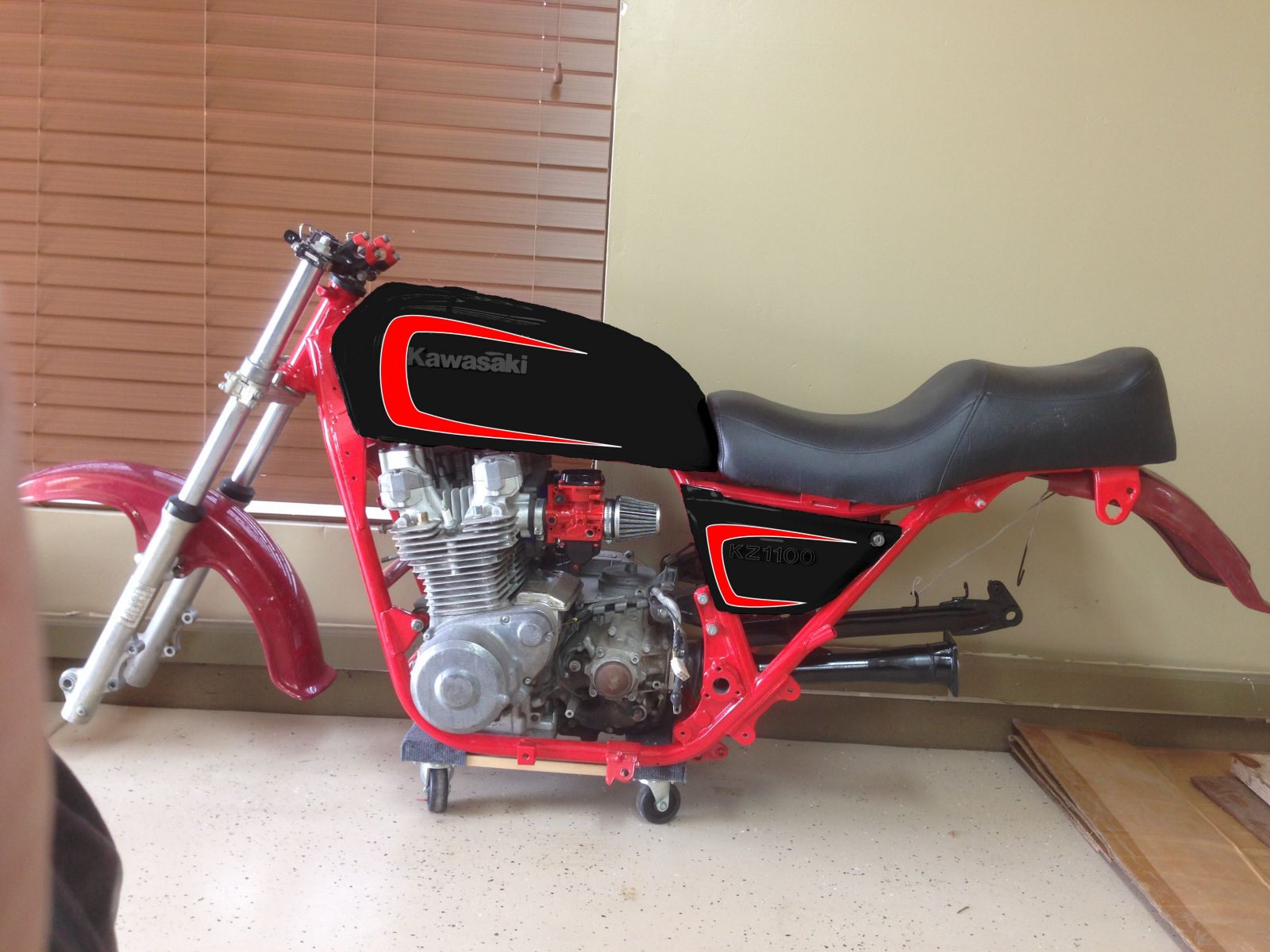

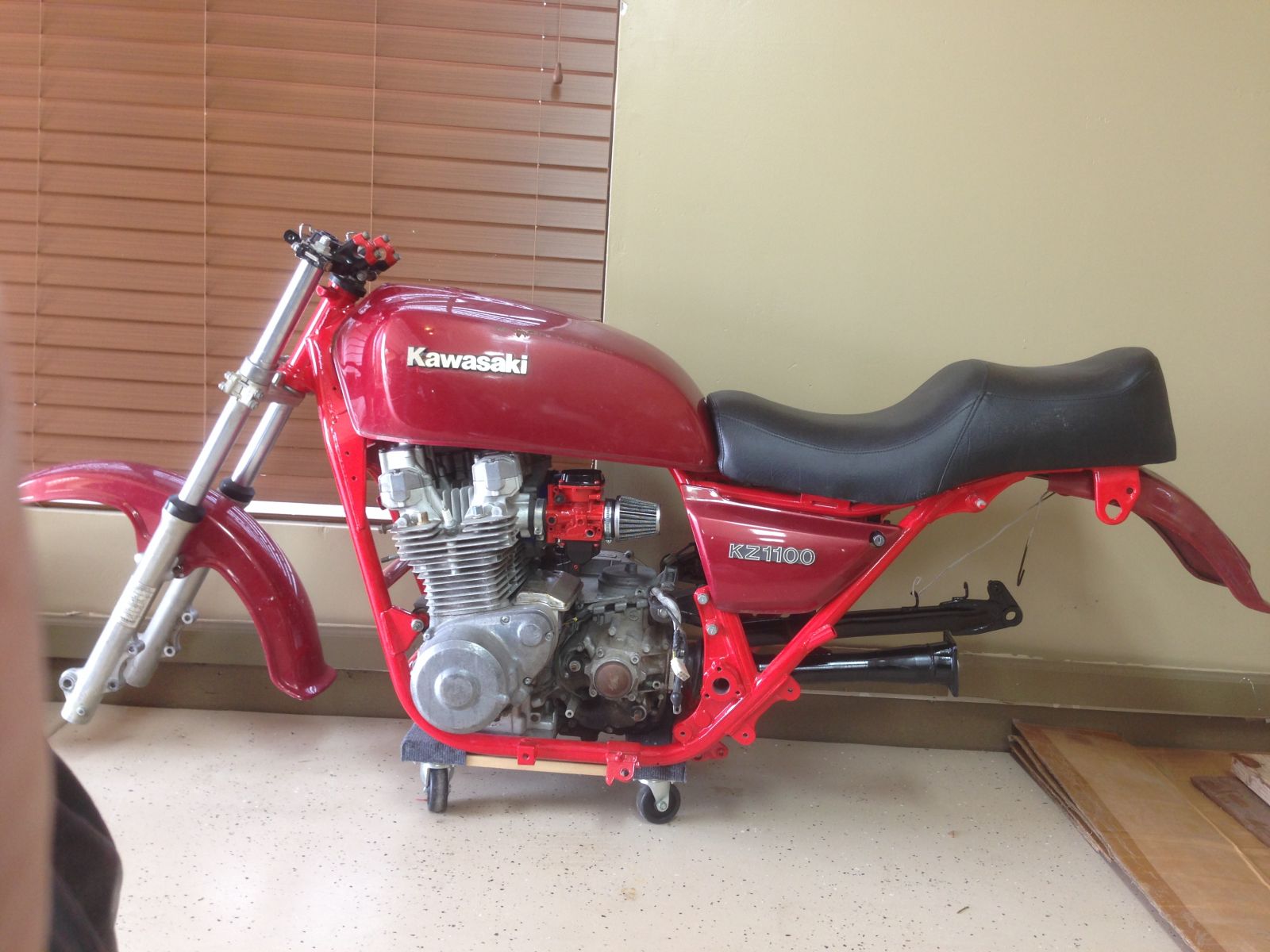

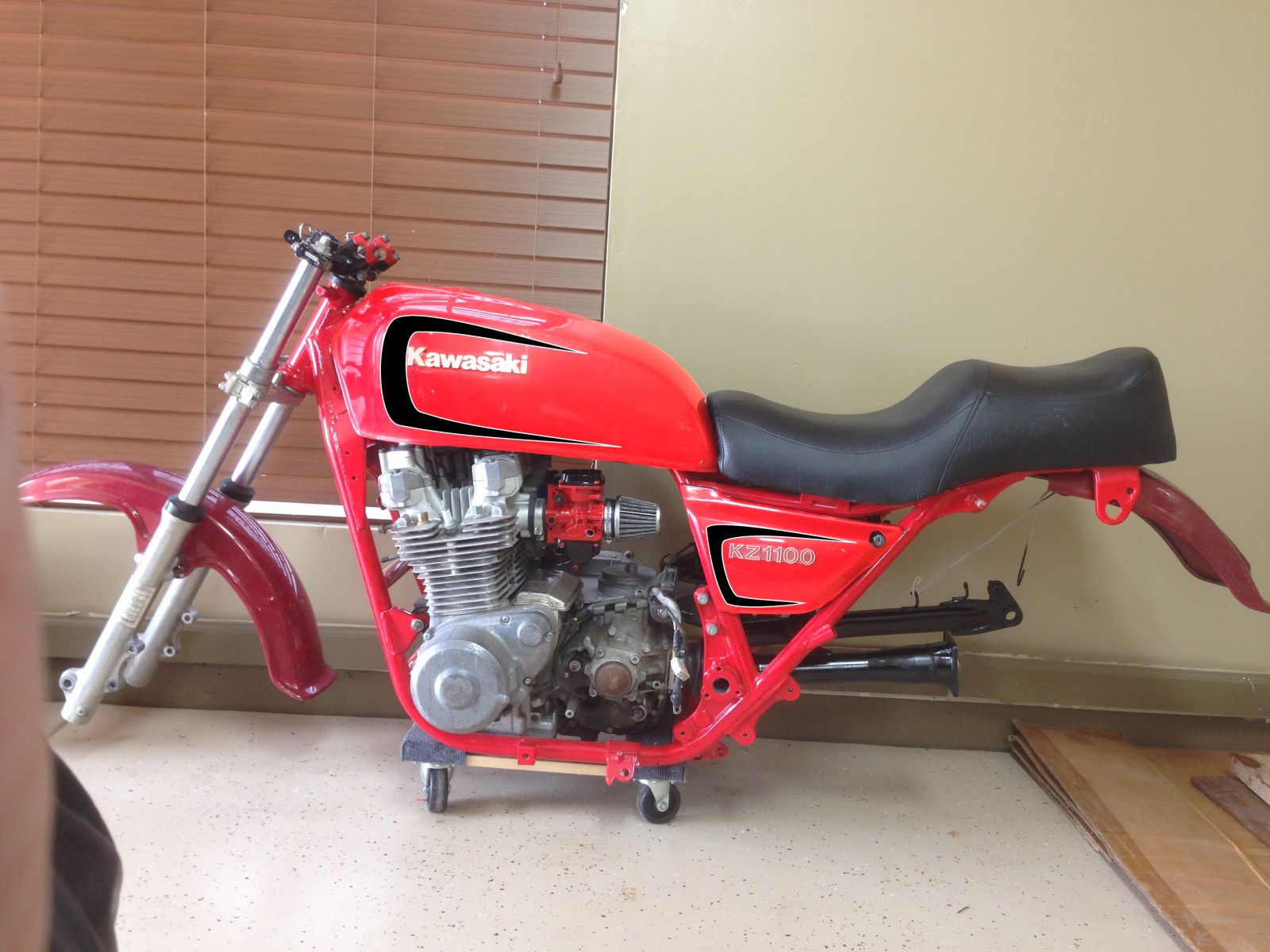

Here's what it looks like with tank and stuff mocked up
Now to decide which way to go with the paint, red scallops on black,
or black scallops on red.
opinions?
opinions?
- turboking
- Posts: 631
- Thanks: 106
Re: 1982 KZ1100A-2 Shaft LTD by Vetter Cafe/bobber
07 Mar 2014 04:19 - 07 Mar 2014 04:21
the primary black looks like an afterthought :blink: ...........primary red looks better :huh: the red frame ties it all together.... IMO

07 Mar 2014 07:25
Yeah that's what I was thinking.
The black almost contrasts too much, alot going on.

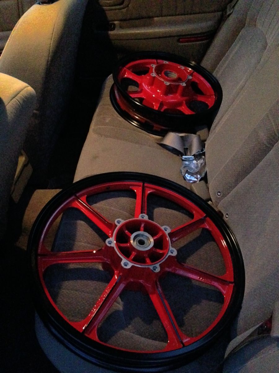

The rims will be dropped off for PC today, I'm having them done two-tone red and black, with the black part of the stock rim pc'd red, and the machined part black.

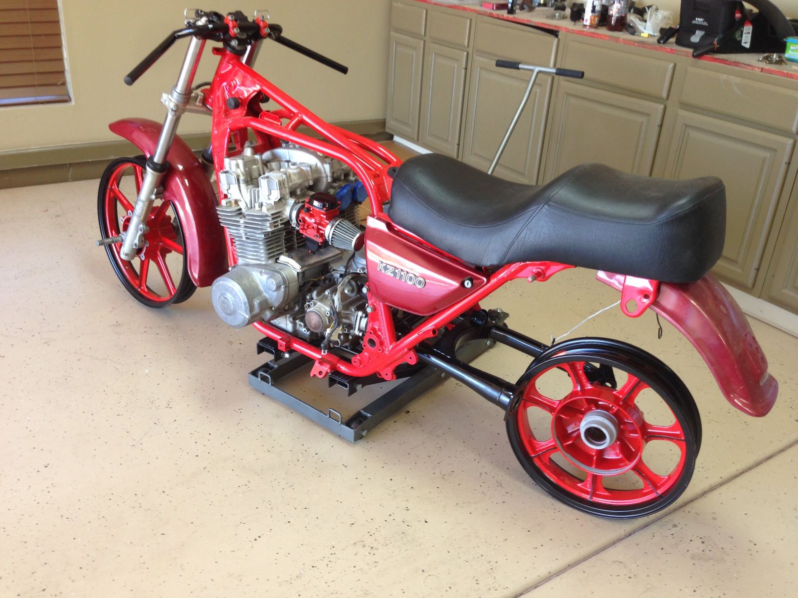

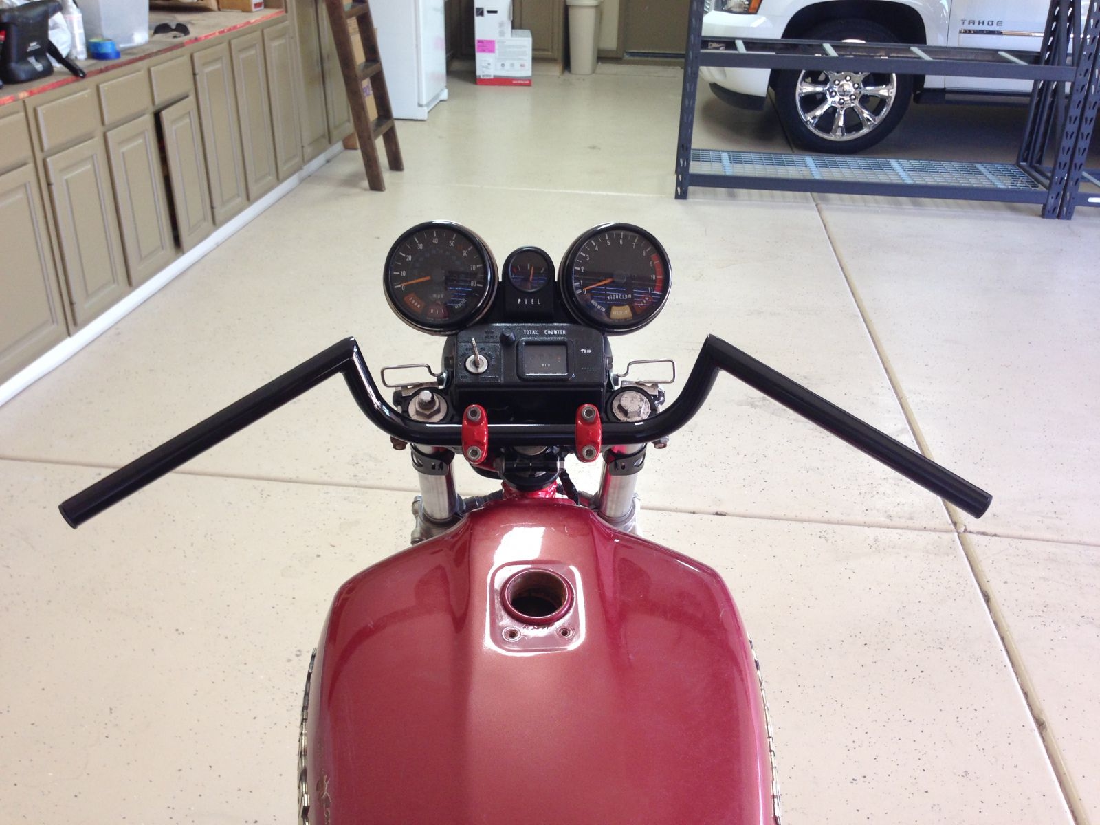

26 Mar 2014 23:59

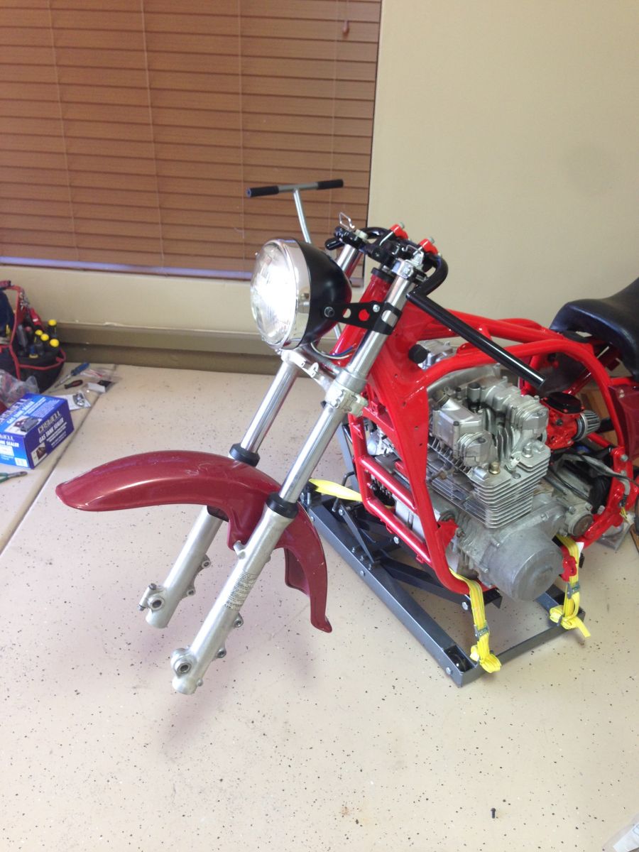

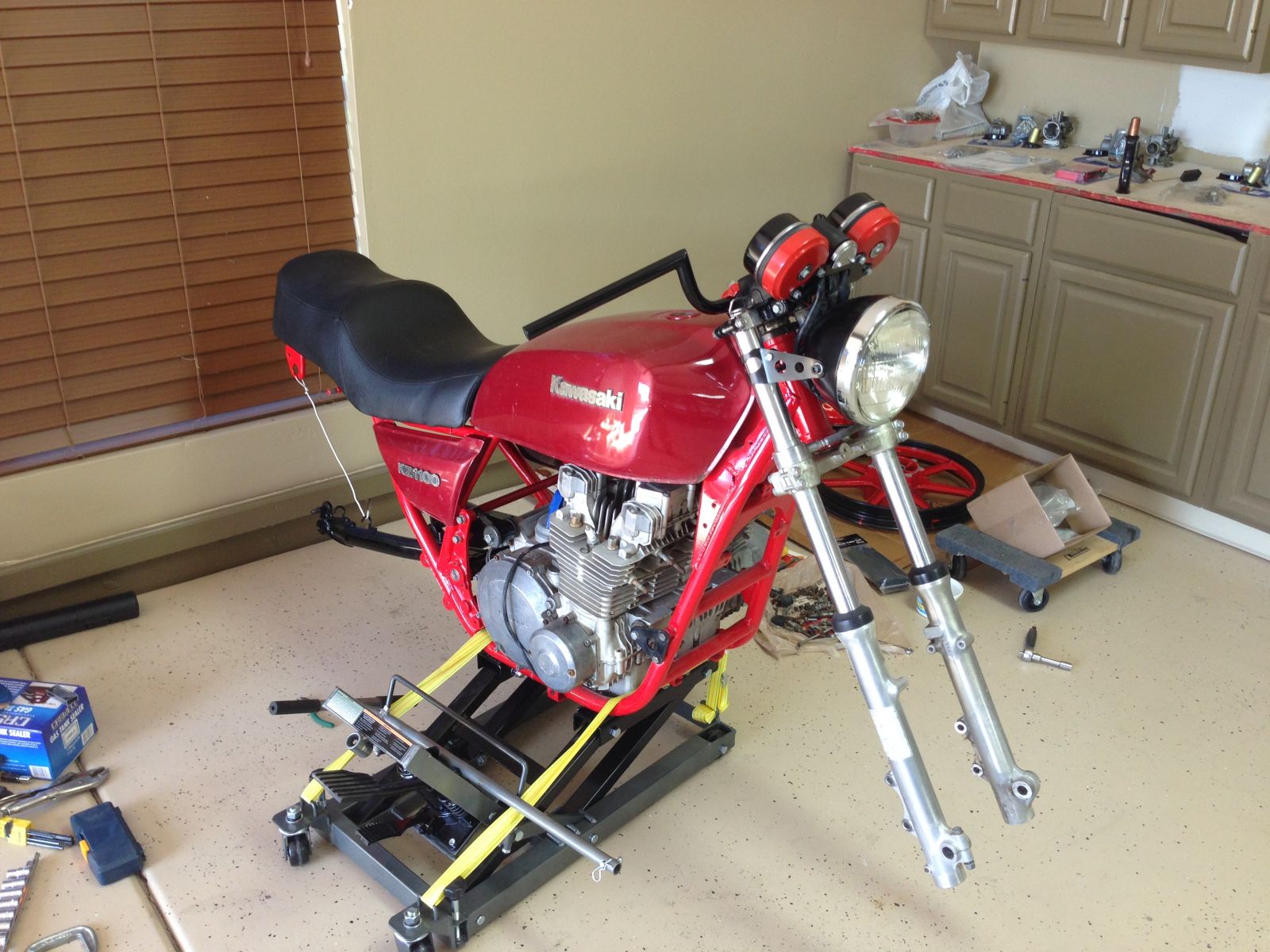

More pics!
You'll notice I inverted the clubman bars. Just not enough clearance with that big arse tank, didn't get full turning radius with it.
