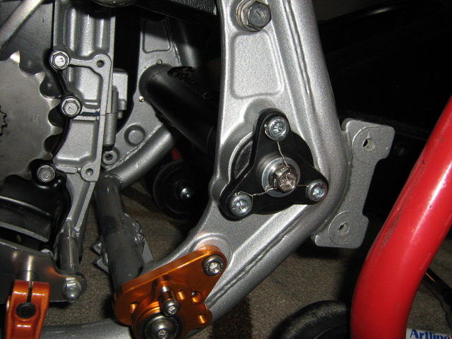

but in lieu of any actual progress please allow me to high light the work of another forum member who actually done it the way i am thinking i may.
i present Arnold's rear set mounts,from Retro Fighter 2.0 (KZ 1100 -82 goes Z1 clone),
i haven't been able to get any shop time,so i haven't been able to get the rearset mounts worked out for the 750.

Thanks, Leon! I must have overlooked this thinking his mounts were part of the stock frame. He's a mastermind here... Thanks again!
