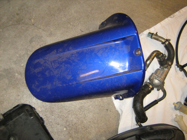

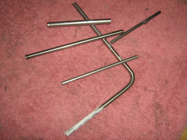

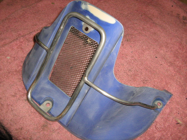

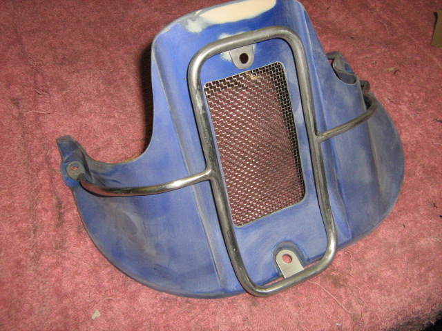

30 Dec 2013 10:01
Thanx guys,

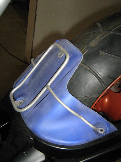

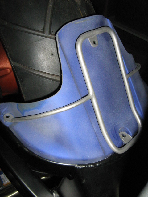

Prepping parts for paint and did some work with the hugger. (do you call it that ?)
Made a small frame for it to get that retro feeling and put some net in it just cuz
