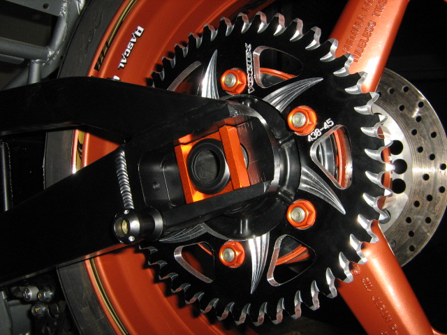

that sprocket is sick!!! :wipes drool from chin: I have som emajor shop envy!!! this build is pure awesomness!!!

Good choice on the sprocket- those vortex ones are really nice, super light weight. Same one I'm running on my build

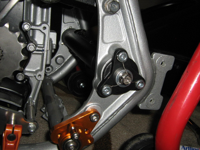

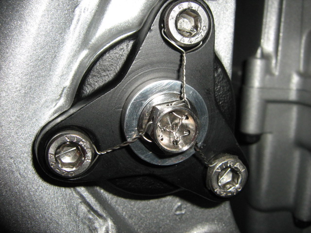

Here´s some pic´s of the last days progress.

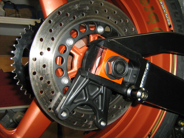

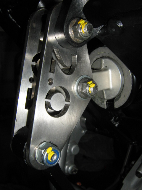

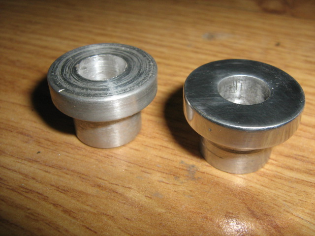

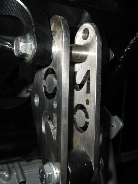

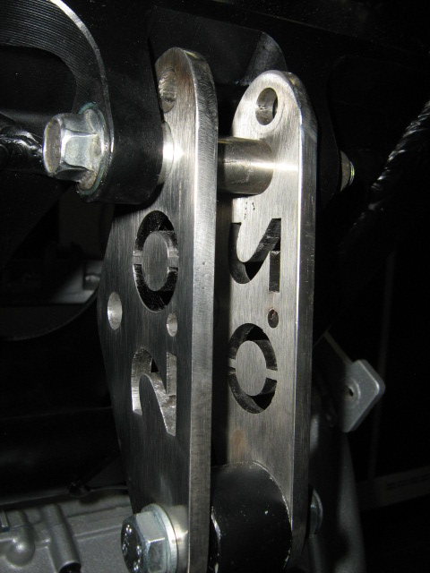

Old swing arm attaching brackets.
Made some new bushings to center the new bolt.
Drilled two new holse to make the rear end 1 inch higher.

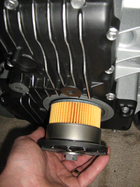

New oilfilter installed
Yellow paint marking that bolt is tightend propery.

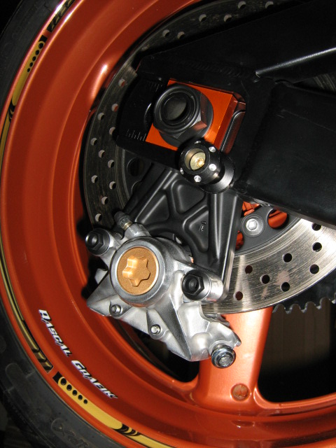

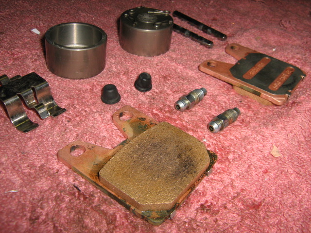

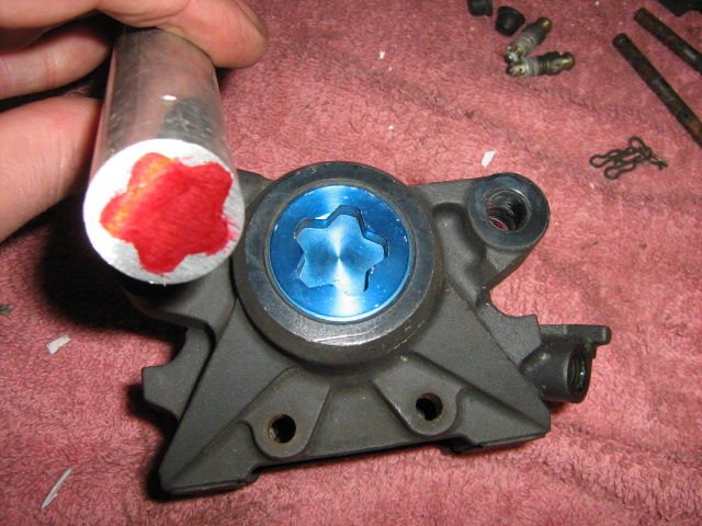

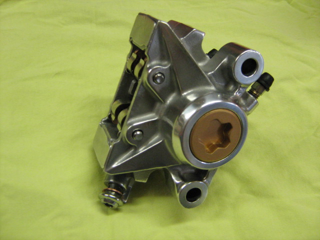

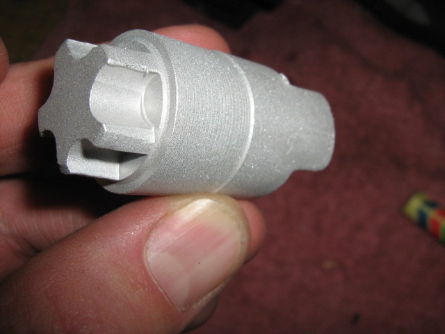

Had to make a tool to get the blue spot out

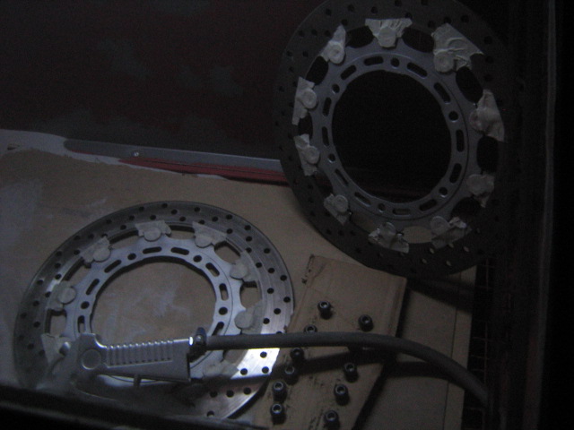

Part cleande wiht the ultrasonic washer

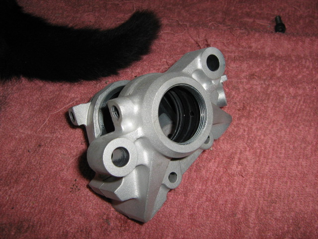

Caliper polished
On the bike
Long time no update....so here´s the latest news.
Caliper polished
On the bike

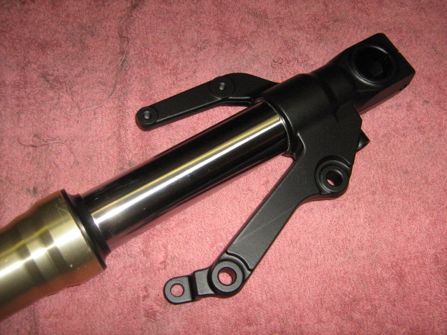

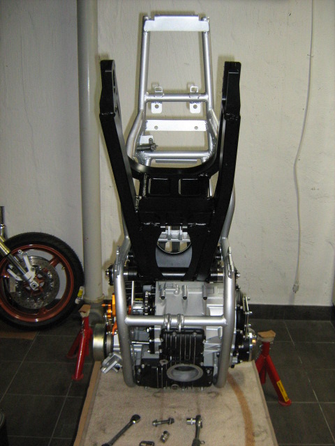

Some more stuff...

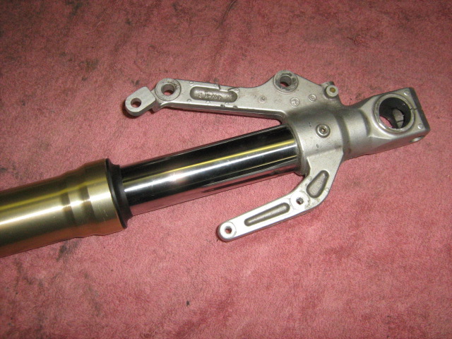

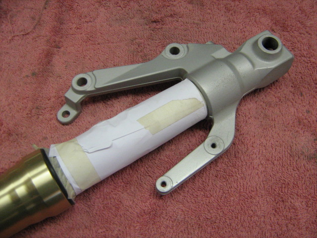

Forks get a refresh.

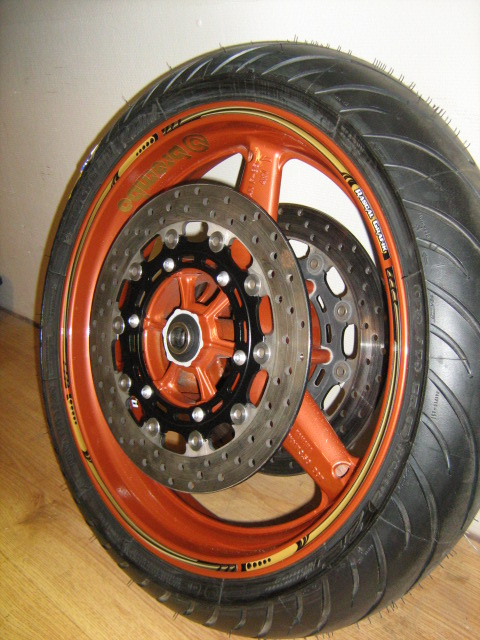

Front wheel get the same treatment as the rear.
My X-mas present...jeeez I´m been good this year

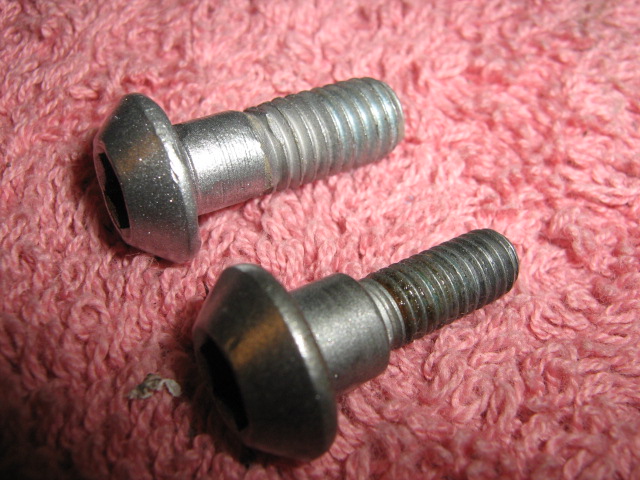

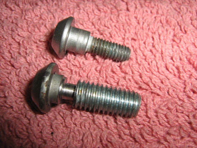

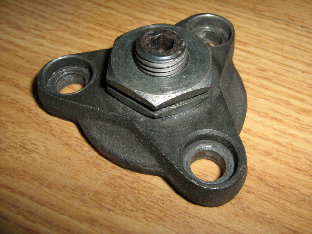

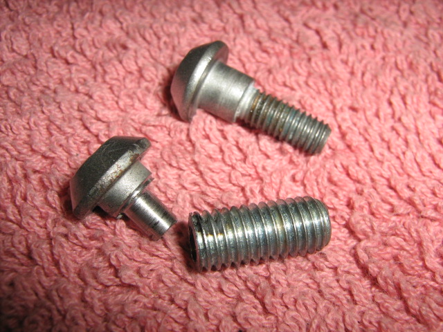

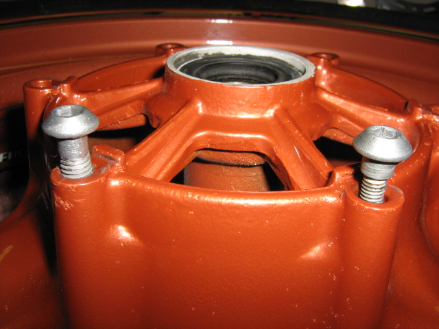

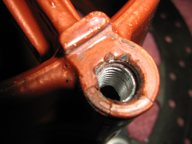

Sheared of a bolt for the discs.
Had to drill it out and make a new one using the same bolt head..
Drilled the old bolt out and rethreaded..

question on your rear sets.....what bike did you get them from? or did you made them.
excellent work....
