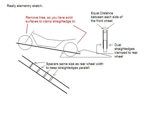

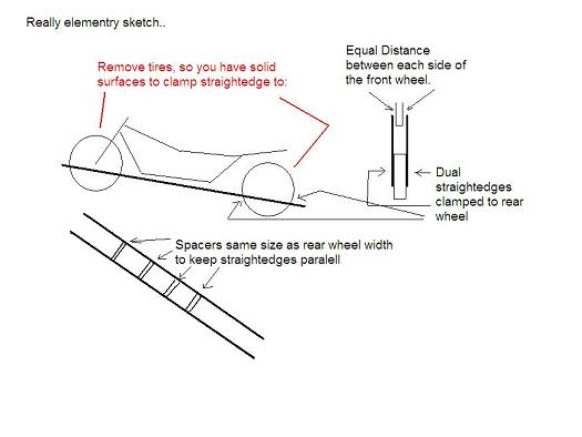

30 Oct 2014 20:01NakedFun wrote: I can send a couple of pics tonight, but I sent you the drawing a while ago? Do you still have it? I have the swing arm centered, but my rear tire may be slightly off center as I remember the ZRX1200 when they went ot the 180 rear tire and 6" rim, offset the wheel assembly in the swing. Won't be able to tell until I get it on a jig. I also need to make a taller kick stand!
Cory
I have same swingarm set up and nearly the same forks. My rear wheel is off center by about .090". The odd part is I did build a jig, and the front and rear are with in .005' of centerline to centerline.
There was a 3-4mm tolerance at the factory for the frame neck centerline to rest of frame. Muzzy when he built the superbikes would saw off the neck and remount it centering it on the rest of the frame. I think unless you want to intentionally misalign the two wheels you may find that it is just going to be off center.
Frustrating.
